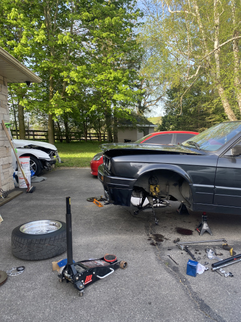

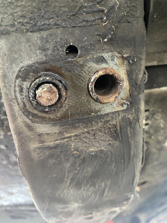

    Of course one of the LCAB bolts snapped in the frame which added extra stress to what was supposed to be a 48-hour weekend job.
    Click image for larger version  Name:	IMG_0700.jpg Views:	0 Size:	204.0 KB ID:	10114673
    Very sketchily drove the car with only 1 bolt on the passenger side LCAB to my buddy with a welder so he could tack a nut to it and get it loose, but finally had a car which felt so much tighter in the front end.
    Note to self - invest in a welding course for sometime soon.

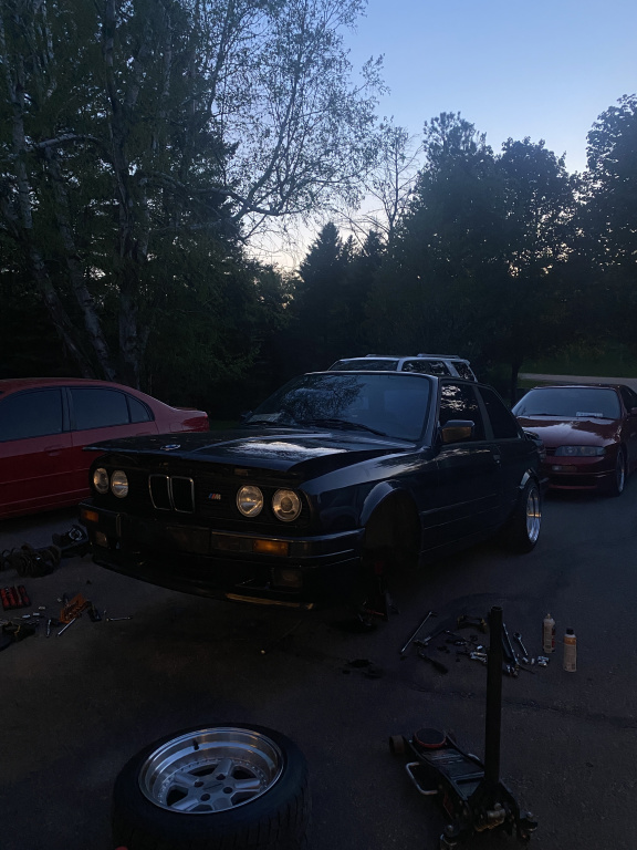

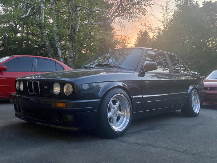

    Here's how she was looking after I finsihed: (had to raise the coilovers up a little as the Toronto streets would've eaten my tech 2 valence up before I even got home)
    Click image for larger version  Name:	IMG_0712.jpg Views:	0 Size:	196.7 KB ID:	10114670

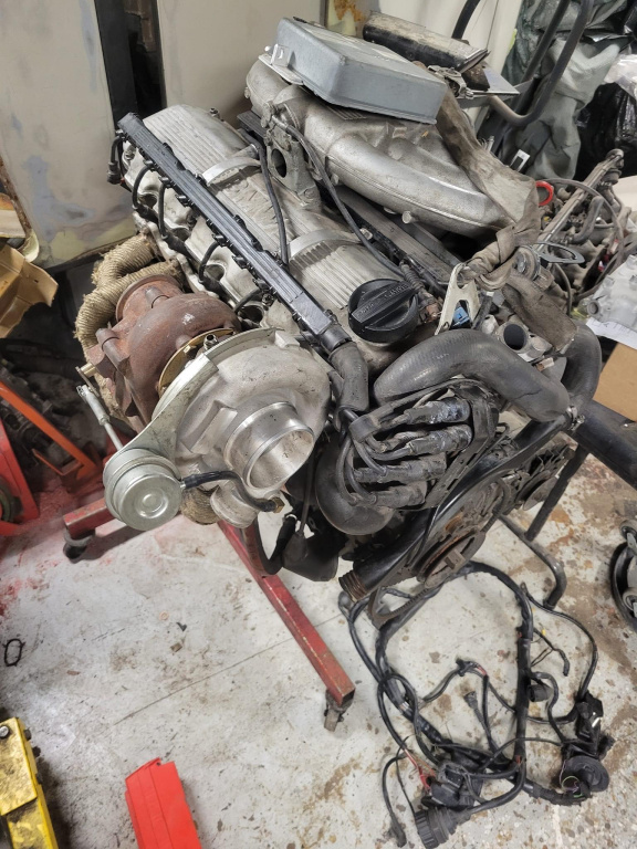

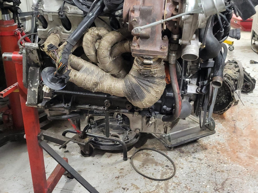

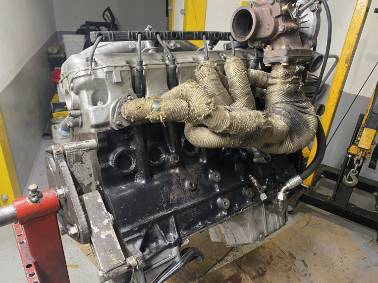

      A turbo motor came up for sale on one of the local Facebook groups with very little history and no real information on the build.
      The pros were: MLS head gasket, ARP studs, came with an RSI V1 manifold, cheap (but still working) Chinese turbo, intercooler piping which supposedly already fit an E30 and all the provisions for oil feed/drain already worked out.
      The cons - I didn't really know anything about turbo'd cars, nor did I have too much experience with engine internals and the seller didn't know if it was built or not.
      I figured the chance to learn about something I'd dreamed of doing, and at a cost which wouldn't keep me up too much at night if it went wrong was well worth it. I picked the motor up and started to investigate a bit more about exactly what I'd got myself into:
      Click image for larger version  Name:	IMG_1975.jpg Views:	0 Size:	246.7 KB ID:	10114696
      Click image for larger version  Name:	IMG_2165.jpg Views:	0 Size:	246.4 KB ID:	10114698 Click image for larger version  Name:	IMG_1974.jpg Views:	4 Size:	293.5 KB ID:	10114695
      Supposedly the car ran on this setup with the stock ECU that I got from the seller although when I pulled it apart it didn't look like it had been chip-tuned as I would've expected. No rising rate FPR or other signs of an early stock ECU turbo car didn't give me much hope, however, I ignored my intuition and continued searching for parts I deemed absolutely necessary to try start this thing.

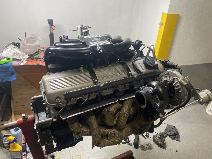

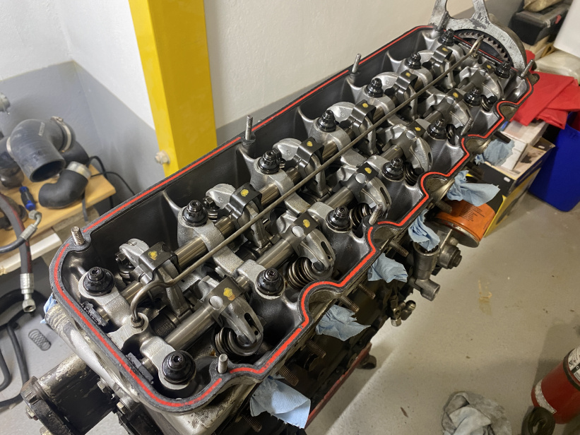

      With the chance to pull my old tired motor and refresh lots of the worn components, I gave the whole top end a refresh of gaskets excluding the headgasket. After a few coats of paint to make it look a little nicer, she was ready to be dropped into the car. I'd checked the cylinders with a boroscope and all looked good. Stock 2.5 motor and pistons, no sign of a different cam so confirmed that it was a stock 2.5 with the head and block decked for the MLS.
