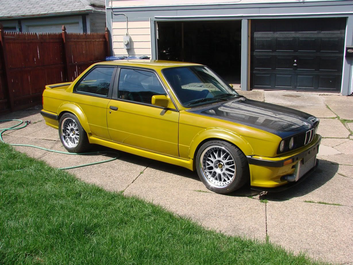

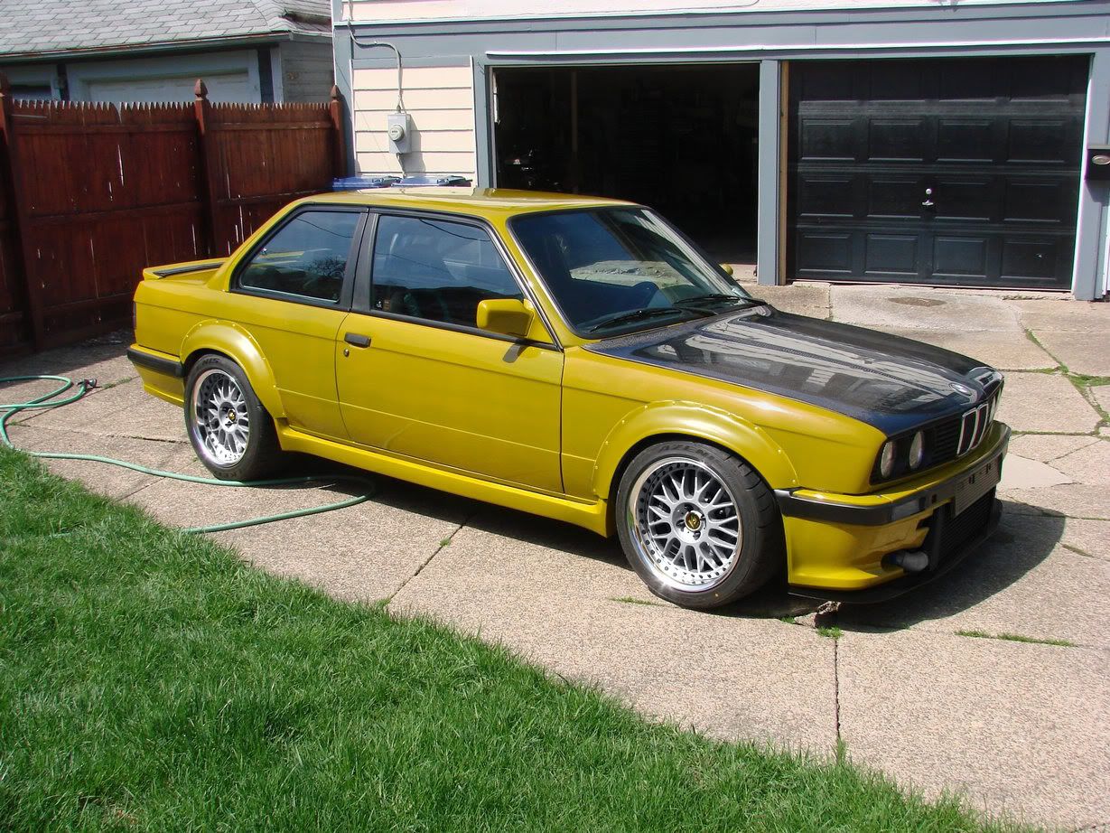

      My lazy friday gave me time to mess with your car newman, I hope you enjoy 'em.
      Original:
      color matched front fender
      color matched fender flares
      silver Volk's
      smoked turn signals
      smoked tail lights
      black intercooler

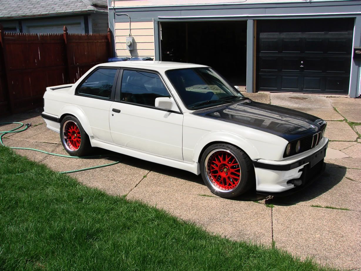

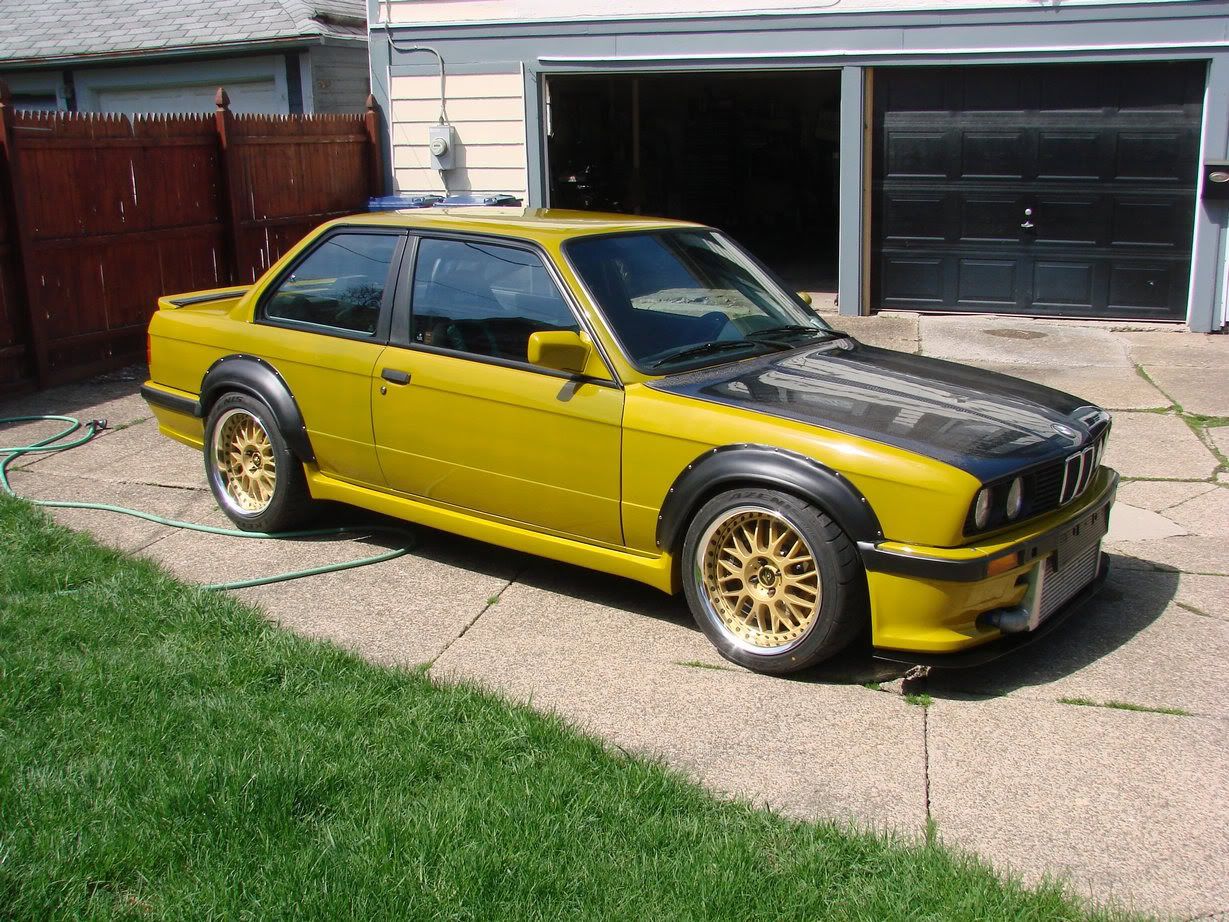

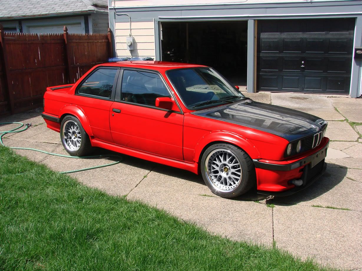

      Zinnoberrot:
      Alpineweis II:
      with red Volk's
      Your car sounds sick newman, just not a fan of your color choices.
