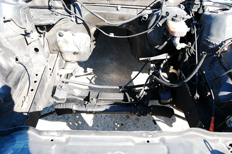

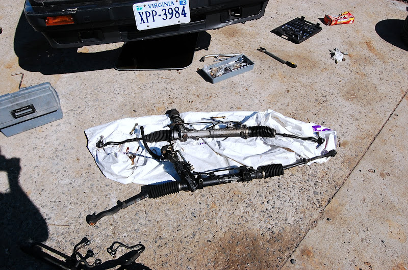

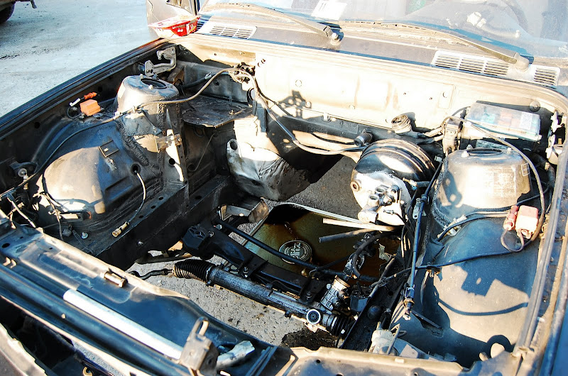

Day 1 as well - first things first - prepare the bay. E36 rack swap, change the booster, and the e34 throttle cable
e30 rack vs e36

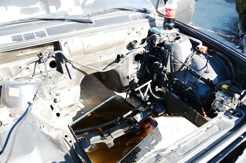

stock 318i booster out, rack out, - what I didn't get was a picture of me going to town with the die grinder on the firewall:nice:
Ended up using flat washers as spacers for the rack haha
I didn't quite get enough metal off the first pass with the grinder, and light was fading so when it cleared without interference I called it a day. I'm going to finangle the boot a little (probably cut it) and get it in there before the car is rolling.

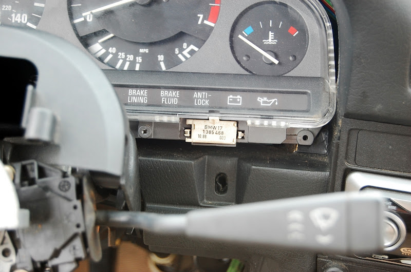

The rest of Tuesday I occupied myself by tearing apart the dash and swapping out the old coding plug. It made me appreciate the ease with which I can take apart my 'yota - not afraid of snapping old plastic pieces with that.
the new coding plug in

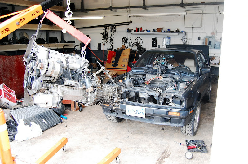

Got a universal alignment tool, got the tranny on and makin moves
almost, almost, almost....

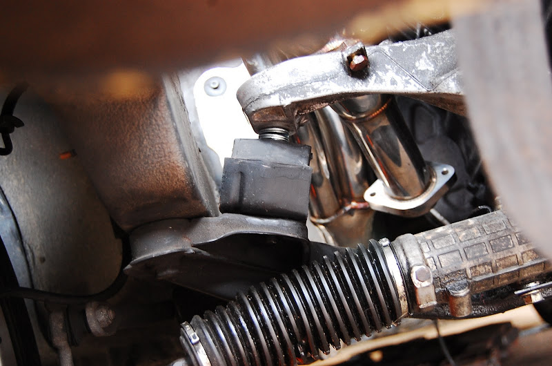

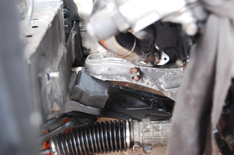

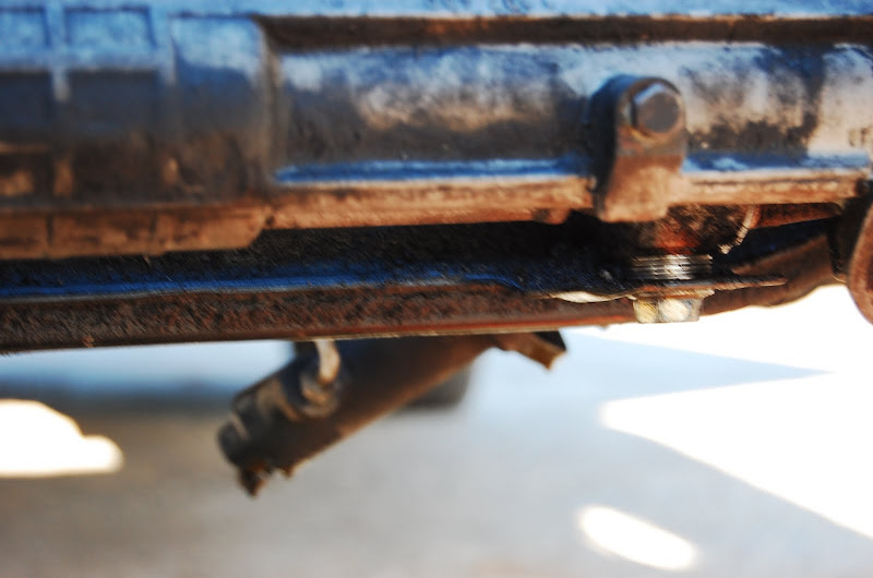

And here is where the next wave of frustration begins - thats about where it sits right now... Im thinking that I might have the wrong mounts now... I have the e28 mounts (I ordered them months ago though so I don't know exactly which model anymore)
Here are some pictures of what I have - is this right?
passengers side motor mount, its on but the other arm is off by like 1 1/4 inches or something..
also thought I remembered reading on a build thread that washers or a spacer was needed, so thats why those are there...

That doesn't really look safe...mounts are correct though.IG: deniso_nsi Leave me feedback here
its just a mock up - nothing has been tightened yet. Is there not supposed to be a spacer there?http://l0st0n3.mybrute.com

i don't want to spread any misinformation here, so i'd much rather wait for someone with some experience.
when i saw that i just didn't think it was right. i have the same exact mounts and didn't need a spacer. i'm using the treehouse booster, not sure if that will change much in this scenario though.IG: deniso_nsi Leave me feedback here
ahh - well I didn't have money for a fancy-schmancy treehouse booster ;) - thanks for the insight man, much appreciated. I'll try and fit it tomorrow without the stupid washers and see what happenshttp://l0st0n3.mybrute.com

From my experience there's about a 1mm difference between the green mount and black mount (could be wrong, which most likely I am). I usually use the mounts with no spacers below. Maximum spacers I'd run would be about two metal spacers/washer on each side. You'll need maybe two on the top side as well to be able to tighten down the motor mounts as the un-threaded portion of the bolt is about 1/4 of the bolts length.
SINdelle:E36 M3 5-Lug | 17x8 & 17x9 BBS RS | S52/ZF | 2.93LSD/3.5HFM/24lb Injectors/C&S Chip[B]SOLD[B]Comment
LOL fancy-schmancy...I would have used the iX booster had I not run out of patience.IG: deniso_nsi Leave me feedback here
wicked - thanks. Is it easier to bolt the motor mounts to the arms before its in, or should I lower the motor onto the mounts?From my experience there's about a 1mm difference between the green mount and black mount (could be wrong, which most likely I am). I usually use the mounts with no spacers below. Maximum spacers I'd run would be about two metal spacers/washer on each side. You'll need maybe two on the top side as well to be able to tighten down the motor mounts as the un-threaded portion of the bolt is about 1/4 of the bolts length.http://l0st0n3.mybrute.com

Since the bolt on the top is considerably longer, bolt the motor mount to the arm. It will take more clearance to have the motor sit on the mounts if you were to bolt it up to the subframe first.
I think the next time I get under there, I will dremel them to make em shorter!IG: deniso_nsi Leave me feedback here
Its in. :) My shitty ebay raceland headers were the issue - terrible fitment on the rear, they were hitting the firewall. Fortunately my boss can weld/bend well so I'm gonna have him have a day with it and get them fitted right. Tomorrow I'm working on some of the wiring and plumbing etc, but I also have to prepare my DD for an auto-x event this weekend so I won't be able to get too much done. moar pix soon 8)http://l0st0n3.mybrute.com
