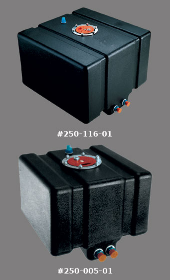

      Great project! I see your oem tank was removed, did you replace it with a fuel cell or?
      Curious if you didn't, and were you able to re-install oem tank with the subframe installed.
      • t1502
        • 21
        I replaced oem tank with a 12gal drag race fuel cell from Jaz, not ideal for my purpose but happened to have laying around.

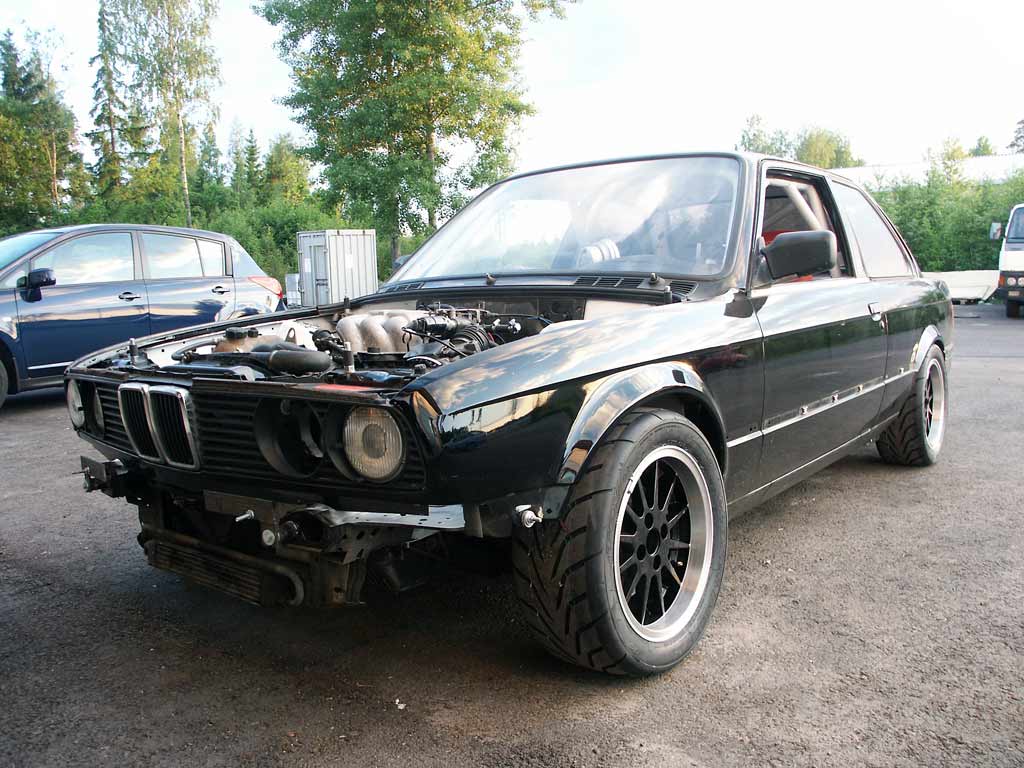

          Small updates: Suspension mods are now installed and so are the new Toyo R888 tires with some old 15" wheels I had from earlier stages of the car.
          Took it for a very short spin around the garage and it felt absolutely great! Initial thoughts that it could be couple of seconds faster per lap than used to be ...happy with that! :D

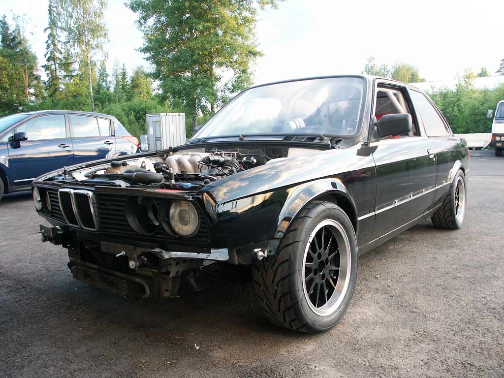

                Last pic before going to the track in the morning.
                Tomorrow morning 8am heading to Ahvenisto to get some new video with faster laptimes hopefully...

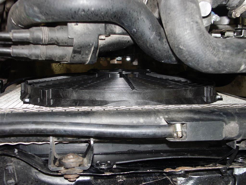

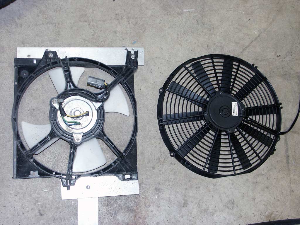

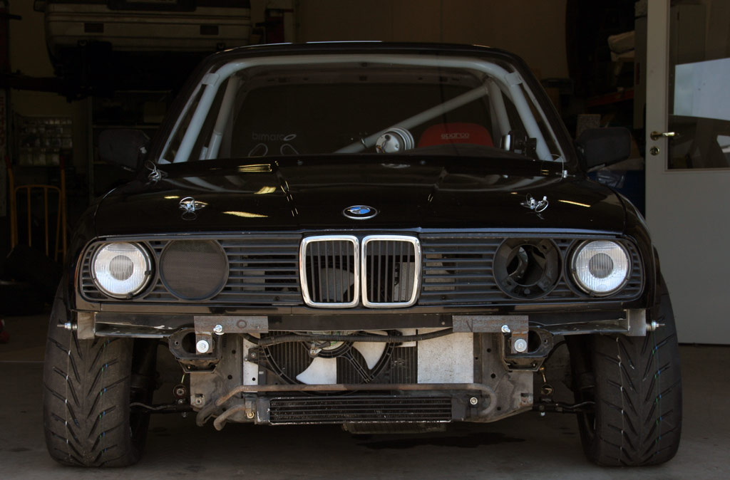

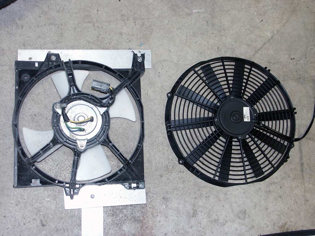

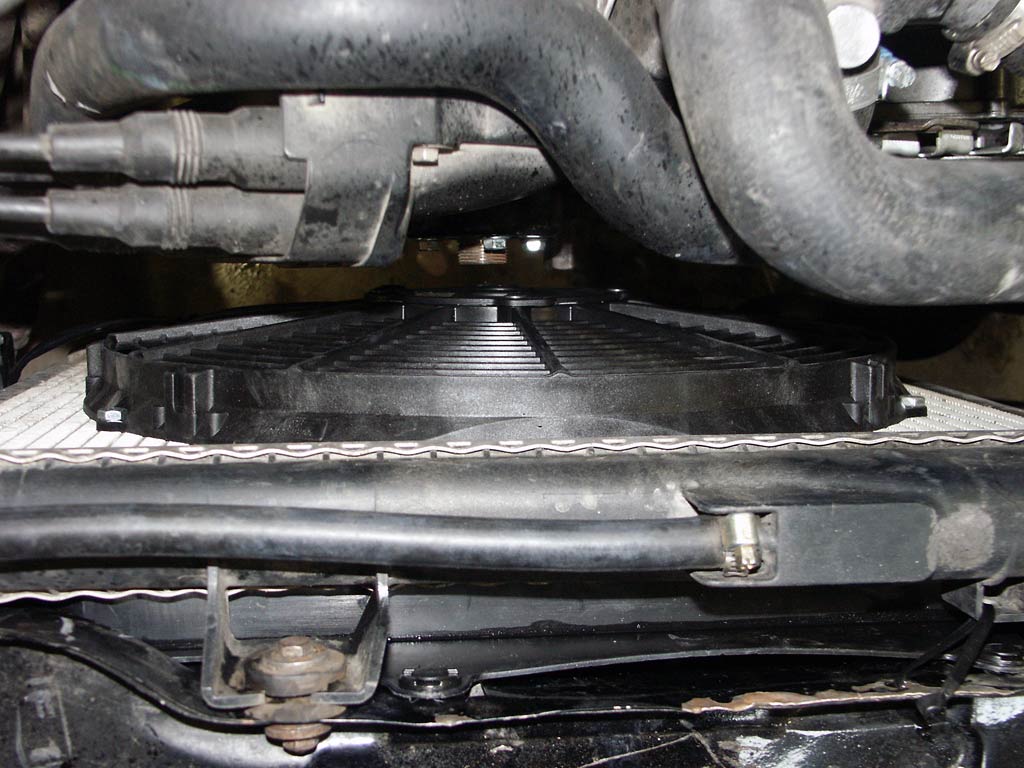

                      Hopefully got the cooling issue sorted now. Ni*san electric fan that I had mounted in front of the radiator got kicked from this project and a Spal unit found it's way to the enginebay.
                      While the radiator was off, I flushed the system. No surprises there, everything that came out was clear as it should be :)

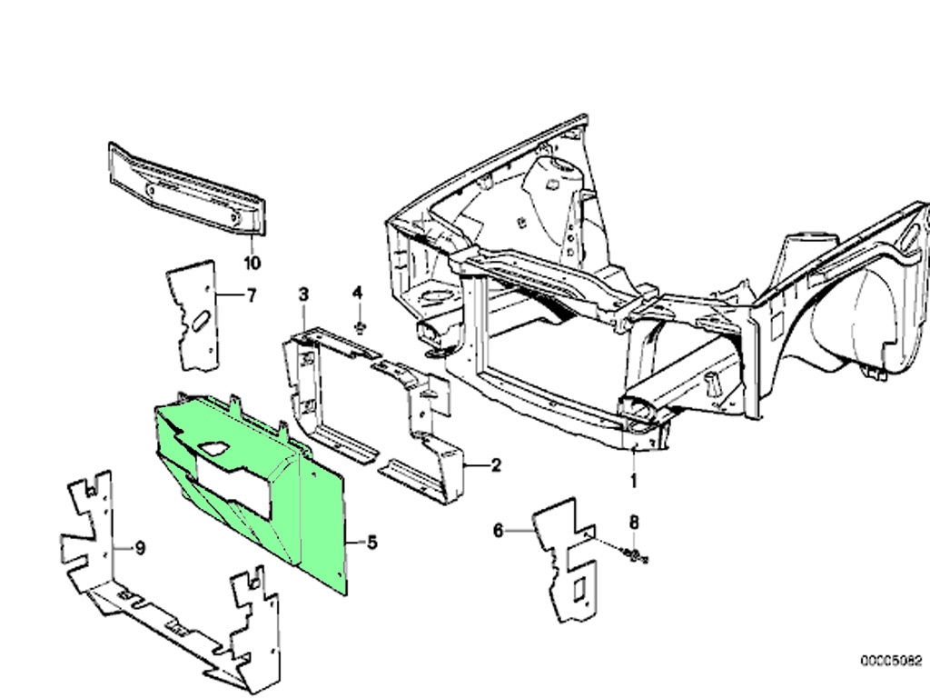

                      Also installed the air intake tube that I had to eliminate earlier to make room for the Ni*san electric fan infront of the radiator.
                      Design sure is different, hopefully cooling power also...

                      Still got 18mm cleareance :D

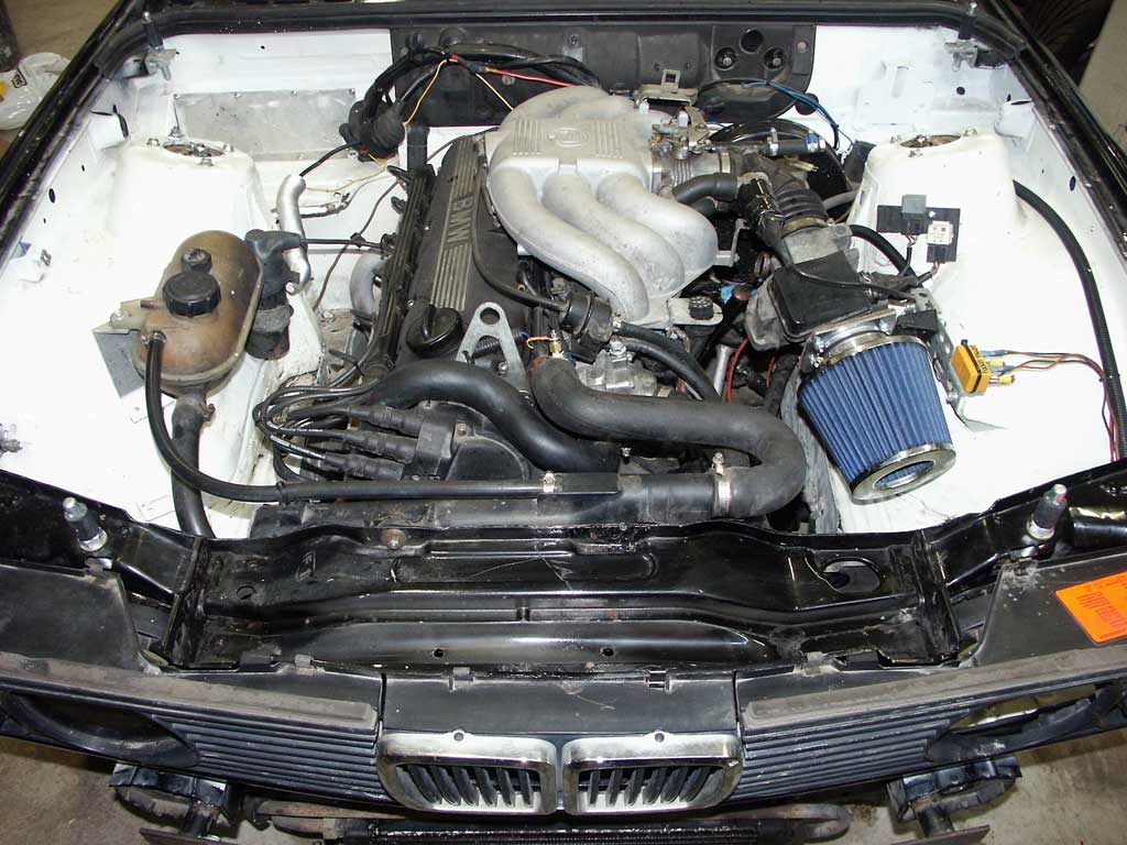

                      Enginebay in it's current state. Lots of things to do... :???:
                        [ATTACH]20661[/ATTACH]
                        I just picked up one of these from the junk yard. I was thinking of fabbing something like this up out of aluminum, but this was free and looks like it will work well!
                        • t1502
                          • 21
                          If you make one out of aluminum, please post some pics. Interested in seeing how it turns out.
                          My plan was making one out of glassfiber, but that has to be later project. Weight savings compared to orginal plastic one is next to nothing, the plastic thingy doesn't weigh a thing... But hey, it's nice to do something just for the fun of it, right? :D

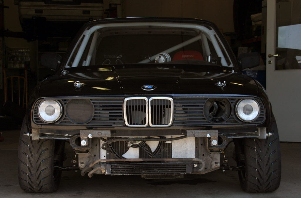

                            Went to the track yesterday and got to finally test the changes that I made to the cooling system. It works!!! Temp used to rise after a couple laps to 240F and now it didn't go past 210F even after 12 laps! :D
                            Got some other things done too. I'll post a few pics of these doings...

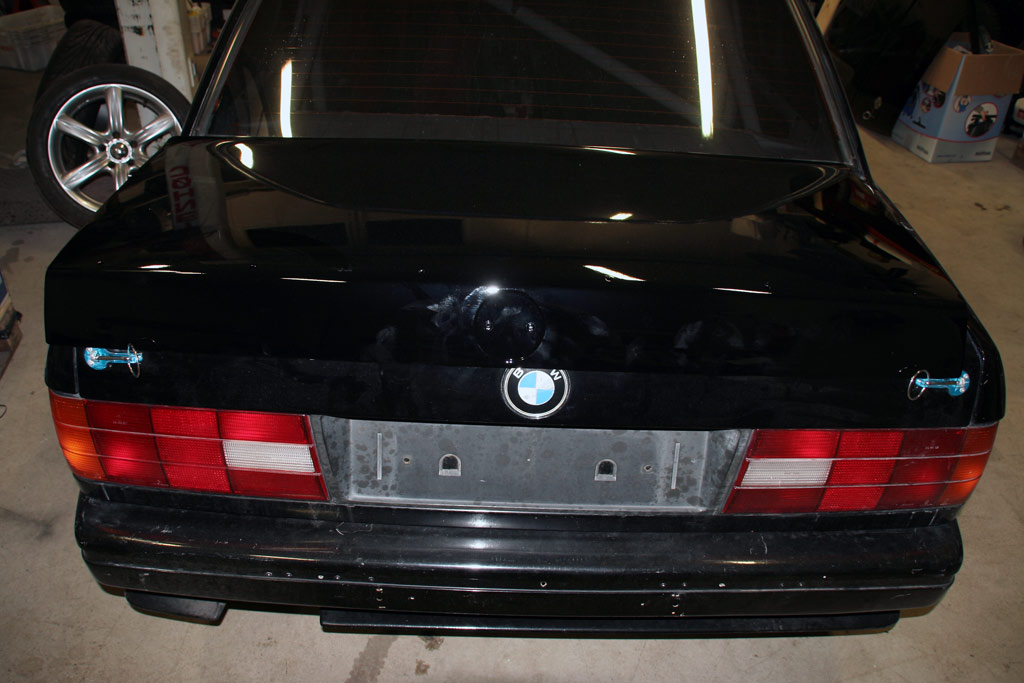

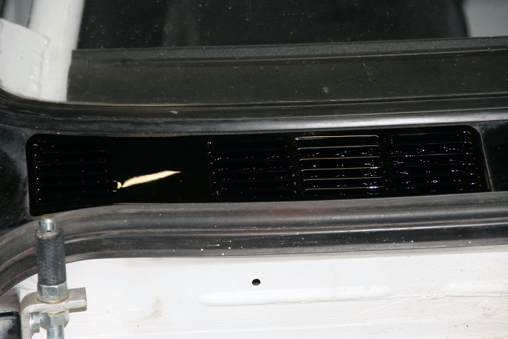

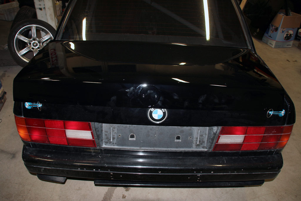

                            Painted the trunk lid...

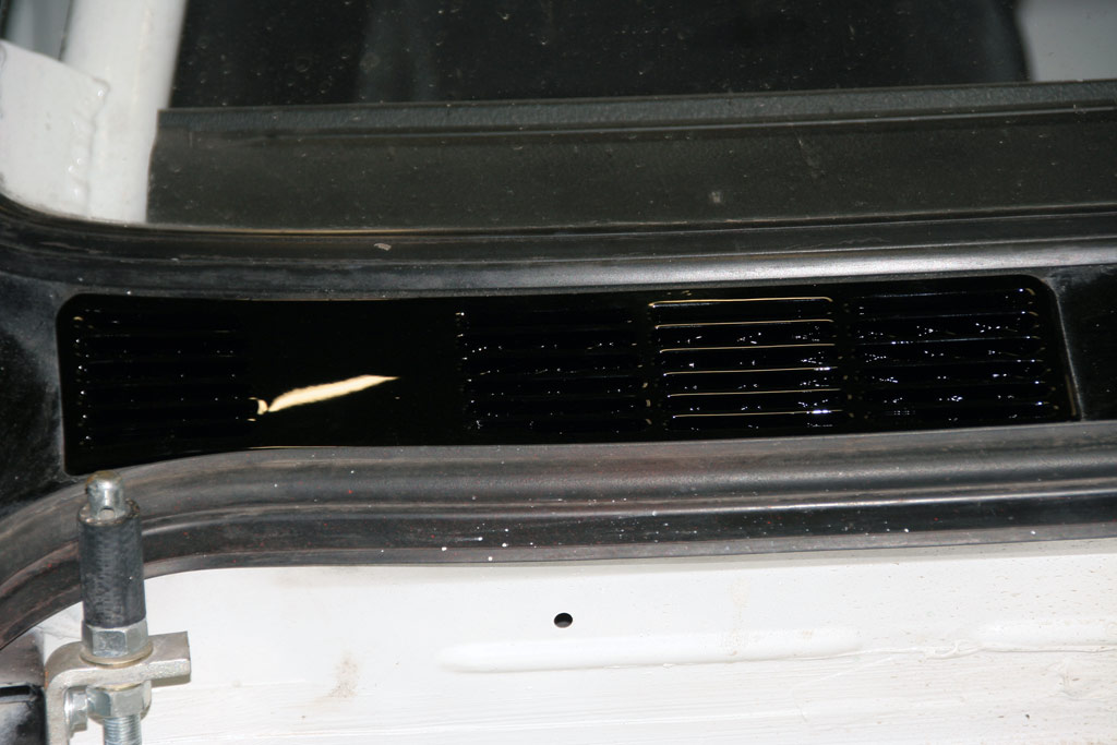

                            ...these little grilles...

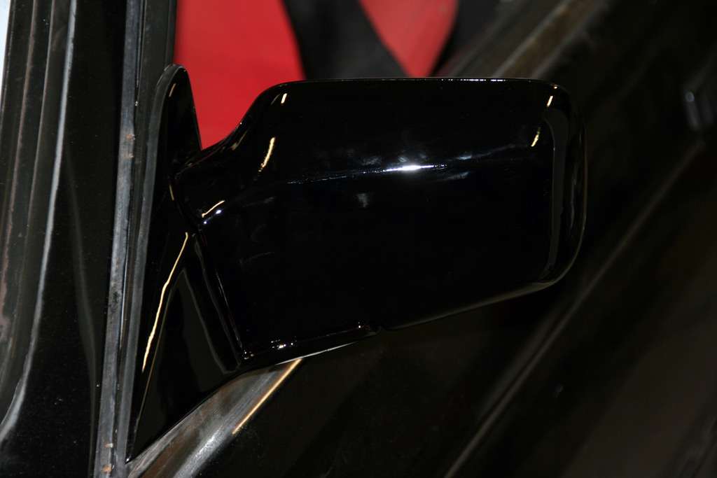

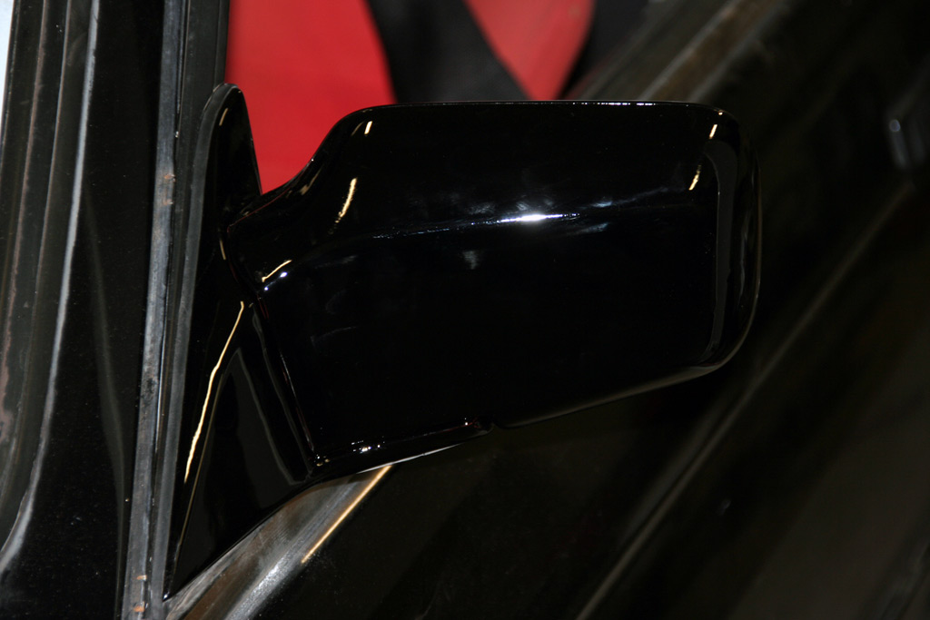

                            and the door mirrors.
                            Couldn't get a good picture where you could clearly see the paint finish, but though it's fine for my project, I can tell you it's far from perfect.

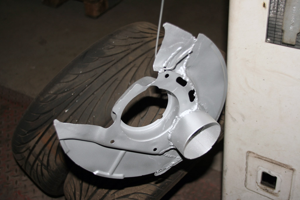

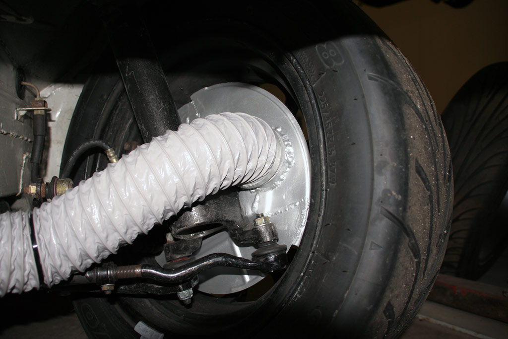

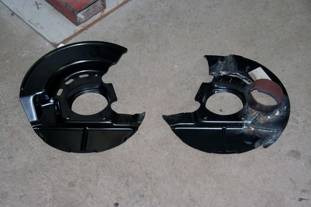

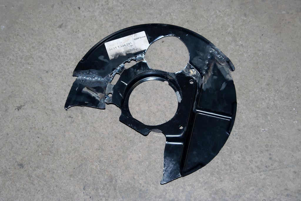

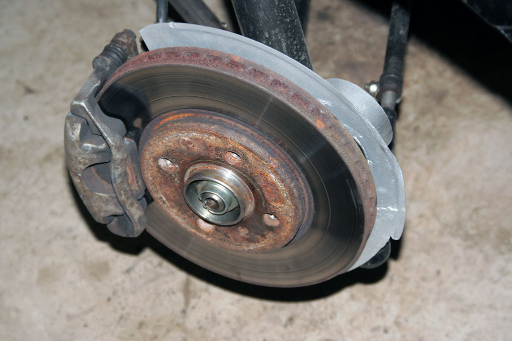

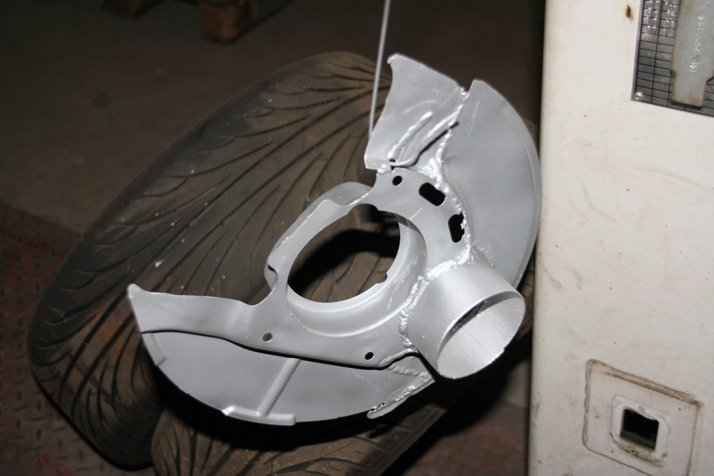

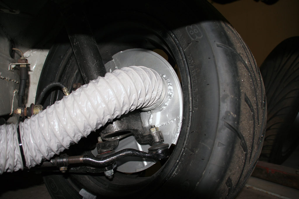

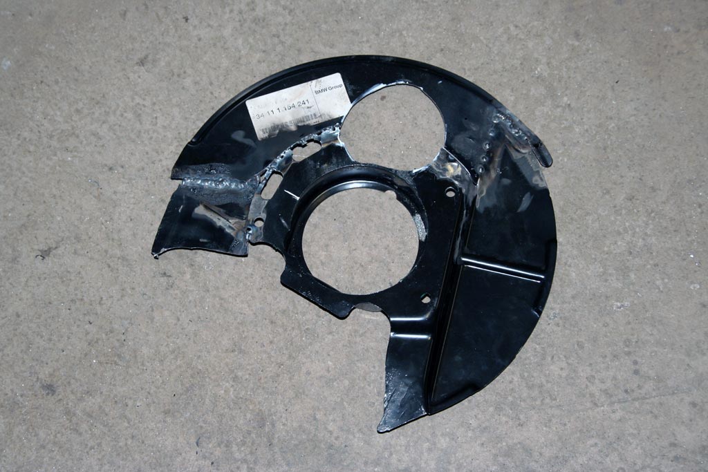

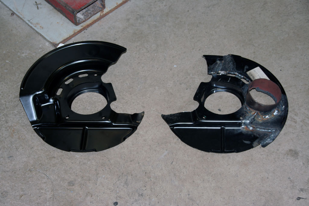

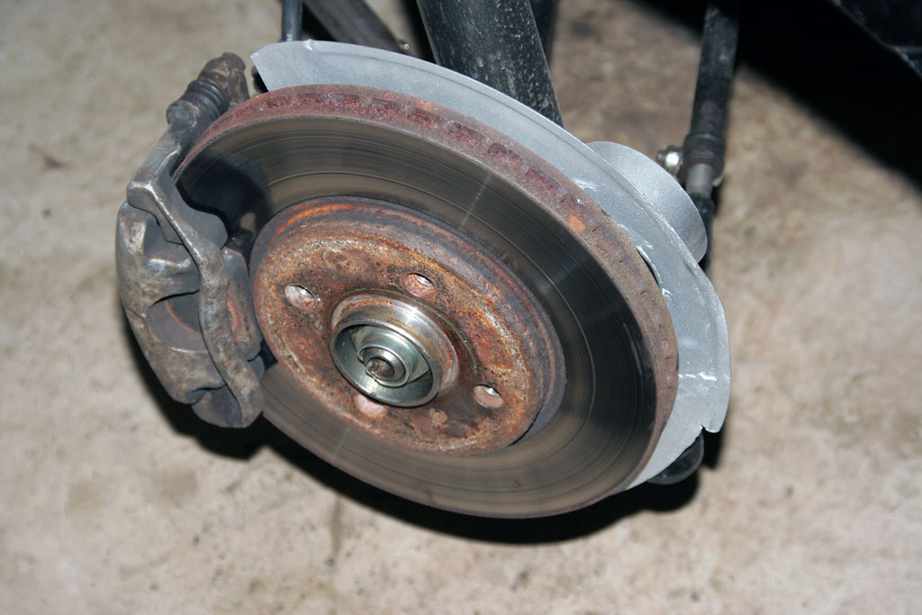

                              The brakes got some help cooling when I modded the original backing plates and installed ducting to them.

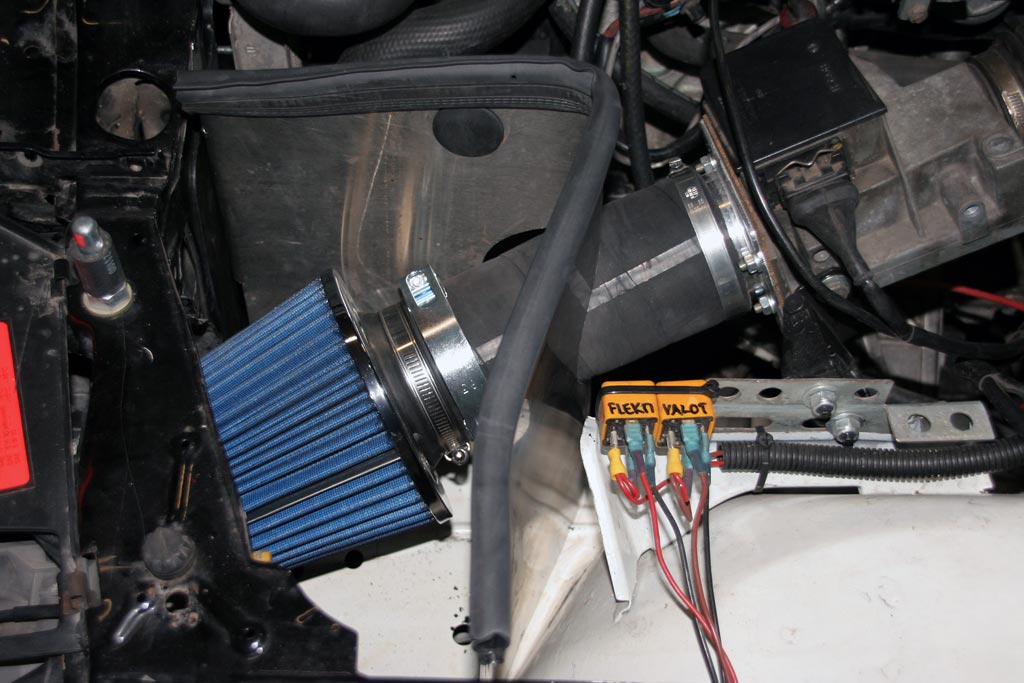

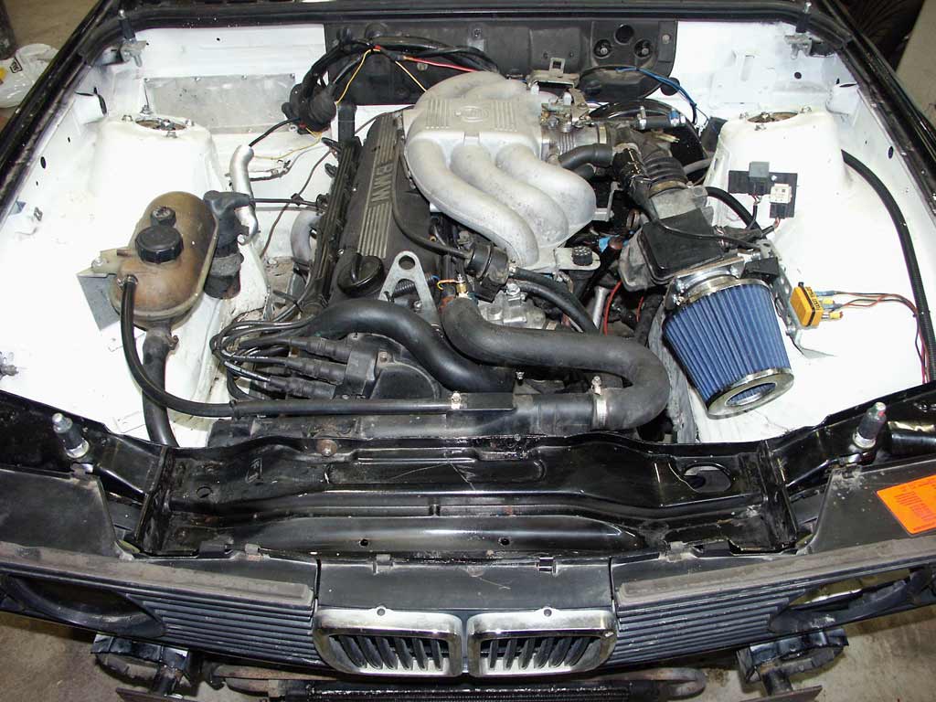

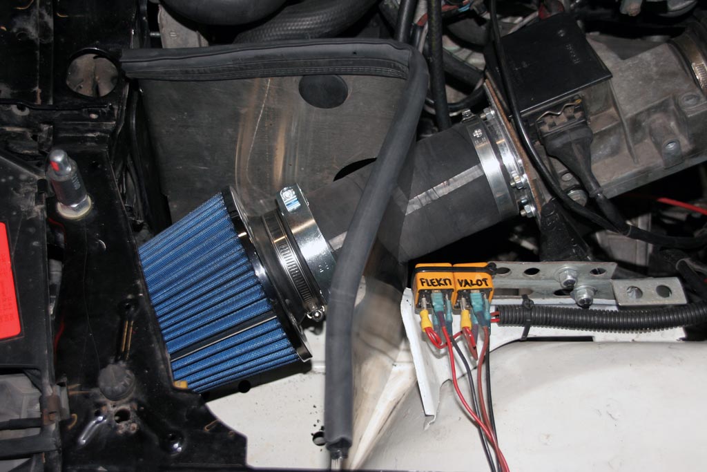

                                Also air filter got some help getting cool air from outside instead of hot enginebay air...
