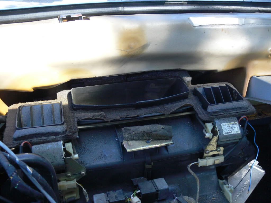

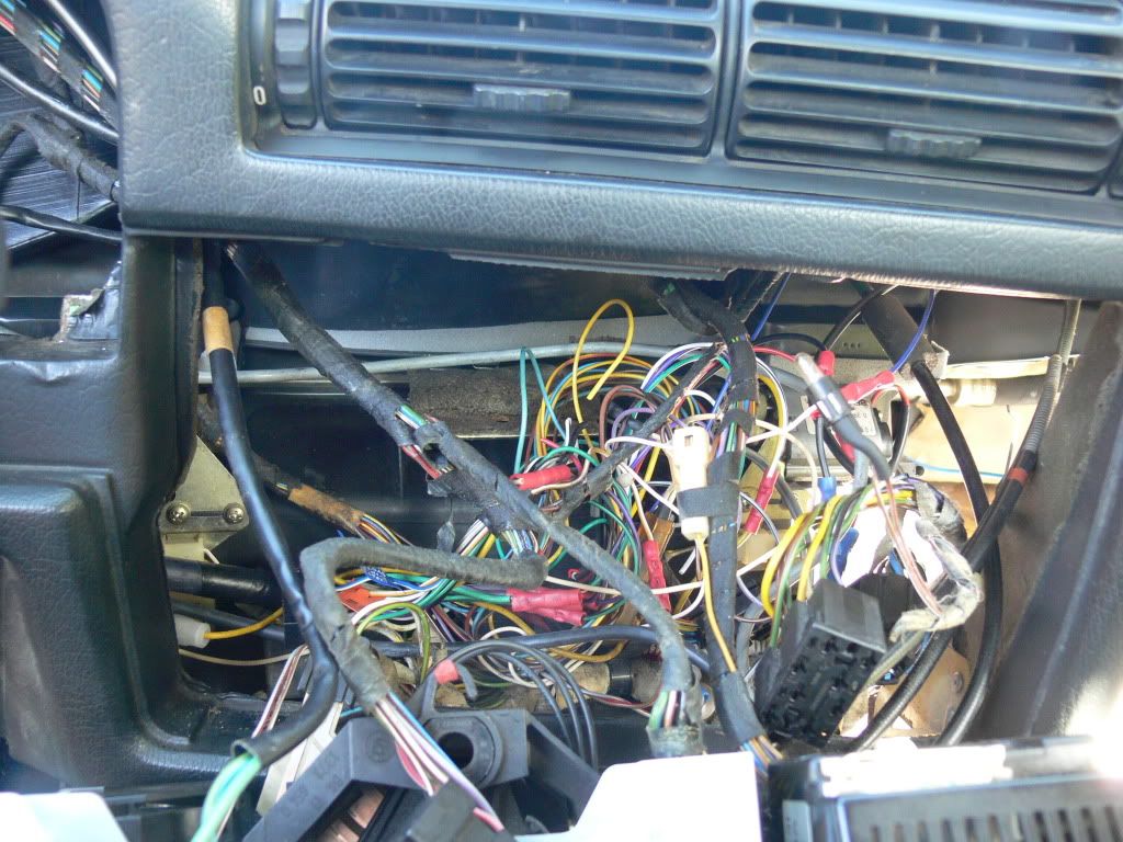

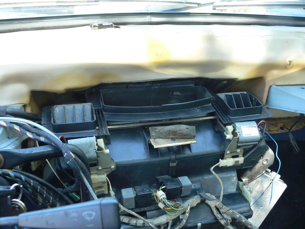

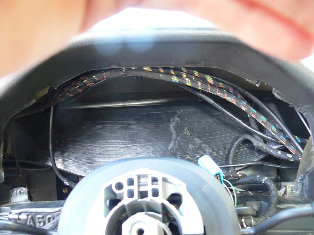

      Here's the HVAC gasket remnants
      I decided to clean everything up

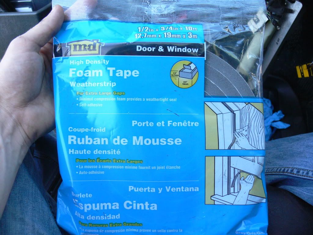

      Since I'm all poor and shit, instead of spending $30 on a new gasket I decided to go the homo depot route and spend $3.49
      Good enough

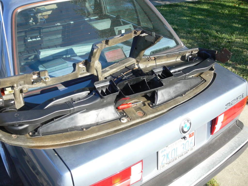

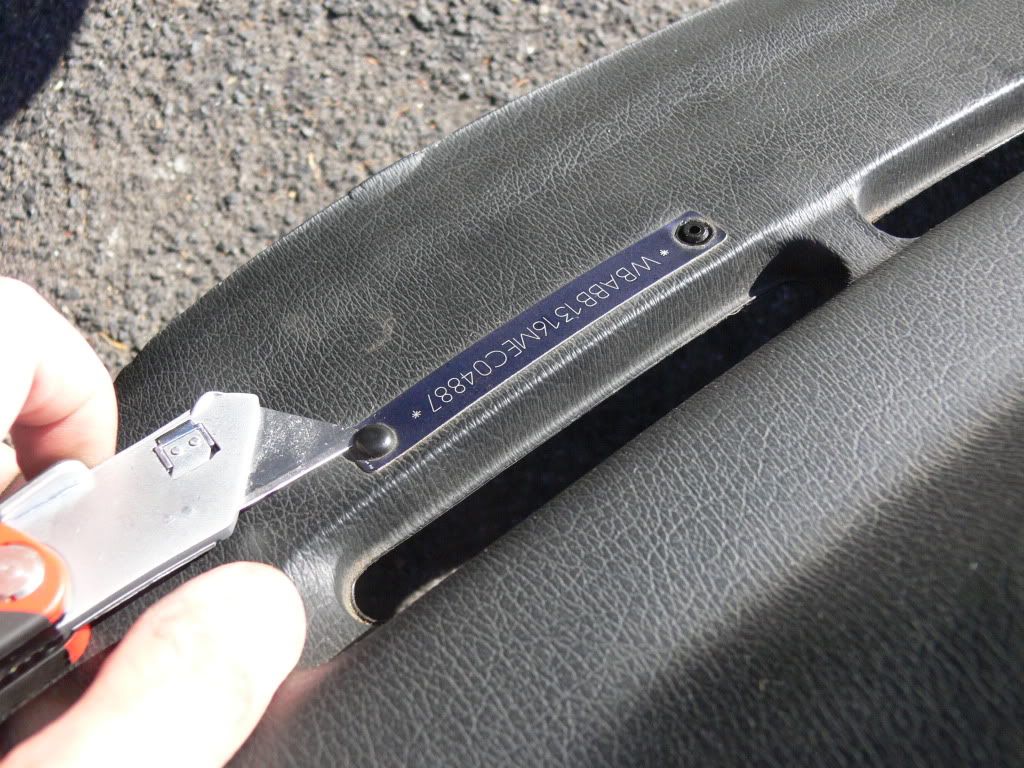

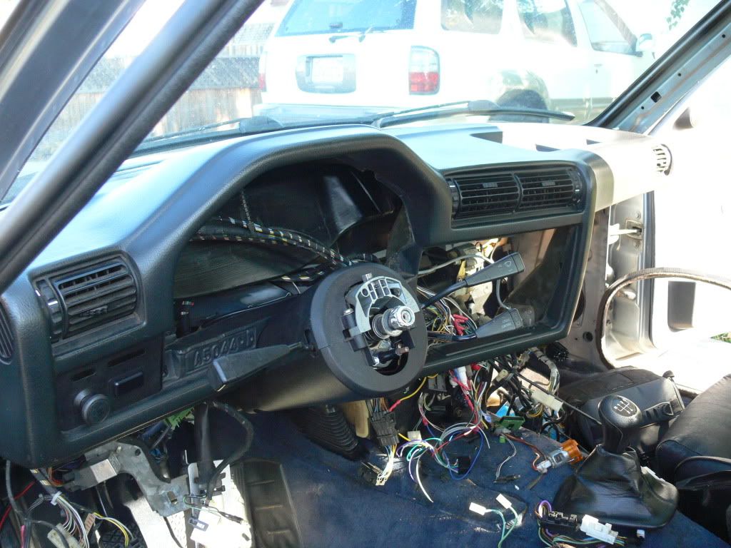

      Swapping VINs (before you get your hopes up, that's the donor dash VIN, not my car's VIN ;))

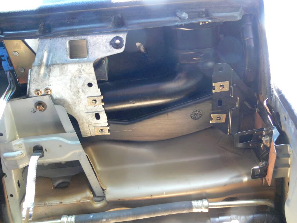

      Reinstalling all the ducting, light switch etc into the new dash
      Got it in

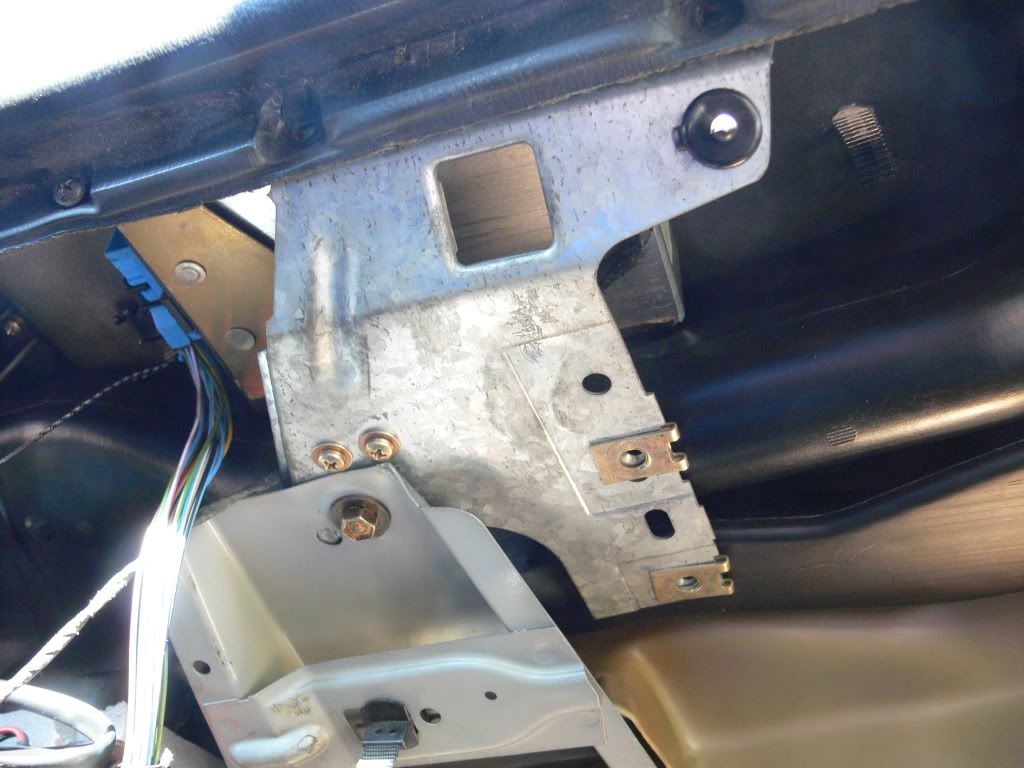

      This thing needs to get wedged up in the dash, it's one of the DME fastening points as well
      Here's where the DME would go normally if you didn't have a 24V swap ;)

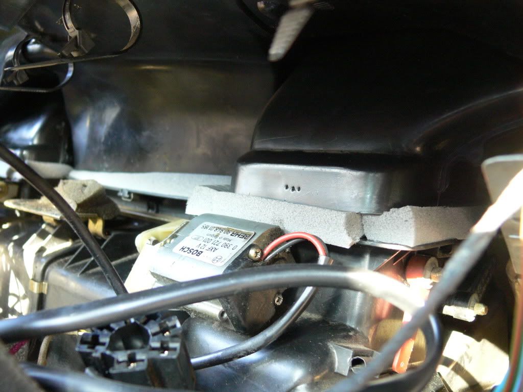

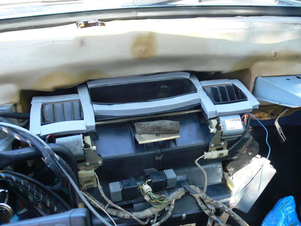

      Here's how the new "gasket" works
      Looking good so far
      Ultimately though it became apparent that the dash is a little warped--it doesn't fit the cluster or the HVAC controls quite right. I'll work with it since I got it for $30.

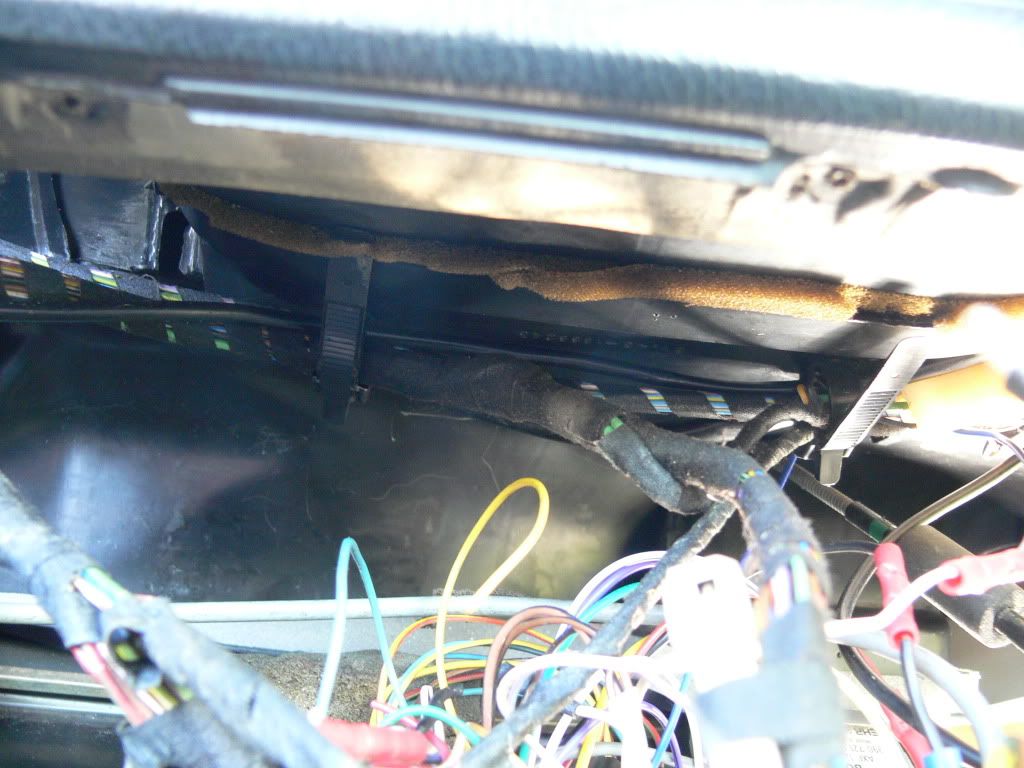

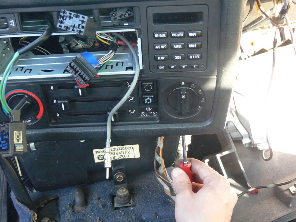

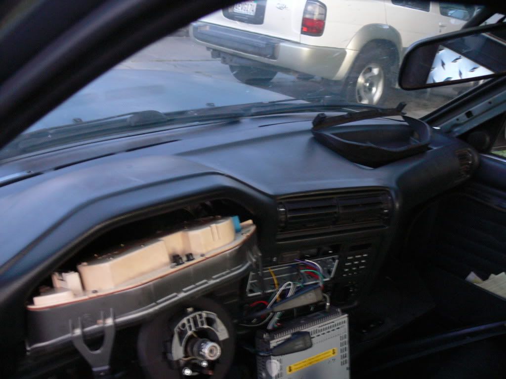

          Consider yourself lucky if you have these zip-tie style clips, these are awesome.

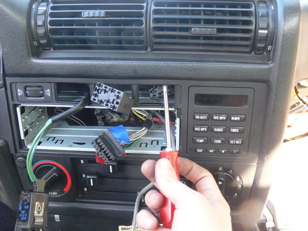

          Here are the screws that hold in the HVAC control/radio panel. One here
          One here
          And one on either side down there
          Broke the extra harness clips that I had, so the harnesses behind the cluster only get one for now.

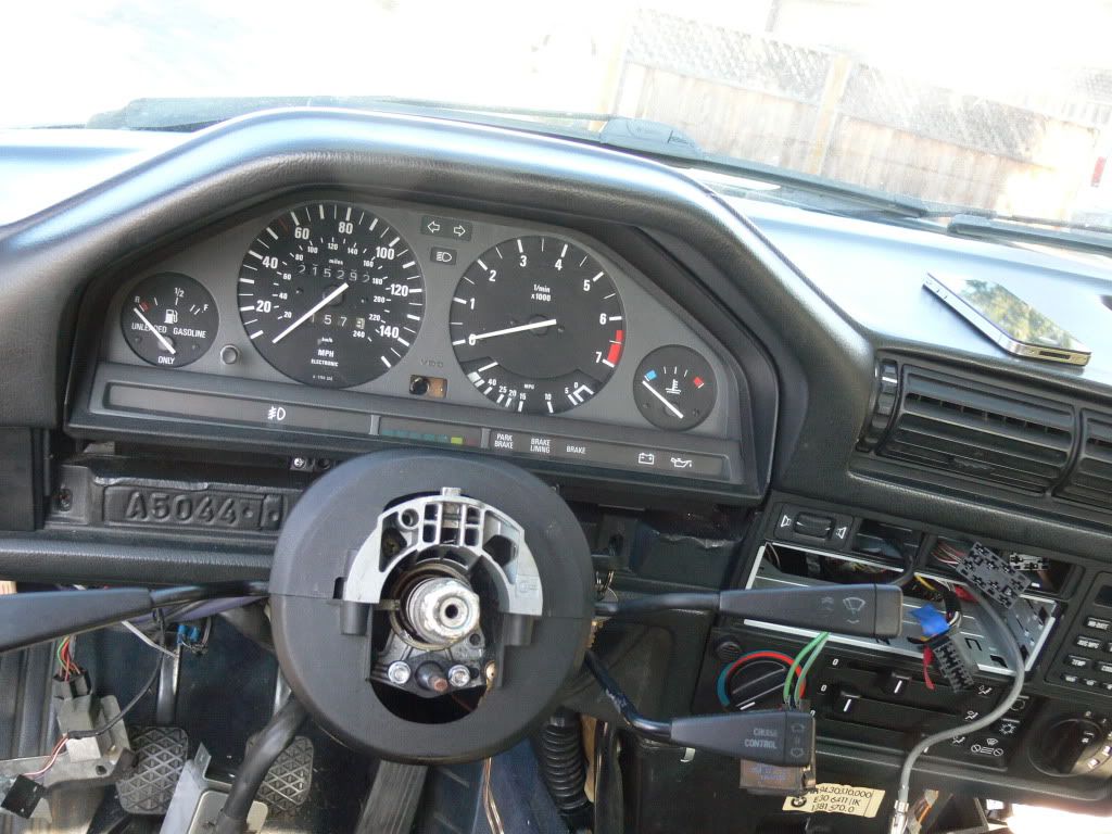

          Cluster's in
          I had to rush to put stuff together to meet my friend after this, so I don't have finished pics yet. Well, it's not totally finished, but mostly... still need to find a short that just popped up in the interior/cluster lighting somewhere.

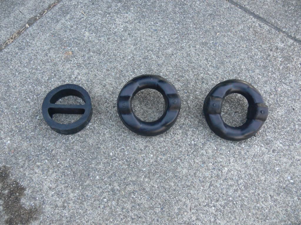

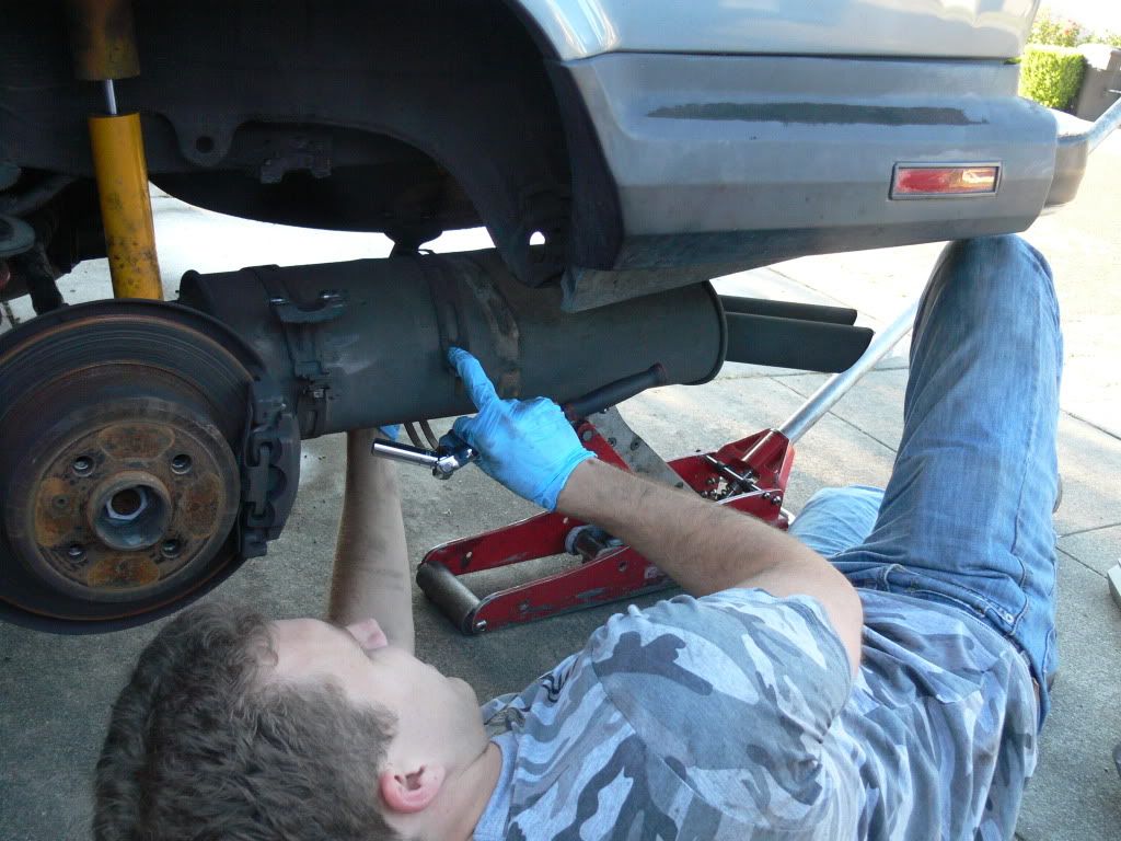

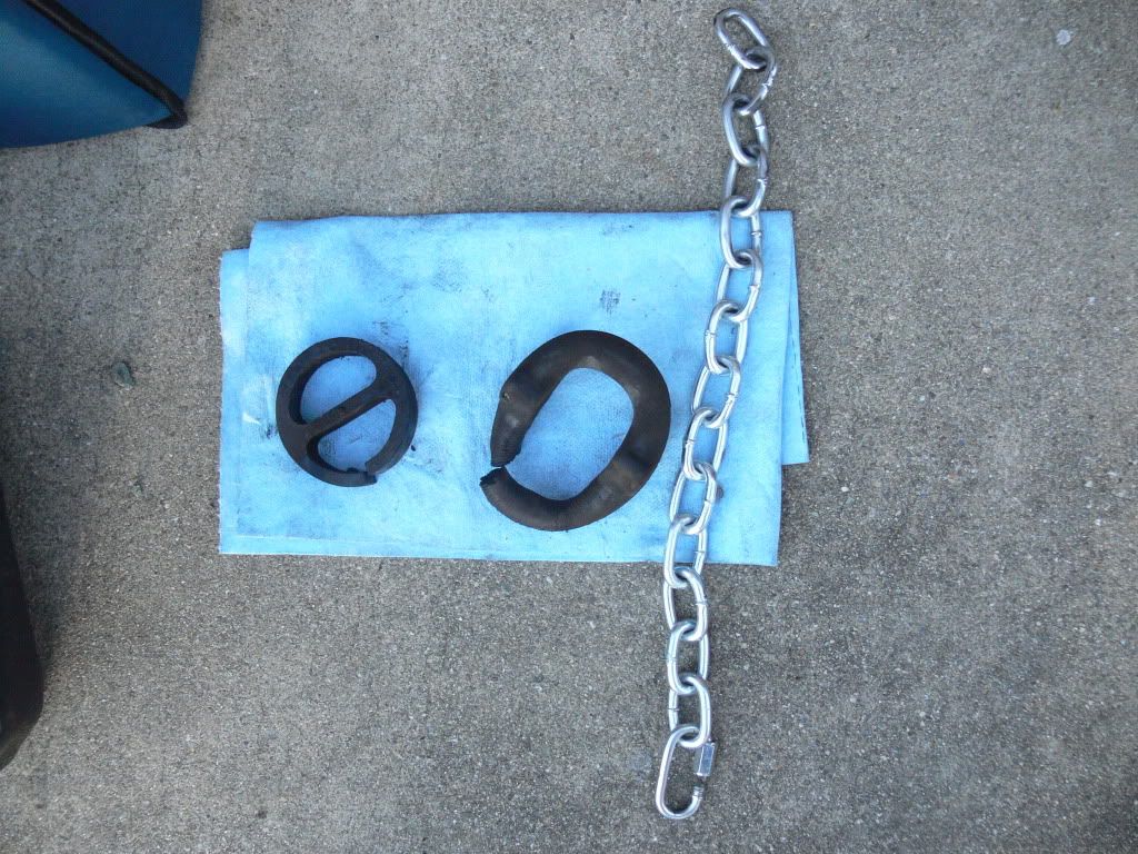

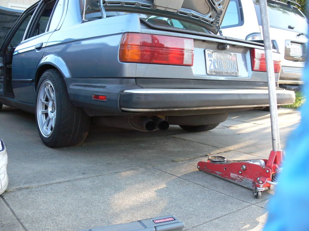

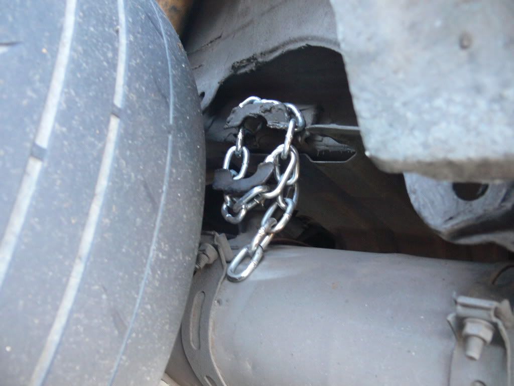

                              So here is the hardware that was holding up my exhaust
                              A chain, you ask? Why, yes. That's what happens when you need something quick because your last exhaust hangar just broke in the middle of a canyon run.
                              Grabbed some new hangars from Dinan, ironically their prices were about 40% of what the dealer wanted ($19 for one of those donuts at the dealer).
                              On they go (this was a bit of a bitch)
                              Finished product. I don't scrape over speed bumps as much either since my exhaust doesn't dangle down like nuts on Danny's chin any more
                              Yes I need new RS3s, they are in the mail! I am going to have to squeeze another trip to LA out of these though.
