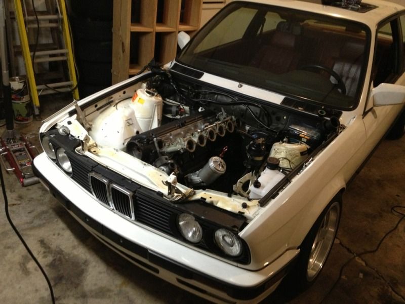

                Engine in, finally!

                • LJ851
                  • 7919
                  #113
                  Oh, yes.
                  Lorin
                  The M30 is God's engine.
                  • Jean
                    • 18228
                    #114
                    nice!
