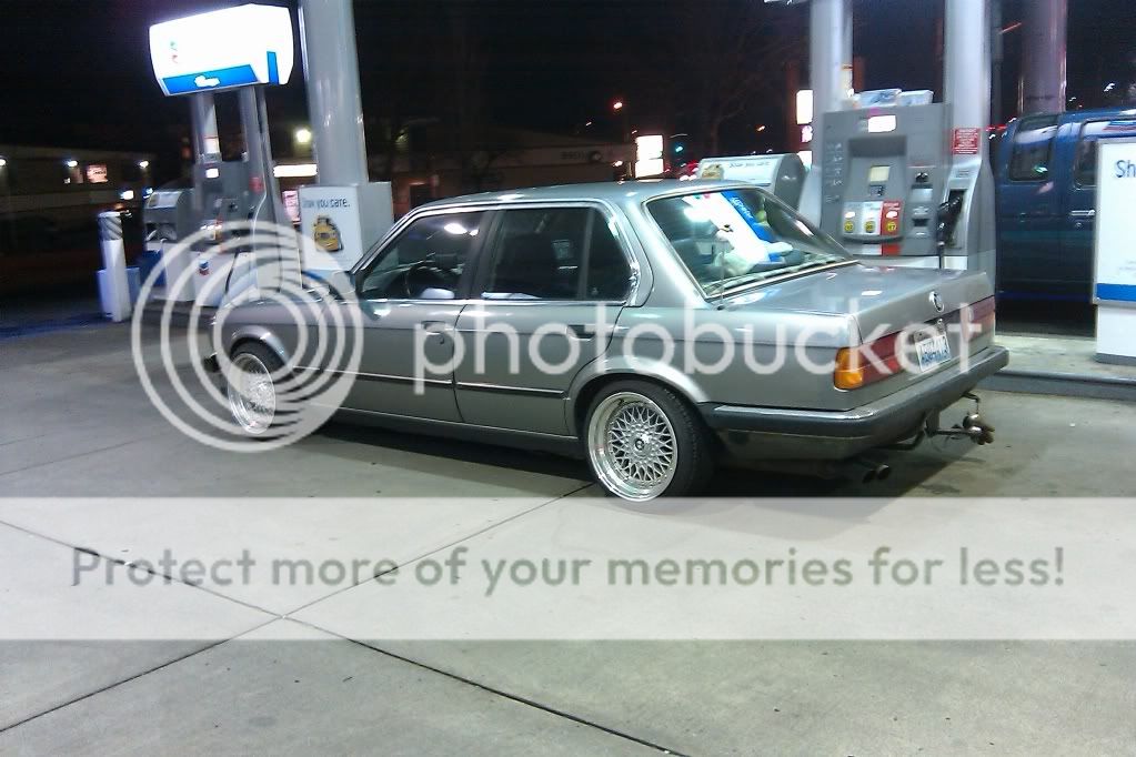

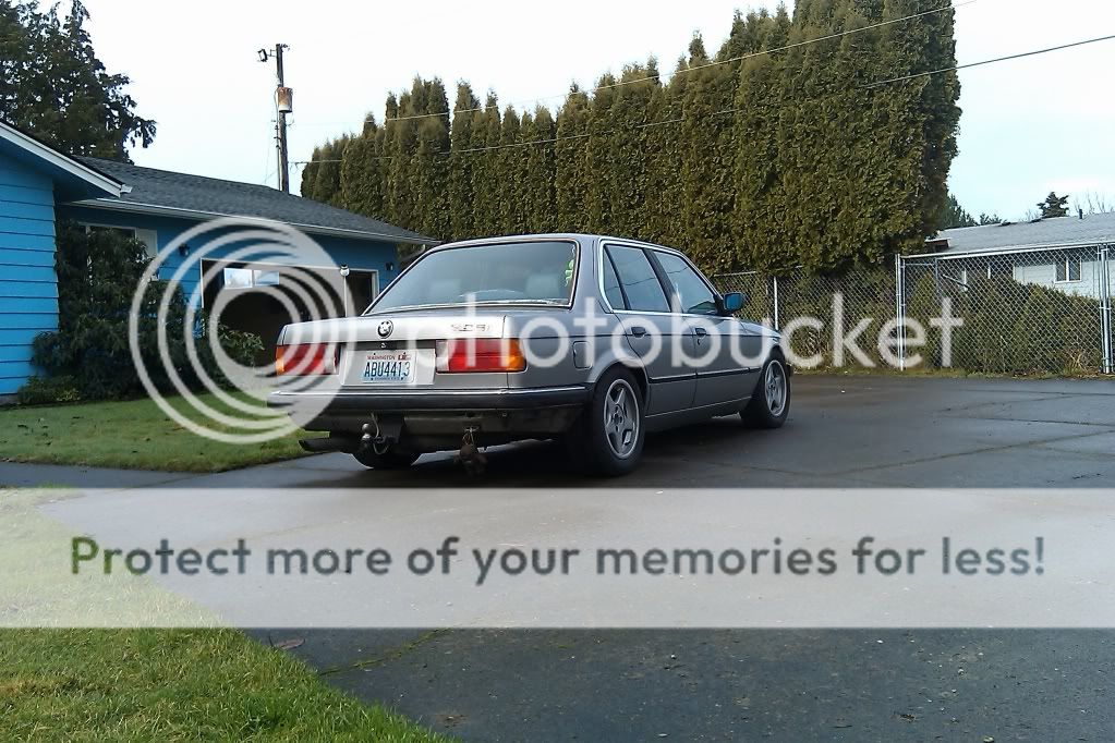

                  Could not find my camera so you guys get smartphone pics.

                    just added rear bumper to your car?
                    • Wishno87
                      • 6025
                      #295
                      Ya a few days ago. Now just need to find a front.

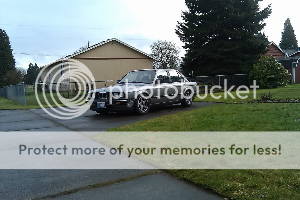

                        Just a little teaser. Proper fitment and ride height will come before decent pics.

                          MMMM MMMM
                          just needsa front bumper, IMO it would be perfect.

                              Do want!!!!!

                                Ya it does look much classier now. Might even keep the window chrome with these wheels.
