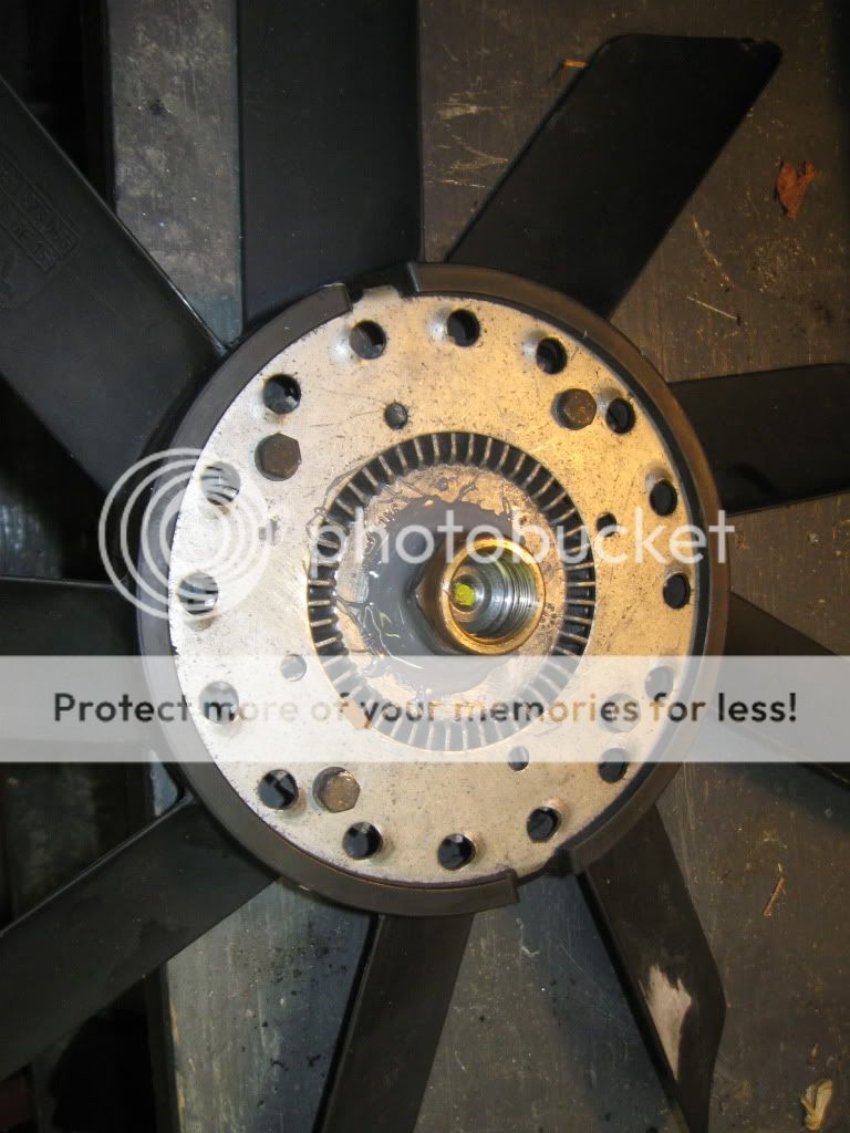

      My fan clutch was shot so i just JB welded it for now hehe

        That fan is going to go through your hood, its prolly worth just leaving it off. How long have you been in waldorf? What base are you at, andrews, pax river, bolling?

          I dont see it falling off, im only reving to 4g. It sounds loud as hell thou.

                    There is a reason the fan has a clutch. At least get a junkyard clutch, don't ghetto-rig the car.

                      what exactly is that reason then? Old cars just had stamped steel blades bolted onto the front of the water pump. The only thing im missing out on is a fraction of power at high rpms when my engine is cold. When the engine is hot the fan cutch is engaged and spins at the same speed as if it was solid. Enough about the stupid fan clutch its my beater.

                        Its your hood/coolant hoses/radiator that will probably suffer the consequences if you spin that fan all the way up to the eta's mighty 5k rpm. Maybe it'll last for a while, but its just not worth taking the risk.

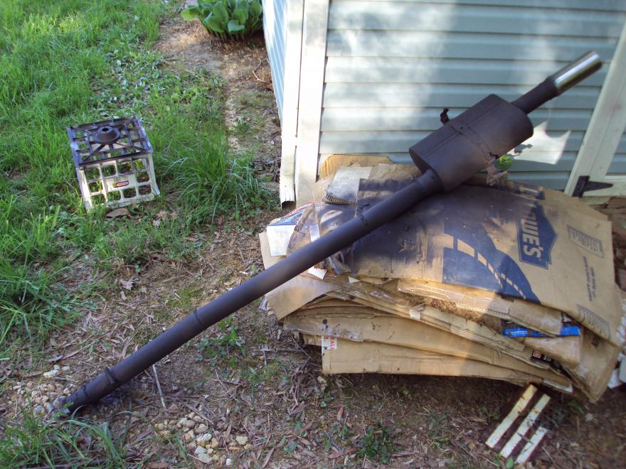

                          So this week I finally stopped being lazy on my DD. I put in an ebay chip, K&N filter, and homemade 2.5" exhaust. Total cost under $100 :)

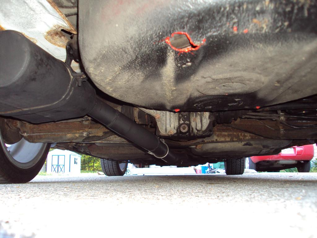

                          For the exhaust I used a SS rolled end tip with a used side in center out maglaflow muffler. For the bends near the diff i cut up a mandrel bent 2.5" L bend. I went right upto the cat with 2.5" i plan to put in a high flow cat next. My dumb ass decided to tack the tip on first. The tip is not straight as i wanted once i hung it up. Next time ill build it front to back.

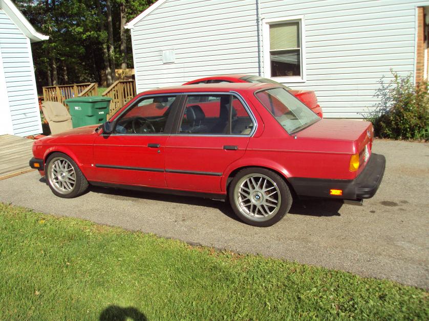

                          I also put IE III springs for ride height a while back.
                          As you can see my diff is leaking on the passenger side. Im debating putting an LSD i have, or just replacing the seal.
