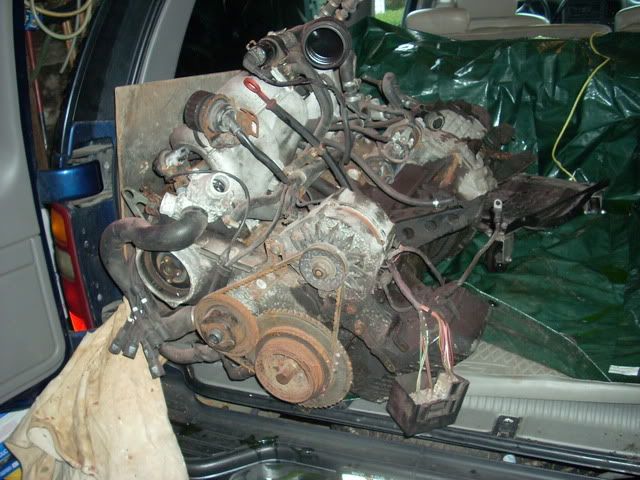

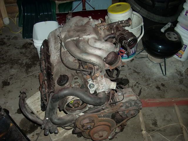

    So Monday i went up there, this is what resulted.

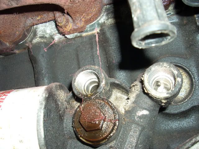

    How fucked am I? Is this repairable, what am I gonna need, i have a friend whos a pro at soldering(His leg in pic)
    I poured half a quart of oil in, just for the lawls, and it started to leak out iof here as I Turned the engine...What hose am i going to need? I didn't start to relize how much this guy ripped off the engine till now.
    Someone bought the distributor off the engine >_<

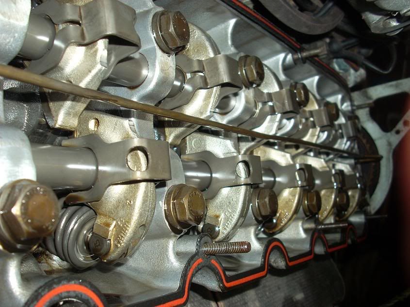

    Took off the valve cover, cleaned it with SOS pads , engine degreaser, and n/c Brake cleaner. Made a slight difference(I'll end up painting it anyways), underneath the valve cover looked perfect, flawless.
    You're probably going to need the other half of the harness.
    Those holes by the oil filter are for the oil cooler.
    Not quite sure where you're going with this though. Are you actually going to get a shell or something?

      a 2.5l would be from an i. if u get a late model eta block you can swap the i head on it and u have basicly just bored and stroked the 2.5i to a 2.7i. there is plenty of info on here about this. i would look into it if you are going to build the motor. other wise i would do a full rebuild on this, it looks like it could use it. and ya you will probly need a new wiring harness. or you can try to find an electrical trouble shooting book and try to fix it. i would def do a timing belt and water pump change. also you should by the gasket rebuild kit, bavauto or autozone has them. for $300 it seems alright.... your going to drop alot more than $300 into it before you get a shell, but good luck

            just get an etorx set. there are 3 different sizes holding the trans on if I recall correctly. I know someone that has a complete late model i wiring harness and most of the parts you're missing. I'll ask how much he wants for the crap.

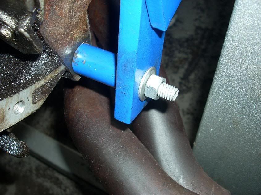

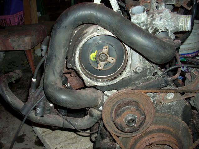

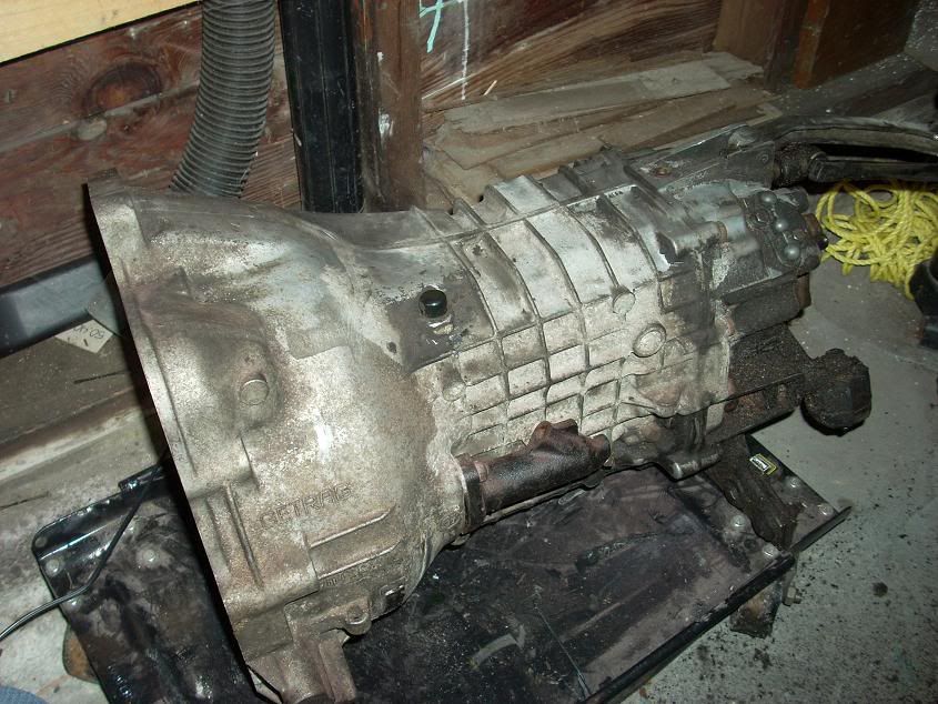

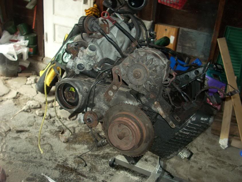

                    Got the tranny off, was a lot easier then I thought. The biggest socket was an E16, i think the next one down is a E12... I bought a Set from harbor freight, along with a breaker bar, I was surprised at how easy the bolts came out with my $8 breaker bar. Harbor Freight is now officially my favorite store.
                    Ignore that black goo, thats from me.
                    After I got all the E-Torx Bolts out and the Starter off, I Pryed it apart with a Screwdriver, it poped right off, except for A 10mm bolt I missed, then it was seperated.
                    it was 11:30, i had to wake up at 5. So i went in and washed up.

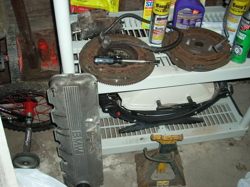

                    Yesterday I started getting the clutch off.Easier then i thought, you need a Hex 5 bit/Socket to remove the bolts. I used a Bit and an electric Impact driver, Didin't feel like going to walmart and buying a Hex set. Pryed right off. The Flywheel was easy too, Just need 2 long Screwdrivers and an 19mm socket, used the impact driver again, easy as hell.
                    Assorted parts....

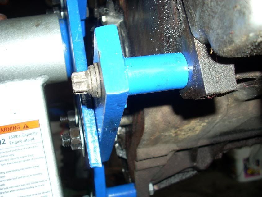

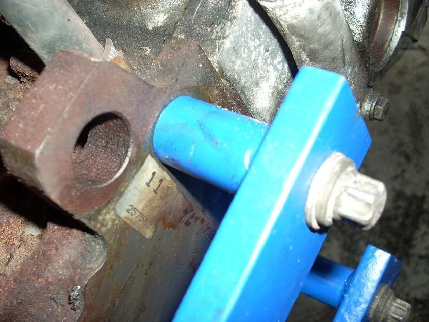

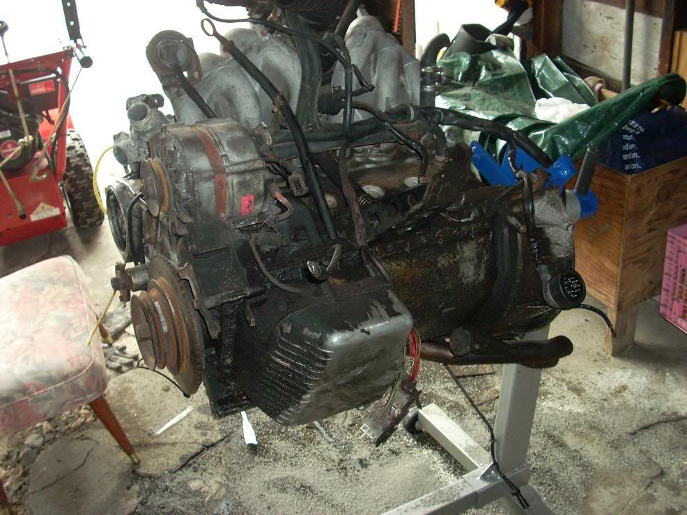

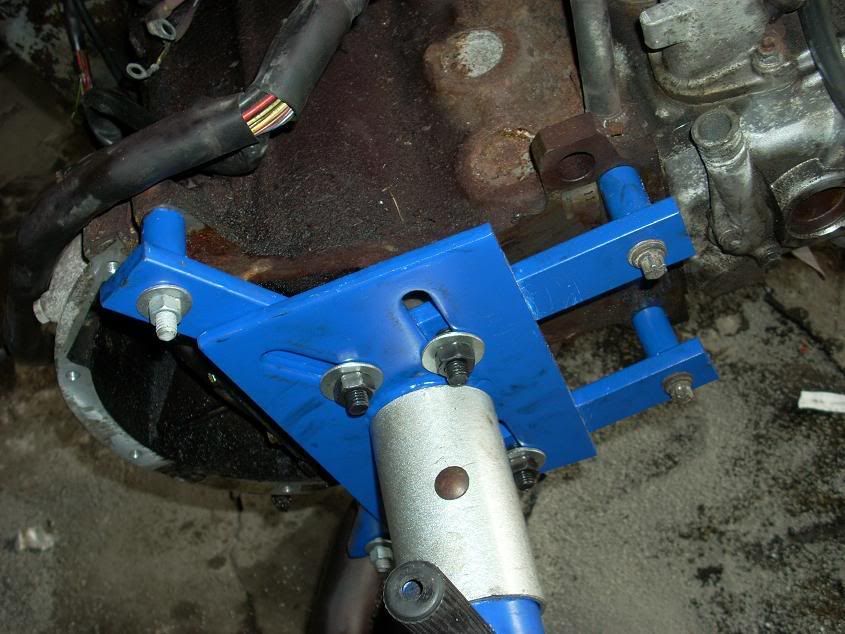

                    Now it was time to get it up on a Stand, I Bought a Duralast 750lb stand from Autozone, doesnt seem to like the weight too much, Seems alittle shaky, i'd reccomend getting a stand elsewhere. Used two of the Original transmission bolts through the transmission holes, Somebody tell me if this is or sint a good idea. I also ran into home Depot at 9:50PM and grabed Galavanized 5/8 by 4 inch long bolts, To go through two holes where the transmission mounted, I Don't recall bolts going through these holes.
                    Pics:

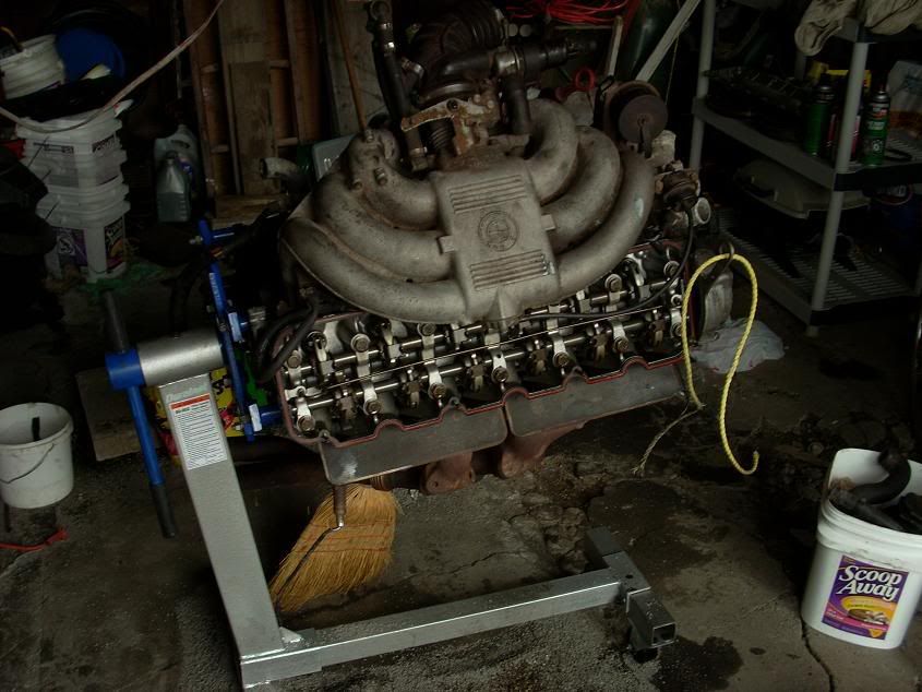

                    Getting the engine on the stand was a fucking feet in itself, we used the latter it was sitting on to raise it up, then attached the stand sideways, then after an hour and a half struggling, slowly rasing it up we got the stand upright, this took three people, we called our freind dan at 11:30 at night to help us out. Due to the engine being sideways, all the oil poured out on the fucking floor out the non-exsistant valve cover, i competly forgot in the chaos there was still Oil in the engine. So 3 bags of kitty litter, a broom and a vacuum where in order.
                    Havn't touched that, valve cover came off to reveal that Cleanliness.
                    Why is the engine sideways? the P/O decided to cut the exhaust off, blocking it from spinning anymore(You can see that in the pics), So i have too unbolt that, then i can stand it upright. That'll happen tomarrow.

                      Man, I wish you would have posted up a want-to-buy ad... I could have saved you a lot of hassle and $$$. I've got a M20 "i" motor with 5k since rebuild with the engine harness and oil cooler for $500 at the shop. Probably could have thrown in a 260 and stuff too..
                      Have fun though, M20's are good motors to have out of the car and on an engine stand. Fun to play with and they are alright to drive too.
