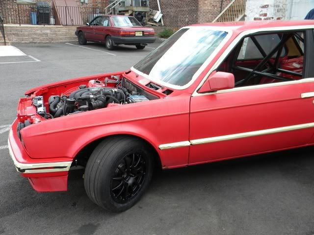

    Yesterday with all the suspension complete and the car on the ground I pushed on it, the car doesnt move, it is so damn solid. Looking forward to getting it back from the welder so we can test drive it in the empty lot next door.

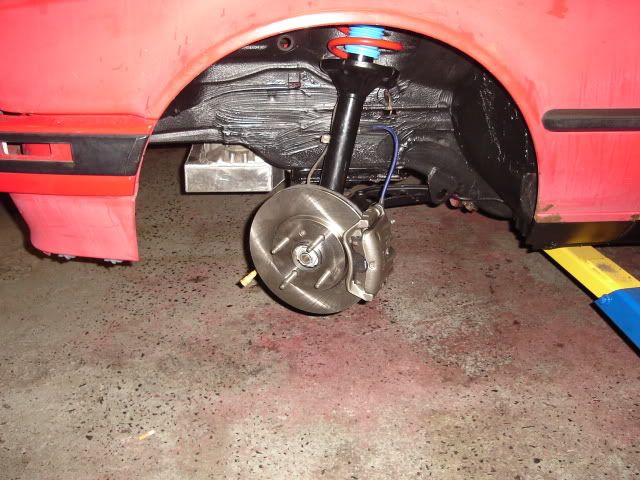

    Thanks guys
    Little closer each day to completion.

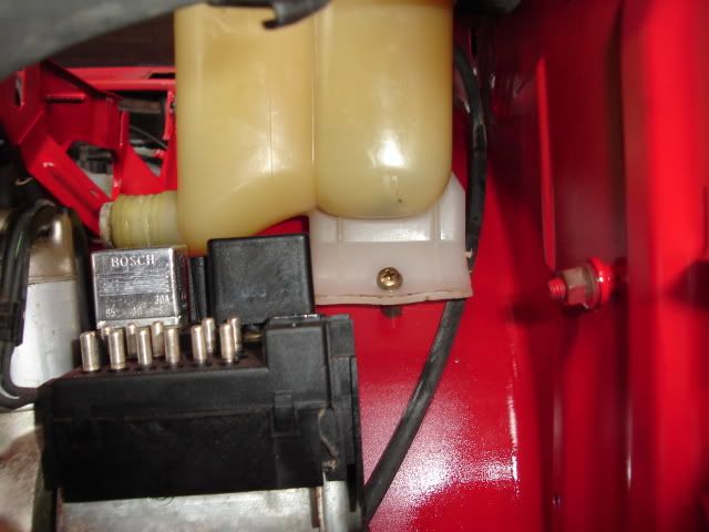

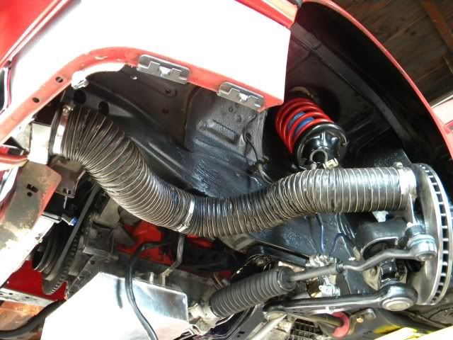

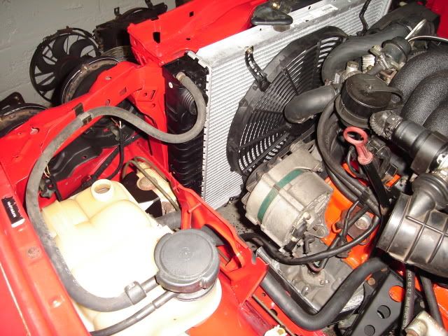

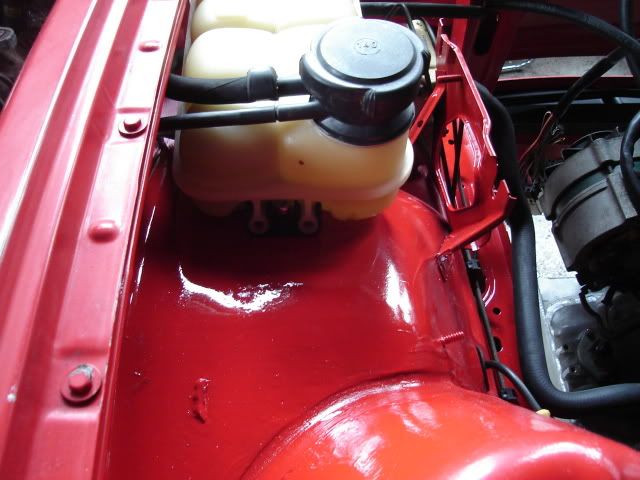

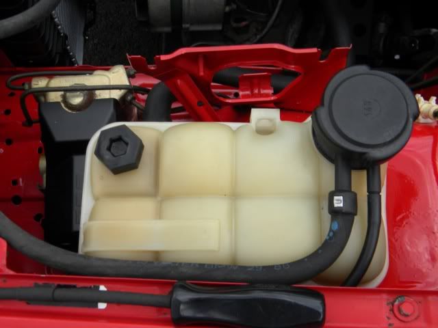

    Mounted up the brake ducting. I used some OEM hose clamps. On the center one, drilled a hole through it and the frame rail and used a self tapper to secure.
    Instead of installing a level sender that won't be used anyways, i went with the cap used on the bottom of an M42 overflow.

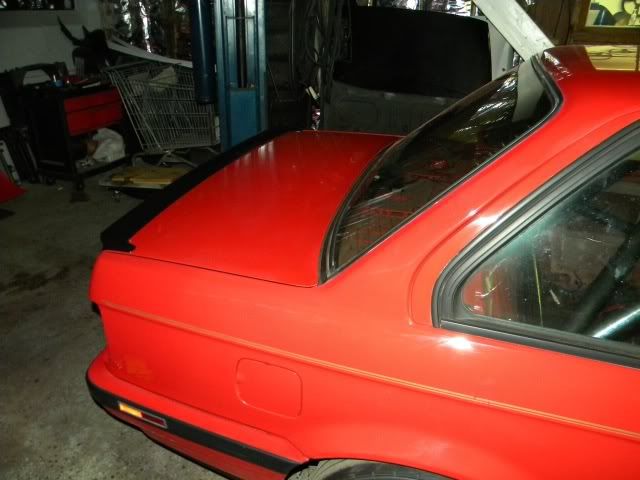

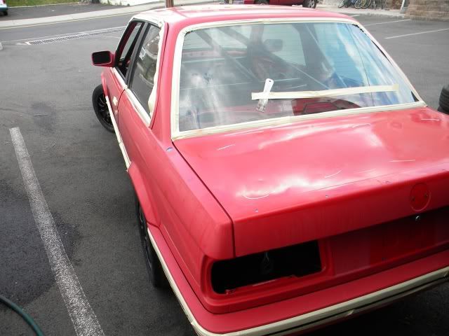

    Our detailer came by today as well. Some before and during pics.

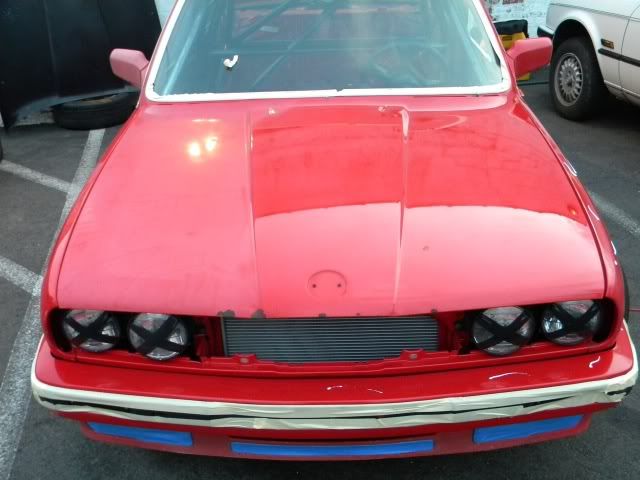

    And here she is at the end of the night. The finish is still pretty rough, but at least its all red and shiny now :)

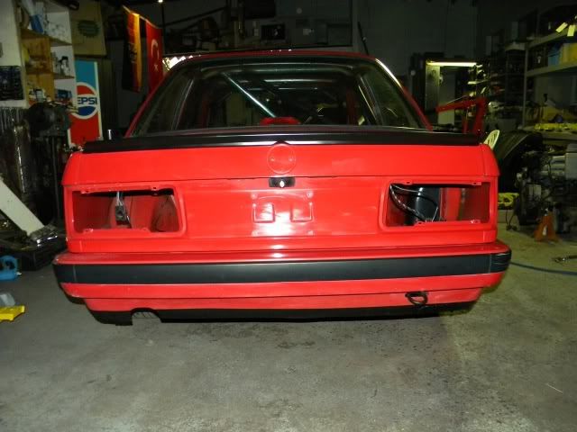

    Kish keeps beating me to the updates with his iPhone pics!

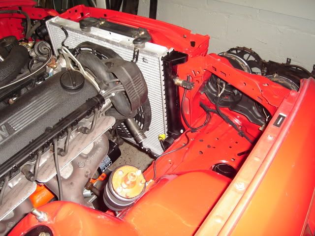

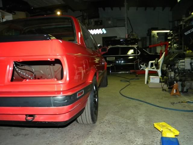

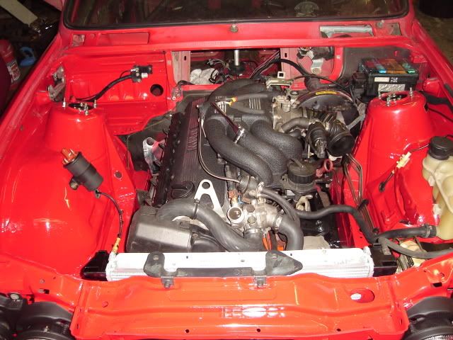

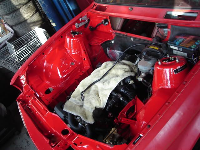

    Levent and I rolling the front end over
    Dropping the shell
    And shes in
    Smile of approval

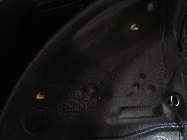

    I didn't bother with welding the stud and braket for the overflow, so i just drilled two holes and bolted them from the wheel well

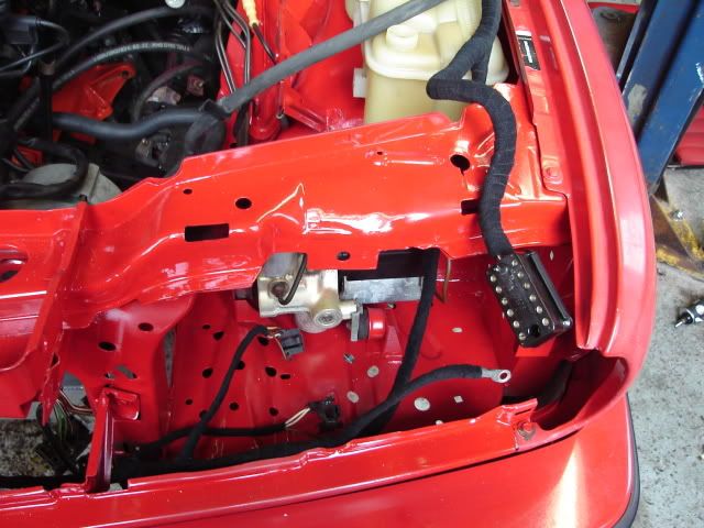

    We have a few rolls of oem fabric tape, so i finished up the wiring, and wrapped them up. Came out niiiice. I still have a hard time dealing with the fact this is a track car and not his DD.
    The rest are just a few end of day pics i took.
    The remainder of the wiring (elec fan, oil temp, oil press, etc) will be loomed and brought inside through where the a/c pipe came in. I also wired up the electric fan using oem bmw connectors, so if the rad ever needs to come out, we can just dissconnect and pull it out as a whole.
    Also, our detailer will hopefully be by this weekend to turn this pink back into red :)
