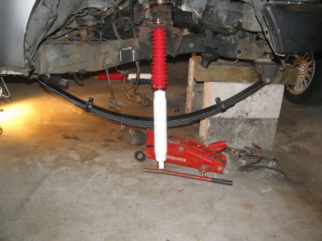

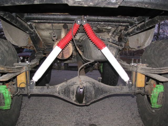

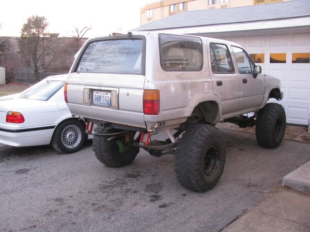

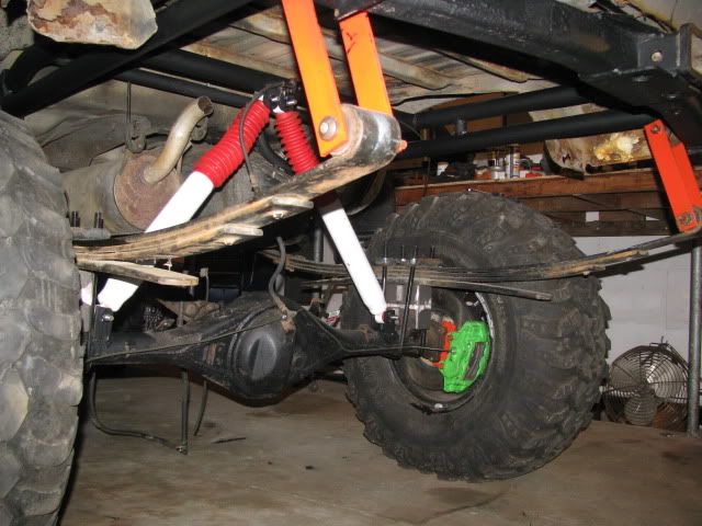

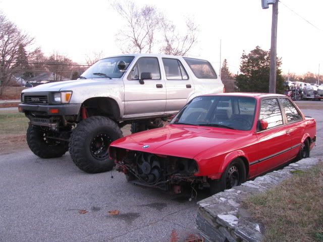

    Its a 1990 4runner v6 that i picked up for 100 bucks. Its on 36's with a solid axle swap from an 85 toyota pickup and an 8inch lift. Rear springs are from an 03 dodge 1500 and it has a rear disc swap with toyota 4 piston calipers and FJ vented rotors.
    And how it was made

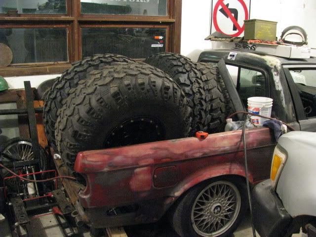

    E30 truck holding the tires, 36x13.5x15

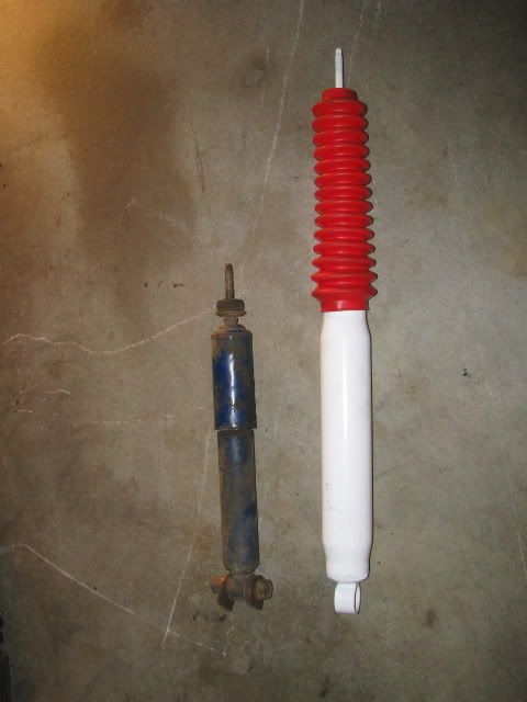

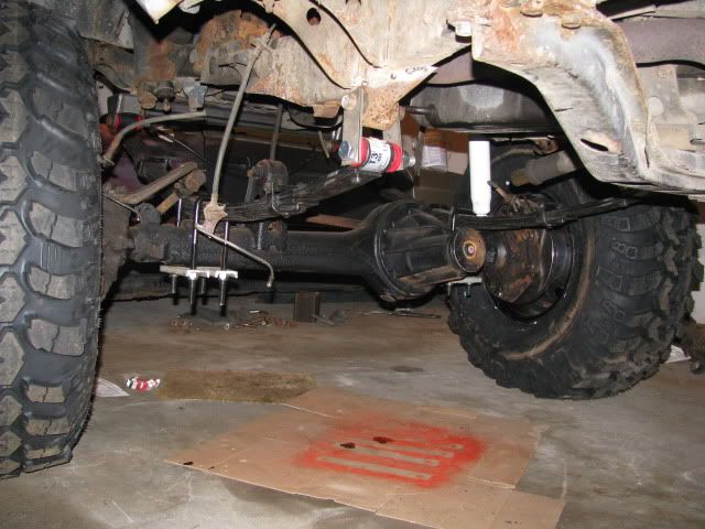

    old front shocks vs. new

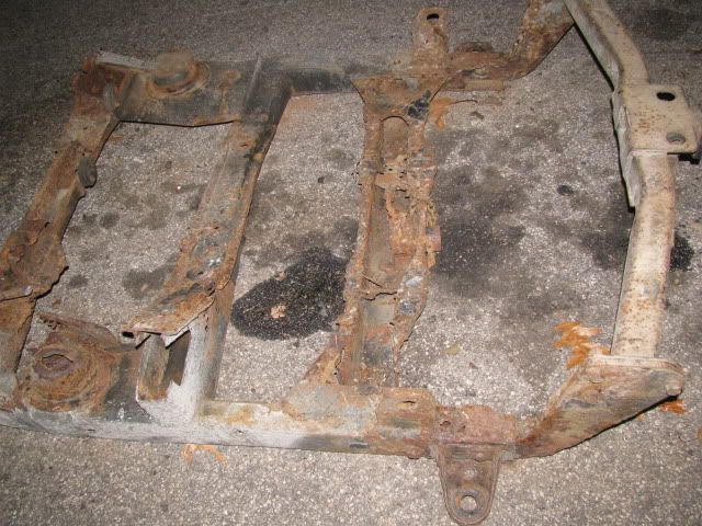

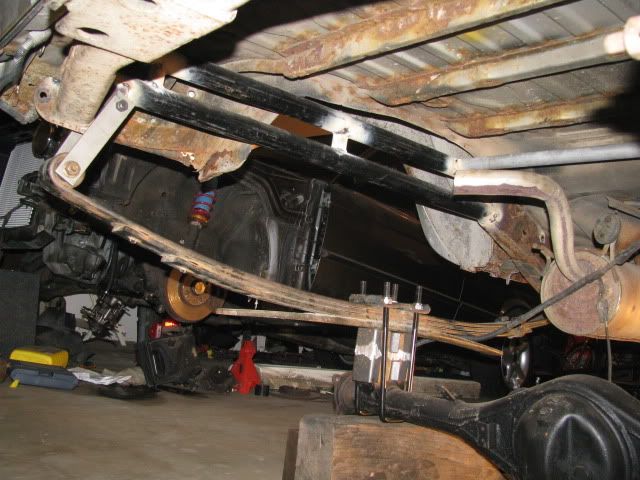

    The rusted out ass end of the frame.
    old axle out
    new ass end
    Rear disc swap

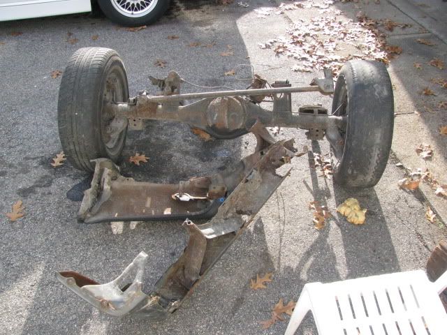

    Old front end

    New front end

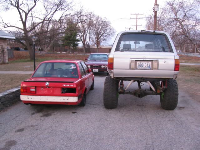

                There is no full width toyota front axle. I got a matching width rear when i bought the front as to not need to regear mine. I'm running 2in spacers on each corner so its slightly wider than the wide trac toyota axles.
                Its not too top heavy at all, as long as you don't drive like a jackass on the street its fine. I still have to cut the front fenders, at the moment i have more flex than i can use.
