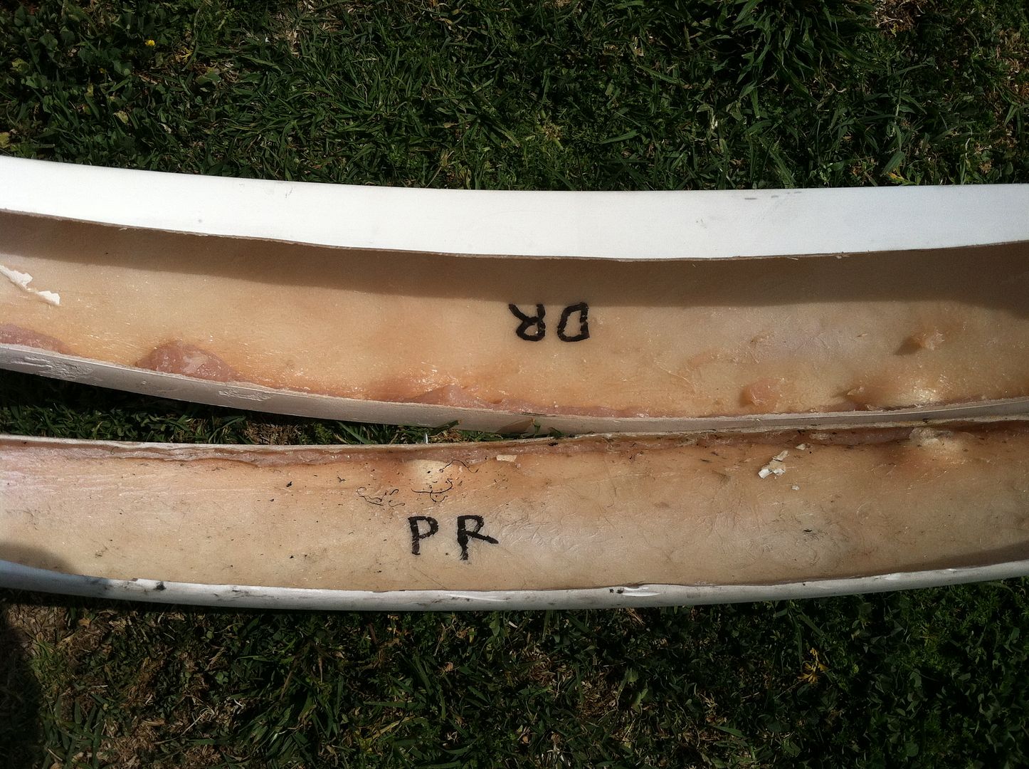

        They are late model esm flares. Hence the cutting.

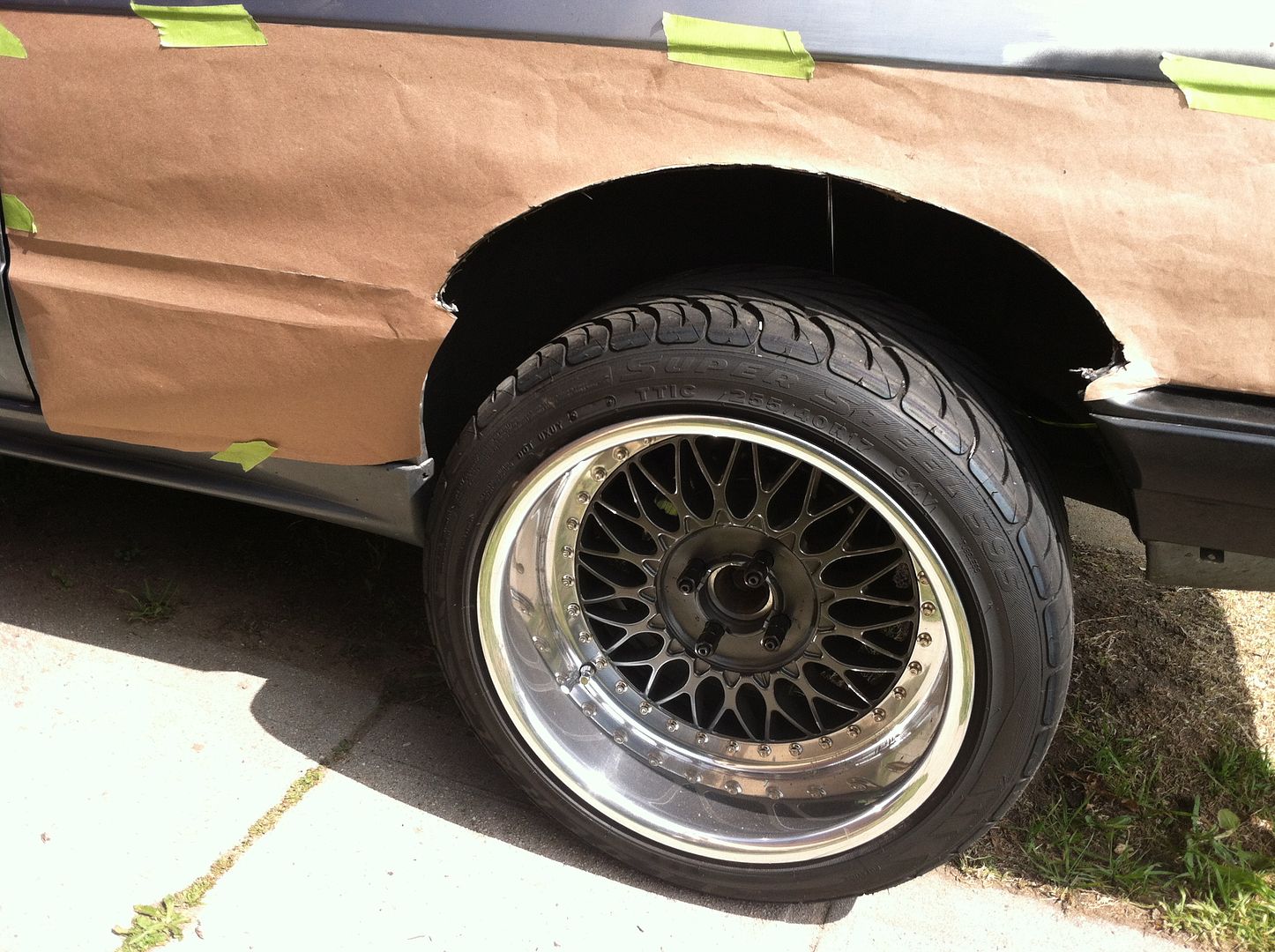

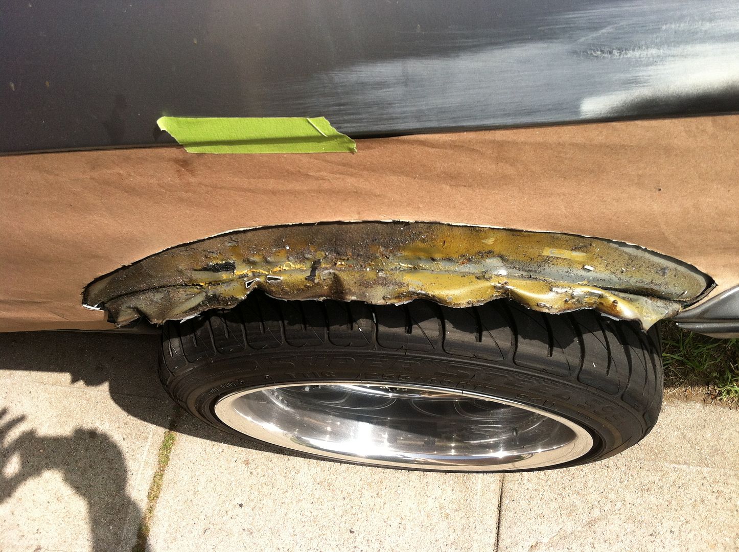

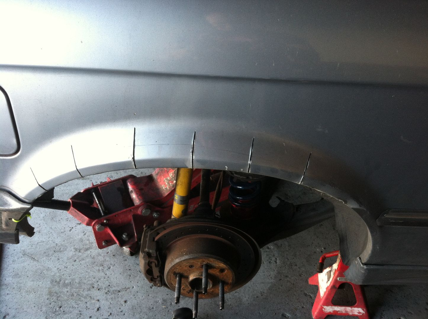

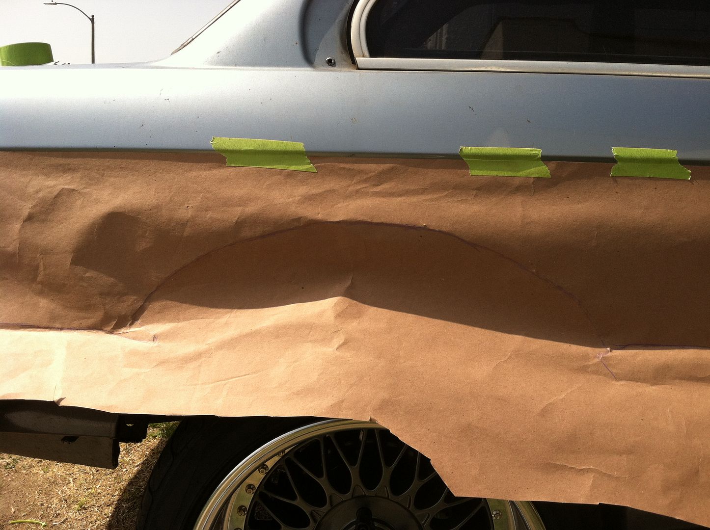

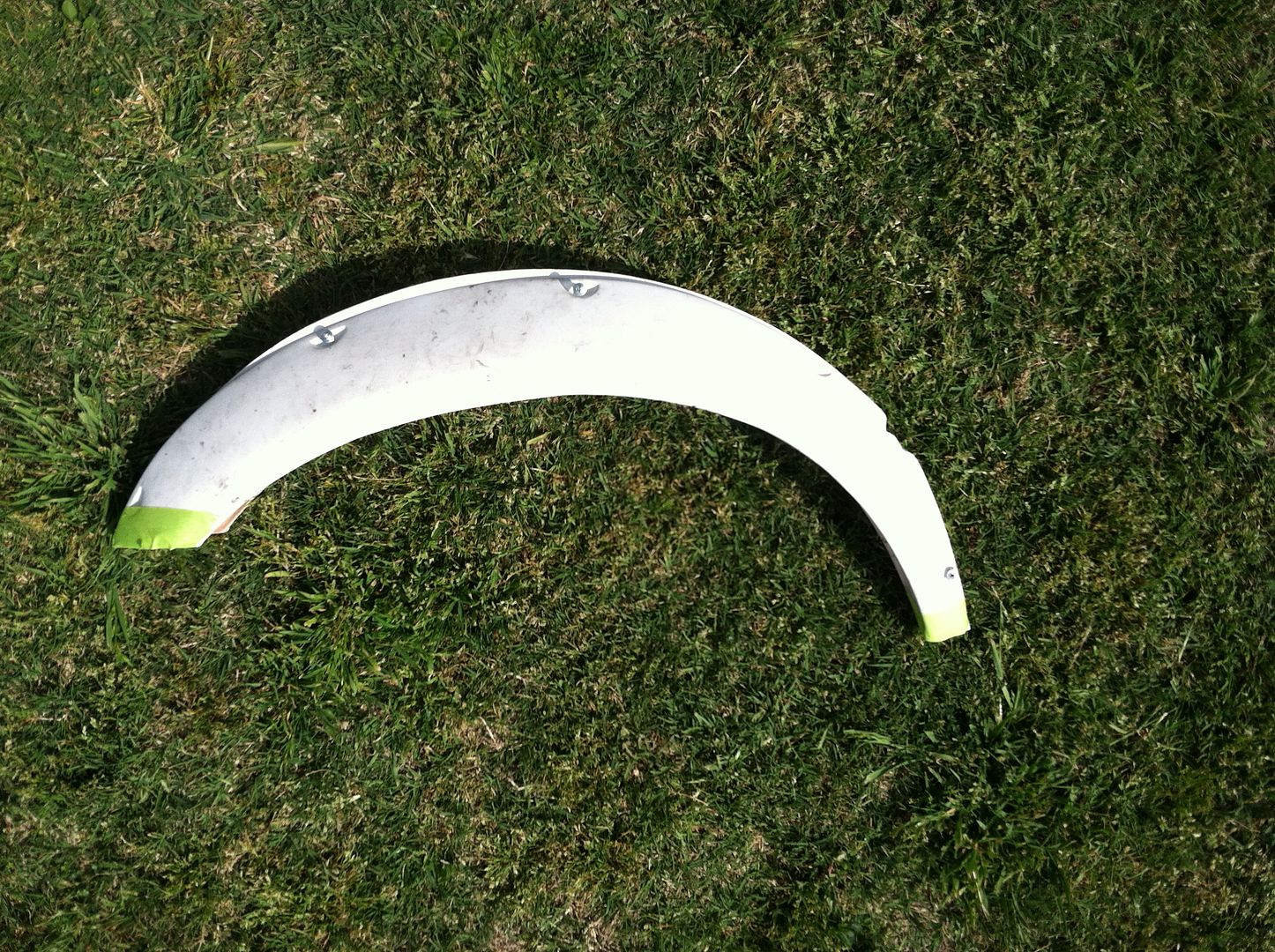

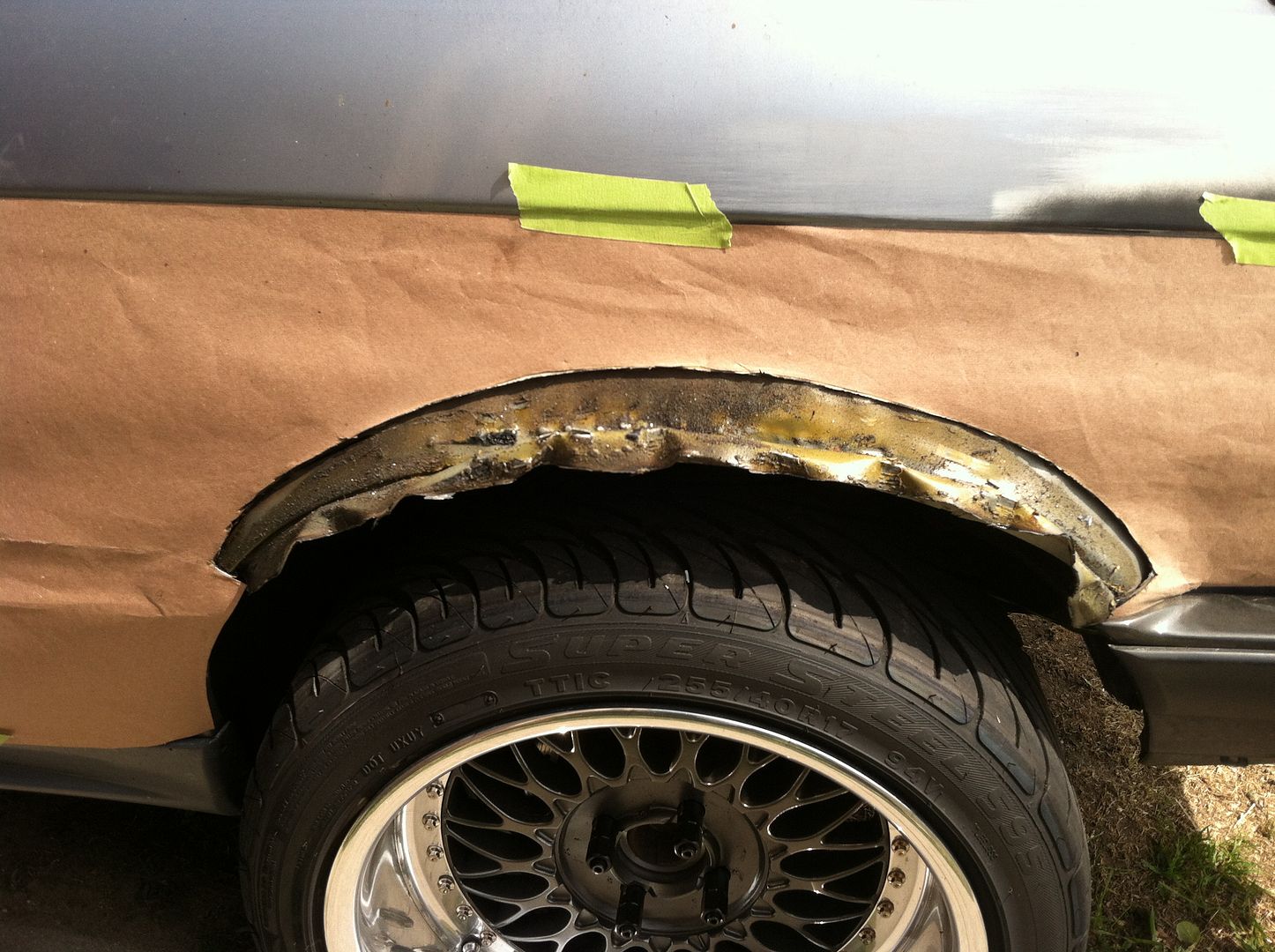

                      So after lots of messing around cutting and welding with out a clue to what i'm doing, this is how the first quarter panel came out. If your wondering why so much abuse its because i'm installing late model flare on to my early model. The flare won't sit flat on the the sheet metal so i had to cut and hammer little by little until could see how they would sit and how much material needed to be removed.

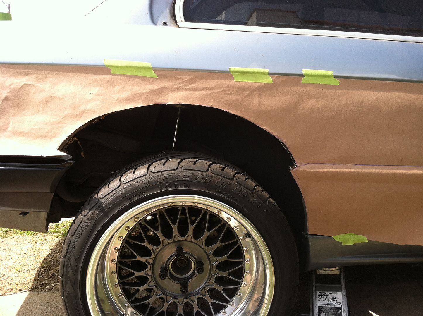

                      Then i made a template using some construction paper thats used for laying on the floor so you don't mess up your carpet during construction.
                      Transferred it to the other side and cut away the outer skin and bent it back. Then i cut out the inner fender.

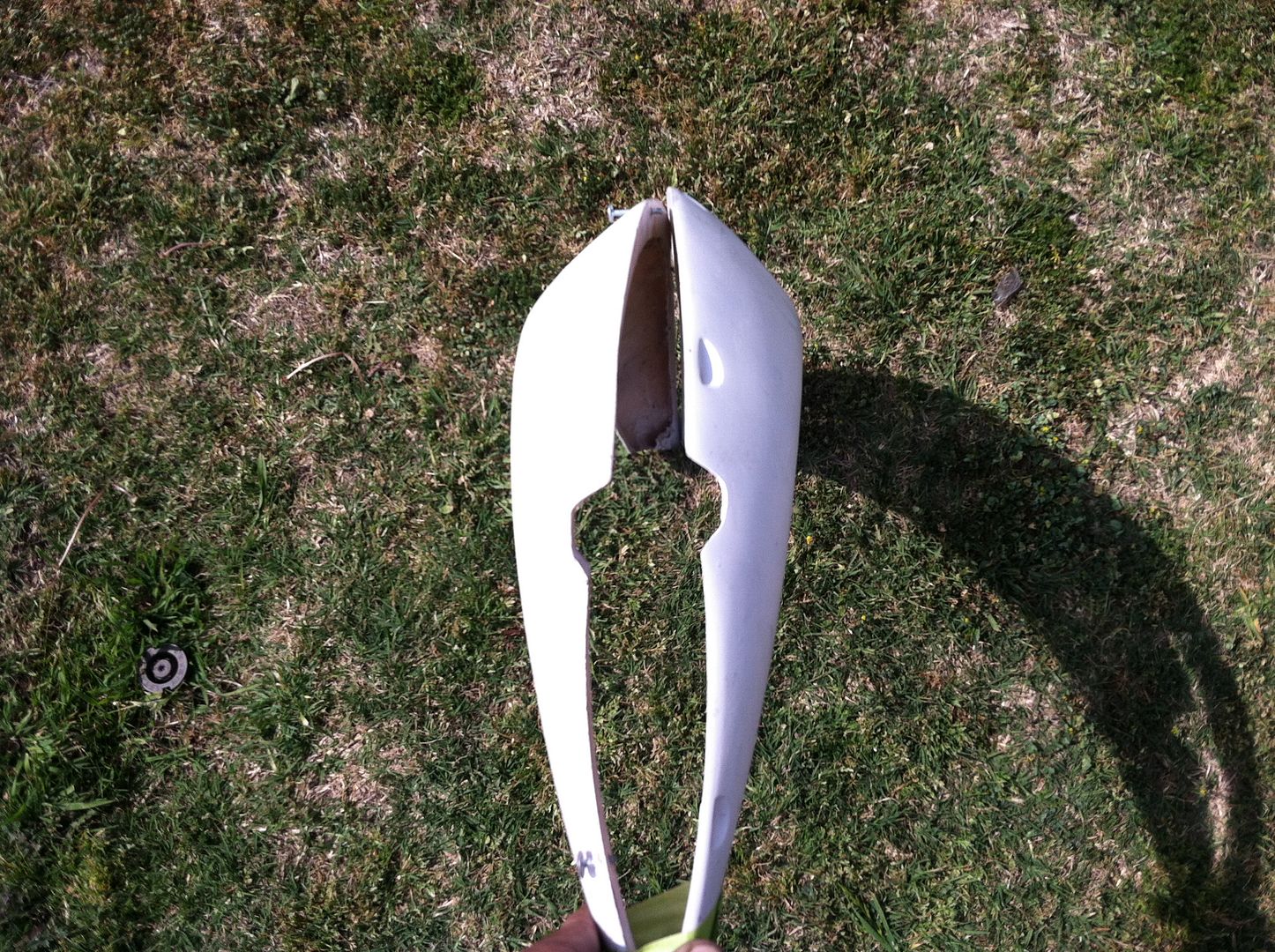

                      Then i mocked up the passenger flare and the molding strip did not line up. So now i'm thinking great, my template was a bust. But then i taped the left and right pieces to each other and the photos speak for themselves.

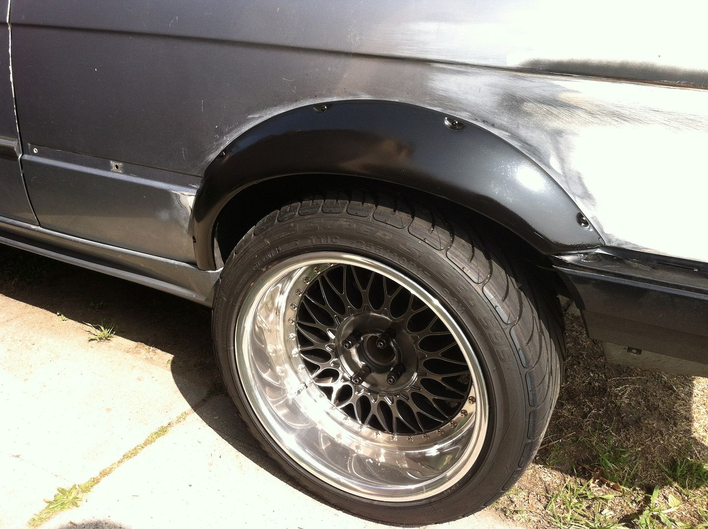

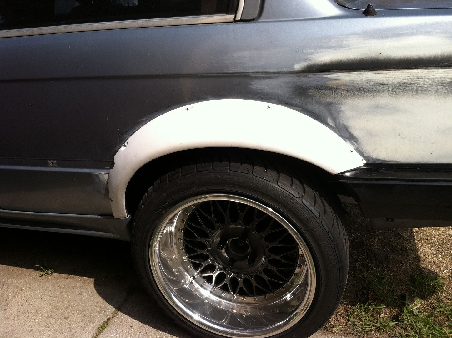

                      Since i'm planning on shaving the trim its not that big of an issue. I then proceded to trim the lip. Not sure why they were made with a huge inner lip if they are intended to allow wider wheels and tires

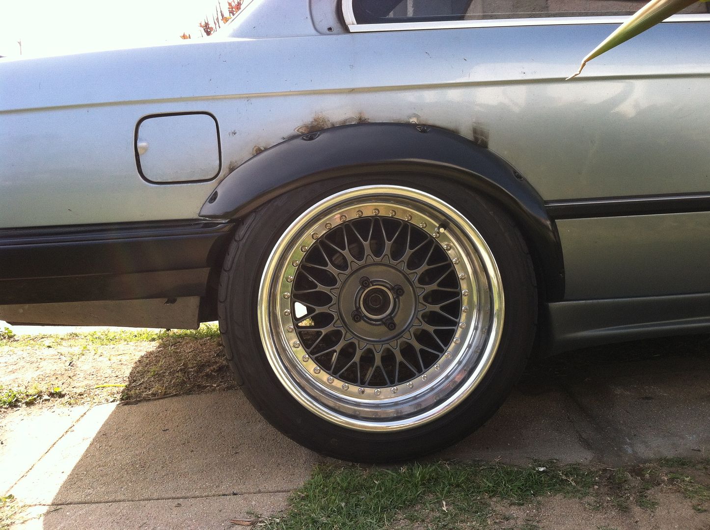

                      All mocked up
                      Decided to paint them black so they don't stick out so much

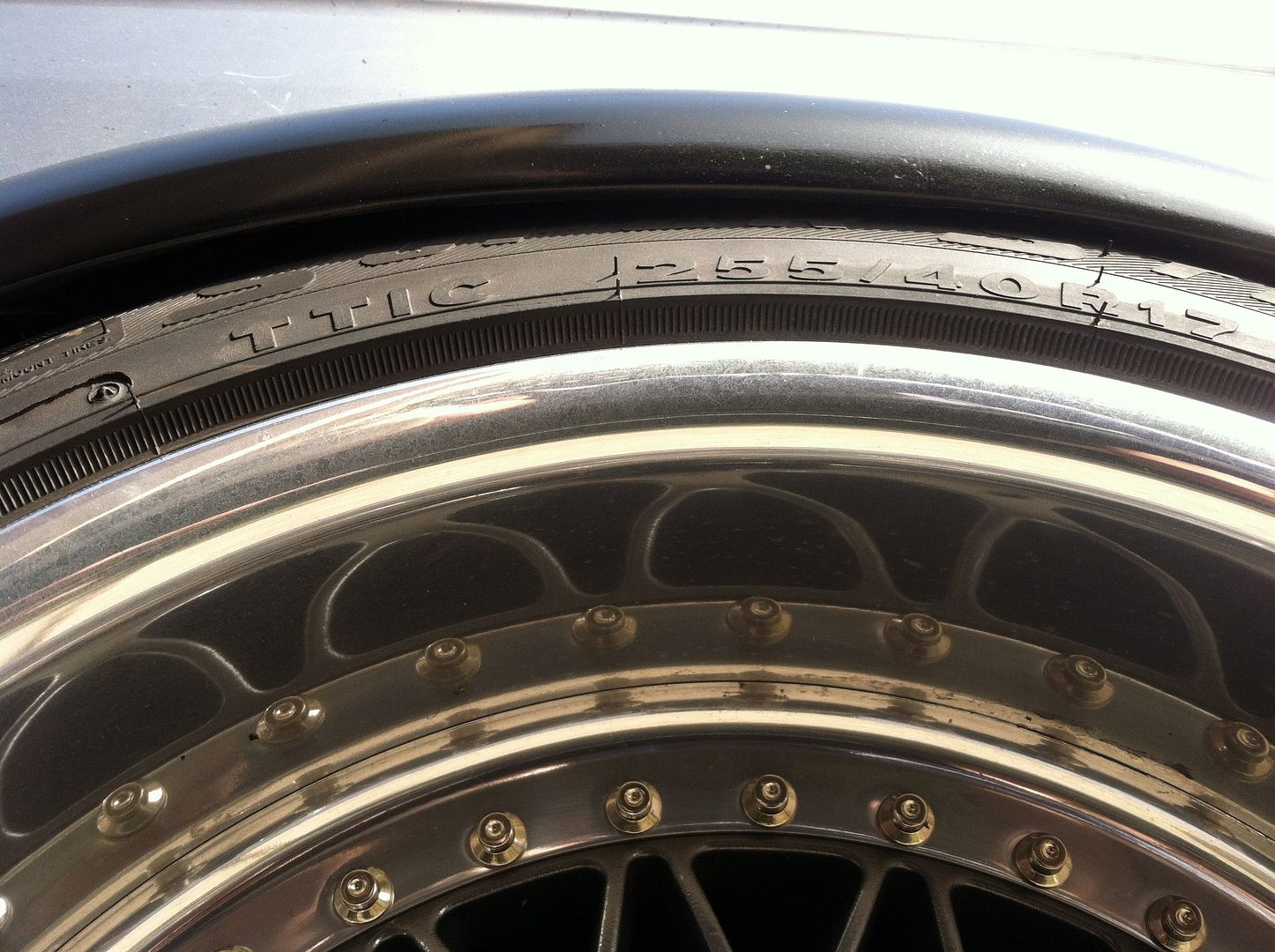

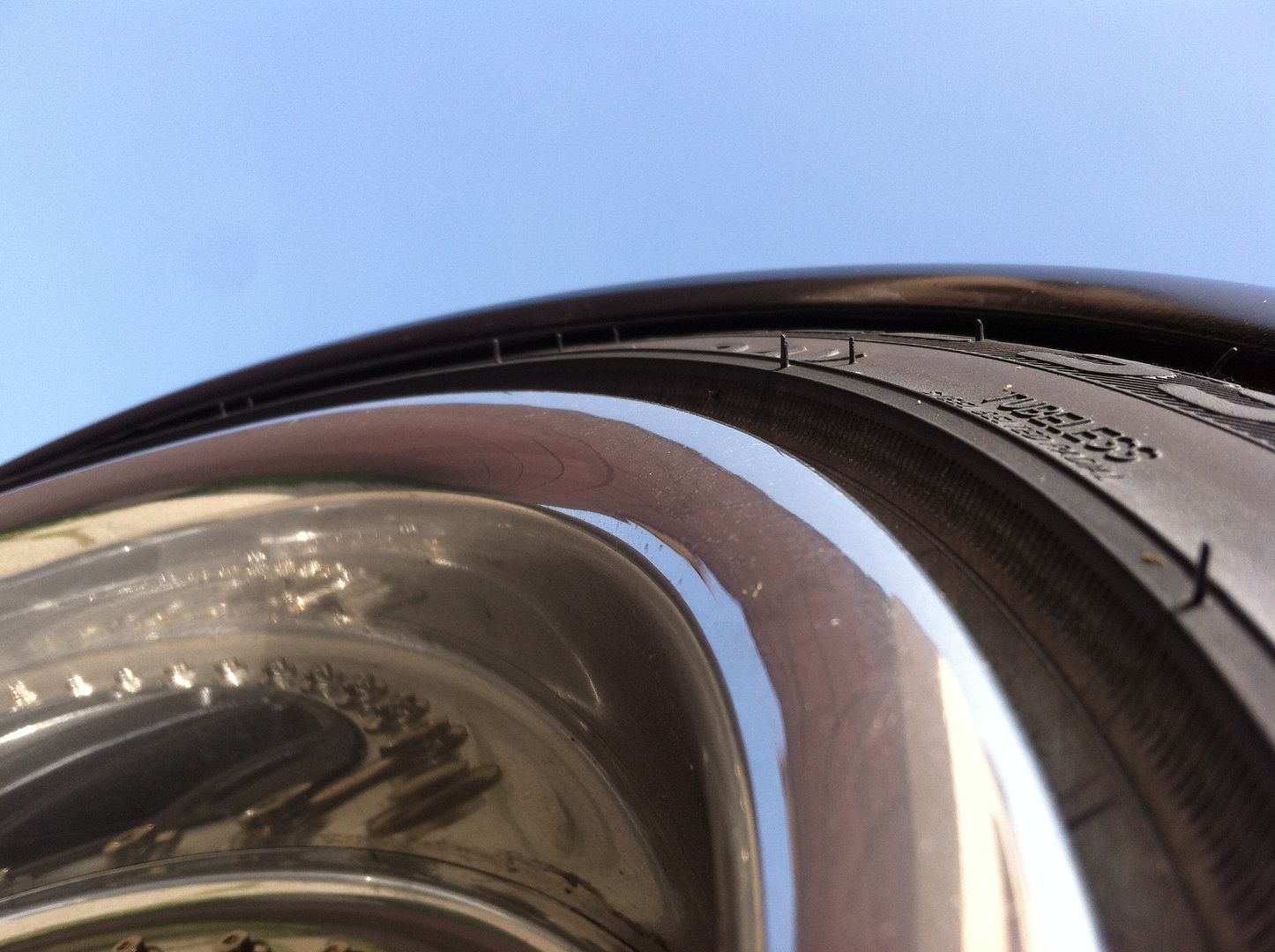

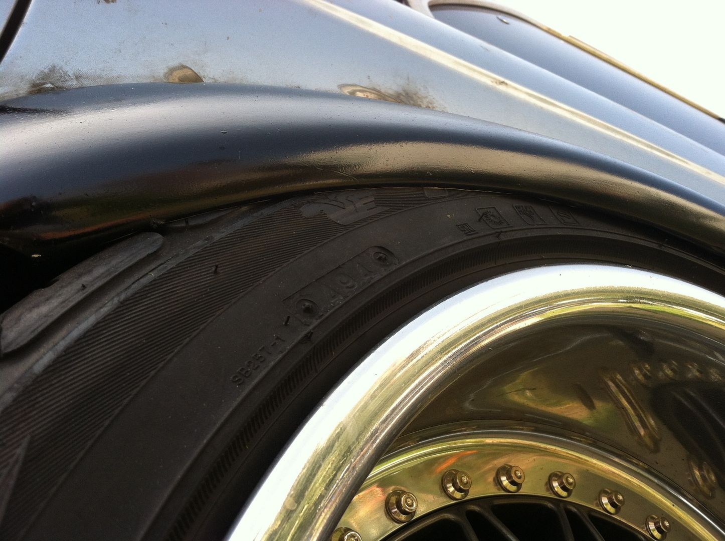

                      And with my coilovers on the lowest setting with new factory upper spring pads. The rub like crazy. I wish the lip did not taper in. If it was flat or tapered out i could easily drive around dumped. I'd need to step down from a 255 to a 245 or add some more fiberglass to space it out more.

                        My dream is to fit 275s for ultimate traction.
                        mtech1/2jzgte/r154/275tire
                        function>form
                          275 Falken 452 vs 255 Federal SS 595

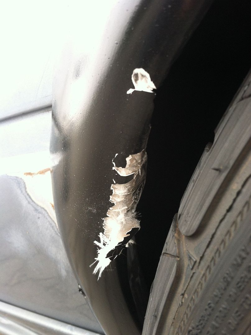

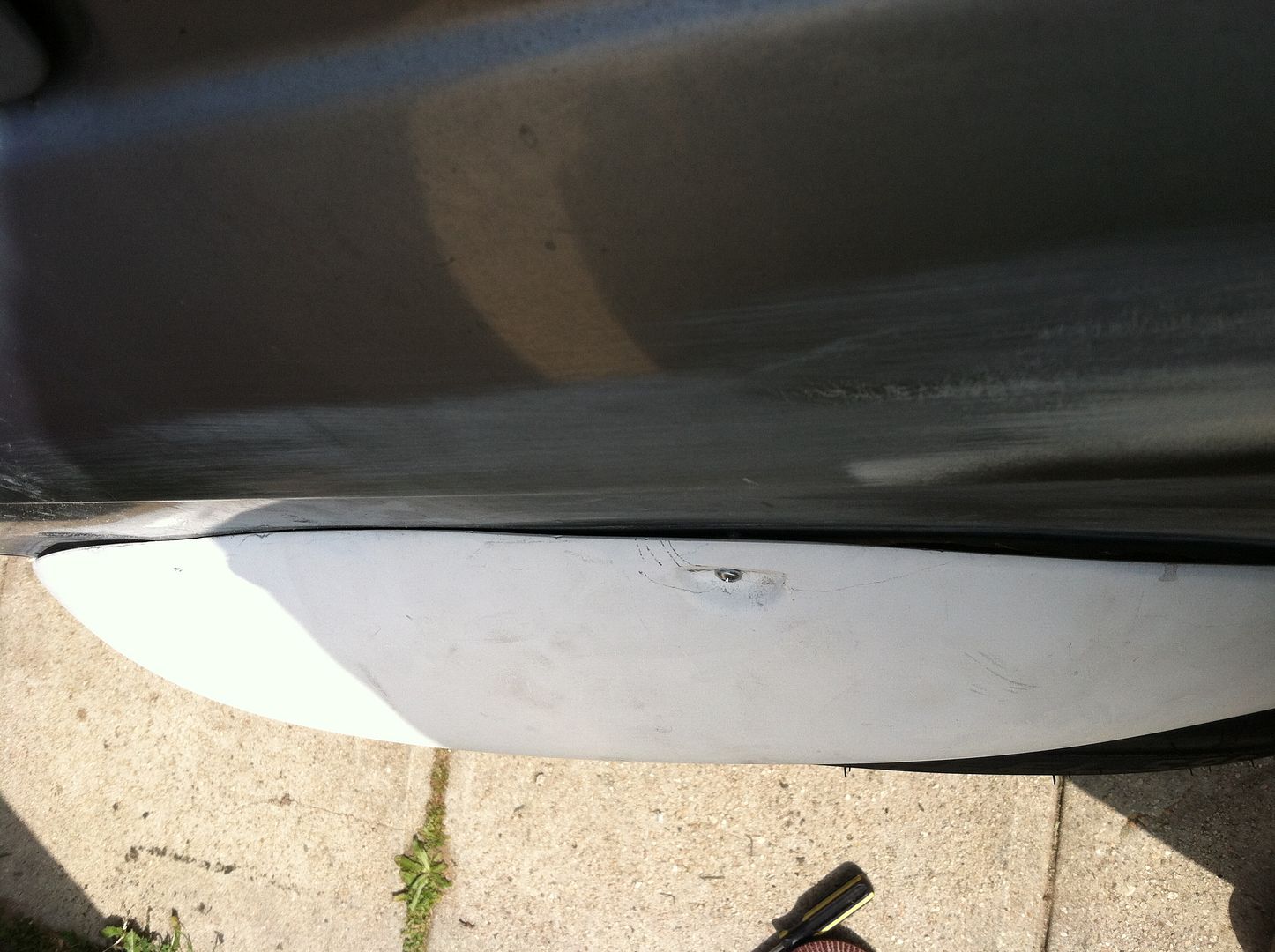

                              Well i thought i had them pretty well trimmed but a big dip proved me wrong
                              www.gecoils.com
                                Doh!
                                Man, I'm really second guessing putting these on my car.......
                                Maybe it's time to look at some KAmotor's extra wides.....
