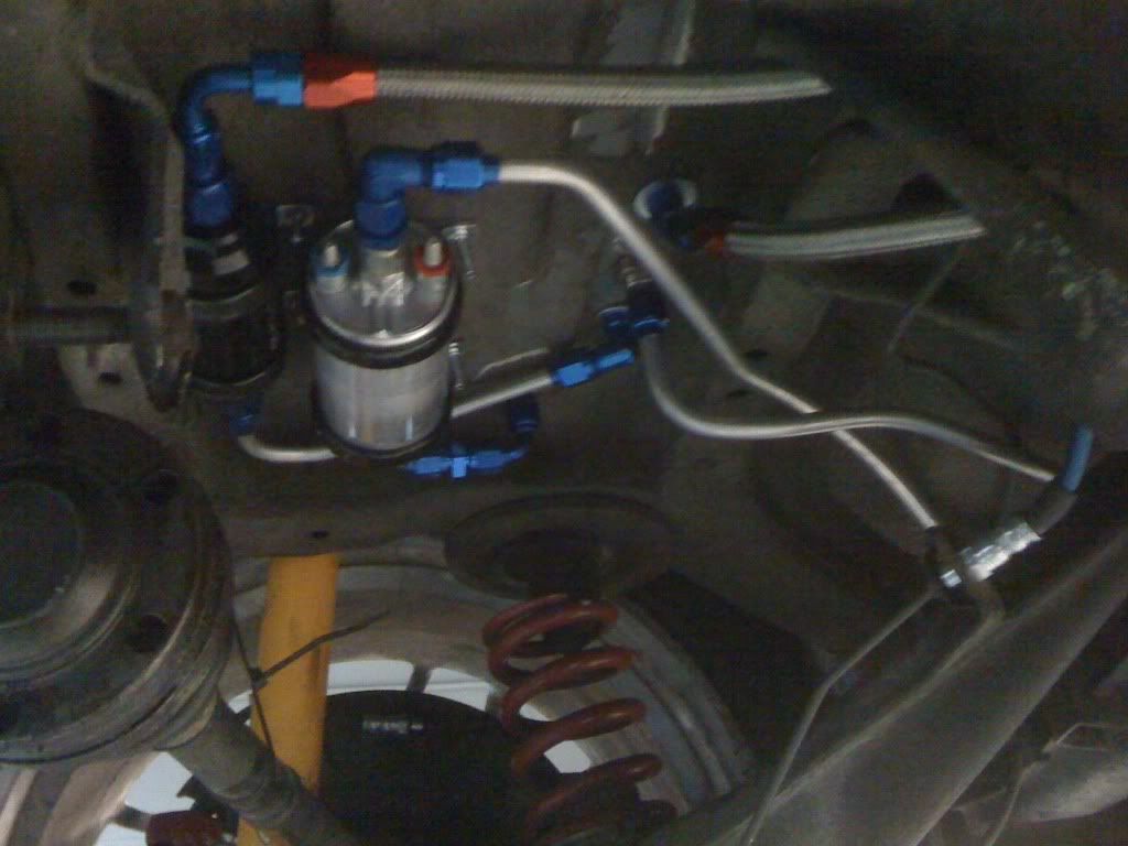

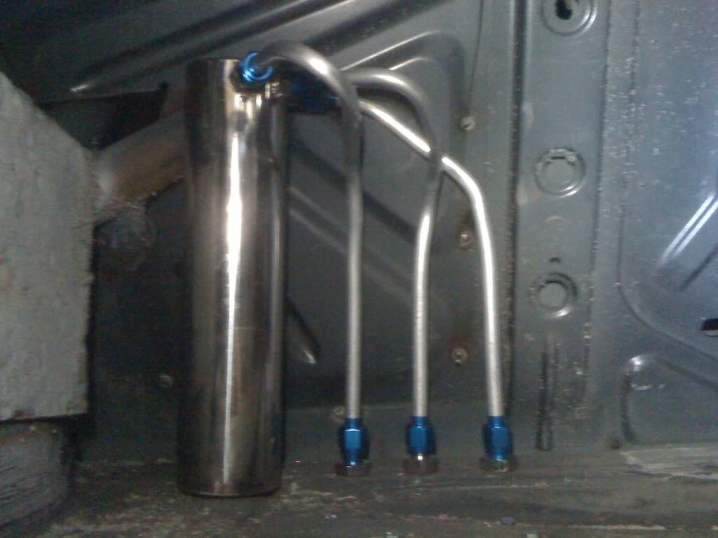

        Here are some pictures of my fuel setup. It's not 100% complete, but you can see what I'm doing. I am running the stock low pressure transfer pump in the tank, to a coarse filter which feeds the surge tank located in the trunk. From the bottom of the surge tank, the Bosch Motorsport 044 pumps through a fine filter, and then up to the rail. The return from the FPR goes back into the surge tank, and then the overflow from the surge tank returns to the tank. It should never starve with this setup.

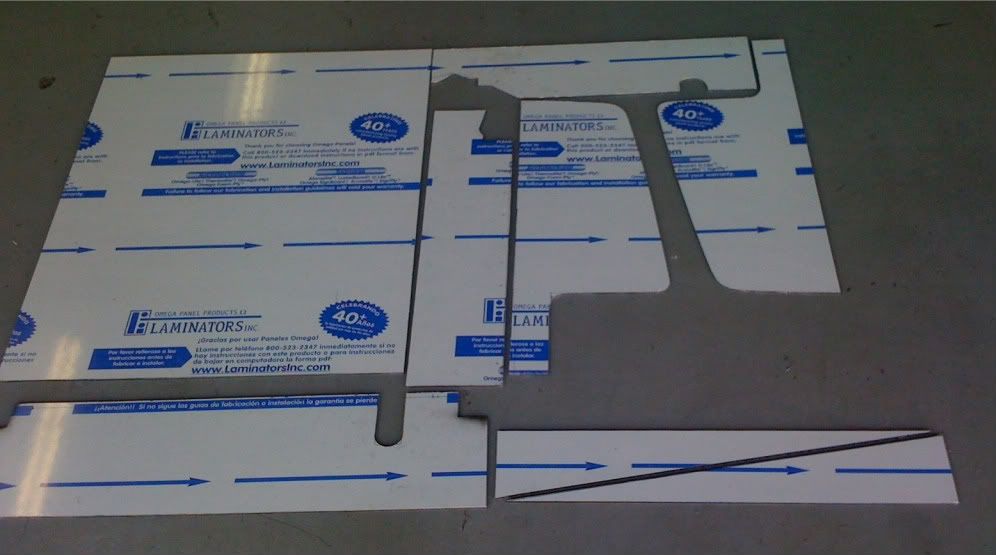

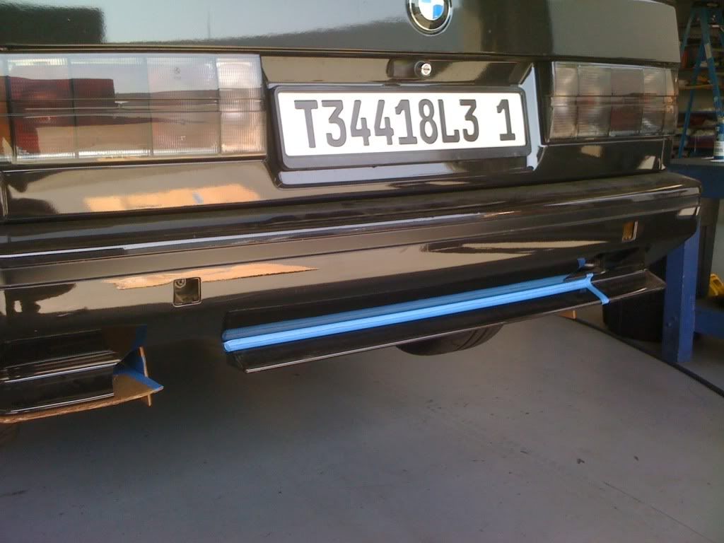

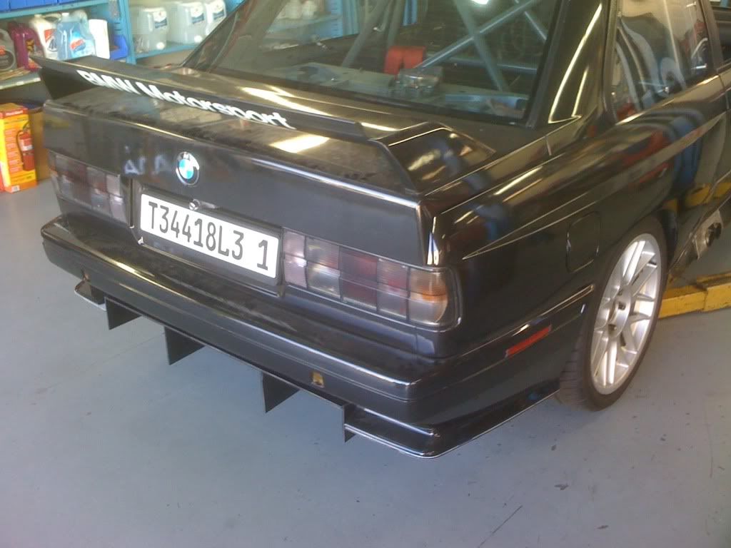

                  So, my progress has been slow, but I finally have some more pictures to update you guys with.
                  Made my rear diffuser. Still have some finishing touches left to do, but the diffuser is basically done.

                    I'm assuming the Mike D setup used the 5/8" pistons is that correct?
                    Diffuser looks good! And the fact that it stays somewhat subtle until you look under is awesome...well done!

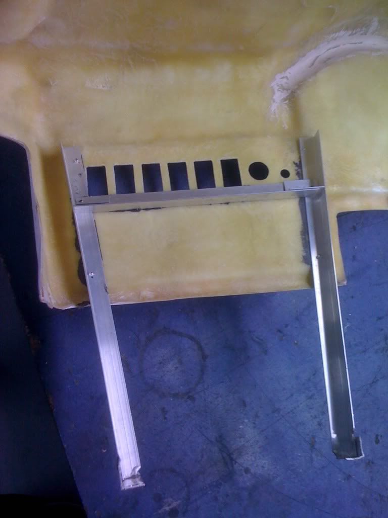

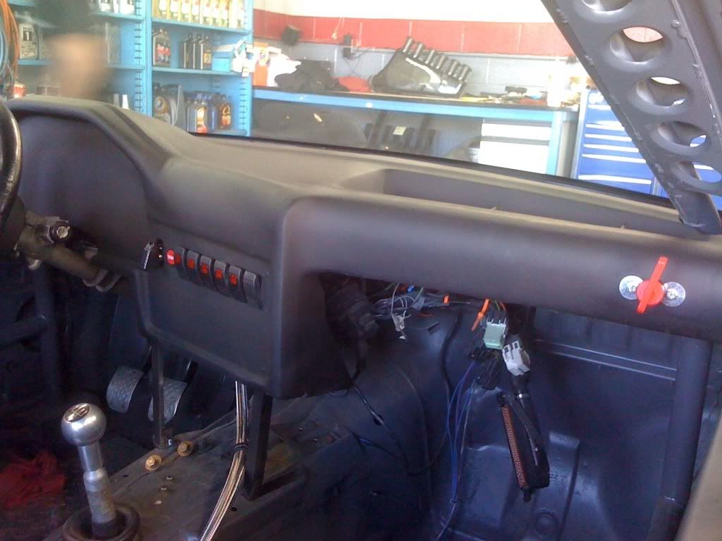

                          Here's a pic of my fiberglass dash. I threw a quick coat of black primer on it. I will make the cutout for my Stack dash display once I have my seat bolted back in so I can get it positioned perfectly. Once I'm done with that, I'll paint it with a textured black paint.
                          Here is how i braced the back of the switch panel:

                            Dash looks much cleaner than I had expected it to look. Excellent job...very clean for a track car.
