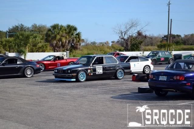

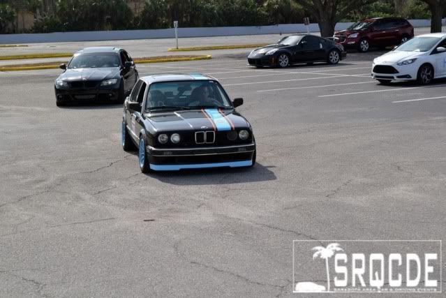

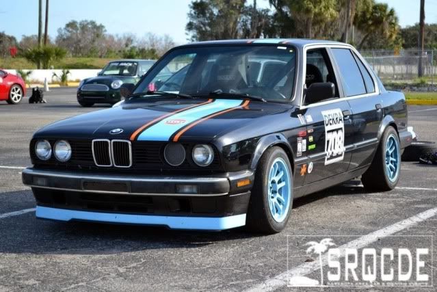

    A few candid shots from a recent autox
    The first real test of the GC suspension and new brakes is happening on Saturday at the first Sebring DE of this year. Just got the car back from alignment and corner balance. Current total weight is 2630 lbs. not bad.
