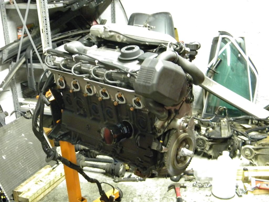

      Today was a wash due to all the snow. Here's the progress so far.
      New Guibo, bolts, and CSB
      Input, output and selector rod seals, and throwout bearing. Little tip I learned, you can just double up the selector rod seal. Just tap it in on top of the old one (as long as it hasn't been done already). Tightens it up a little bit too.
      That new foam bushing tightens up any slack in that joint as well.
      More to come over the weekend.
