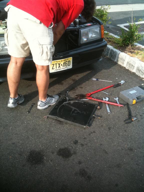

                      (01) Removed the SLS pump and installed a custom block-off plate in its place. Decent amount of weight lost from the very front of the car. More importantly, we got rid of a major source of drag: the SLS pump is driven by the exhaust cam! Should help the engine spin up a bit more freely.
                      (02) Removed the a/c condenser. Couldn't remove the compressor yet since the accessories run off of a single serpentine belt. Need to figure out what belt length we'll need after deleting the compressor. Once that's all done, we can pull out the remaining a/c pressure lines.

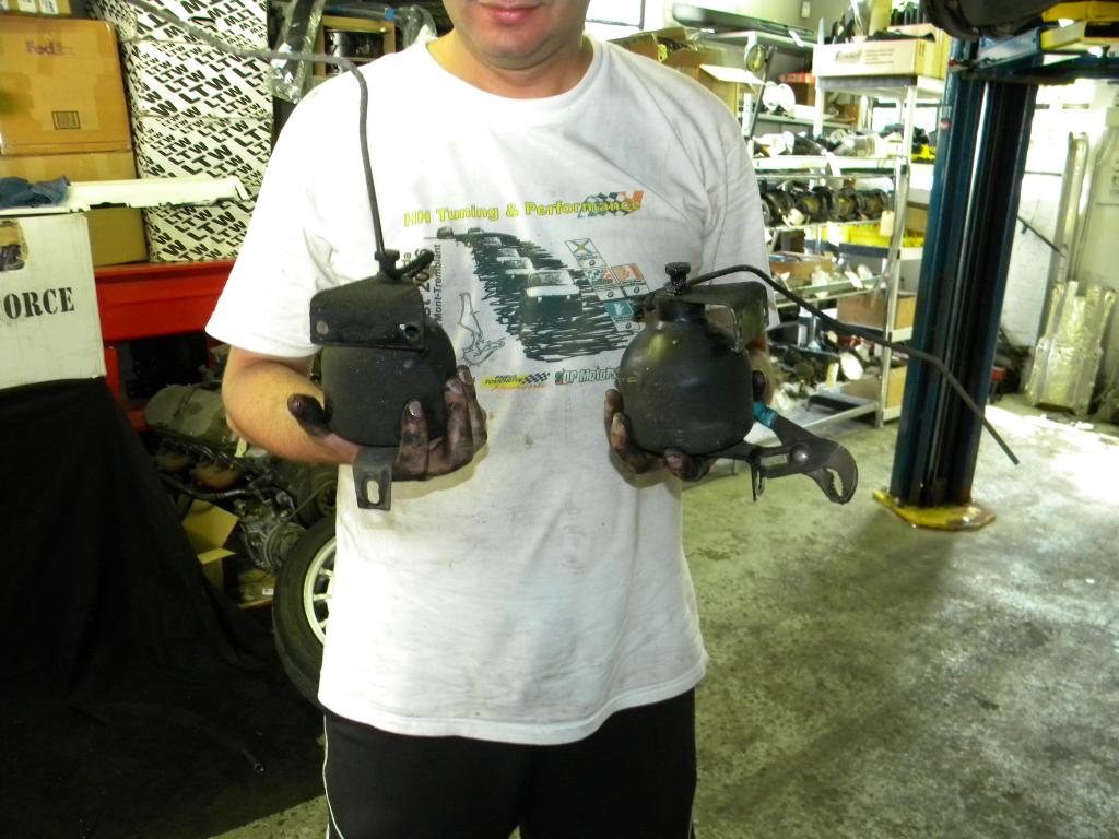

                              Quick update
                              Unfortunate the car wont be here for Gfest but we made good progress yesterday with the big brakes and the sways.
                              We also removed the useless self leveling suspension aka big balls.

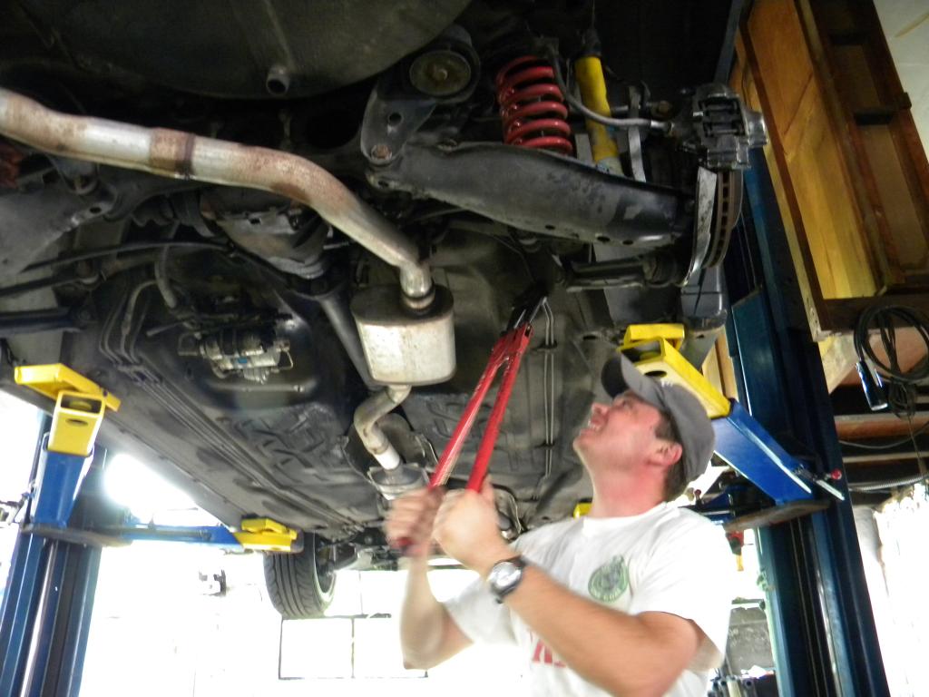

                              • ZM Blue Devil
                                • Dec 2006
                                • 13836
                                #90
                                Joy of removing useless lines.
