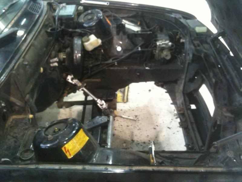

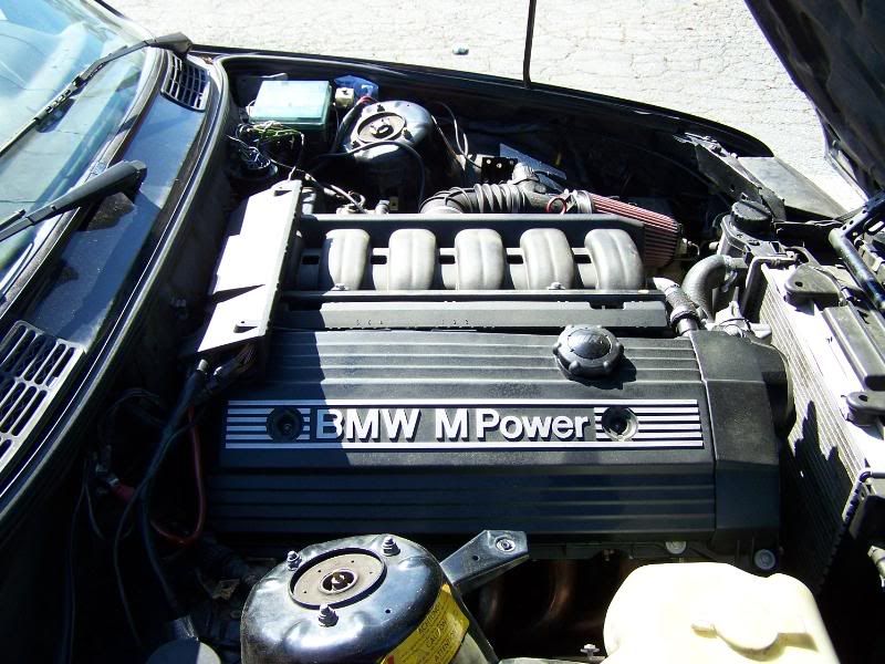

    Hey. I snapped a couple of pictures of my E30's together at work Saturday before I removed the S52 from my old '87 eS. I've had that motor for a bit over a year now and it's time to try something else.. Usually I have a bad habit of getting rid of a car within a year of buying it, but I'm sort of attached to this old chassis. I thought I'd start a project thread (for once) to keep track of what's going on with the car. Even if nobody cares, it'll be easier for me to look back through everything.
    Here are my cars in front of the shop where I work--
    Schwarz '87 325eS and Diamondschwarz '85 eta-
    S52B32 engine in the car-

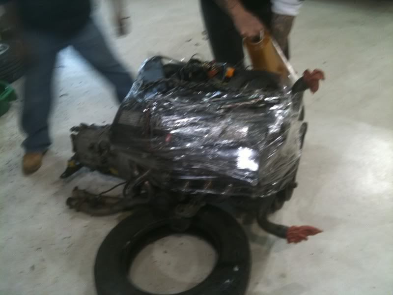

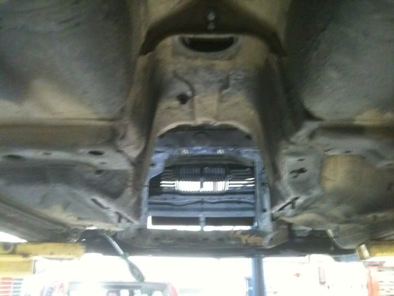

        S52B32 engine on the ground and halway through packaging for the long trip to New York--
        Empty shell--

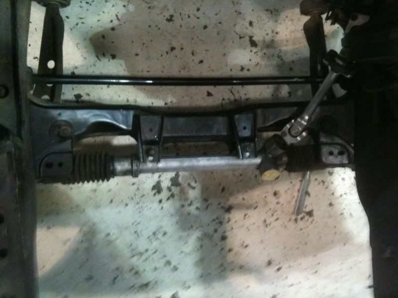

        Since we dropped the suspension with the motor and trans, I thought it was a good time to weld in the TMS subframe reinforcements that I've had around forever. I also removed the old power-steering rack (which was being run as a non-power rack anyway) in favor of a nice clean Euro non-power rack that I've had in the garage for a year or so.
        Different racks. Added fresh tie-rods to the Euro rack--
        Different linkage--

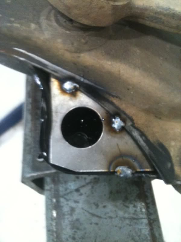

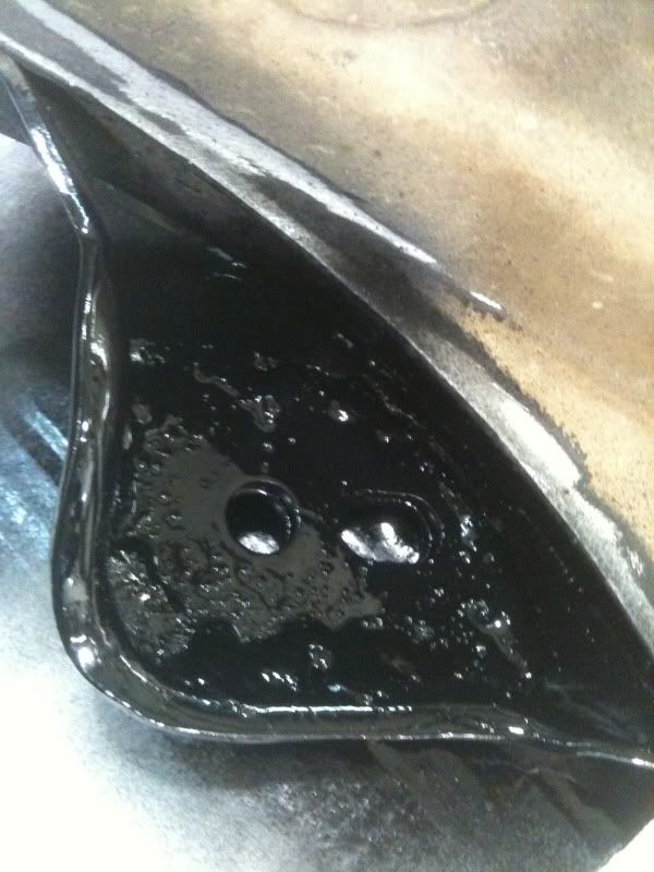

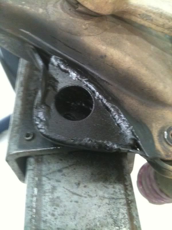

            Front engine mount location prepped for the reinforcement plate(s)--
            First plate welded in and sealed/painted--
            Second plate tacked into place--
            Connected the dots--
            Painted for now--
            Subframe and new-old rack hung the car--

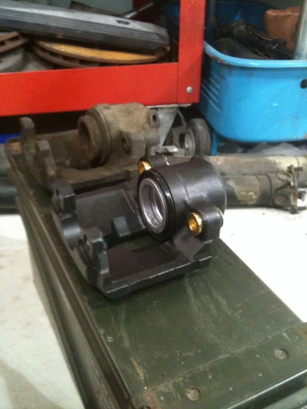

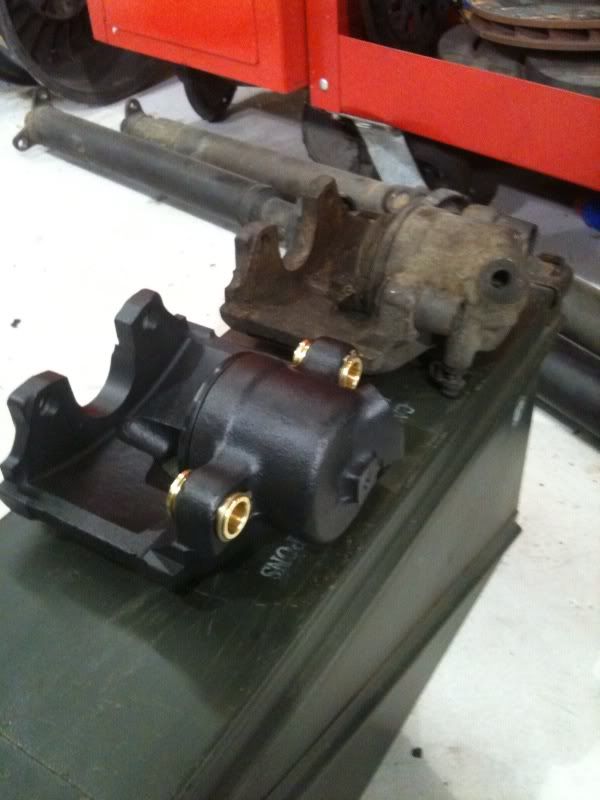

            I would have installed the 5-lug suspension tonight, but of course I forgot to order front rotors... So that will be my next "update". All of that is reinforced as well and I've turned the wishbone style trailing arms into A-arms like the early DTM arms.
            The only pictures I have from that are from the caliper rebuild process (roughly a month ago)--
