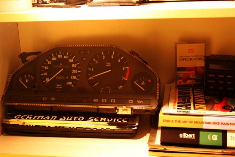

      Banking on my gauge trim rings to arrive sometime this week, then the euro cluster will go in.
      Just wondering guys: Is the 'fog light' light on the instrument cluster strip supposed to come on while the fogs are on?
        That's what it does in my car.

          nice euro cluster
          k/m
          liters for the gas gauge
          symbols for the lower strip
          front and rear fog symbols
          clean lens
          both tabs look fine
          k/m odometer gears
          nice pickup
          vdo or motormeter?

            cool, was just wondering that because on my old one, it would not come on :)

                Originally posted by iwantspeed
                nice euro cluster
                vdo or motormeter?
                VDO. Just wondering..is it possible to put the km/h face on the original mp/h odometer/speedometer module? I was planning on putting the original module with the correct mileage onto the new cluster...however, I want to retain the Km/h gauge face. Do the faces separate from the odometer modules?
                  Yeah, i think you can remove them. Oh BTW, that cluster was from a 316i or 18i (both m40), Hence the 6k redline mark, instead of the 6.5k redline mark.
                    yeah, i have an m42 318i
                    isn't the board different for 318 anyways?
                            yes,
                            i think you have to remove the needle
                            then 2 black flat head screws then you can remove the gauge face
                            nice eye
                            i didnt know that or notice.
