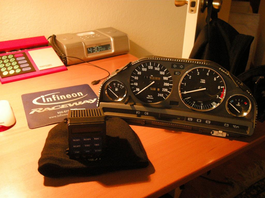

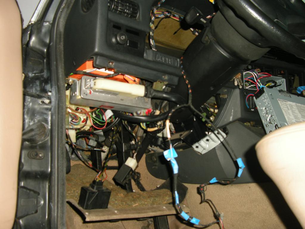

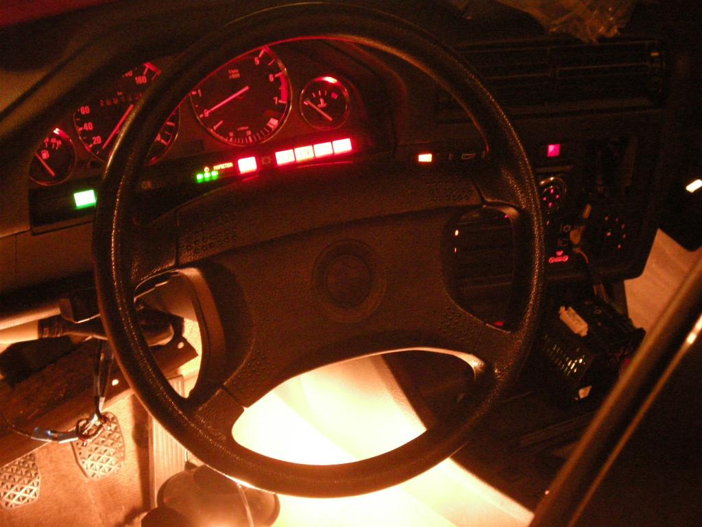

Today was VERY productive.
Took me hours, but it was worth it.
Took almost everything out of my dash.
Installed the European Cluster w. trim trings.
Did the 13-Button OBC Conversion, gutted the old harness.
Having a Fully-functioning cluster with ALL lights working is nice. :D
Pics tomorrow. Drove around tonight with it still in sort of a mess, need to reinstall a few things tomorrow as well.

did you ever find out what the 2 plugs were for?Your signature picture has been removed since it contained the Photobucket "upgrade your account" image.
Originally posted by Wh33lhopVANOS: sometimes you just need to go full retard.Comment
Yeah, well sorta.
The Door gong is apparently hooked up to the OBC, to 'gong' when the temperature hits freezing..or something like that.
A lot of people who's tutorials I read said they left it out, and it isn't that important to me either.
I still haven't put installed the OBC into the dash yet, I need a new back light first. This one's way too dim.

Discovered that the old cluster had been causing a short, blowing Fuse #12.
Replaced it, now my Speedometer, Odometer, and Liter per Meter Gauge all work again
...after three months
