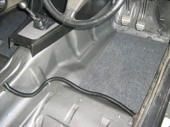

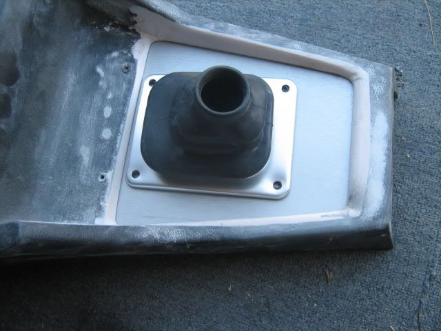

                          What shifter configuration did you use to put it in the right place? What was the biggest wiring hurdle?

                                Shifter, i used the Toyota one. Where the hole was in the tunnel I cut out a rectangular piece leaving the original hole more to one end. Spun it 180 deg and welded it back in. Hope that makes sense. Had to stuff around with console but came out ok.
                                Will make a nicer boot and tidy it up some more but initially just want to get it all together and working,
                                pretty comes later
