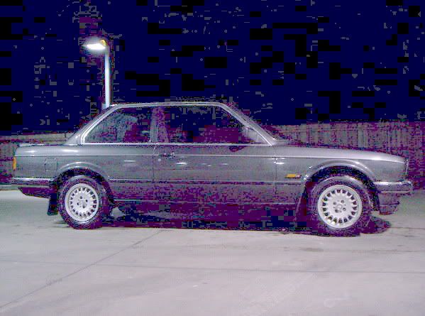

    This is how it looked when I first bought it in 2005, well when V test drove it for me as I was license retarded at the time. I could see potential.
    This is how it looked the night I got it after a serious workout at the car wash.

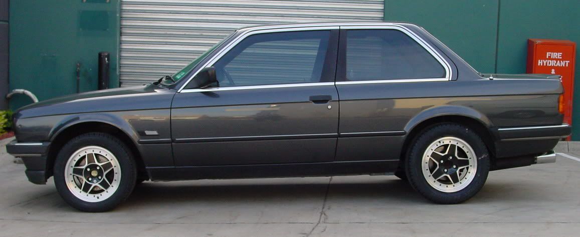

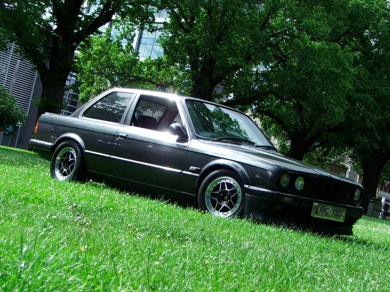

    1983 323i 5 speed manual 2dr manual windows in graphite metallic which I still seems quite an uncommon colour
    First lot of mods were
    15x7 et25 shod with 205/50-15 fronts and purely for visual reasons, went against tradition and fitted 225/50-15s to the rear well aware of the slight oversize and if anything, detrimental affect to performance.
    But wait, I dont remember buying a 4x4 E30
    Even after a drive, it reminded me of a giraffe

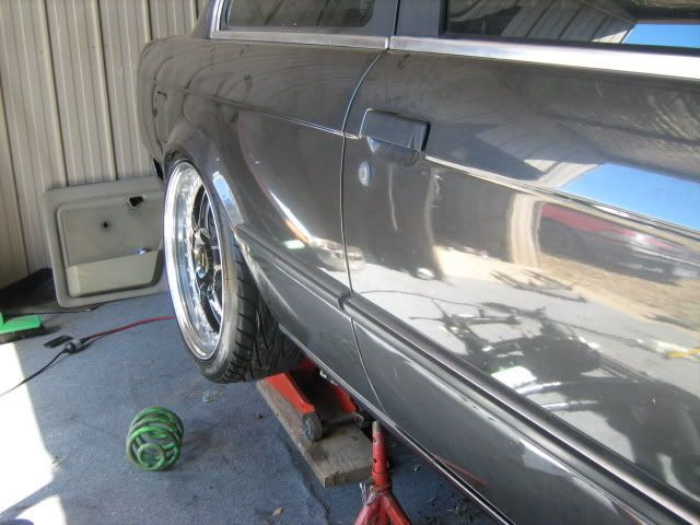

    So naturally, next step was get it sitting better.
    Seeing that made confirmed my reasoning for doing the 225 rears, just filled the rear wheel arches that bit better.

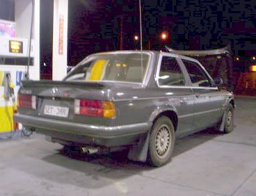

    Few other mods around that time were the single Remus, wanted to steer away from the typical twins found on 6cyl BMWs.
    Clear side indicators and smoked fronts.

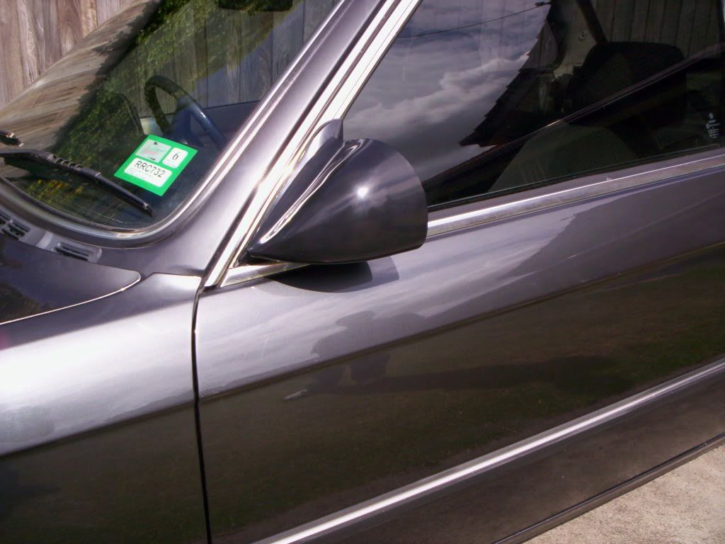

    Added some mirrors, for looks and they were a couple of happy meals lighter than the originals (weight loss bug starts here)

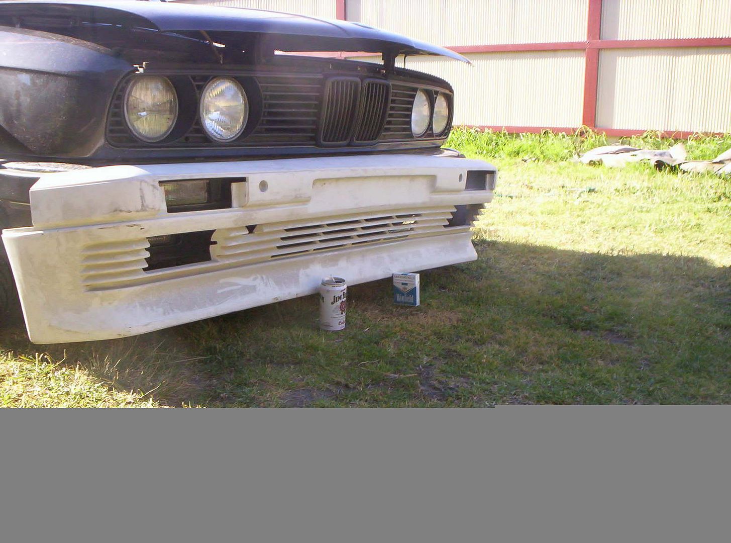

    I didnt want a full bodykit, so started working out what front spoiler to use.
    Decided on doing the unthinkable and chopping up a brand new BBS front spoiler (lolz at the flaming Newman copped here chopping into his Mtech1).
    This front was part of this BBS kit.
    I had access to a complete kit, front rear and sides minus the flares. For anyone that has had one of these kits will know, the flare makes up part of the bumper replacement section, shown in this pic.
    So I could not use the whole bumper as a replacement but I knew I could make it work and the big advantage was that it wasnt fibreglass.
    So out with the tools, yes Jim beam being an important tool at that stage lol
    First morning it was fitted, finished late the night before, got up at sparrows to take this pic

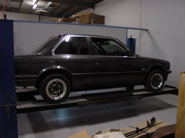

    Was starting to be happy with the way it looked, sat, sounded and drove.
    A bit of a wheel swap with ADJ turned it into the thorn between the roses this day.

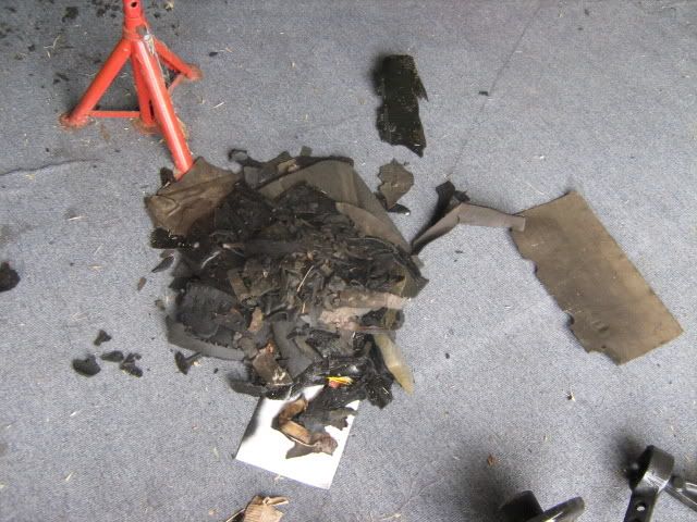

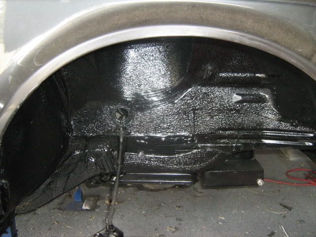

    So not much else happened apart from an interior strip, started the sound deadening removal trying to find some, what I call natural horsepower, weight reduction.

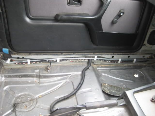

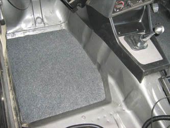

          So I had been plugging away again with the car, working late at night, getting the swine flu from working until stupid oclock slowly getting things done and collecting goodies
          The last of the sound deadening removal

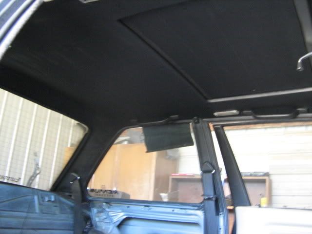

          Painted headlining black

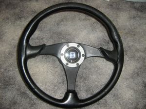

          New tiller, bit of a mix and match for the look I was after, again with contrast

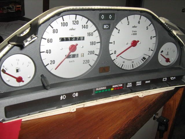

          Didnt want white guages but wanted a lift, brighten up the instruments, didnt want to retro fit an aftermarket brand gauge so went with MHW silver gauge faces.

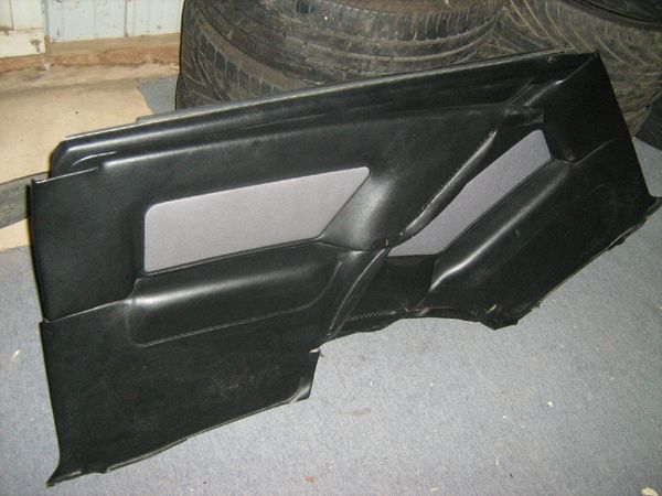

          Some new door trims

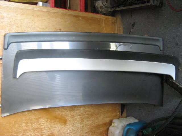

          Mtech1 rear wing purchased (now fitted)

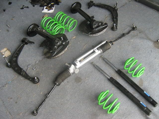

          I also pulled suspension apart, all new ball joints and some bushes, new front Bilstein shocks, cleaned and painted most compnents,

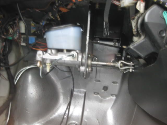

          So lately I have been getting fired up again trying to stay busy so brakes were the mission as the booster was NOT going to fit and I didnt like the idea of fitting a smaller booster.
          So after much discussion and thought, I went with twin boosters in the boot with bias valves fitted to both front and rear lines
          Master under the dash on passenger side,

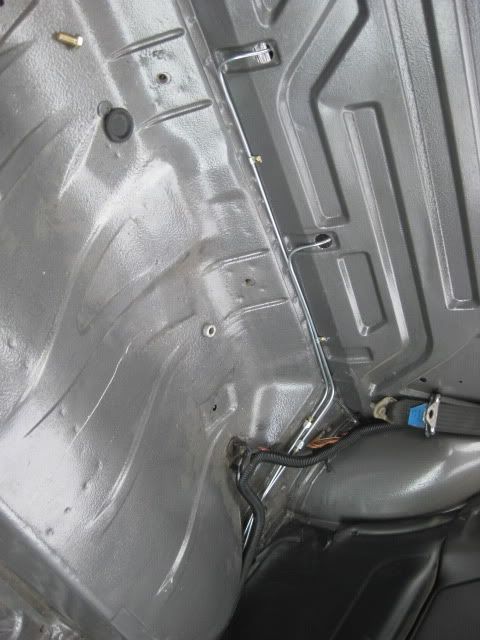

          Making the custom lines is something that I was confident in doing, I had drawn up the circuit but considering I had to go from master to boosters, through bias valves, then to front and rear brakes, and considering the pressures that are created i left the lines to a professional.
          In the end it was a combined effort with me assisting Paul after hours.
          I was extremely proud of my efforts in making the under dash bracket for master myself, all of the bracketry for the boosters in the boot as well as the bits I did with the brake lines. Considering im no fabricator, just self taught
          Pics of the lines running up the electrical channels
          Through to the boot (still havent fitted grommets)
          Instead of using the brake line that comes in a roll, we used stuff that comes in straight lengths. Watching Paul do some of these lines reinforces why its better to pay people to do some things. I think I would have wasted 20 metres of line doing it myself.
          So we bled them up, one small leak on the left front which was at the caliper and nothing we had fabricated, tightened the hose (I must have loosened months ago when doing suspension), re bled and not one leak.
          With a t piece temporarily set up using vaccum off another car, the pedal felt so much better than I expected. Not too hard like when using a 25mm/1inch master on an E30 normally.

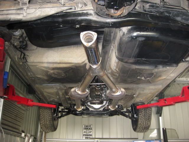

          Running 2.5inch stainless to cats, after cats merging into single system, 2.5 stainless hotdog for some bark with more 2.5 stainless to the rear muffler which is also stainless Xforce twin tip.
