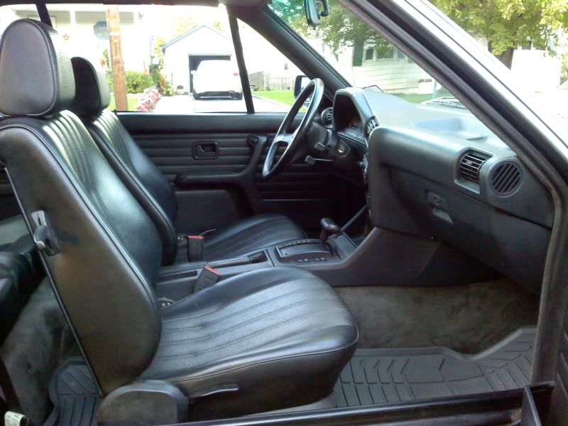

      Just a few updates, got a screaming deal on a near mint set of standard seats, so I threw them in. Here's a few recent pics after a carwash, looking pretty good, right?

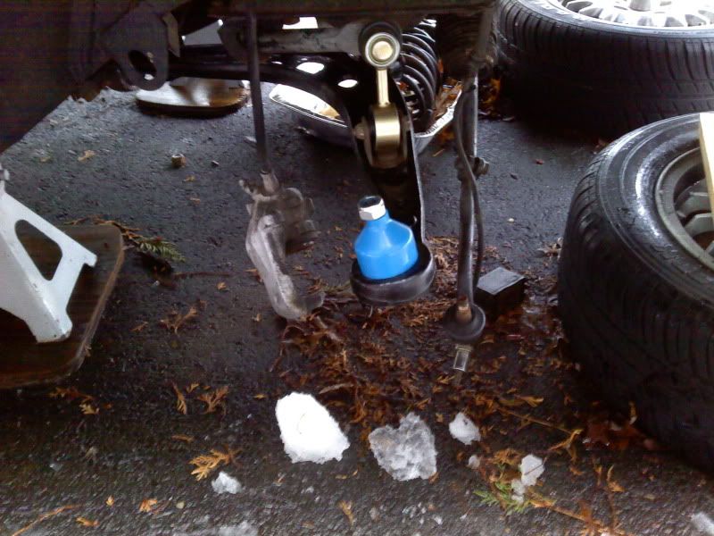

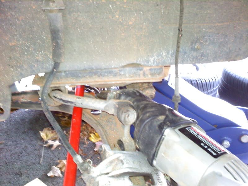

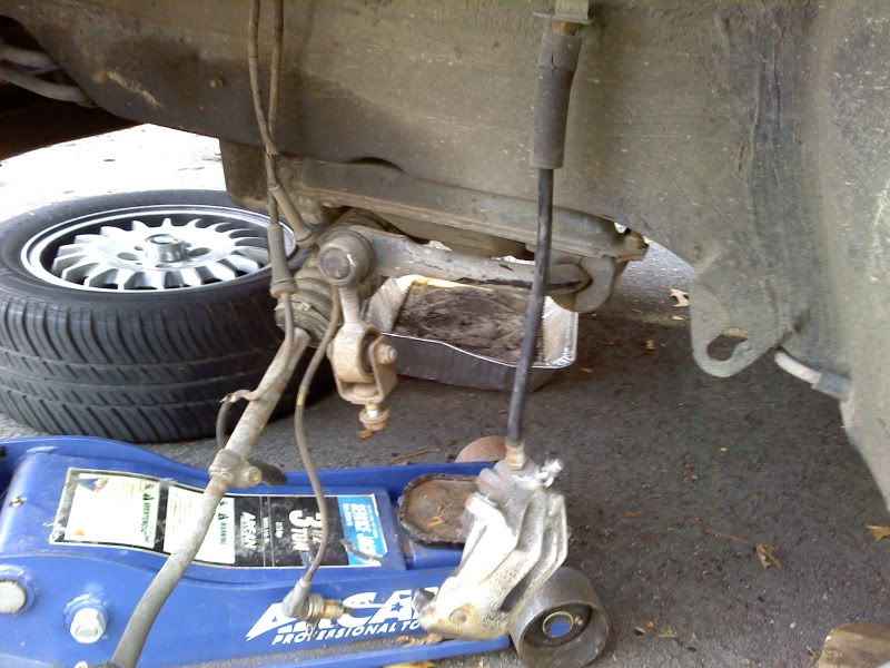

      Currently I working on the front suspension, new control arms, cabs, inner/outer tie rods, struts, M3 springs, etc etc. Was all going well till the inner bj bolt on the pass side control arm, pretty much locked up when it was almost off, fucker must be cross-threaded. Well in my infinate wisdom i thought it would be a good idea to use the sawzall to cut the shaft of the bj under the subframe. Sure I got the control arm off, but the bj is tapered and will never come out thru the top, wish I woulda thought of that, i dunno, say yesterday? Oh well, i got a few ideas on how to get it out. I used the balljoint press i bought for my truck to press in the new e30 M3 CABS, worked pretty good. Hopefully I'll get this all together soon, needs a front wheel bearing, so im getting that to right now.

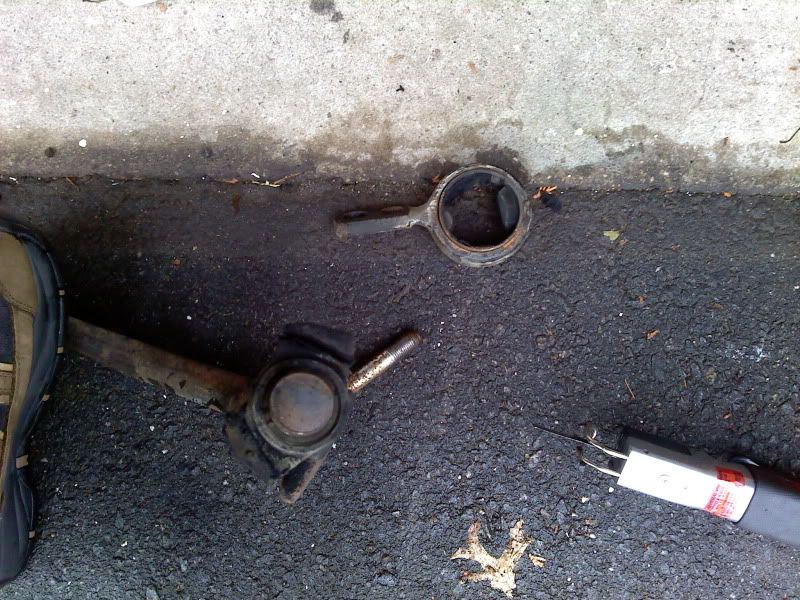

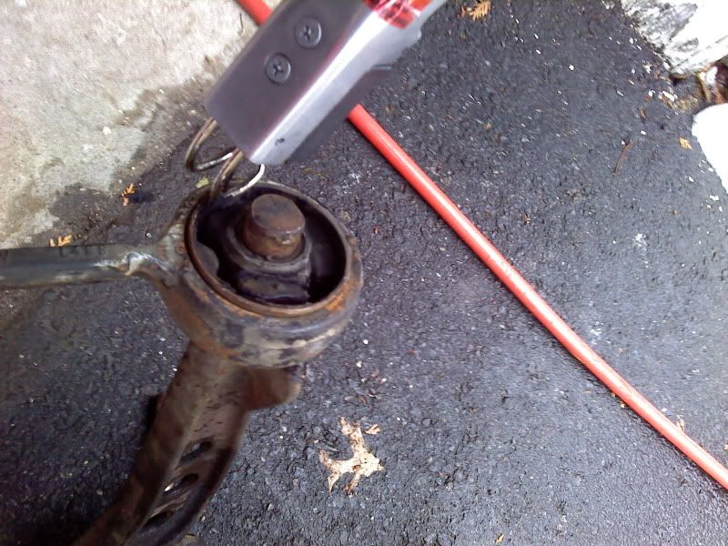

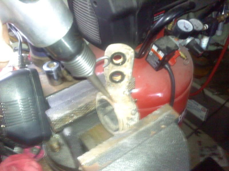

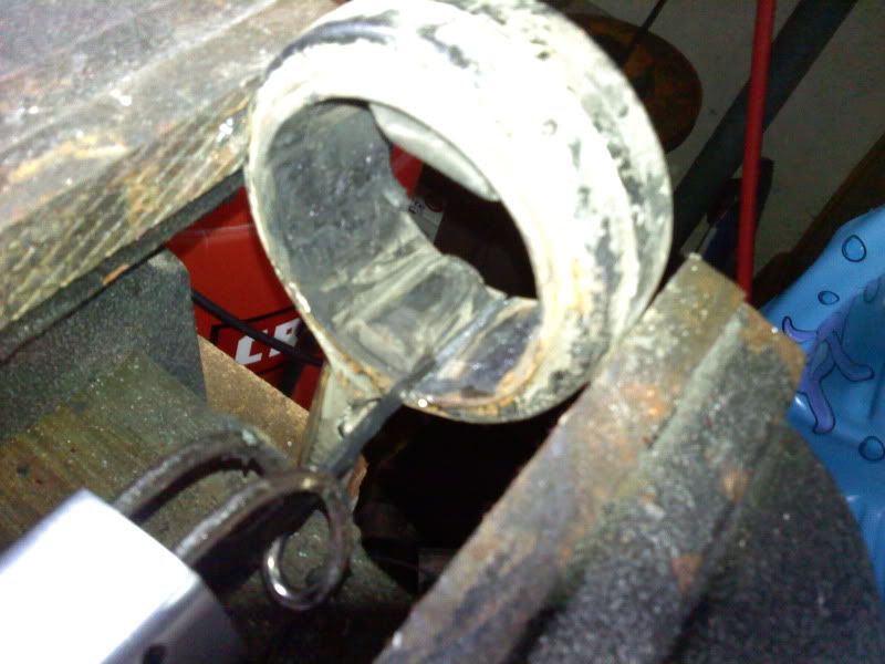

        Ok, been a while, got the stuck control arm off, pressed on some new m3 offset cab's to the new control arms, and got the new control arms on, as well as some new sway bar links. Here are some pics of how I got the CAB's on.

              I know this isnt all that exciting stuff, but the good new is I got the front end all back together and drove it for the first time in a few months! Feels so good with all this new stuff. I used m3 offset CABs and M3 front springs, looks like it sits a little lower, but im gunna give it a few days to settled and i'll take some measurements
