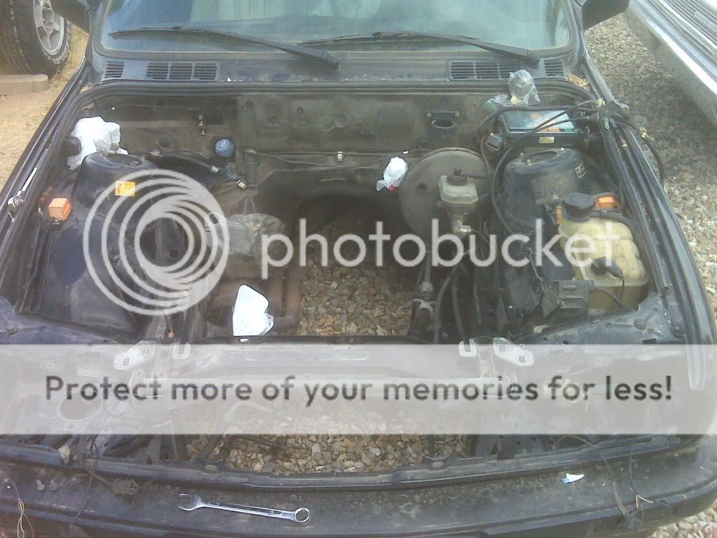

    Engine bay shot.
    exhaust and BB are now removed as well. Back to the story I guess.

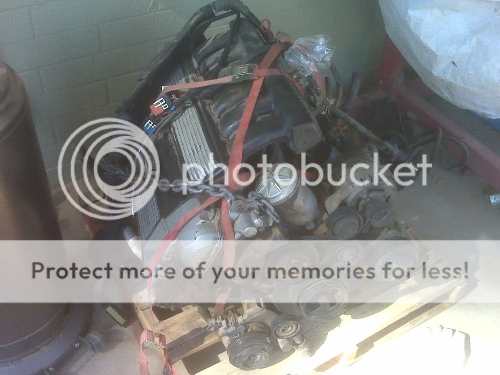

    I believe it was May 14-16 he was in town and we started to tear down the m50 and clean here and there and replace some gaskets and hoses and what not. Swapped the oil pan for the e34 one as well.
    The weekend of June 12-13 I drove out to Miramar to pull a tranny from a donor e36 he had.
    So here are some pics of where I am at now and we will continue with updates from here.

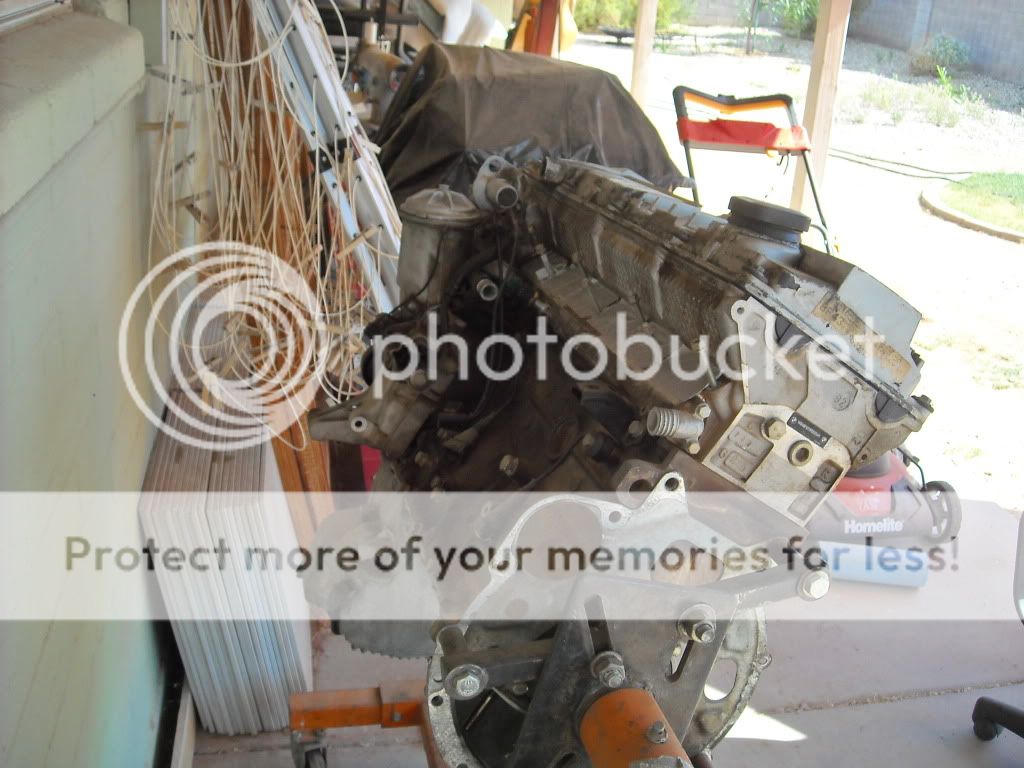

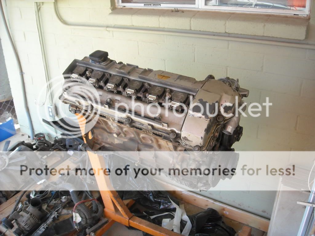

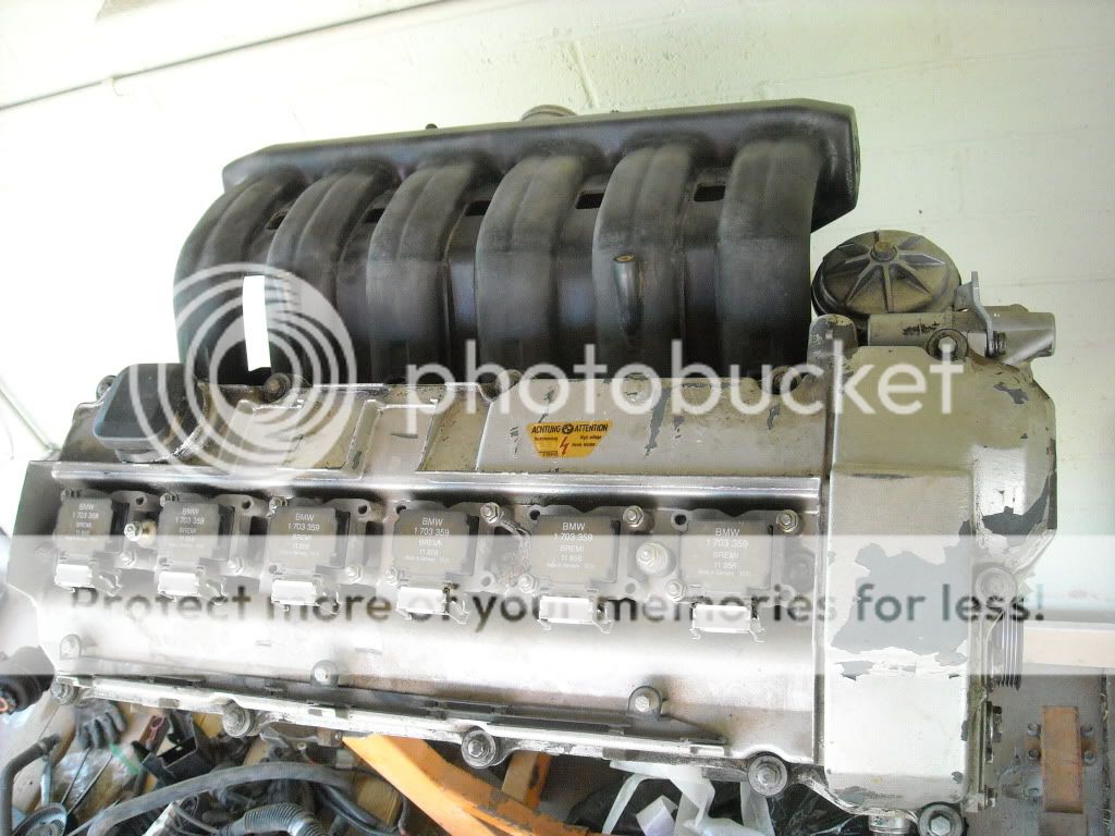

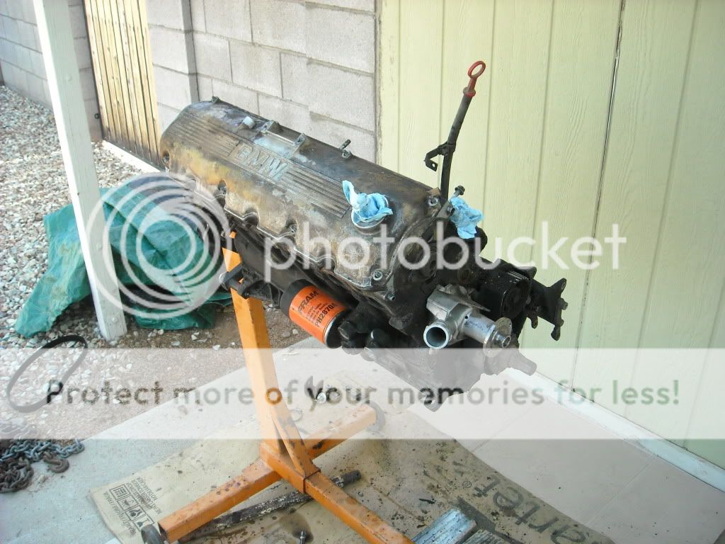

    Started putting the m50 back together. Changed out the spark plugs, thermostat and housing, cleaned the injectors, wiped down the motor a little. Not gonna have this thing super clean just want it running again.
    Here are a couple pic of the m50 on the stand.

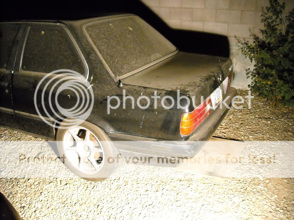

    My abandoned e30.

          Anyways, cleaned the injectors and fuel rail, cleaned the intake manifold and put it back onto the motor, cleaned some gunk out of my brake master cylinder resivoir. Took off the water pump, did not want to chance it going out after I put the motor in might as well add to the "while I'm in there list".

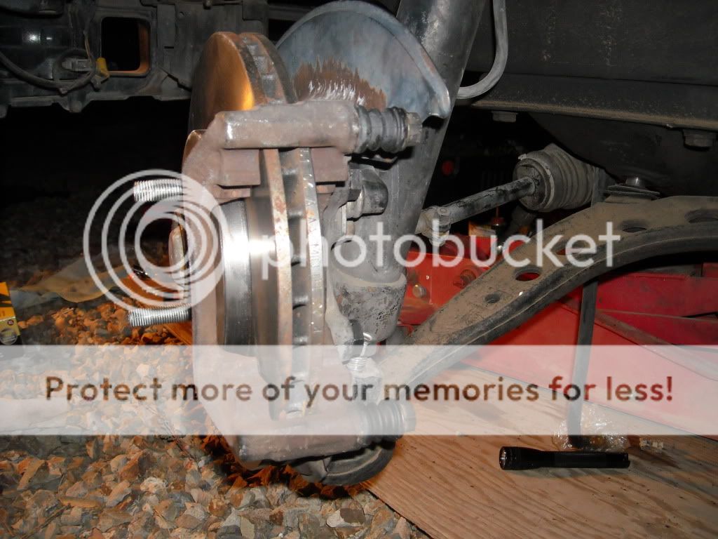

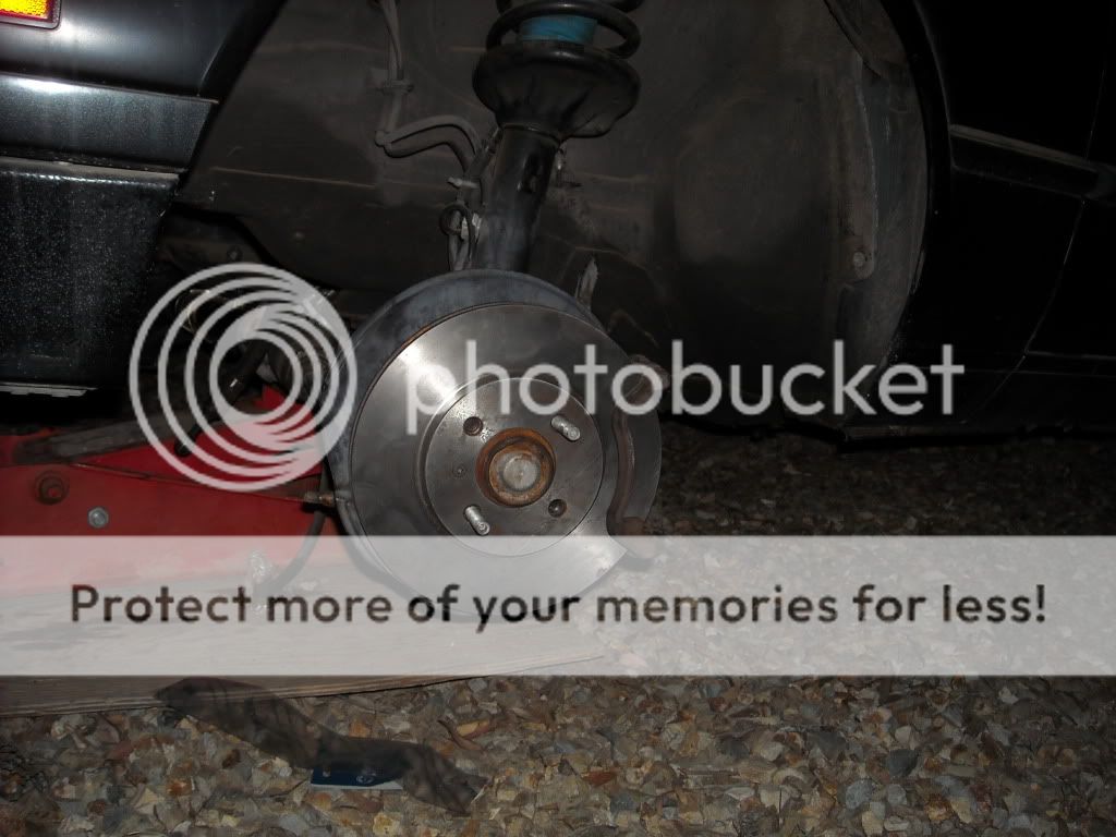

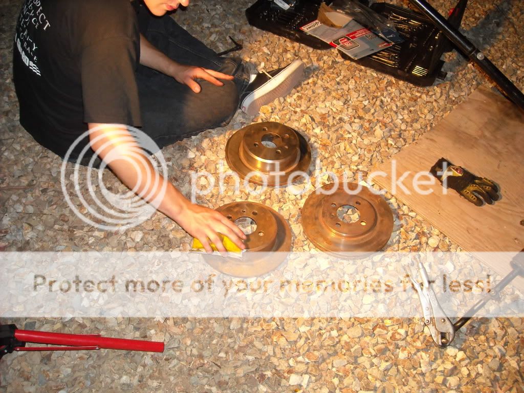

                  So as I said earlier I was going to put the rotors/calipers/brake hoses all back and put the wheels back on to do the rack.
                  Fail #1, convenient leak in my shed that got some rust on the calipers, no big deal just needed some sand paper fixin'
                  Got one rotor on the front driver side and tightened down the mounting screw.

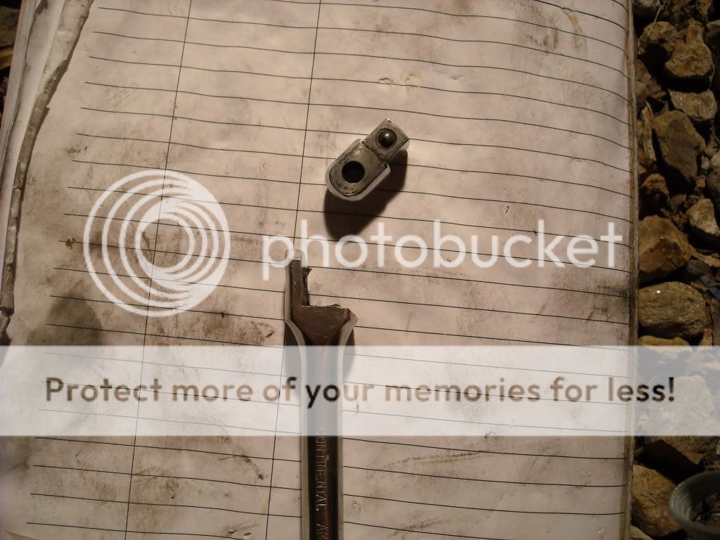

                  Fail #2, get over to the pass. side and DOH forgot I never drilled out the old mounting screw that had the head broken off... Cant run the drill or anything at night and I couldnt get enough of it to get with pliers or vice grips so it will have to wait. (btw yes I know thats a rear brake hose I was just making sure I didnt orther the wrong size... since I was effing everything else up)
                  So moving on I am thinking "I will just install the calipers and drill the thing out tomorrow and put the new one in". Wrong!
                  Fail #3, now I usually have everything organized. Every bolt/washer/clip/cable etc labeled... can't a set of mounting screws for the damn caliper to the strut housing! Looked for about an hour and fifteen minutes and said screw it, I will just have to wait til the morning to hit the hardware store and buy two similar bolts. Which means I cannot even install one side because I need to take a bolt in for reference to make sure I have one exactly alike. FML!!!!!!!!!!!!!!
                  Then fail #4 is just obviously I cannot put the rack on without the tires on because A)Fed up for the night B)To fed up to put the tires on to make sure the wheels are straight then have to take them back off to finish the brakes tomorrow.
                  Still in high spirits despite my FAIL filled evening.
                  We don't need m50 when we have one hooman power! My buddy Seth came over to help me and realized it was fail so decided we better push it around..
                  Good night fellow enthusiasts, hopefully I won't be such a ruh-tard tomorrow and I can make some headway.

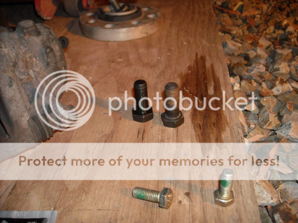

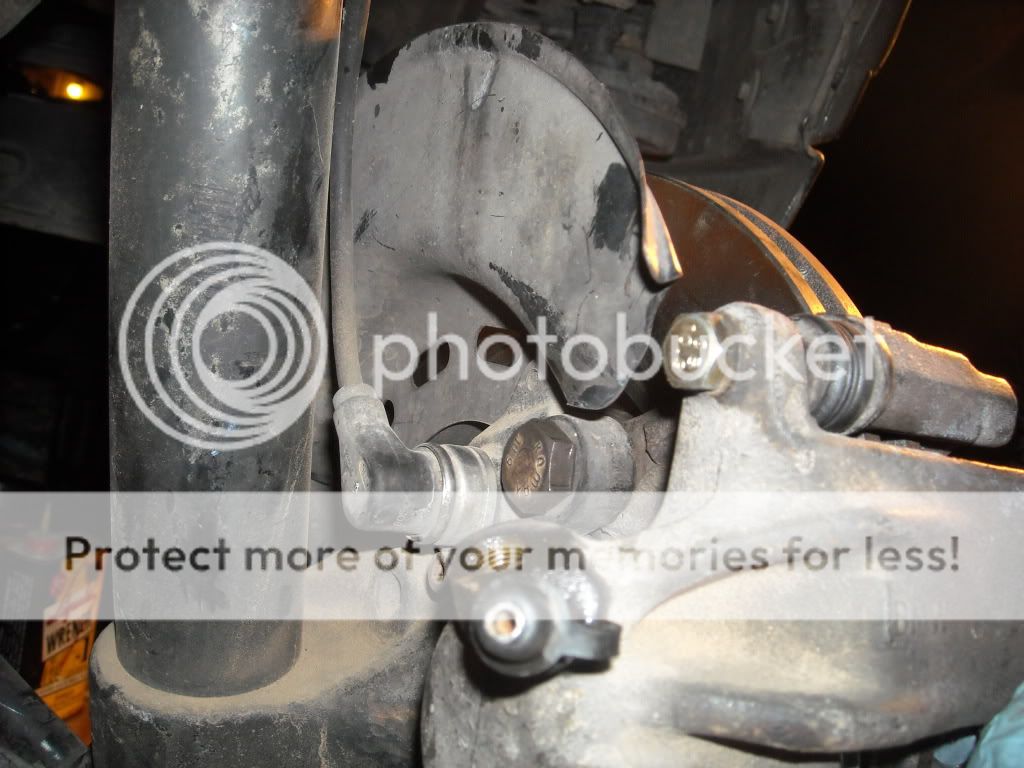

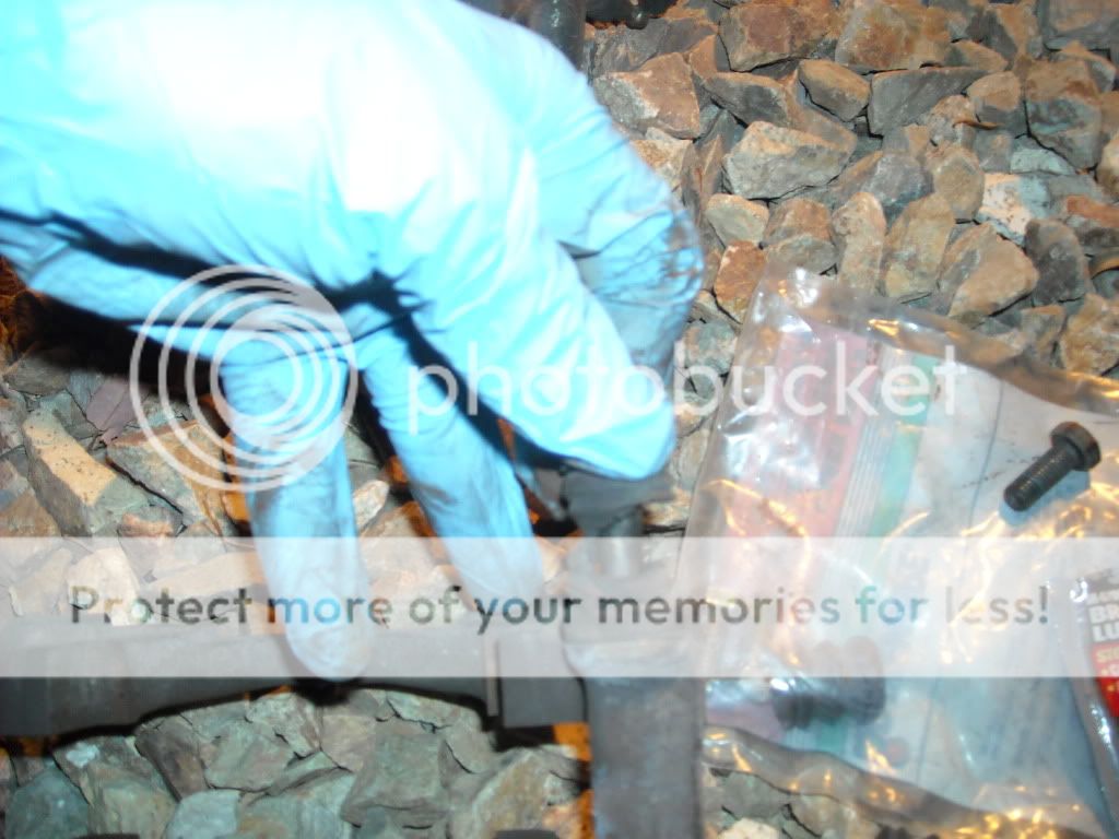

                    Picked up a couple bolts to replace the caliper mounting bolts I misplaced.
                    New and old.

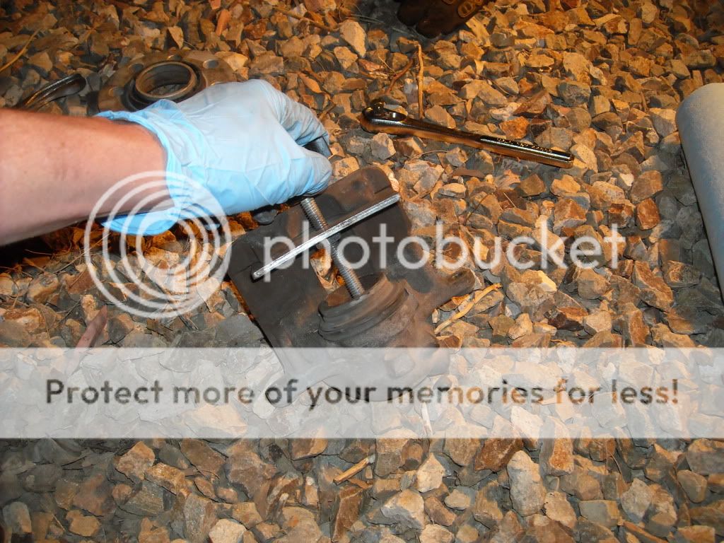

                    Also picked up some new brake pads and guide pin rubber boots to replace the old and ripped ones I had.

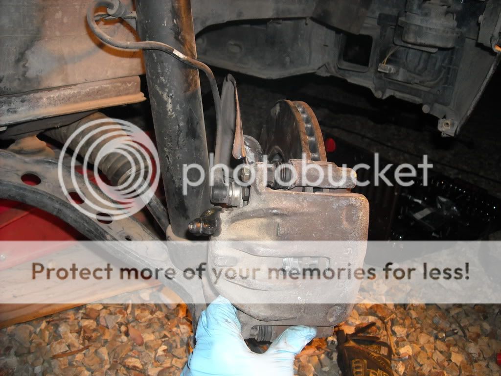

                    Then started installing the calipers. Couple pics.
                    Noticed the rubber cover to my caliper bleeder valve has a hole in it.
                    Also put on a brake sensor I had purchased back when I first decided to pull the m20. sweet.
                    So, just taking a break then I am going to put the wheels back on, lower the car back to the ground and then check out the rear. See what I need for that. Also need to change the gasket on my diff, it has a small leak.

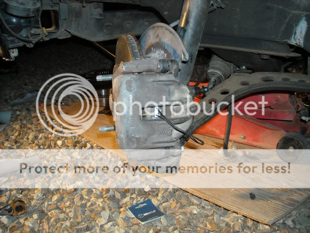

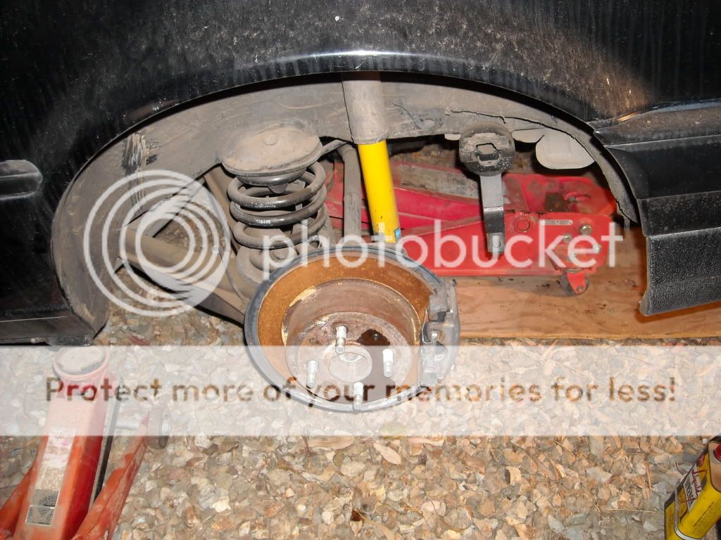

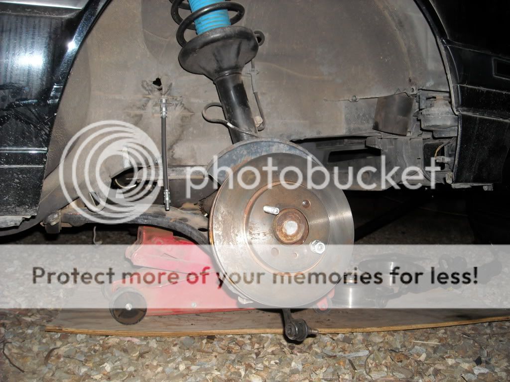

                        Okay so another update... lots of time spent, little accomplished.

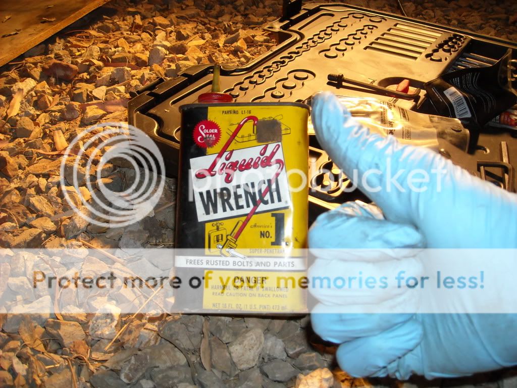

                        Heres the deal. Moved to the rear, jacked it up, secured it, pulled the tires off and started undoing everything so I can swap out these rusted ol' rotors. Mounting screw comes out with ease, as does the bottom caliper mounting bolt. However, the top mounting bolt has other thoughts and decides it wants to delay me a couple hours...

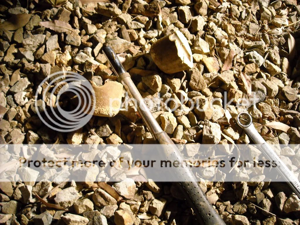

                        Tried hittin it with a box wrench, tried adding a pipe to it but the angle just wont keep the wrench on. Sockets are fitting because the hose is in the way and the hose just spring loads when I try to disconnect it. Im goin at this thing forever coming up with new ideas to try to get it off... One of which was hit the wrench with a mallet.
                        Mallet was old and just broke in half...
                        Also used a load of
                        finally I raised the rotor disconnected the strut and managed to get a 3/8 drive socket with extension and breaker bar on there.
                        So I lay down on my back and pull pull pull with everything I have, still nothing. So I slip a pipe on there and pull again and here that great "crack" sound of a bolt breaking loose..... wrong
                        It broke the damn breaker bar. So I took the chance and used another and heard the exact same crack only this time it was the bolt. Finally I can give up for the night and go to bed. The car almost beat me....
