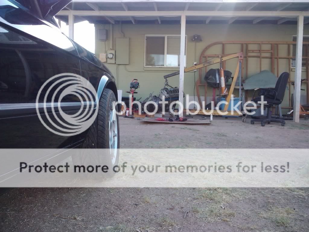

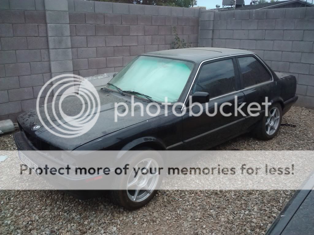

So while I still have some cloud coverage I am going to push the car into the center of my yard to rinse it off/spray out the bay before the m50 gets put in.
I still need to take the engine off the stand to start attaching the flywheel/starter/clutch and transmission. I will work as much as possible today before the heat completely kicks my arse. Its already about 100 degrees but its not bad with clouds.
Here are a few pics of the mornings progress.

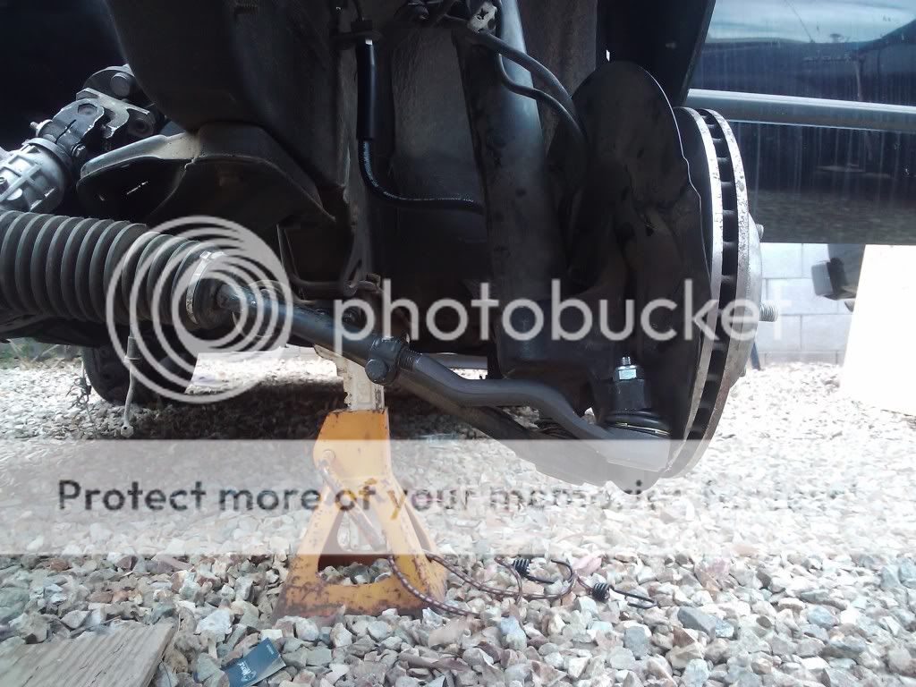

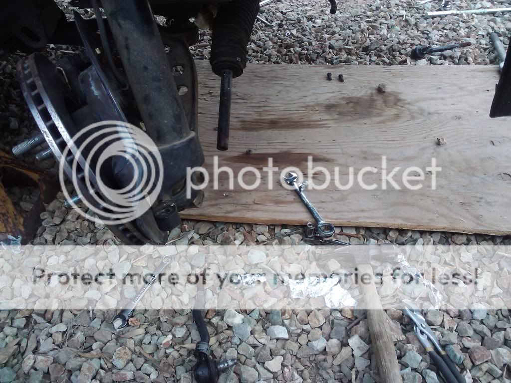

New line on. (also got some bleeder screw caps cus mine were toast)
Old tie rod end off.
New one on.
Did the same to both sides. Lines, caps, and tie rod ends.

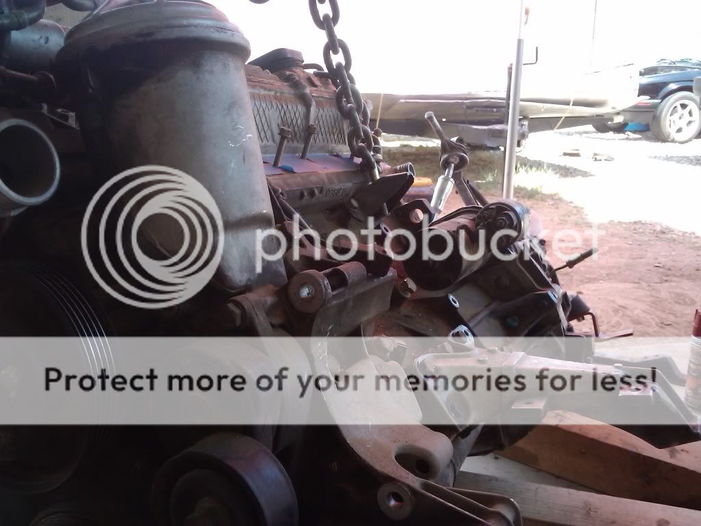

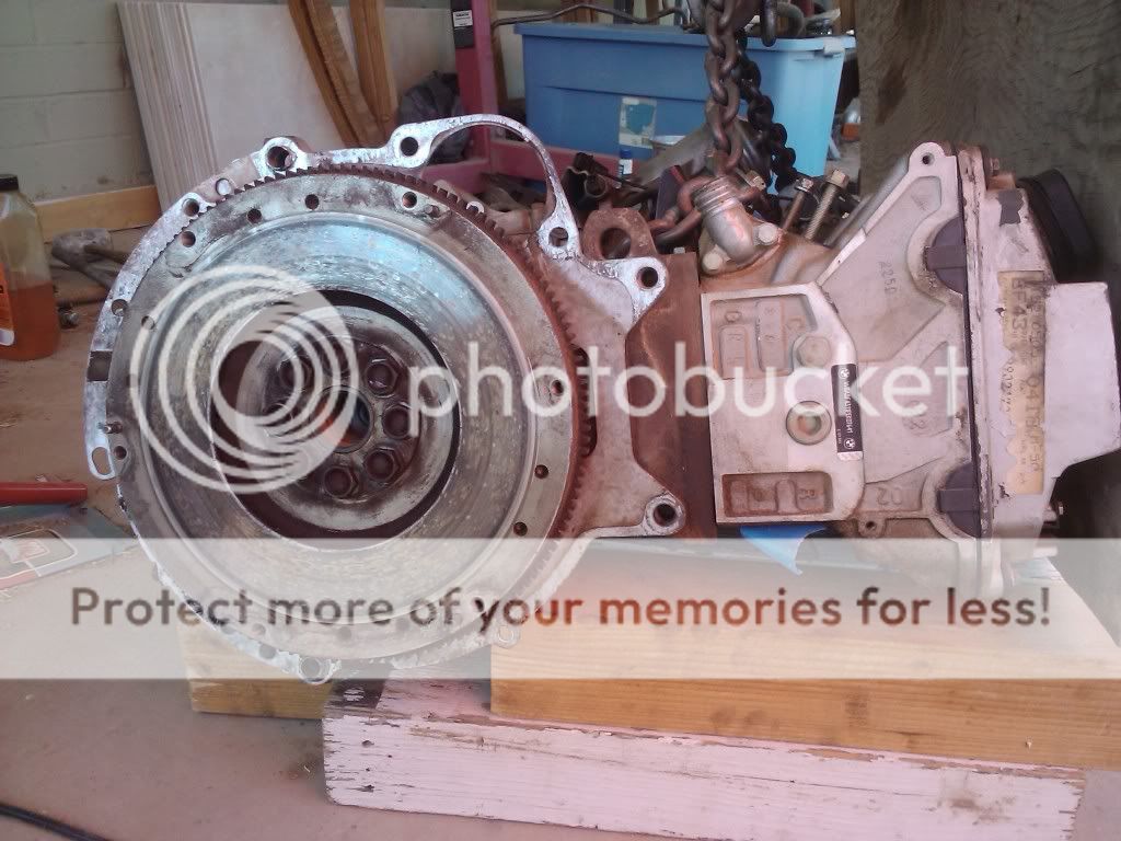

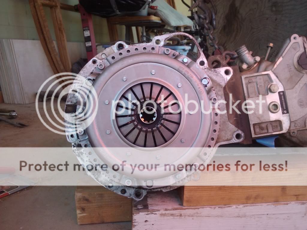

Anyways, got the transmission attached to the motor.

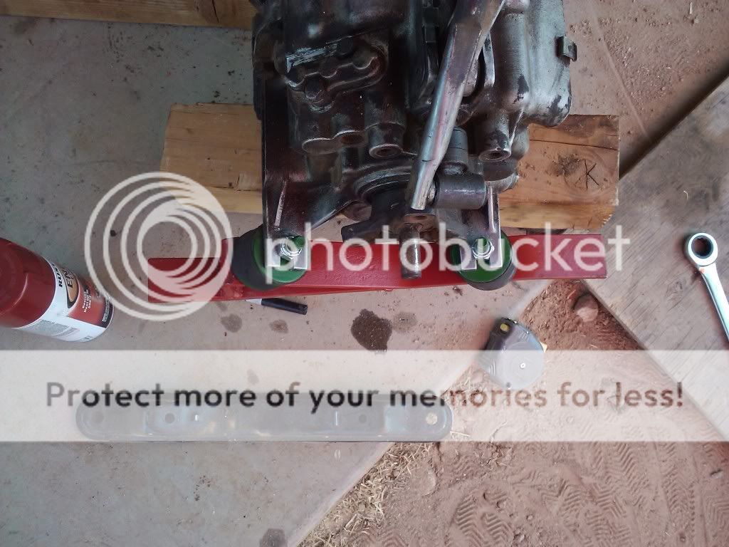

Then I worked of filing the slot for the tranny mount part on the transmission itself to fit the e21 mounts.
At the same time I decided to paint the tranny brace as well.
So, in the morning I need to mark up the brace and drill all the holes. Then install the engine mount arms and busings and get ready to drop the motor. Hoping its tomorrow! We will see.

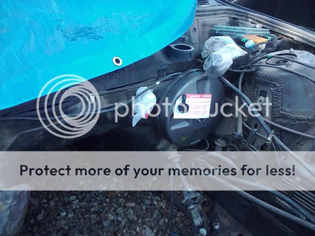

nice work, if that booster is unpainted (like how most rebuilt units come) throw a layer of paint on it otherwise its gonna get surface rust supper quick!

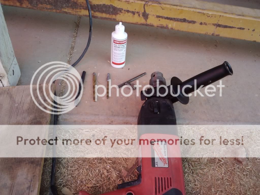

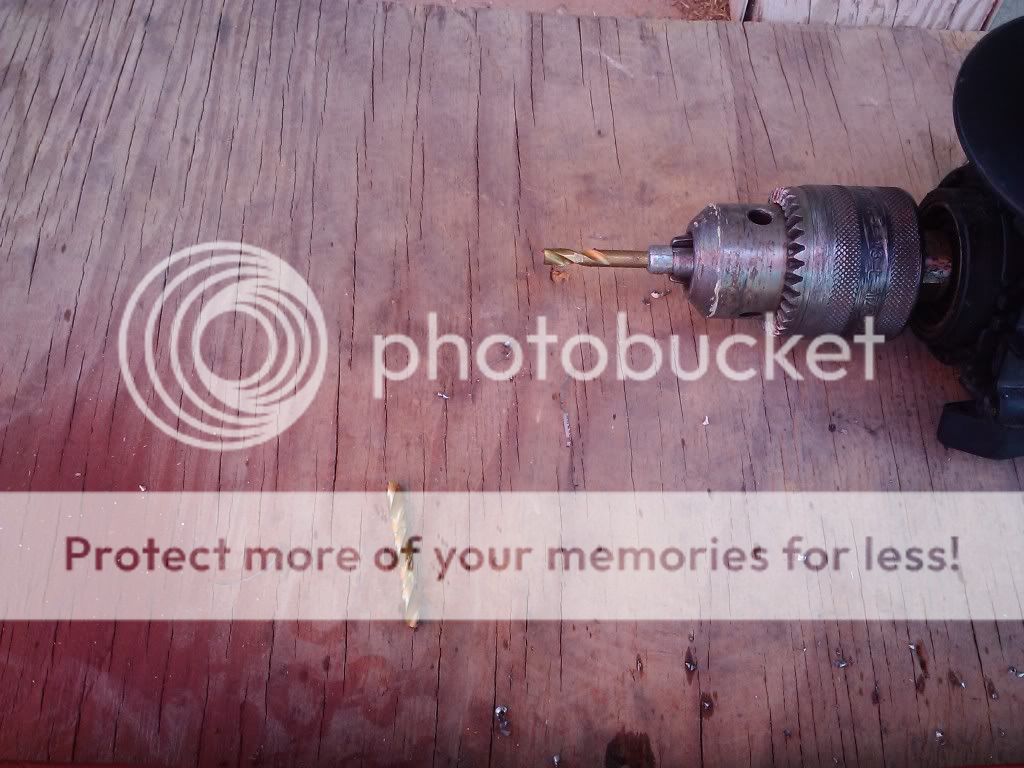

Also had to make a trip to my fathers house to borrow his corded drill, and to Lowes to buy some drillbits for drilling metal. Ended up breaking a small one but I figured that would happen.

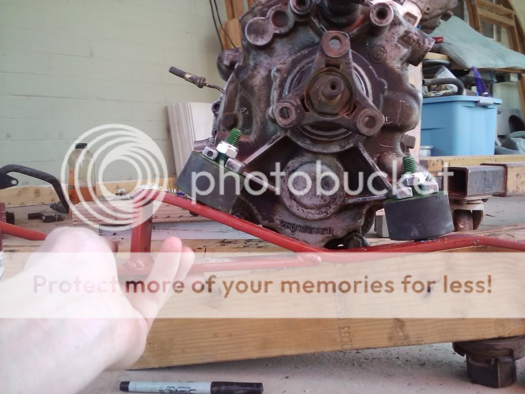

Started working on the tranny brace and got that installed. I looks like it is a couple degrees off but I cant fix it.. just gonna have to deal with it.
Its going to need to be painted again but I am not worried about that now.

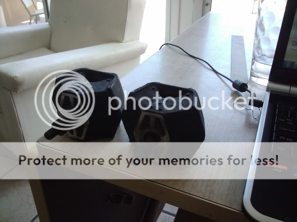

Then I installed the starter and the mounting arms. I am going to be using E28 M5 engine mounts.

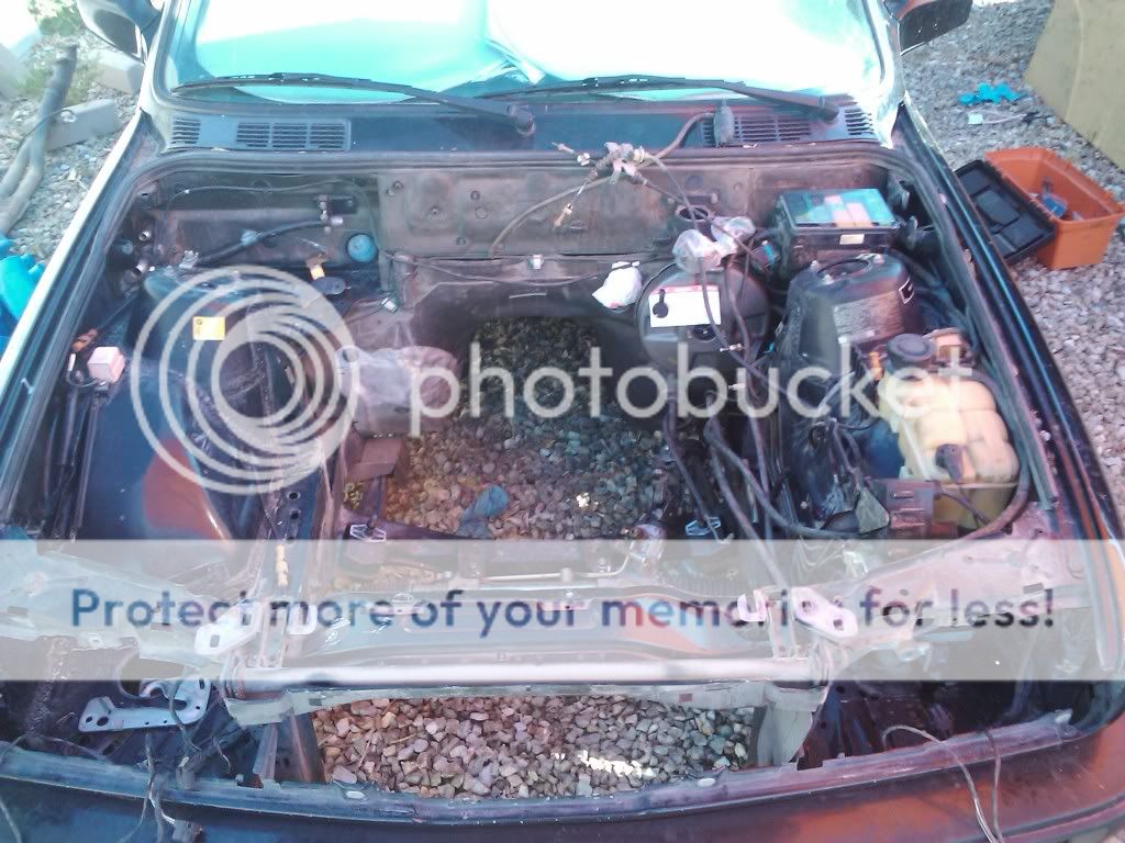

Since the front of my house faces west I am going to wait until the sun lowers a bit to allow at least the front end of my car to be shaded by my porch cover. I will spray out the bay again maybe scrub it a little before I drop the motor in.
Didnt drop the motor as planned, got to side tracked by prepping everything, but at least I am taking my time and will minimize my "should have done that before I dropped it in" list.

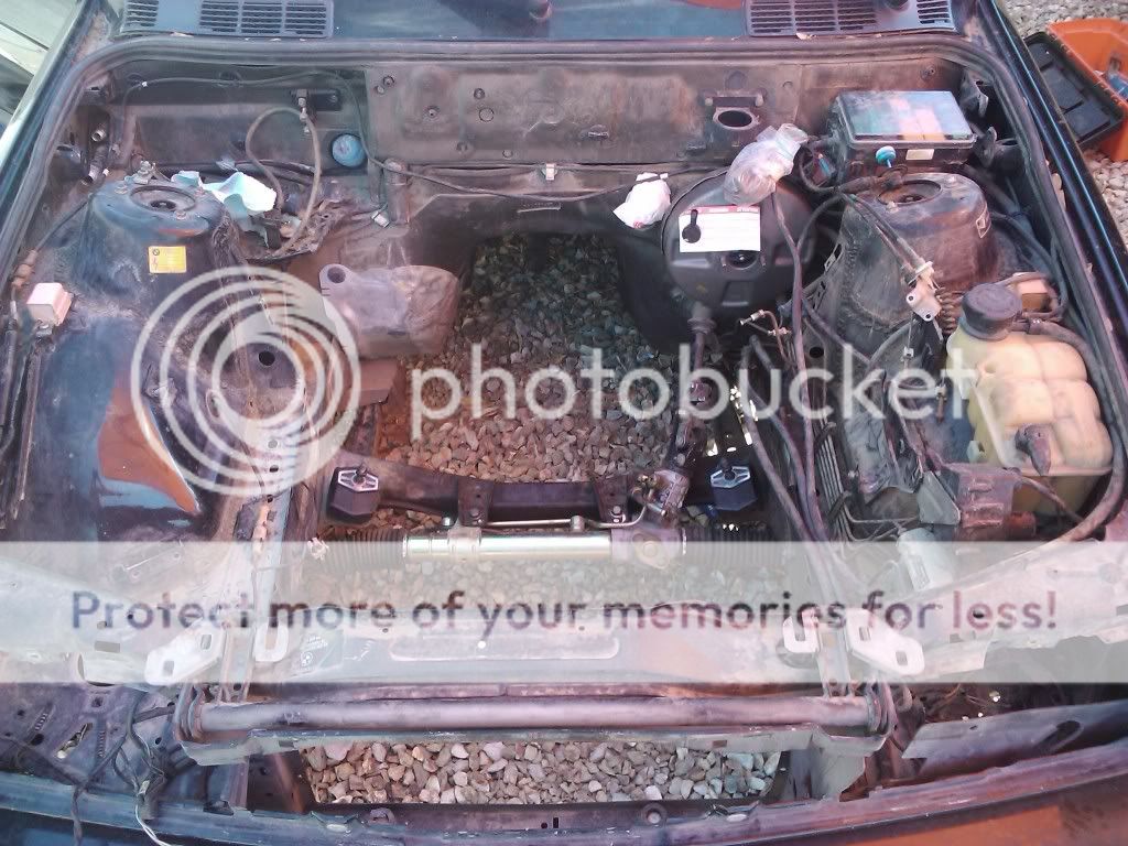

So I cleaned out the bay real quick, nothing to crazy I didnt wanna spend all day doing it. Just about a 20 min scrub. While I was doing it I didnt see much of a difference until I looked at the pics.
Not much of a difference, but cleaner.

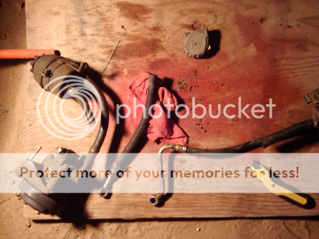

Modified my power steering hose to the proper length for the m50. I have an m50 one but it is covered in oil so I am assuming it has a leak.
Then I cleaned the power steering resivoir and bracket.
