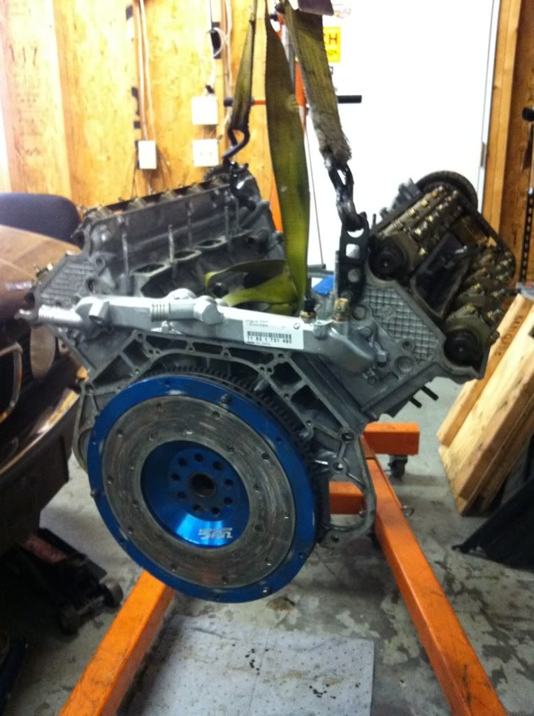

    Got the crossover pipe, valley pan, and rear main seal housing all torqued down today. Started pulling the chain guides out but then realized the TDC I had set it too was 180 degrees out. After alot of cussing I called it a day because the main chain had briefly slipped off the crank pulley and I'm not sure of it's original position now. I immediately went looking for my auto flywheel because my UUC unit does not have a notch for my crank lock. I must have thrown it away because I can't find the damn thing anywhere. No more updates until Tuesday when I bring home the timing blocks and a borrowed flywheel to get everything back in line. $&@$?$!!?$&

    Just scored a UUC M5 flywheel on ebay. Putting the engine back together tomorrow.

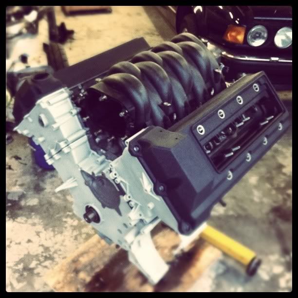

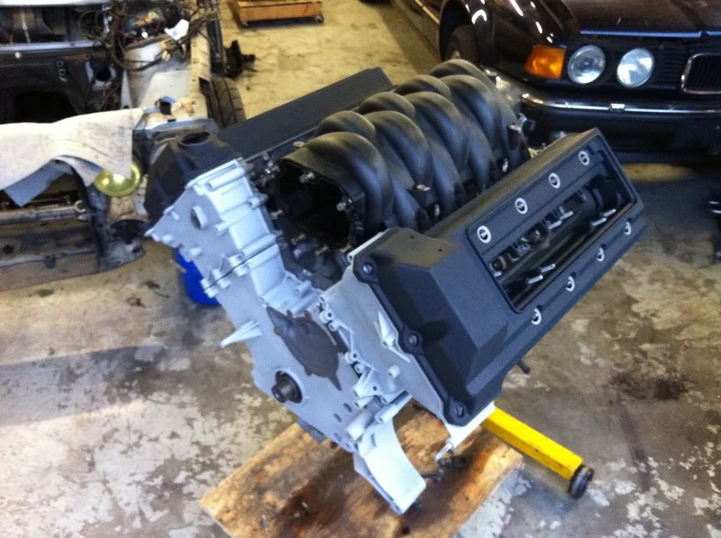

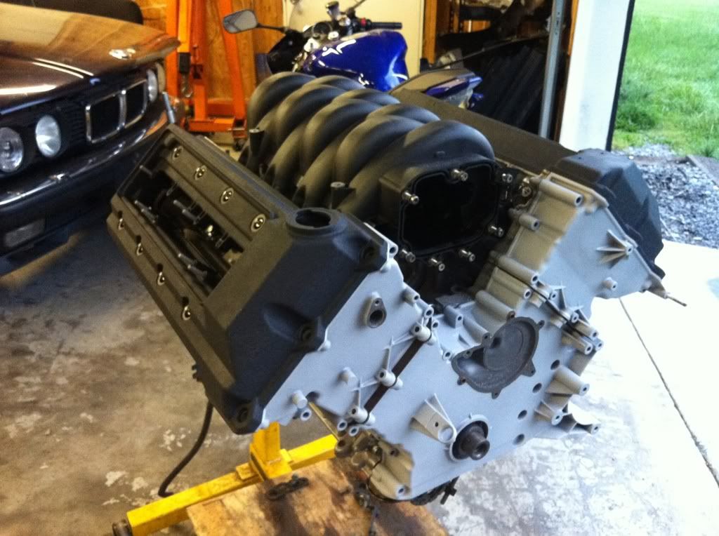

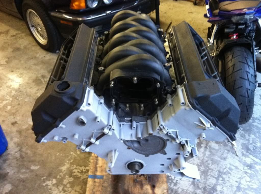

    Some progress finally. 3 weeks and $375 later all my timing covers and valve covers are cleaned and powdercoated.
    Natural matte look to the timing cases.
    Black wrinkle on the VC's.
