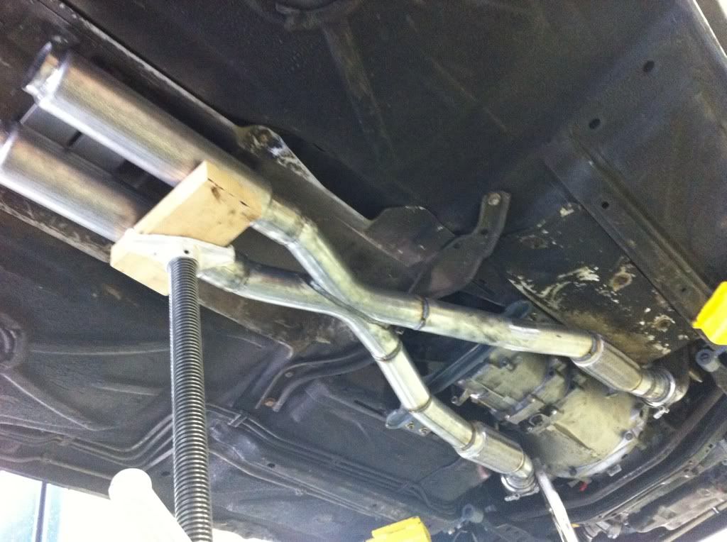

    Thanks. I can't take credit for it though. I could have attempted this myself if I had a lift but lying on my back and trying to make all those complicated angles would have broken me. The hardest part has been trying to keep it as close to the body as we can on the drivers side just after the downpipe V-band. It will also have another pair of vbands shortly after the subframe bend. This will allow me to remove the center section only to play around with different resonators or work in the trans area without dropping a huge one piece system. Should be done tonight. I'll post pictures.
    Be glad you are having someone else do it. I attempted mine on my own yesterday, and now have the problems you decided to avoid... having the drivers side hanging down so low. Trying to get the pipes to bend in to the center, under the driveshaft, is a major PITA when you are working under the car on jackstands. I realized immediately I wouldn't be able to do that, and just ran them straight back under the floorboards, making them a good 2" or more lower then I wanted them to be.
    Yours looks great, and that's a nice looking x-pipe!

    Not a huge update but here is the exhaust taking shape:
