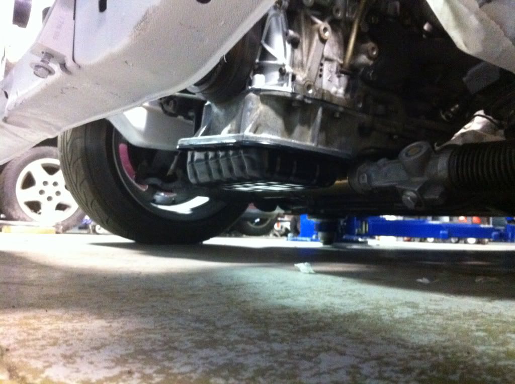

          It looks like the motor is sitting pretty far forward in the engine bay. Even with how lightweight the sr20 is, wouldn't it be better to get it closer to the firewall? I'm not well versed in the overall weight balance of the verts so I could be way off. Either way I'm really enjoying the build.
          I thought I posted a picture showing it, but I guess not. The motor is within an inch of the firewall, it's as far back as it can go really. Any further and the shifter would come nowhere near the stock hole (it doesn't line up as is and has to be cut), and you'd have to work out something for oil pan and steering rack clearance:
          It could have gone maybe a 1/2 or 1/4 inch back, but I may switch to a Moroso oil pan soon, so I wanted a little extra clearance.

                    Could you take a pic of the firewall clearence you have. And possibly some showing better the sump clearence to the steering rack.

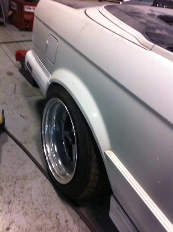

                        Rear subframe has finally been swapped out... It's nice to see the car no longer at gay ride height, but now I have to figure something out to get the front lower.

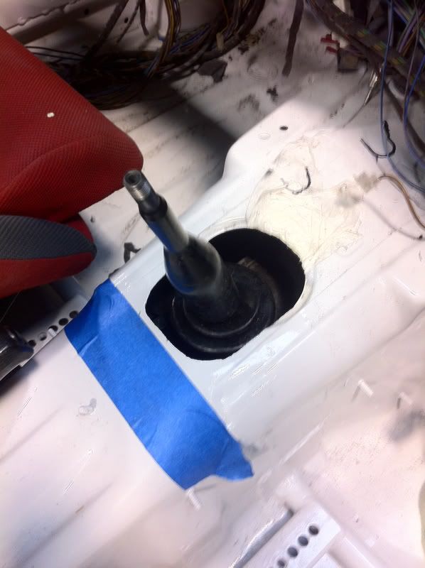

                        And minor modification to fit the shifter:
                        Next time I'm at the shop i'll get some more pictures... The clearance on the underside of the car may have to wait a bit as the car isn't on a lift anymore.
