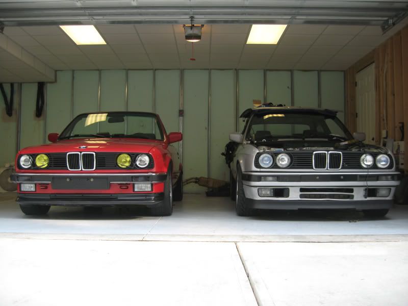

                  Dude - our cars were talking smack to each other this afternoon....so much so that I had to go down in the garage and unhook their batteries. lol

                        Is it me or you have even more restriction of air thru your euro trim? This may not help with air flow either.
                          yep, that's what I was saying the other night regarding air flow. The euro grills and euro valance flow way less air than what was on it before. The S50 needs a solution....
                          '87 325ic, powered by S50.
