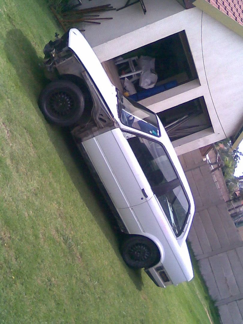

    I bought this car a couple years back, I drove it around for a few months. Then the bug bit to strip it and start playing like with my previous 325i.
    So it began.
    After all the stripping I found some rust which annoyed me and i lost some motivation, at which point I had thought of spraying the car a dark green.

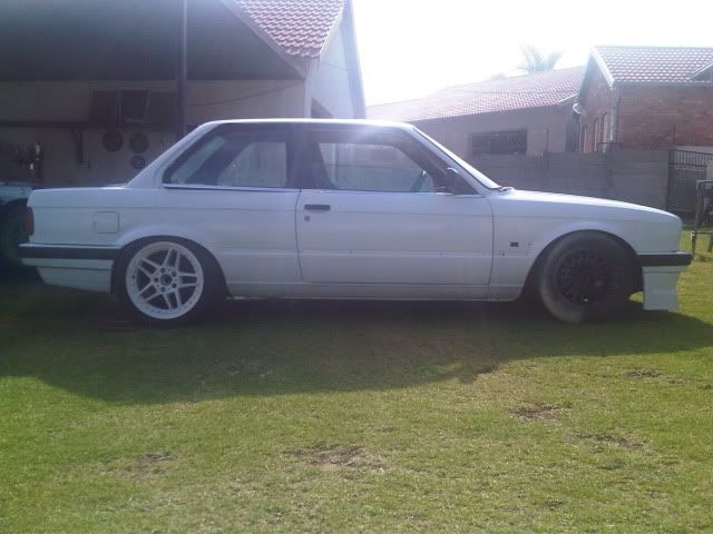

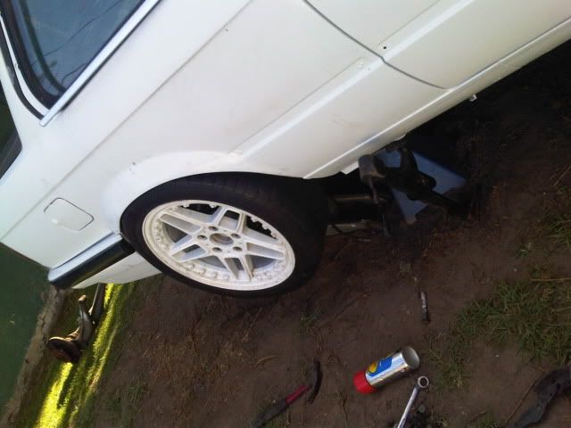

    I started by fitting the rear 5 lug. e30 M3 hubs, e36 M3 discs and E46 m3 callipers... still need to find a solution for the hand brake.
    I need to machine down the 20mm rear spacers to 10mm, as it stands the edge of the tyre just clears the fender but I would like the extra safety margin.

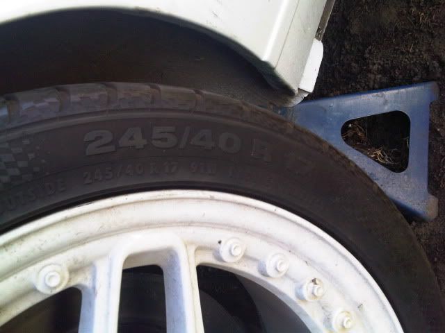

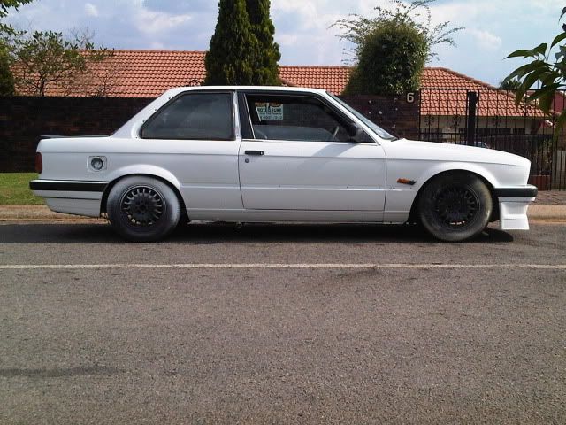

      So I got it back down onto it's wheels (not after it tried to kill me tho!) It looks good, but the wheels are very very tight to the fender, I've got to options. 1 is to machine 10mm from the 20mm spacers in the rear and the other is to pull the fenders a bit more, both are viable options as I'm going to still paint the car again as I'm not happy with the paint job.

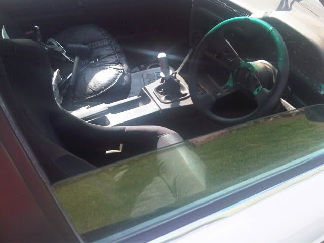

      Then I've also started working on the interior, this is a quick snap to show some of what has gone into it, the wheel and knob are the same as in the race car.

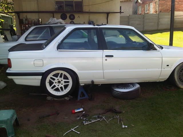

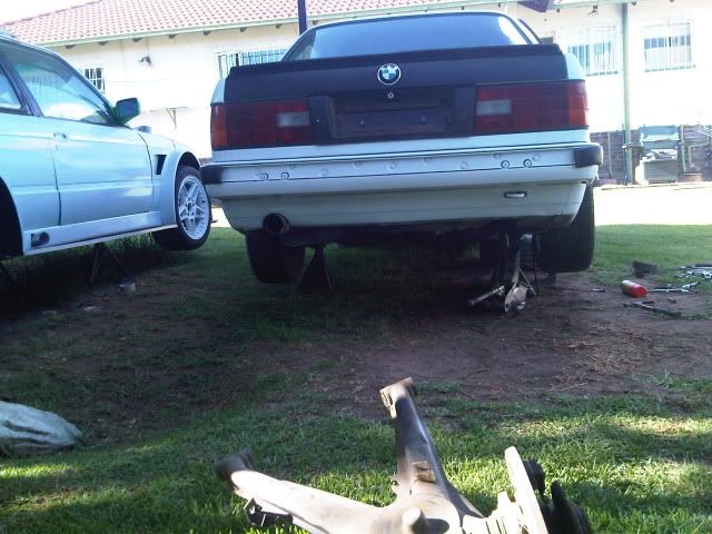

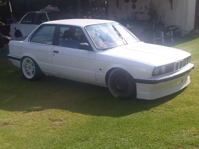

            So finally after much deliberation. I pulled all the spare suspension for the race car and fitted it onto this car. It has e36 coilovers, tubular arms, e46 rack, and AP 5000+ brakes... essentially the exact setup as the race car, except i'm running the softest spring thast we had for that car which is 800lbs.... eeek!
            Now, I just need to find a set of wheels for the car. I've found a set of ARC-8 type wheels this side, but now I need to find out if they have e36 17" fitment. I plan on running 245/35/17 Toyo's as the current 245/40's are a bit tall.
              I believe they do have the arc8's in e36 fitment. I do like the wheels on it though!
                If you look closely at the rear wheels they extend past the arches by 50mm or so, as they are the wheels from the race car. If I could find another set I will fit them but I will remove some off the back spacing, to give it a 42 offset.

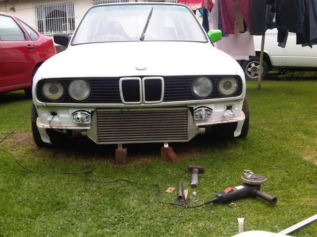

                  I'm starting to research and collect parts for the motor, it's not going to be too crazy I guess. Just going to boost the m10 on stock components up to 1bar.
