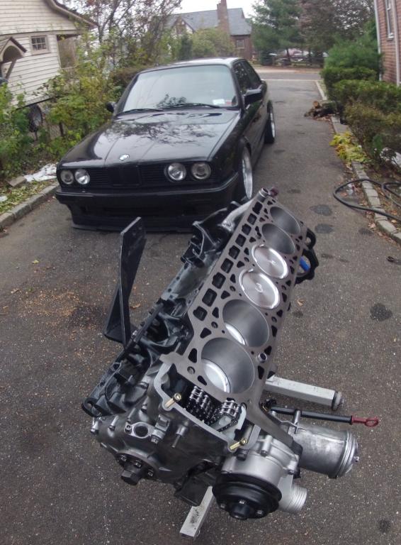

    Little update on the s38. Bottom end mostly together. Ill post up more pictues when I get some time.

                            I ran the VIN on the engine recently and what I saw kind of disapointed me. The M5 the engine came from had quite a past. It went from Minnesota to Florida then finally to PA. In 2010 it was sold in an auction with 215K miles. Slightly more then the 170K I was told. Shit.
                            So after the engine came back from the machine shop the first time I realized that I never had the mains line honed which is necessary when using ARP main studs. The studs are torqued to 60ft/lbs instead of the stock 14-18ft/lb +50 degrees so the journals could potentially be out of round. 200 dollars and a few days later the block came back to me.
                            Gave the block a nice gloss black coat of paint.
                            Checked the cylinders to make sure that they were what they were supposed to be. 3.697" Took measurements in 6 different locations to make sure it wasnt out of round or tapered.
                            Had the journals polished. Rechecked the journal measurements and the main bearings to make sure my oil clearences were around .002" like the machine shop said they were after the line hone. Measurements checked out and confirmed with plastigauge.
                            Installed the new timing chain sprocket. We managed to slide it on after heating it in a toaster oven. Torqued down the caps.
