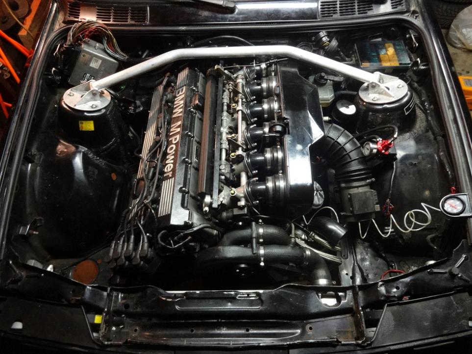

    I was able to get a few more things done in the last two days. Coolant manifold, t-stat assembly, distributor and wires, fuel rail and injectors.

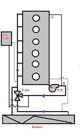

    Basic diagram made of the coolant system. Not sure if im going to install the expansion tank on the passenger side yet. If I do i wont have to run some lines across the bay. I will not be using a heater core. It looks like in the original setup water came out of the exit of the water pump, labeled B, through the heater and into the back of the engine labeled A. Can I just block them or should I run a hose connecting them? From what I could see blocking them would be fine.
Name:	cooling system s38.png

                  Originally posted by ttrousdell
                  [ATTACH]70712[/ATTACH]
                  [ATTACH]70713[/ATTACH]
                  Because the thermostat is appears to be a recirculating design, you probably won't have any problems with extended warm-up time by removing the heater core circulation.
                  However, I don't think running without a heater or core is a good idea in a street car. You won't be able to defog your windshield, for example.
                  A couple of years ago, the heater core in my '92 E34 sprung a leak, so I looped the lines temporarily until I could tear the dash apart to replace it. I had to go on a 4 hour drive at night in early April to my new drill location in southern PA. Thank goodness for heated seats. That drive sucked, but would have been hypothermic without the seat heaters.
                  Limiting yourself to only being able to drive the car on bright sunny days with low humiditiy is... well... limiting.

                              If you block off the driver side of the the system, how will you loop the back of the cylinder header outlet into the system? That aside, without the core in play you'd have a significantly less efficient system without the ability to use the heater core to release heat, you'd have no cabin heat or a way to instantly help bring down engine temp and it is also more difficult to know when your system is bled.
                              The heater core has already been removed from the car. I dont intend to ever make this car a daily again so the inconveiniece of no heat or defogging will not be an issue. I decided to plug both the holes, one in the back of the head and the other at the outlet of the water pump. Yes i will lose the ablity of the heater core to help with cooling the engine but that is not its main function anyway. My radiator and fan should have the ablity to remove enough heat from the system without relying on the heater core. Maybe it might be harder to bleed. Ive never tried to bleed a car without one.

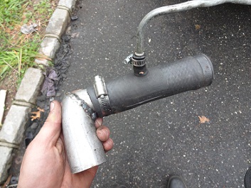

                              Plug for outlet of water pump. Similar one was used for the outlet in the back of the head.

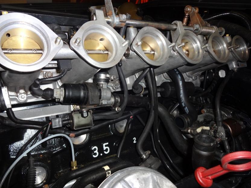

                              Under plenum mess. Using all new vacuum lines since the others were completely dry rotted.

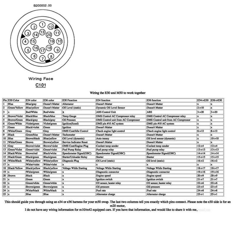

                                Unlike the M30B35 swap where I was simply able to use the M20B25 harness, this swap forced me to use the S38 harness and consequently repin the C101/X20 connector. It also didnt help the the harness was messed with so certain things had to be figured out that otherwise woulnt have been an issue. The diagram below is what I used to distinguish the pins on the e34 side of the connector. Note: C101 is the 20 Pin connector found on the e30 while the X20 is the 25 pin found on the e34/e36.
                                89' M20B25 C101
                                1. Alternator Charge - BU
                                2. Oil Level - GN/YL, BU/BK
                                3. Not Used
                                4. Cool. Temp - BR/VI
                                5. Oil Press - BR/GR, BK/BR
                                6. O2 Heater - GN/WT, GN/YL -12V
                                7. Ignition Coil - GN - 12V
                                8. Fuel Rate(econo) - WT/BK,YL/WT
                                9. Tach Signal - BK
                                10. Oil Level - BU, VI/GN
                                11. Inspection reset - WT/GN, WT/BU
                                12. Check Engine - GY,BR/BK
                                13. Fuel Relay - GN/VI,VI/RD 12V
                                14. Speedo- BK/WT,BU/YL
                                15. Unloader- BK/GN
                                16. SRS/Not used
                                17. ABS
                                18. Starter - BK/YL 12V
                                19. Not Used
                                20. Not Used
                                Repinned the connector to give it a nice stock look. Just match the wires that have the same function. Its that easy once you know what wire is for what.

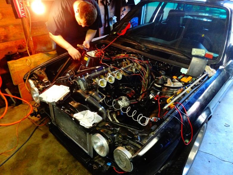

                                The brains of the wiring operation, toointoxicated60. Id probably still be scratching my head trying to get this thing to start if it wasn't for him.
                                Sorting through the wiring. O2 heater, Main, and fuel pump relay shown. Altough we have most of the electical work figured out, we still cant get the fuel pump to run because the ECU is not grounding pin #3 thats connected to the fuel pump relay. Only when we ground it to the shock tower can we get the pump to turn on. I now know why they had the mysterious white wire coming out of the harness (ground wire).
                                Almost done...
