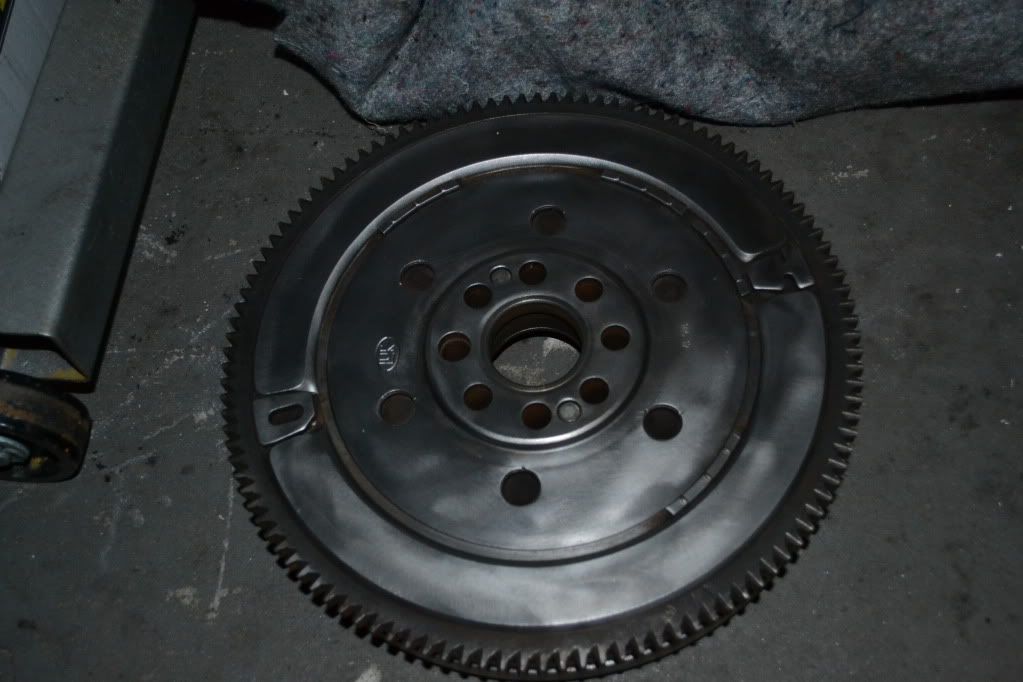

Scored this big heavy thing locally ;)
This isn't going to be a track car so I decided to stick with a dual mass setup. I already ordered the new clutch kit, awell as all the remaining hoses and bearings that I need. I only need 4 more major parts and I will be dropping this badboy in! If anyone has an e36 Dshaft local let me know. I also need a starter, C101 adapter and shorter selector rod.Your signature picture has been removed since it contained the Photobucket "upgrade your account" image.

Oh man, you should have at least gone with a 16lb steel one! No chatter but still great pick up.
http://gripforce.com/store/index.php...roducts_id=210Your signature picture has been removed since it contained the Photobucket "upgrade your account" image.

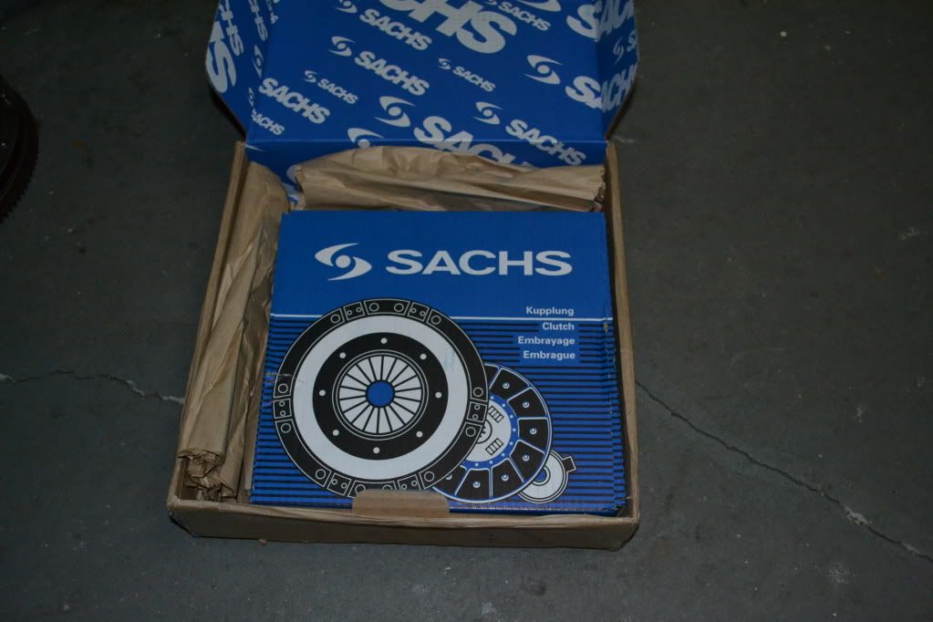

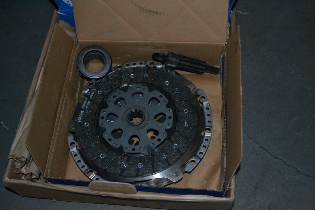

Got the new clutch in the mail!

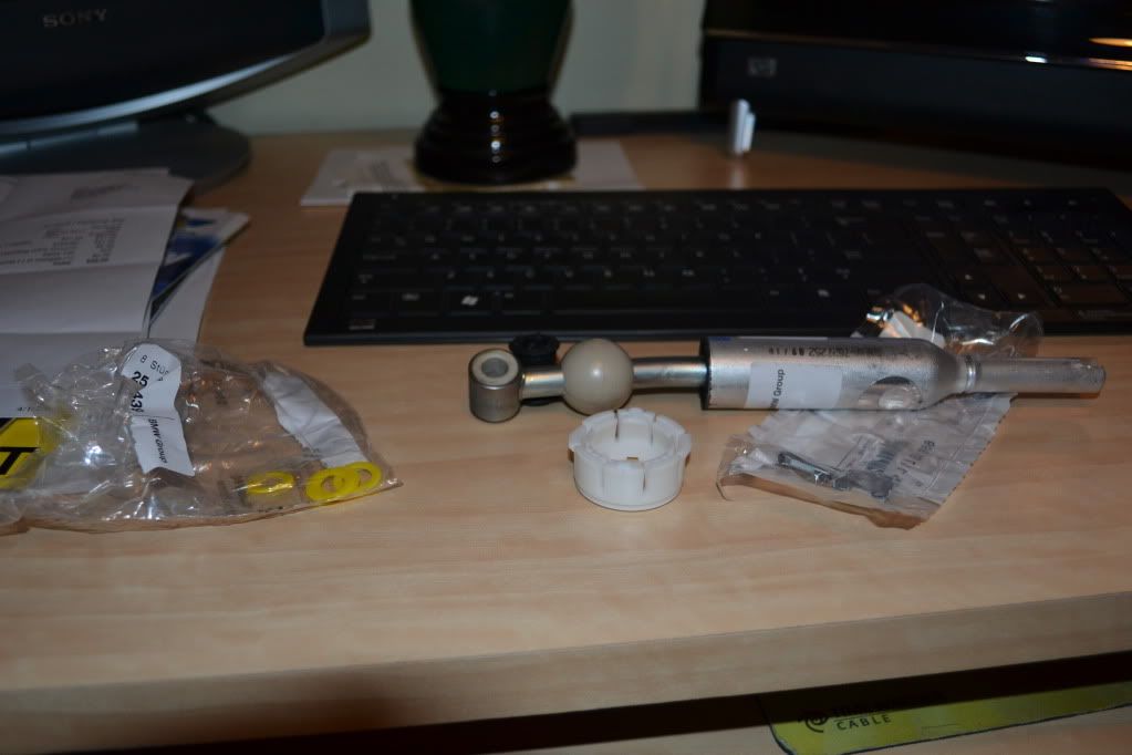

Got the short shift kit from BMA, also awating 320i shift linkage, some bolts and nuts and then will be dropping the motor in. Trying to drop this all in during spring break weekend.

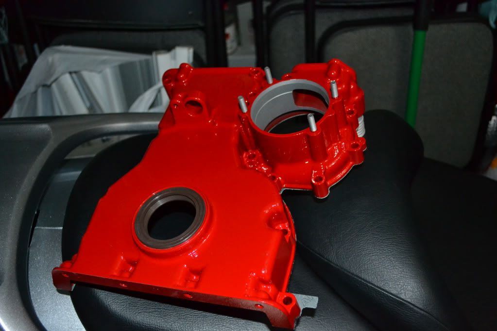

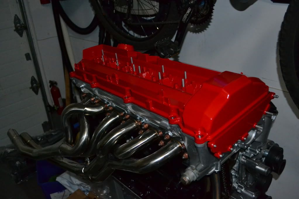

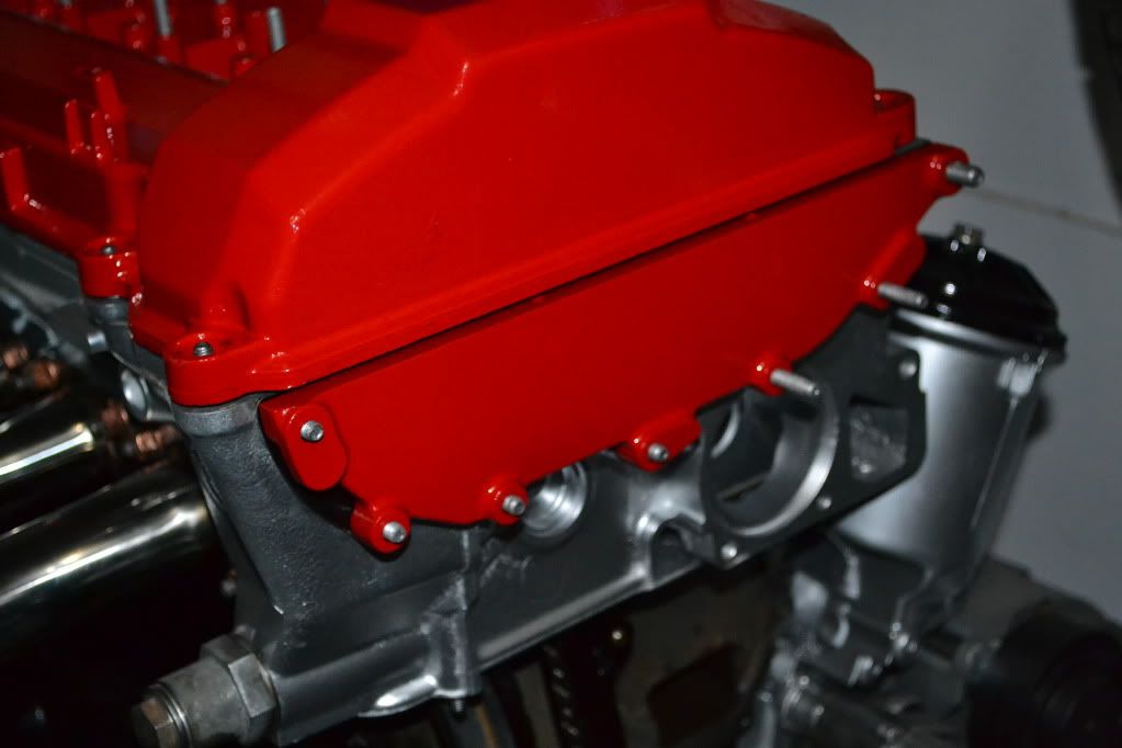

Got my valve cover, front cover and timing cover back from the powdercoater, I love it:buttrock
Now to get it assembled.:DYour signature picture has been removed since it contained the Photobucket "upgrade your account" image.
