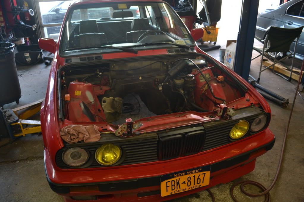

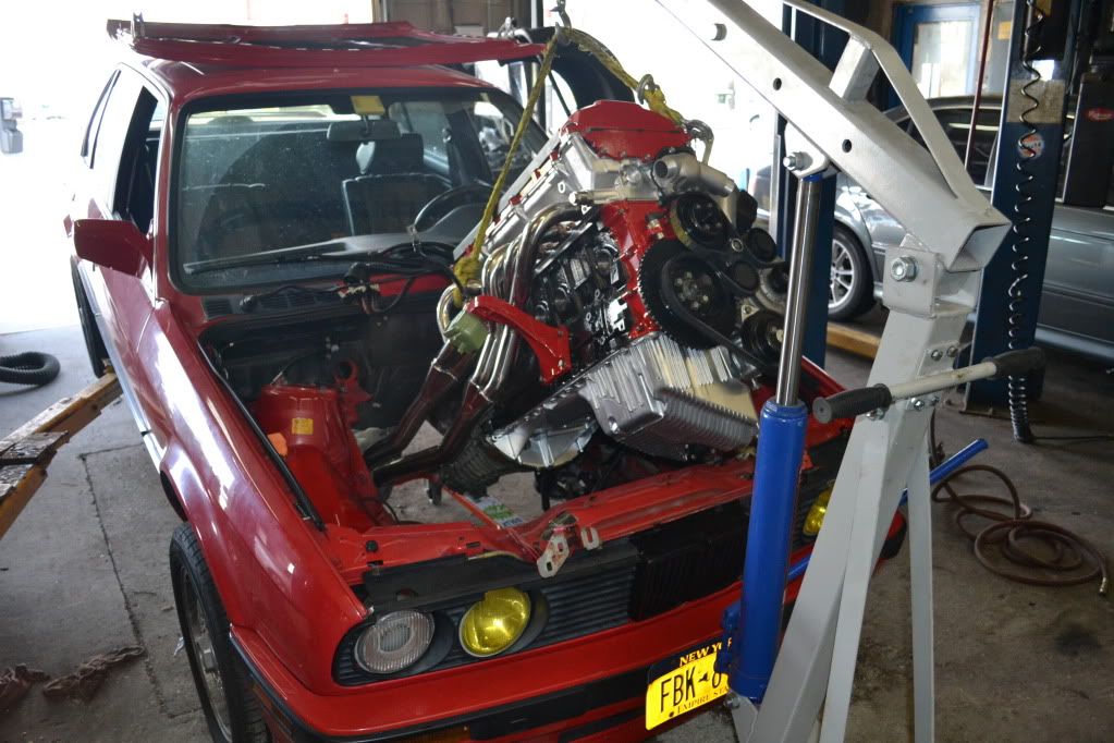

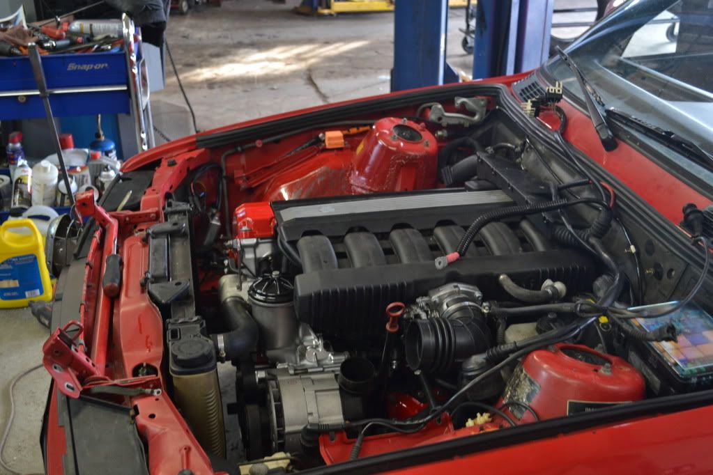

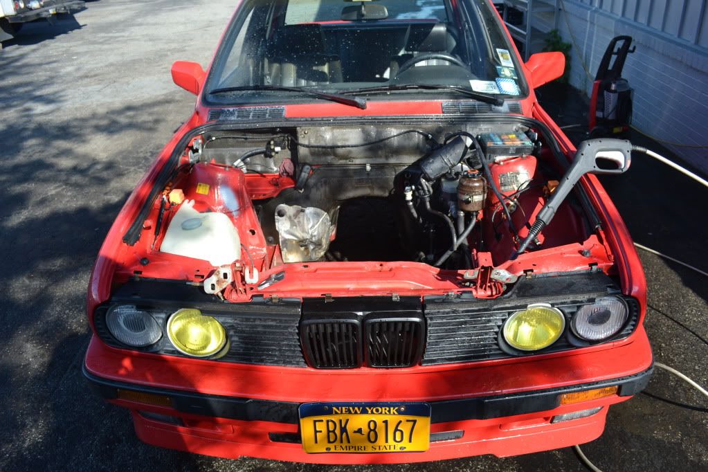

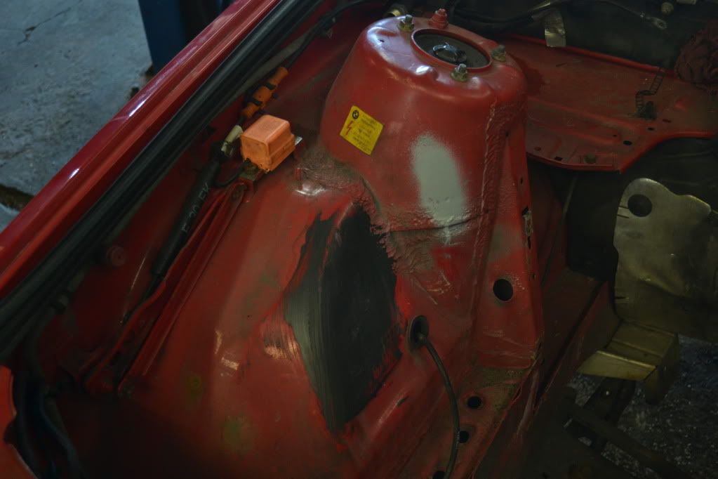

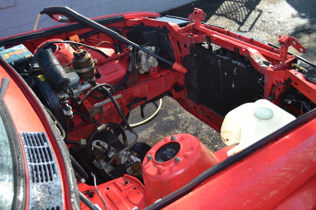

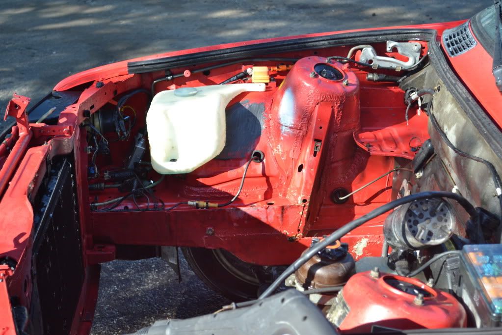

                        Well here are the pics, it took all of 10 minutes to pull the m42 out. Took a little less than 30 minutes to put the m50 in, I couldn't get a load leveler from anywhere so my father and I got handy with the lift, a jack, a dolly and a cherry picker.
                        Oh no, where is the m42?

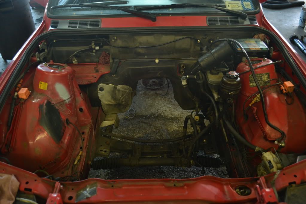

                        Shaved down the coil brackets
                        Power washed the engine bay. Pretty happy with the turnout.

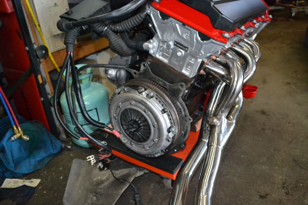

                        Clutch/flywheel on along with the dust cover.

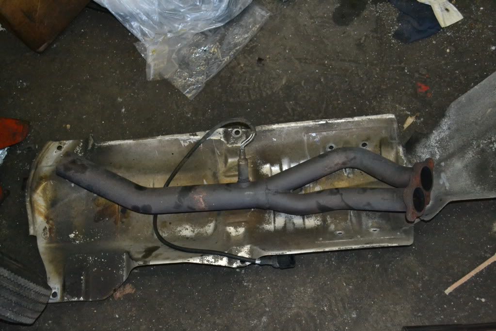

                        I will be trying to use the m42 downpipe as a y, I rather use this than some shitty maglaflow piece.

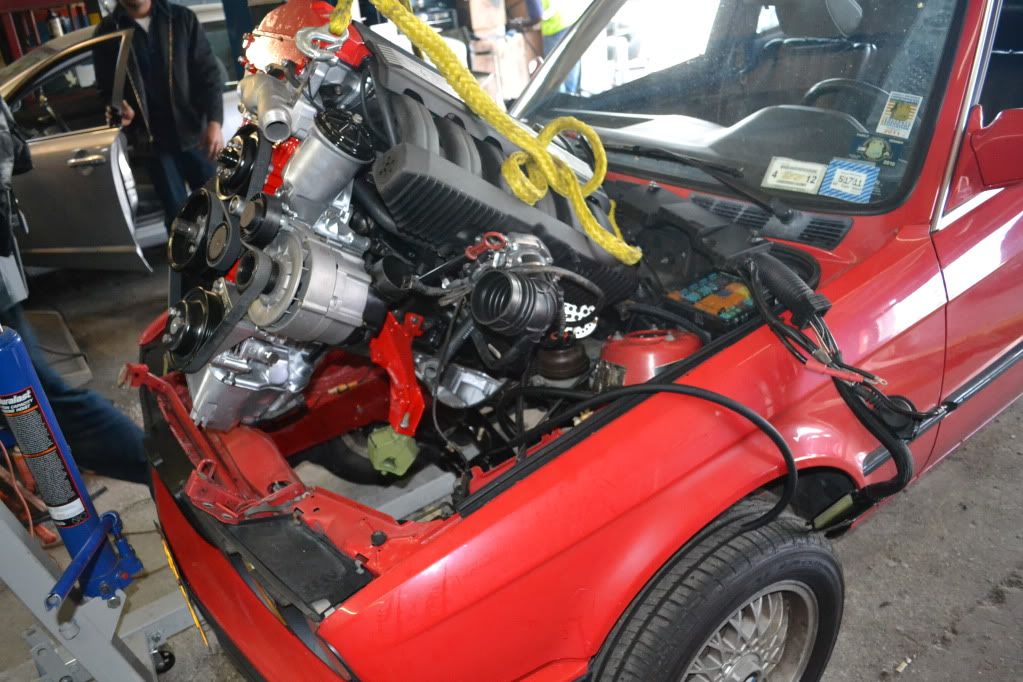

                        Putting the motor in
                        Motor in ;)
                        Plugged everything up and when to crank it, starter clicked, We forgot to power up the starter, connected the wire and it cranked but wouldn't start. Wasn't getting spark nor fuel, Found out we did everything right except the harness adapter is the wrong one, so now I gotta wait for a new one. Oh well, did a good job for my first ever swap. Couldn't have done it without my father, Now all I need is the adapter and I'm waiting on the 320i shift carrier, then everything will be bolted up and taken to the exhaust shop!
