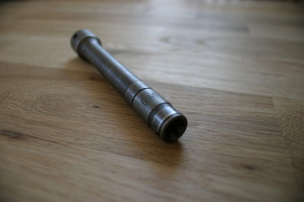

    I will have to buy the long/skinny BMW E12 torx socket as I do not wish to remove the cams. My E12 is too fat to get in there.

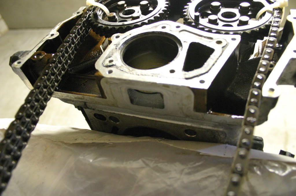

            Pulled the timing chain guides/rails, and cylinder head this morning. I went to the dealer before hand to see if I could buy the Long E12 to remove the bolts, he said he had to go check in the back, and hoe comes out with this:
            he says, "Bring it back when you're done".....sweet.

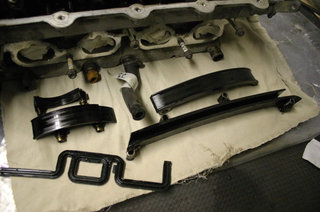

            The rails/guides look to be in excellent condition and I will probably be offering them up for sale as i have already ordered new ones. The profile gasket looks new.......
            I can barely feel the wear with my finger.

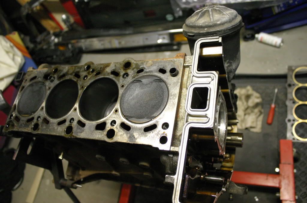

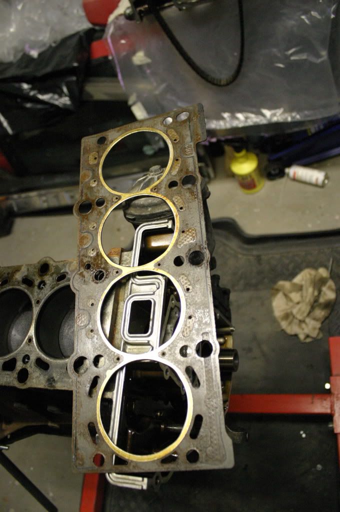

            Head surface on the block and head look very nice. A little carbon on the piston will come off easily with a little oven cleaner.
            BMW Head gasket
            No pitting whatsoever on the profile gasket sealing area.

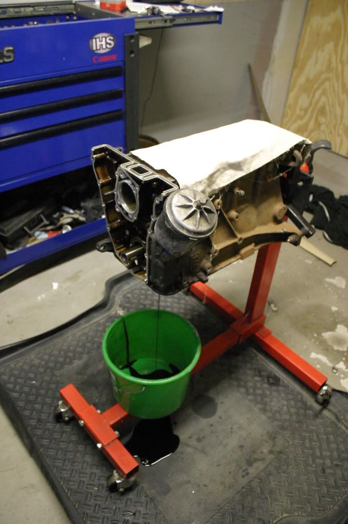

            And here is where it goes awry. First, pull your filter BEFORE the pan, or else you get this mess:

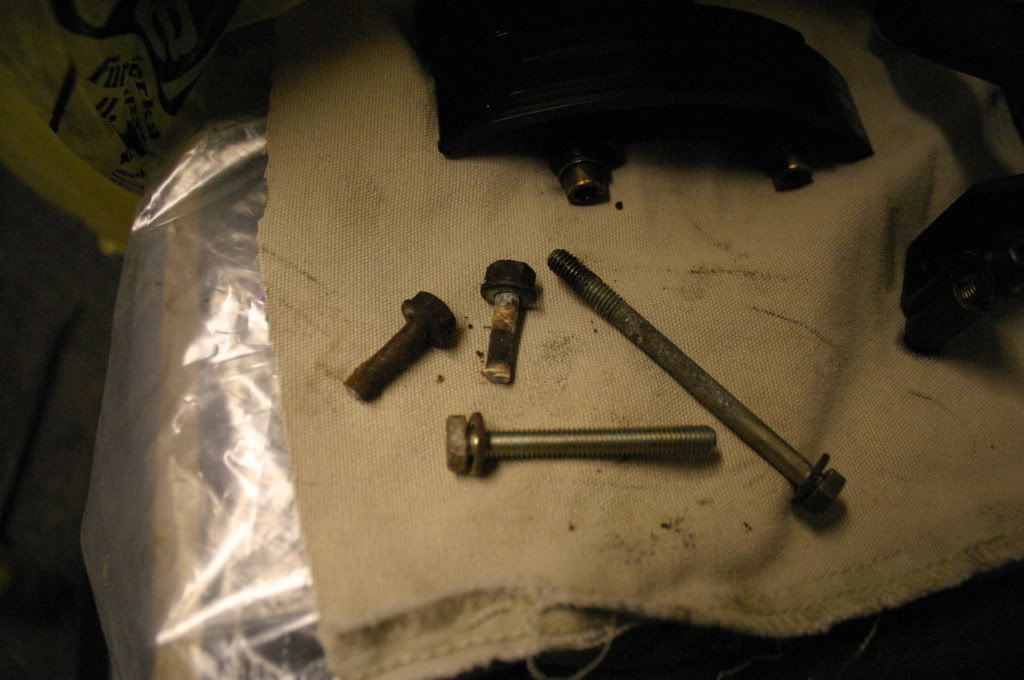

            So I decide to finish today, I will pull the oil filter housing. Right off the bat, with no warning from either bolt, the front (2) lowers break clean off, in the goddamn timing case. And I must have twisted the top front longer bolt at least 3 times before just the head broke off. I PB'd the broken sections so I can work on them next week. Need to pickup some reverse drill bits and a propane torch. I'll heat them then hit 'em with the reverse bits and removers, maybe i'll get lucky.

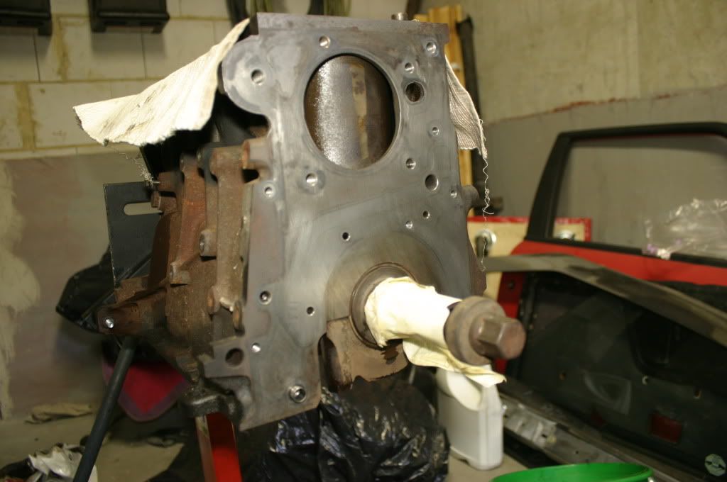

              Well, I had a few minutes today((no pics) and had to know if I would be drilling my timing case....well...
              Last time, I got as far as breaking 3/6 of the oil filter housing mounting bolts. The long top bolt snapped off at the head of the bolt and the lower 2, at the timing case, or so I thought. I used a prybar, gently, and a brass drift/hammer to break the housing free. It was hung up a bit on the longer broken top bolt, as it was cocked from twisting, but broke free after a few solid whacks. As it's slowly coming off, I see that in fact the lower 2 bolts had snapped off and left me about 3/16" of thread hanging out.
              The top bolt was first and initially turned by hand, when it hung up, I grabbed it with some vice-grips and out it came. I shocked the lower 2 with a punch/hammer a few times each, locked the good ol' vice-grips on them and it turned, as did the second.
              I proceeded to pull the timing case, and all looks ok. I will be picking up a few parts from the dealer on Monday morning so I can proceed with reassembly, after I clean all the crap off of the oilpans, timing case, intake manifold/TB, etc. Plus, I still have to redo the input/output/selector shaft seals on the trans, the rubber bushing in the diff cover, and the guibo & CSB.

                  Wow – that’s weird seeing the timing case without the idler sprocket.
                  Ha! I had the same deal with the top two oil filter housing bolts. Snapped off. Torched ‘em, PB blasted. Off with vice grips.

                  fwiw – an E12 socket from a local parts store + standard socket extensions worked for me.

                    No idler wheel in the timing case.
                    Originally posted by Gruelius
                      Holy crap, I did NOT know that!
                      Is there an updated guide rail for M42's or is this strictly for M44's? Maybe its an m44 bottom end and M42 head?
                        I'm guessing it's a different case, but I'm not completely certain.

                          I think it was swapped from a donor motor and new guides were put in, BUT I think they used the old tensioner for some reason. It rattled a bit when I first heard it run. I also think they left the original oil filter housing on it due to the corrosion on the bolts.
                          I replaced the oil pump rotors and cover b/c they, like the oil pressure relief valve, idler gear, and profile gasket are a weak point on the M42/M44. They're relatively cheap at about $70 for the rotors & cover, plus a couple extra $$ for the timing case gasket. Also, I didn't have to buy an M44 case so I don't mind spending the money.
                          Your welcome on the help, I just thought it looked 'not right' and it bugged me, even though it was 1am and I just got home from work. After doing DSM/4G63 t-belts for so long, I understand the insanity that comes from repeated attempts at setting timing(f'ing oil pump sprocket always had me scratching my head).
                          See above, the case is M44 but the rest of the guides, save for the M44-specific deflection rail, are the same. The oil pump rotors and cover are also interchangeable. I have the updated( I hope) oil relief valve coming as well. I will also be ordering the updated(I hope also) lower thrust bearing shell. If it is not, I will be ordering the lower-half(pan side) M50 thrust/crank bearing. The M42 and M50 block side are the same # so the pan side must fit.....I will be letting you all know what I find. I still have to pull the crank journal cap and inspect the crank for wear.

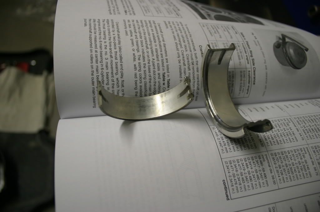

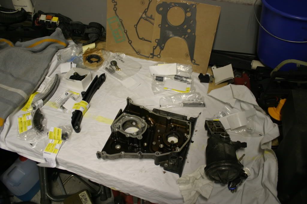

                            I stopped at the dealer a few days ago and picked some parts...
                            From top left, oil pump/cover/coverbolts & new bolts/o-ring/gasket for the oil filter housing, then the updated oil pressure relief valve parts, and on the bottom brand-spankin new guides and tensioner. Against the wall, the E36 metal cover gasket and the timing case gasket.

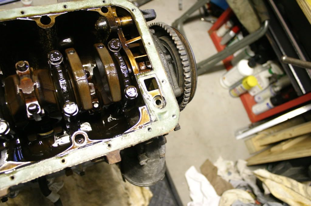

                            Also picked up the M50 pan-side thrust bearing half....in standard size in the corresponding color.
                            The old bearing shows little to no wear, and the new bearing to the right.

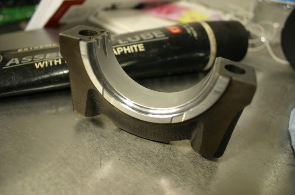

                            And in the cap.....
                            A little assembly lube and 43-46ft-lbs later, it's in. The assembly turns smoothly as well.
                            Cleaned up the block-to-timing case surface as well, and that's where I left off today.

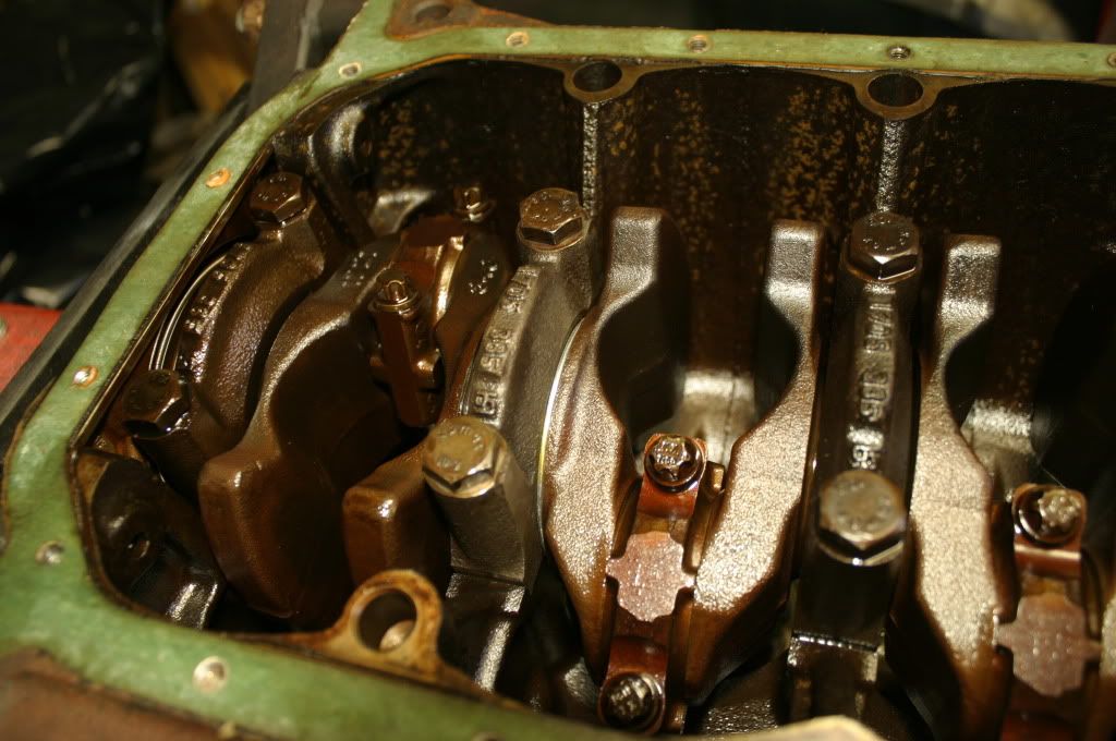

                                I prepped the block for the head, cleaned the crud off of the pistons with 3m green pad and Spray Nine Grease-off. Also prepped the bottom end for the upper oil pan and ordered an oil pump pickup gasket. I also had to find some Loctite for the oil pan bolts, etc.
                                I also took the timing case & covers, oil pans, and intake manifold(after fighting the fuel rail for 20 minutes) to the self car wash and gave them a good once over.
                                I will have pics tomorrow evening. I did the rear main seal and it's metal housing gasket yesterday. I plan to install the updated oil pressure relief valve, new oil pump & cover tomorrow, then the timing case. And If I have time, I will do the pans as well. Then the head later this week, and with any luck I expect to have the motor(minus the intake mani) done by this weekend.
