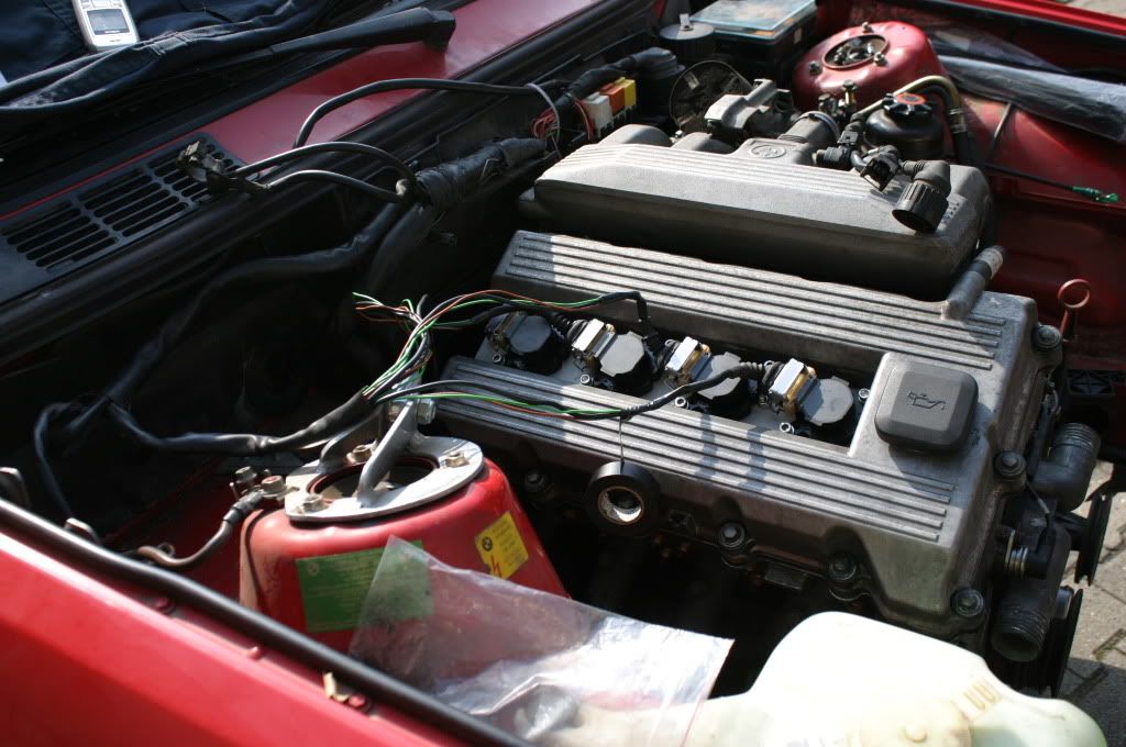

        Well, at 4:58pm local time, she started up after 3 cranks and settled to a steady idle. I had to shut it down after 5-6 seconds b/c I only had the exhaust manifold installed. I have to make a new bracket for the cat pipe, then I will be moving to the rear. The Subframe bushings I installed less than a yr ago have shifted.
        Here are some pics from today:
        Coil wiring and jamming the harness back in the cover:
        Done:

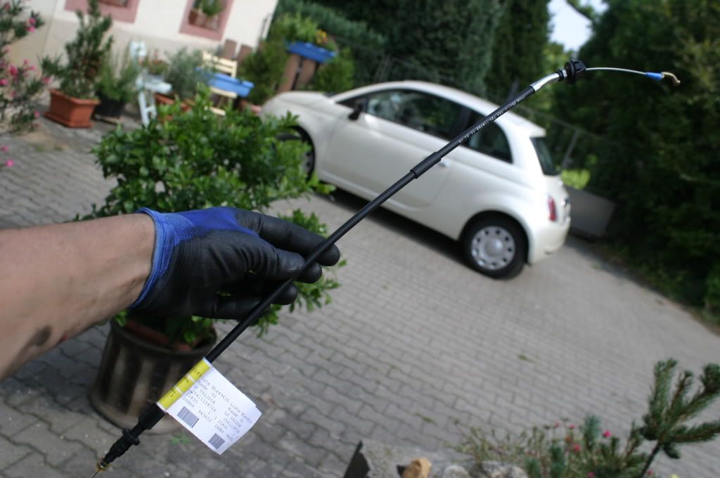

        New accel cable:
        Just before ignition:

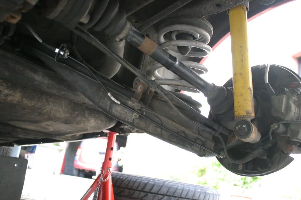

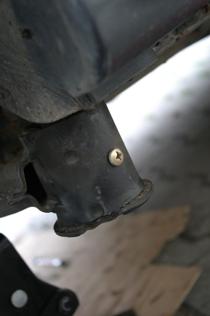

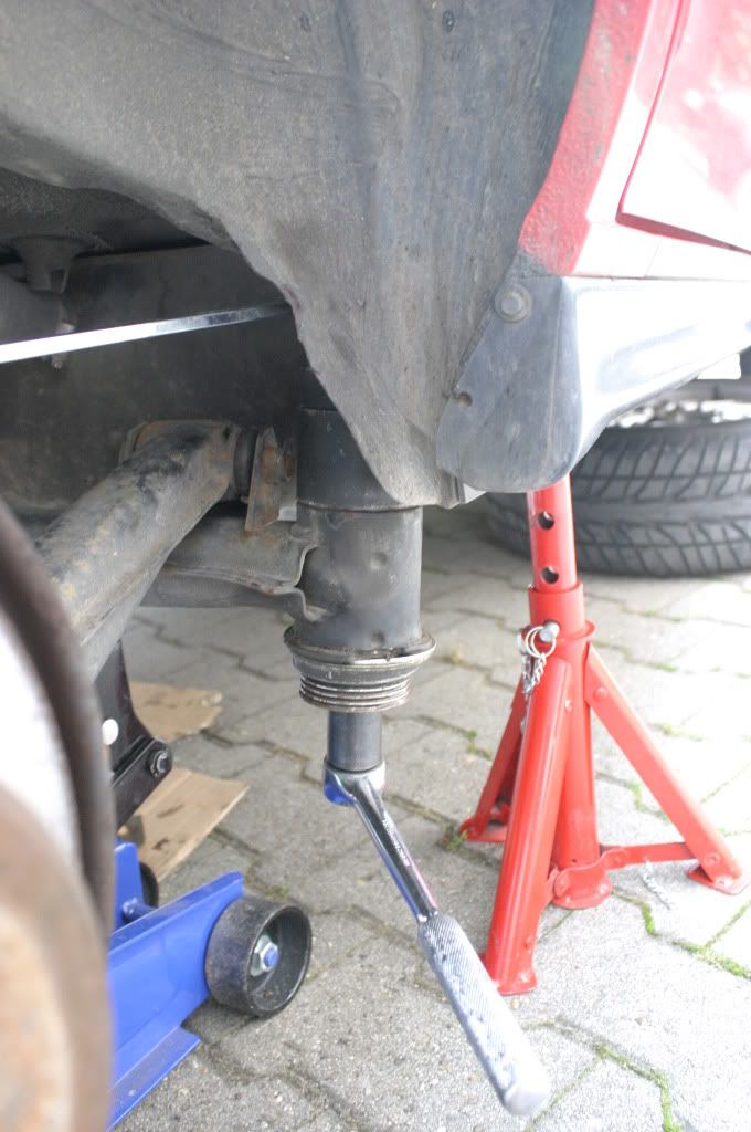

                Sorry for the lack of updates and the lack of pics, I will explain...
                I wanted to wait till the motor was running to tackle any other issues, like the rear subframe bushings. I put the rear upo in the air and grabbed my special bushing installer consisting of from top to bottom, an old serp belt pulley, (2) huge alum washers, M12 threaded rod, an old huge Snap-on socket.
                I reset the bushings, they were out about a cm or so:
                And to make sure I don't have to do this again:
                Drilled a hole thru the carrier and the sleeve in the bushing, drove in what I had handy. When the time comes, it is easy enough to knock the head off and drive the thread through to remove the bushing.

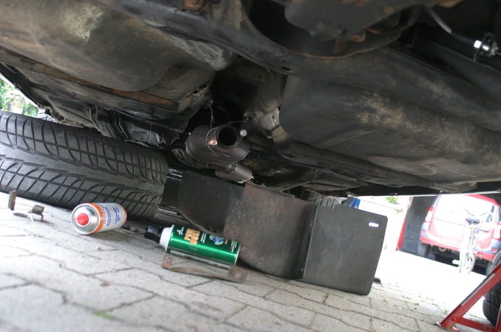

                Next BJ were the rear brake lines. I figured now was the best time to repolace the brake lines since I would have the subframe out anyway. I took advantage of Blunt's deal on the Goodridge SS lines. And sice they are TUV approved over here in Germany, I said 'what the hell'.
                Well, I started on the right side. I cut the rubber line and used a line wrench on the hard line and a 14mm socket on the cut-off side. The line came loose easily also on the trailing arm connection. That was the easiest part for the next day and a half. Moving to the caliper line, the fltting and soft line fitting were completely siezed together. I was badly bending the line to get it loose so I said f' it. But by then it was 3pm on Friday. So I flew over to BMW and ordered ALL new hardlines for the rear, came to about 18euro. So, Saturday morning, I picked up my lines and got to work. Bent the new rear, came out very nicely:
                Then installed the caliper line.
                The other side went like butter and got that done in about 2hrs, yes 2hrs. It is a royal PITFA even with the subframe hanging, and brake fluid dripping on you.

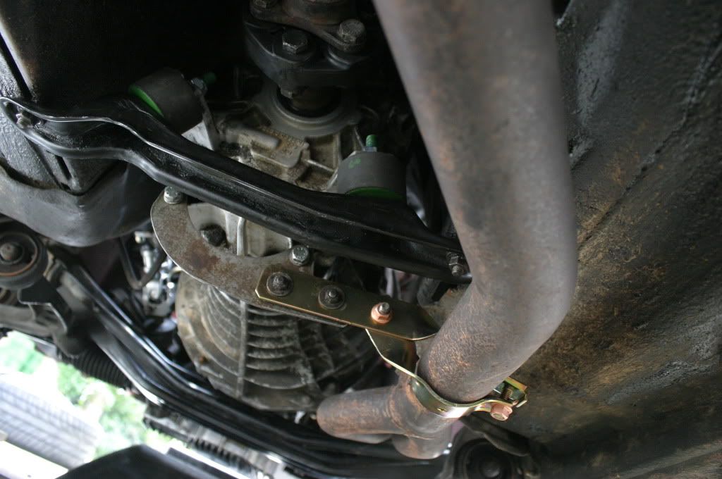

                Making sure the lines sat well I moved to the driveshaft and exhaust. Didn't stop to take any pics really, except these (2). I just kinda aimed the camera underneath:
                I Bought new springs/bolts/nuts, and a fresh exhaust bracket(below) for the cat pipe. Don't wanna put any extra stress on the manifold.
                Here is a bad shot of the new giubo, E21 mounts, exhaust bracket...
                There is a pinhole in the pipe, don't ask how that happened just under the band. I have to head to my buddy's shop this Thursday to use the welder.
                So after that, I hung my overpriced catback with all new rubber rings. The bands for the iS exhaust are larger than those for the m40 exhaust so I ran home to grab one that I had lying around. I ordered another from the dealer today.

                    Wow – you’re all over the place !
                    Nice, tidy job there on the COP wiring.

                    The subframe bushings crept outward? That’s a new one to me.. Clever solution.
