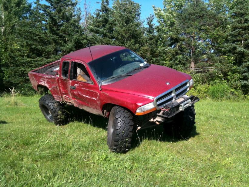

Credentials attached. (571, an Ultra4 car I codrive - 350/th350/np205 tube chassis with d60/14 bolt; the dumpbus, my '97 Ram 3500 tow rig with '01 24v swap, mechanical pump conversion, 13sp Eaton trans; and Roadblock, my '98 Dakota crawler - 318/46re/203-205 doubler and d60/10.25 axles)Leave a comment:
