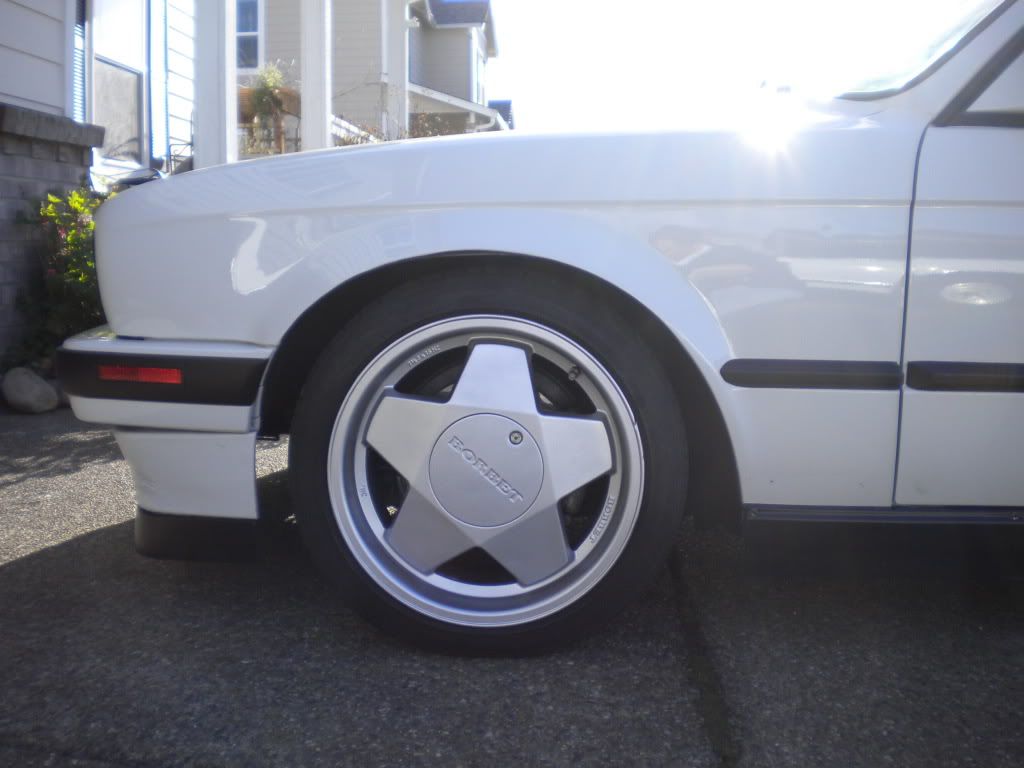

                      Also!!!!! Got some Miro-STPs with basically new Kumho Ecsta XSs on them. Rims are 16x9 et15 with 205/45s on them. Some teaser pics. Looks completely HORRIBLE right now. Ordering GC conversion kit and whatnot sometime soon as well. Obviously, rolling and maybe some pulling of fenders will be needed, but its all a work in progress.
                      Rear:
                      Front:
