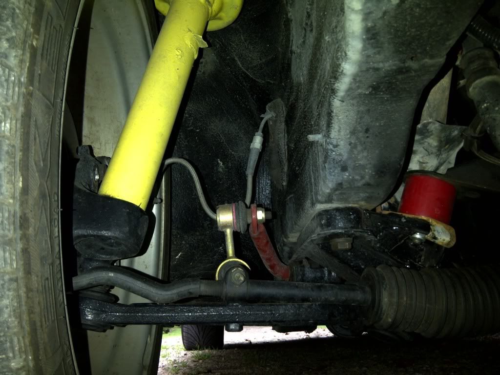

    not much changed except i removed the ABS, and plumbed all new brake hardlines and installed a full set of SS brake and clutch lines.
    working on subframe, T A bushings and Diff now.

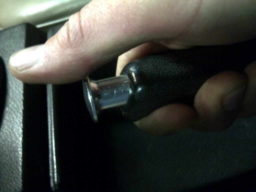

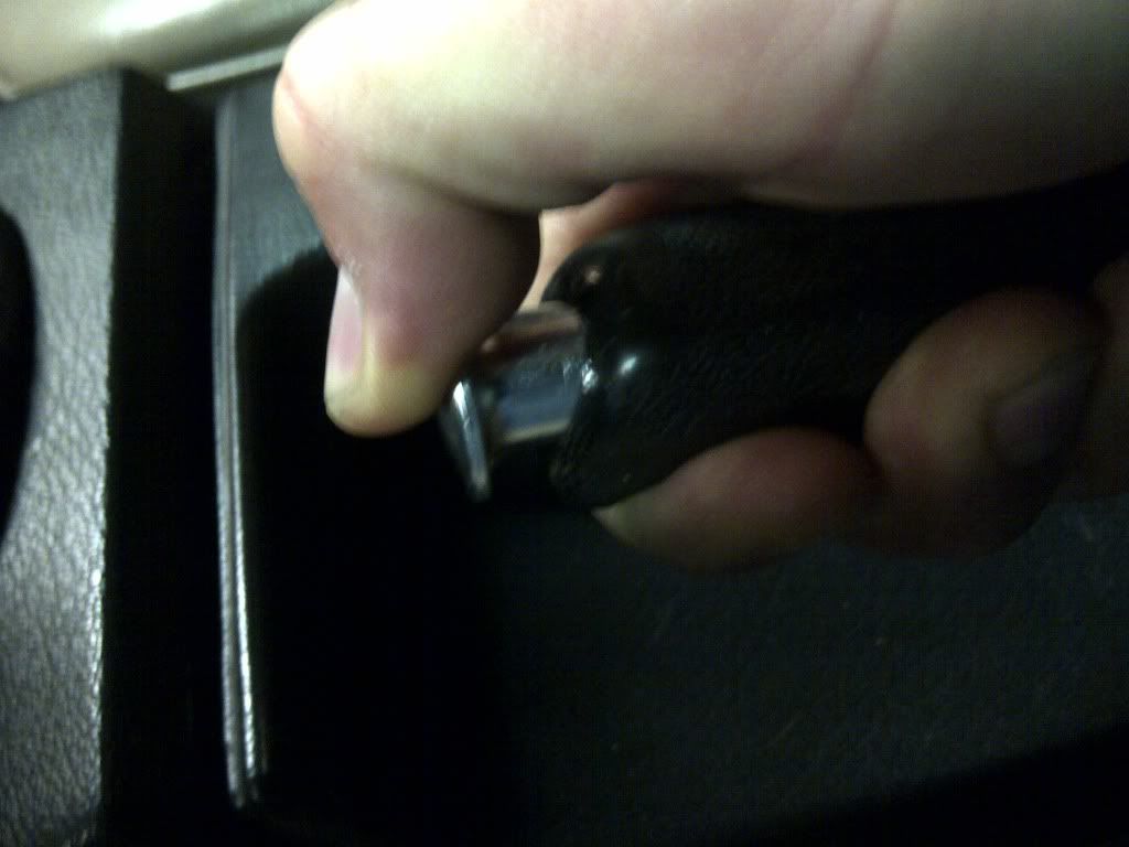

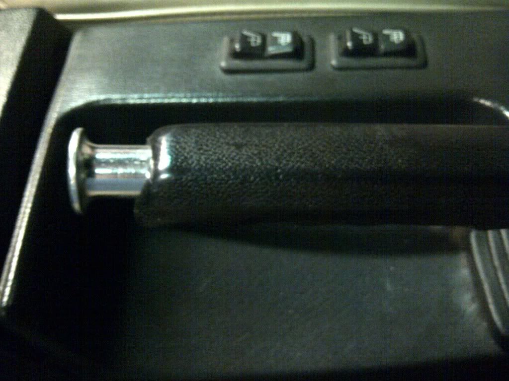

    I have a bunch of drift goodies kickng around for my s13, so i was going through the junk and found one of those bullshit drift spin knobs for the E brake.
    I took the E brake handle apart and fitted the spin knob over the oem knob and JB welded that shit solid. Its more of an aesthetic thing, but it also works

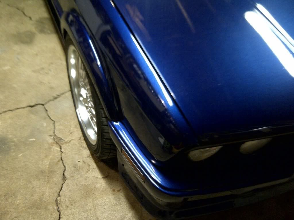

    heres some randoms that i took with my cell last night

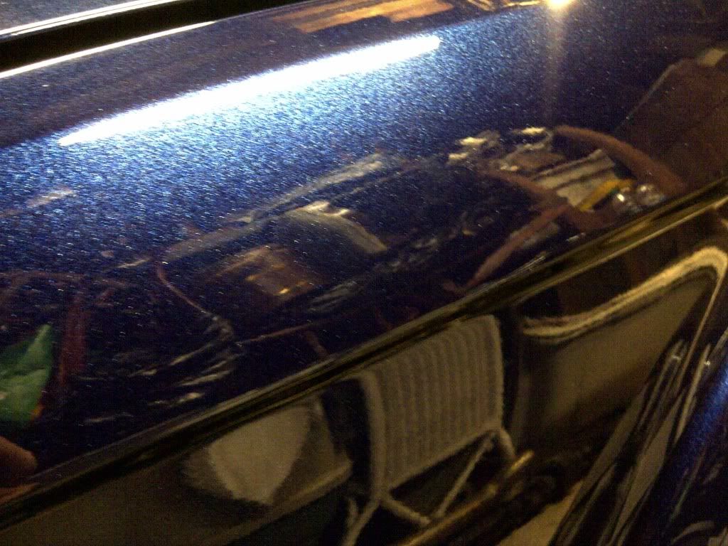

    I fucking love this paint!

      Sweet car! A little too much flake in the paint (for me) but it's a cool color.

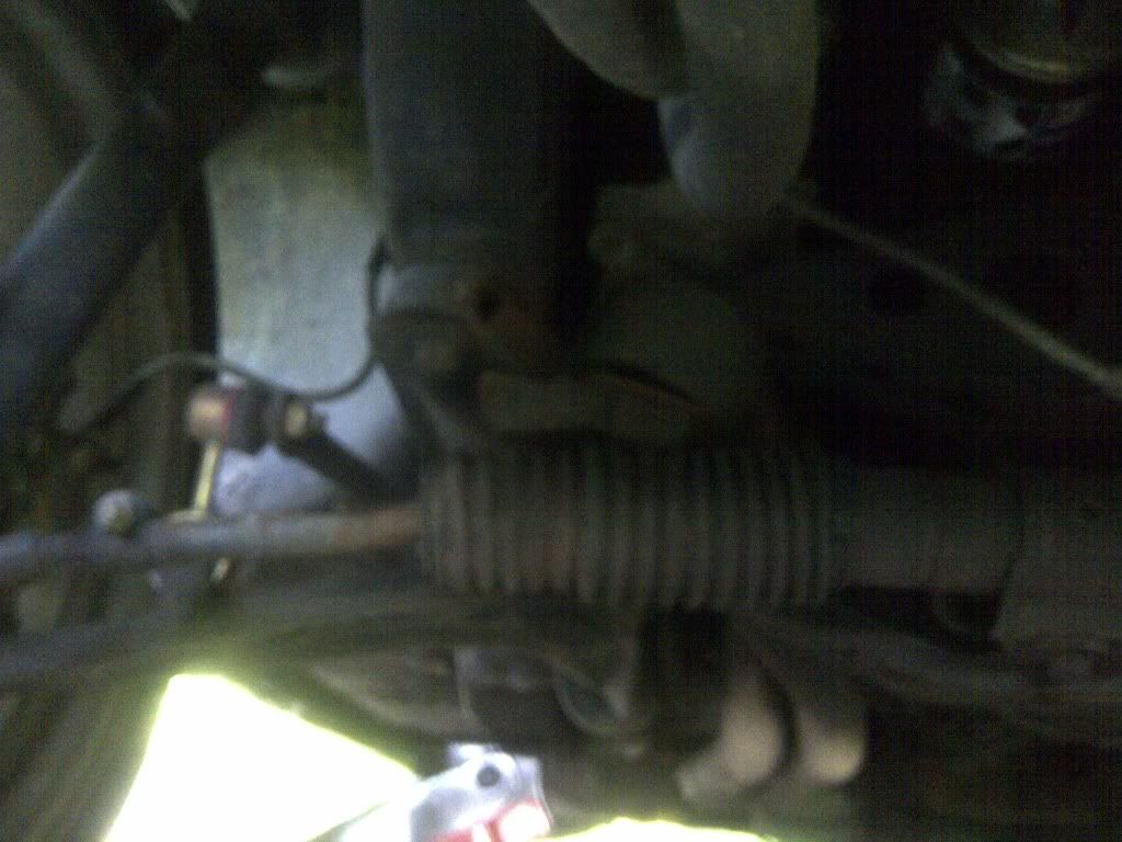

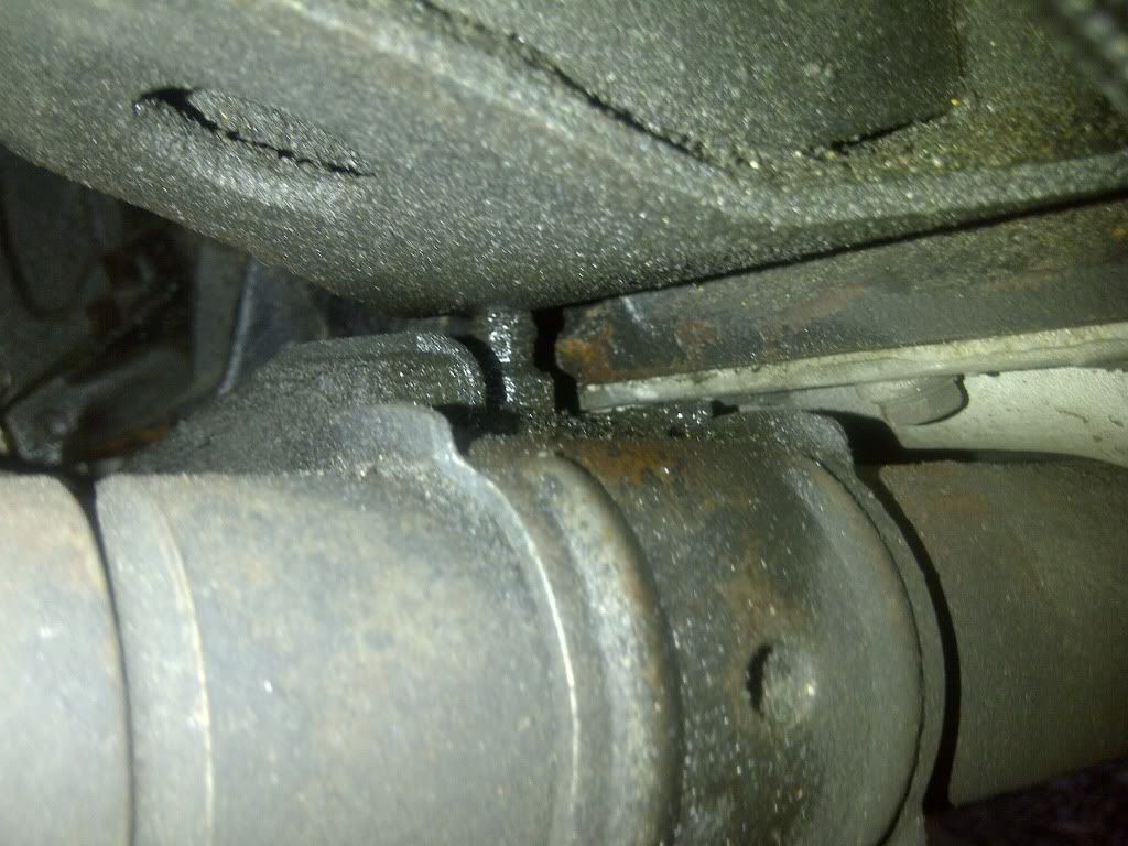

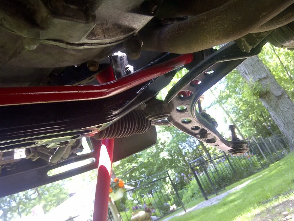

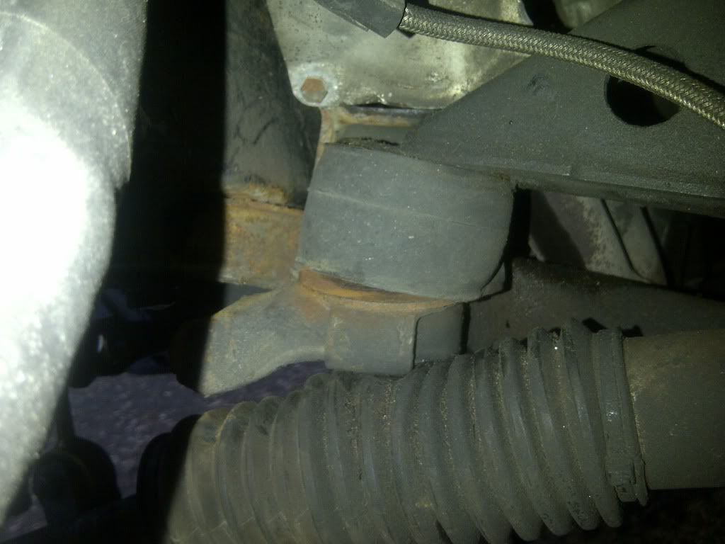

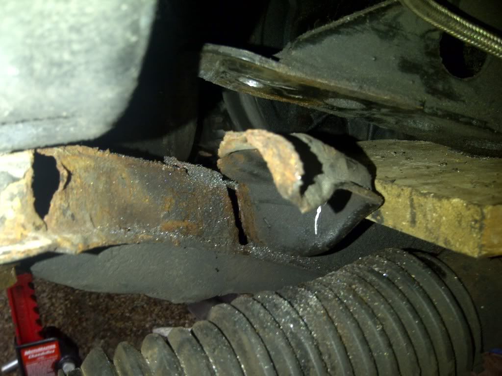

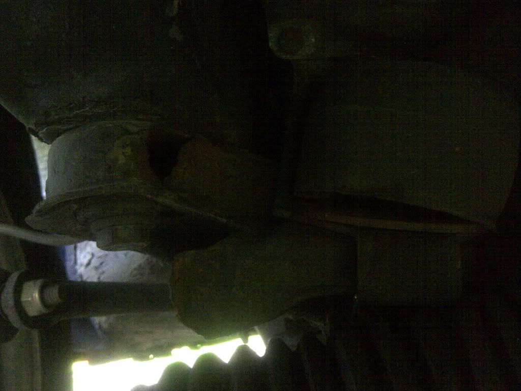

        Disaster strikes
        Experienced some abnormal vibrations and clunks, so took a peak and found some carnage!!
        SAVED BY THE STEERING RACK BOLT!!!

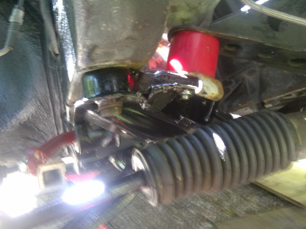

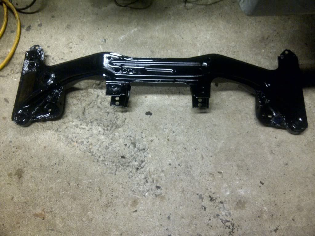

        got to work and sourced a clean cross member, welded some re-inforcment tabs and welds, cleaned it up and painted it, cleaned and painted up some other stuff too....

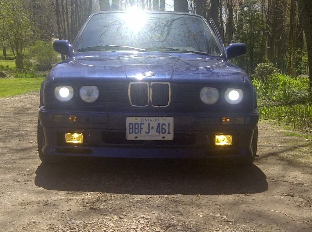

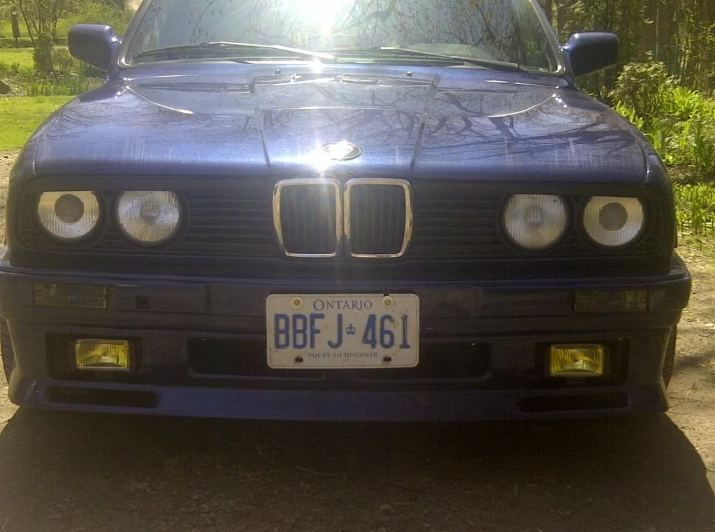

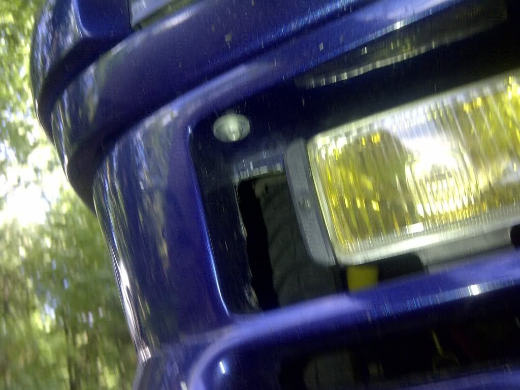

          installed some cheapy frog lights!, hooked up to the OEM switch.
          Next thing up is to figure out some french style yellow highbeams, with the smoked crosshair light set from Ary. Any help would be appreciated

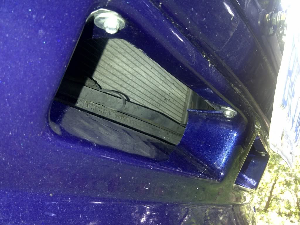

                do you have any pictures of how you mounted the early model lower valence to the late model bumpers? thanks

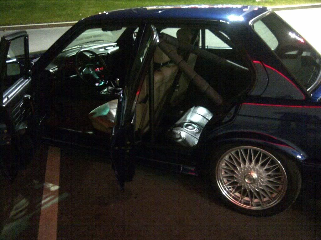

                            me and homie think its soo tight exspecially the picture of all the doors open with the roll cage
                              I literally cut away the existing metal lower valance following the line just below bumper. lined up the ES valence and screwed it into the underside of the bumber, on the sides I used some aluminum flatbar with a bolt under the front lip of the fender where it meets the bumper down to the lower part of the valence. Its not perfect, but I had nothing else to work with at the time.

                                [QUOTEme and homie think its soo tight exspecially the picture of all the doors open with the roll cage
                                all you need is a turbo
                                that ka24 is f#*kin tight ][/QUOTE]
                                Thanks, but it aint no KA24DE !!!

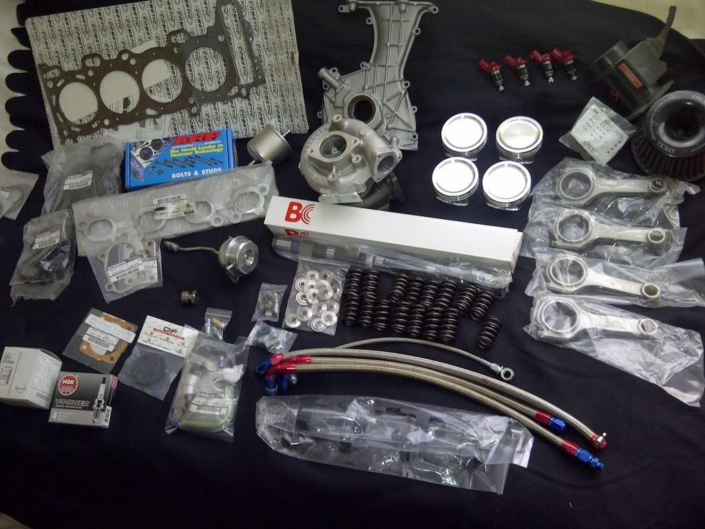

                                heres a teaser of whats taking alot of my time lately, I previously said that i would be building this beast ! wheels in motion now!!
