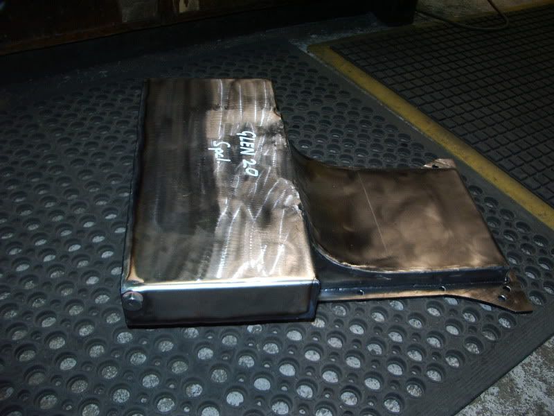

                    Oil pan is done!
                    The drain plug sits just above the bottom of the pan.
                    Here you can see the oil pump pickup and the strainer I used.
                    The coupler is a silicone exhaust coupler off of an RC car. I might switch it to a piece of hydraulic hose though as it isn't as stiff as I'd like it to be and I think the strainer might rattle against the bottom of the pan. It only sits 1/8" or so off the bottom, so...
                    Just need to add a dipstick tube and it will be done. Going to use the stock dipstick and tube and either cut the dip stick or the tube down so that it reads correctly.

                        Realized I made a bit of a mistake when designing the pan.
                        But it can be fixed. Basically just going to re-attach the piece I cut out to make the diagonal part and then just put the drain plug in the very bottom of the pan. I originally didn't want to do this for fear of catching it on things, but the crossmember is going to hang down farther and is in front of it, so I"m not worried.

                          If you move the plug to one side would that allow you to have enough clearance? A great idea putting it where you did. Ive had too many plugs catch so always try to keep them out of the way and avoid the bottom at cost, like on this one for my graphite E30

                            Gonna be hard for me to explain it, but what if you just took the plug out, weld in a threaded shaft cut to 45 degrees on the top to sit flush with the angled part of the pan and have the drain plug exactly where it is, just vertical now instead? Might still be able to keep the head of the bolt flush with the bottom of the pan/trans.

                              Oh, man! That stinks! Seems like I'm always making mistakes like that, but on a much smaller scale. I'd be ripshit, but it looks like you've got it handled. :)
