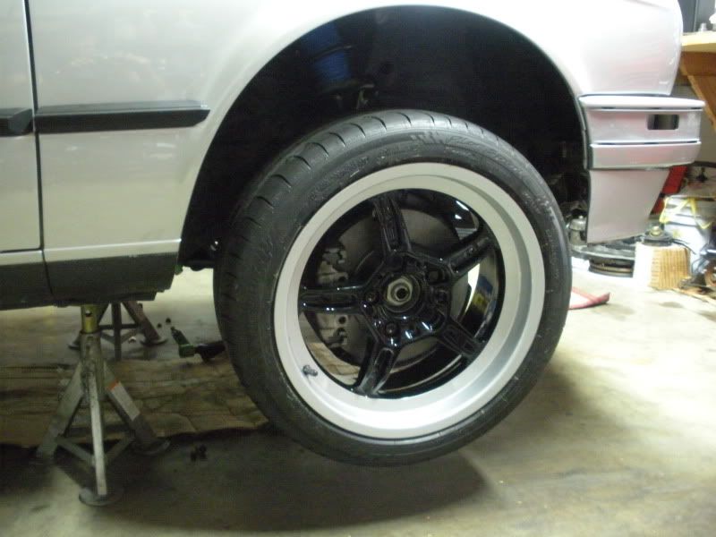

    And finally to bring this thread current to today, I iinstalled the subframe and got my E34 staggered M Systems installed with 235/40/17 (thanks to Kaliboy for giving the nod on the meaty tires)...
    Rollback shots and the culmination of several months work...
    Front shots
    Rear shots
