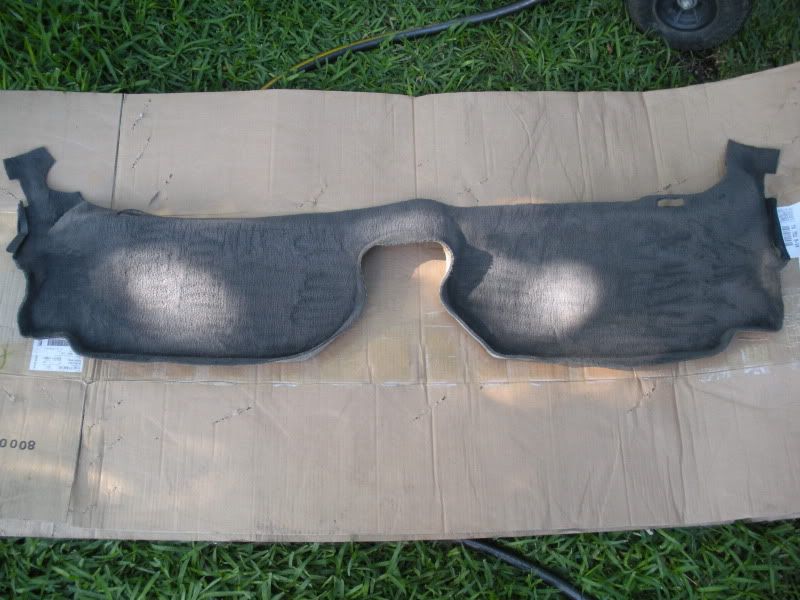

                      Cleaned, scuffed and then used slate gray trim paint to redo the trunk/backseat cover panel. Looked like crap before and was covered with water/mildew rings so really pleased with the result.
