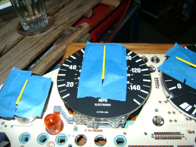

      After I was done cleaning up the the wring some, I wanted to remove the heater box from the car finally. It's way more simple that it looks at first glance. You only have to remove the four nuts in the blower motor compartment and the nut that is fastened to the L shaped bracket behind the center console. Then ease the ac lines and heater core lines out of the firewall....and voila!!
      Cleaned up the dash some more and removed that last piece of carpet
      I also recommend to plug the heater core lines when removing the heater, otherwise this will happen....:loco:
      Oh well tho!! Easy clean up. Now this is the mess that I have on the work bench. Need to organize and clean that up soon.
