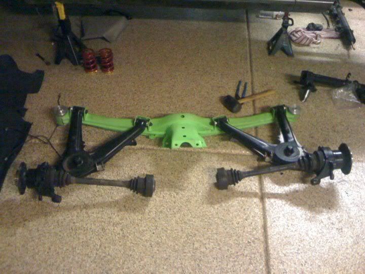

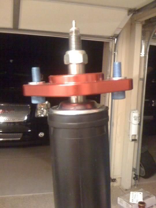

                update!
                AKG Solid Subframe bushes
                E30 M3 TA's/5 lug goodness!
                E-brake deleted
                Monoball TA bushings
                The right boot has a tiny crack and was leaking a little bit. Its nothing major but I do not wanna do those now.. pain in the ass!

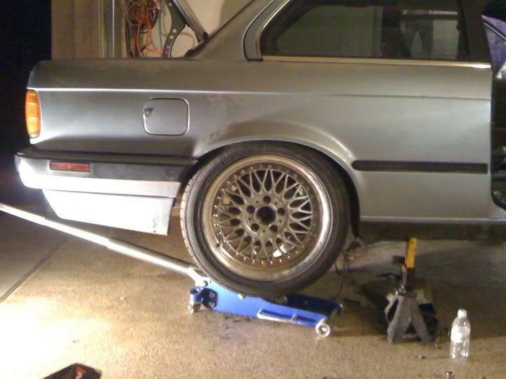

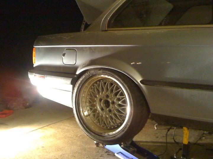

                17x8
                235/45(ithink)/17
                Needs major fender treatment! Adjusters are as low as they go but i barely have the spring compressed at all
                I also have to get some hubcentric rings, which i forgot!

                        Why would you delete the E-brake? Seems like a pretty useful item on a street driven car. The wheels look fantastic, you may need shorter springs in the rear though.
                        • xAZxE30x
                          • 1241
                          Shorter springs?
                          I deleted it just because I did not have all the parts required to put it on and being in Arizona, we don't really have slanted streets. I can't ever think of a time since living here where I had to park on a hill. I know a few e30 guys running without and they said it's never been an issue. If it turns out it was a bad idea then I will slap them on

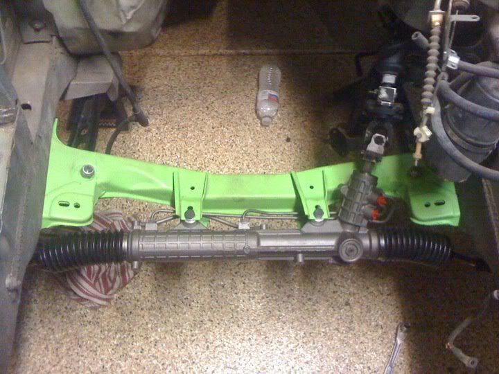

                            I got this bad boy in tonight..
                            I have an airbag car and you most definately have to cut the fire wall. Wasnt able to install the rack without doing so. Took a bit of playing around with it to get it correct. I also forgot my fucking key so not sure exactly if it spins freely but it most certainly should

                                Originally posted by xAZxE30x
                                Shorter springs?
                                In one of your previous posts it said the adjusters were all the way down and the spring was barely compressed. I assumed you meant it was not low enough.
