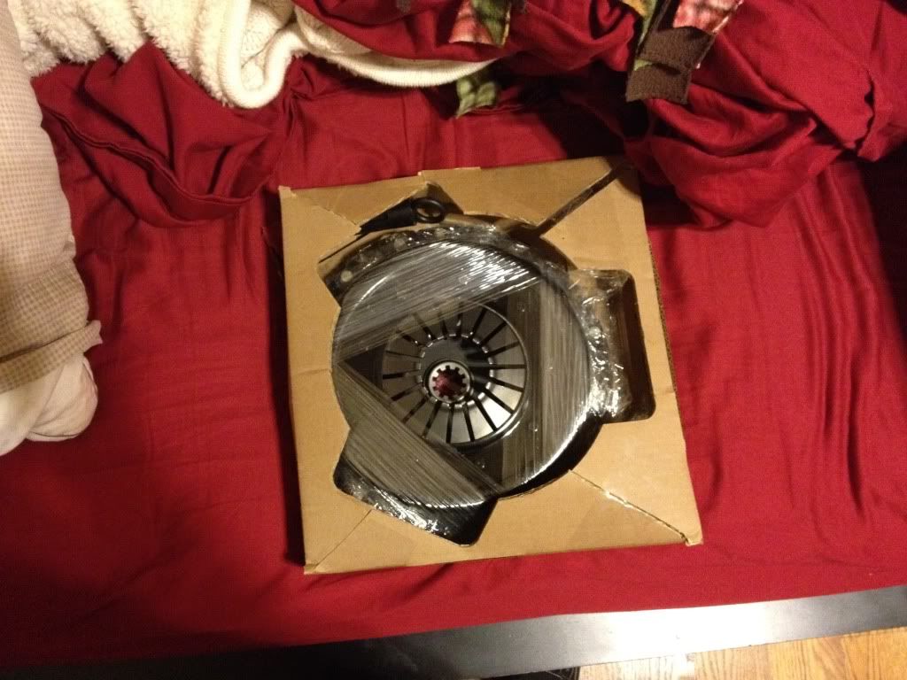

      UUC Segmented Kevlar Clutch

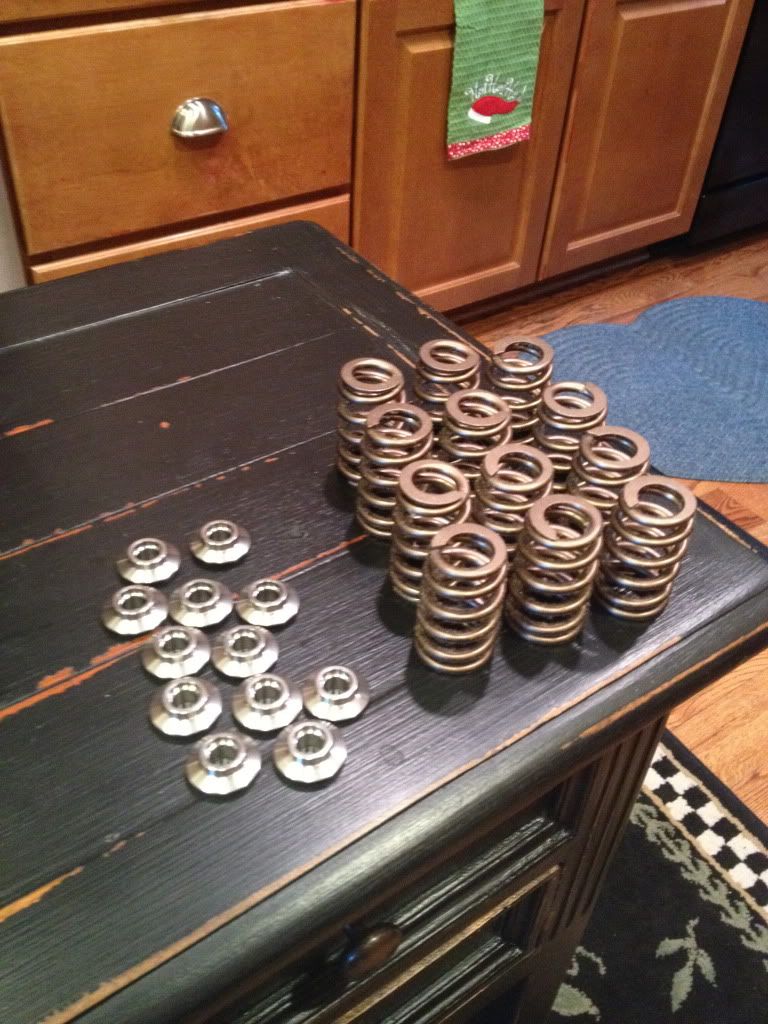

      PAC 1523 Valve springs & PAC R442 TI retainers

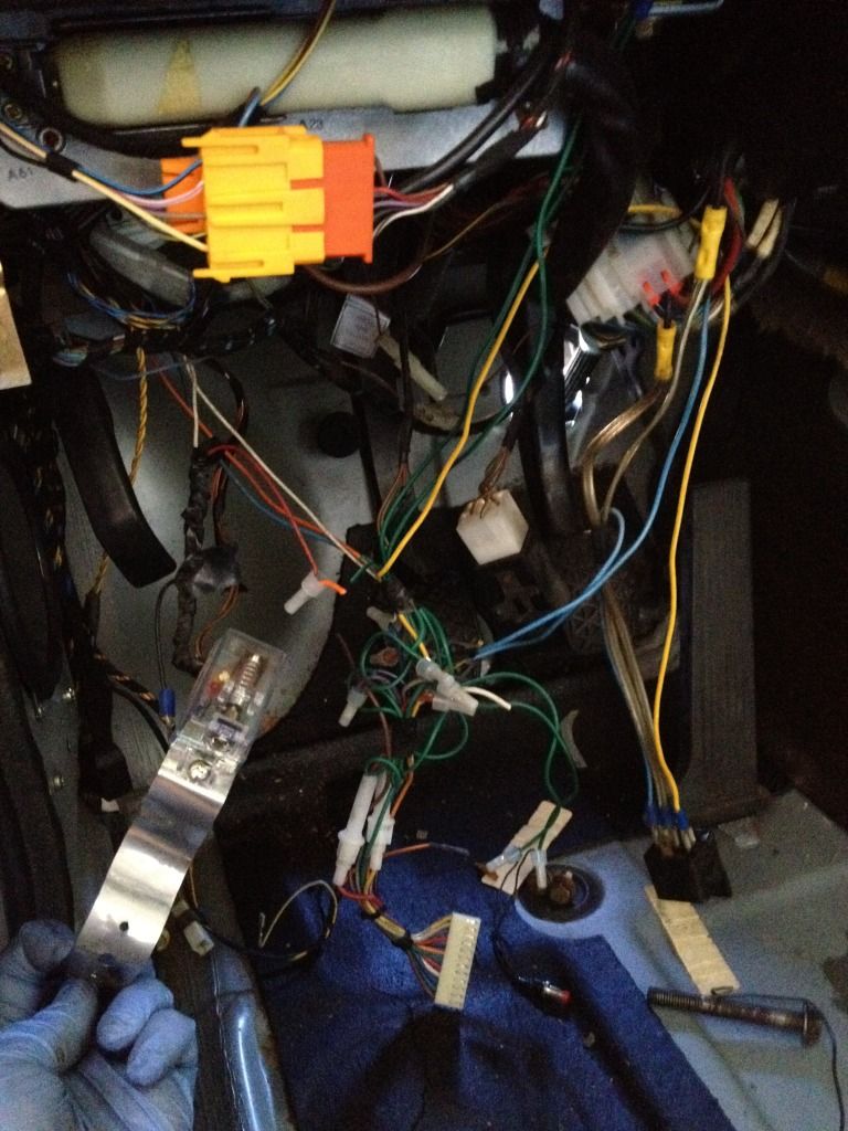

          the previous owner had some hack install some janky alarm so got rid of all the crap I did not need, which was everything seen here for the most part
          I was in the process of putting a new pan on the m20 this past weeked and realized I left my torx at home so couldnt get it finished up. Tomorrow I am going to get the new pan installed and then the engine is all ready to drop into the car. This is just a stock m20 for now. Still working on the turbo m20.. its mostly ready to go just need to figure out my valve spring issue and then it is all ready. I am just dying to drive this thing so a regular m20 will do just fine for now, especially since my 318i blew up and sold off I need a car!

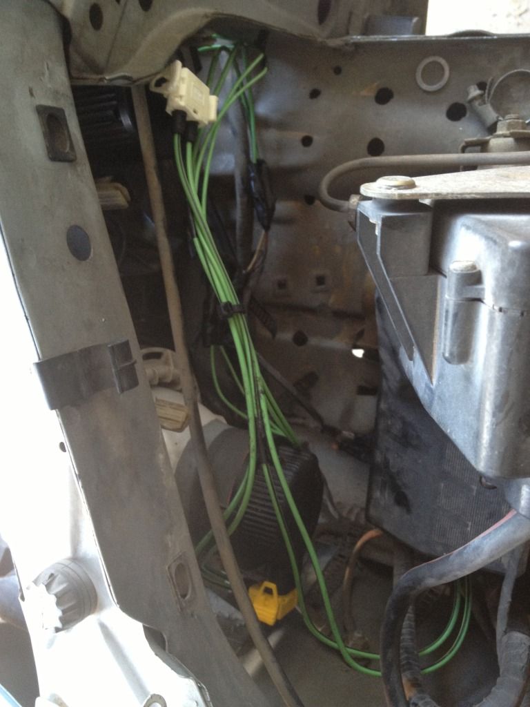

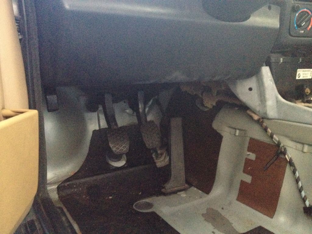

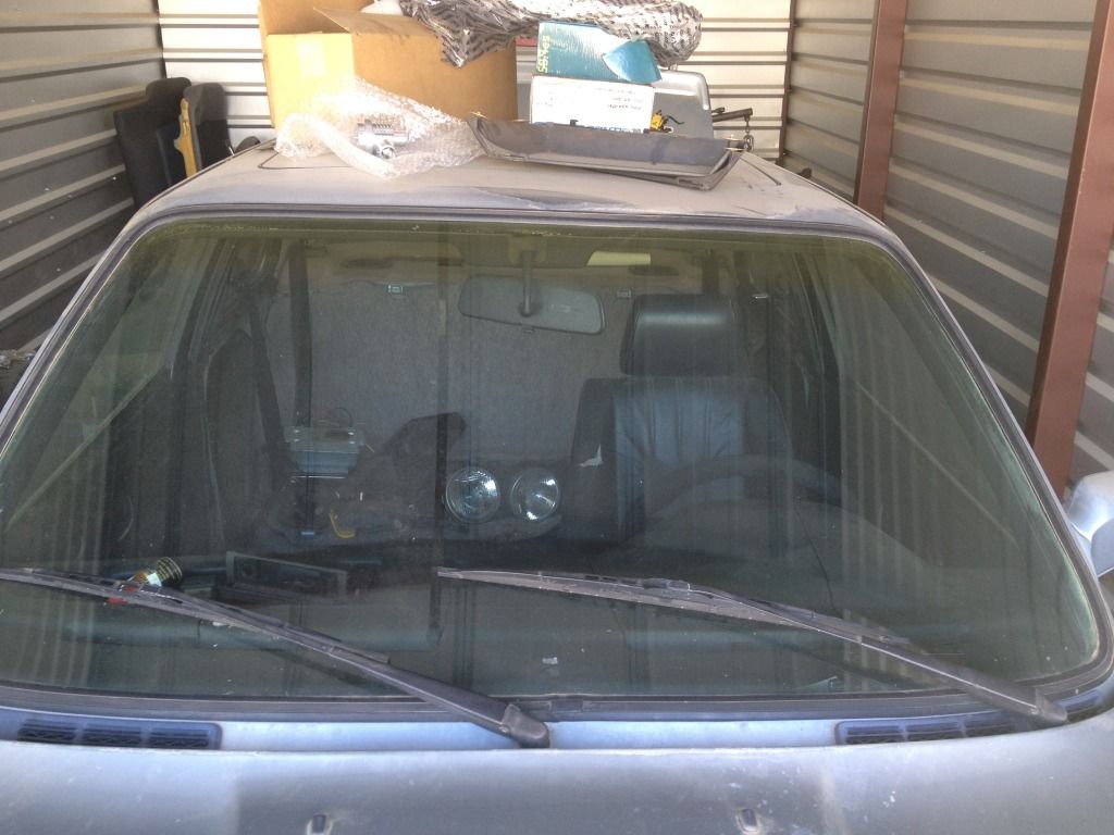

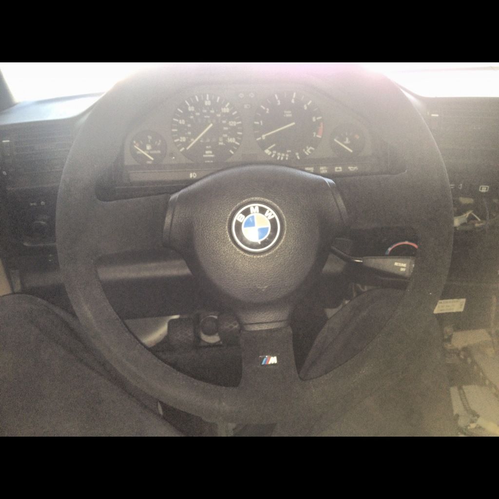

              I got the interior all cleaned out today finally, misc tools, hardware, trash, radiator, spare lights, half an m20.. etc! I was able to finally get all the wiring tucked away and nice and neat. I put a seat in it for the first time since 2009.... :(:D

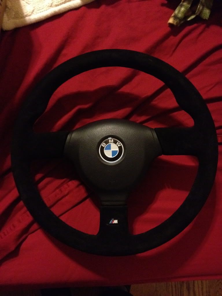

              got my suede mtech2 wheel in place :D
              woot! a seat! haha
              and almost got the front end all finished up! needs a grille! getting the old clips off the valence was a real bitch! I said fuck it on the last one, which is why it sags kinda.. do it later

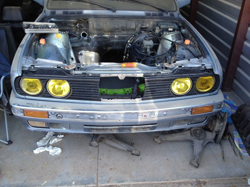

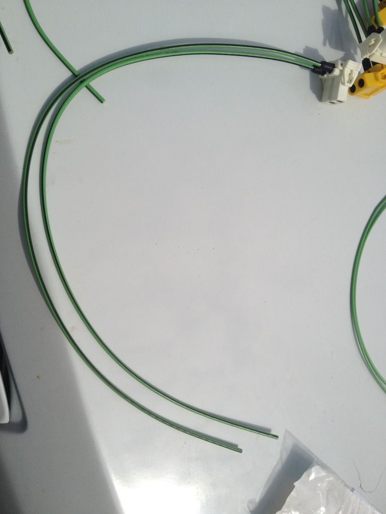

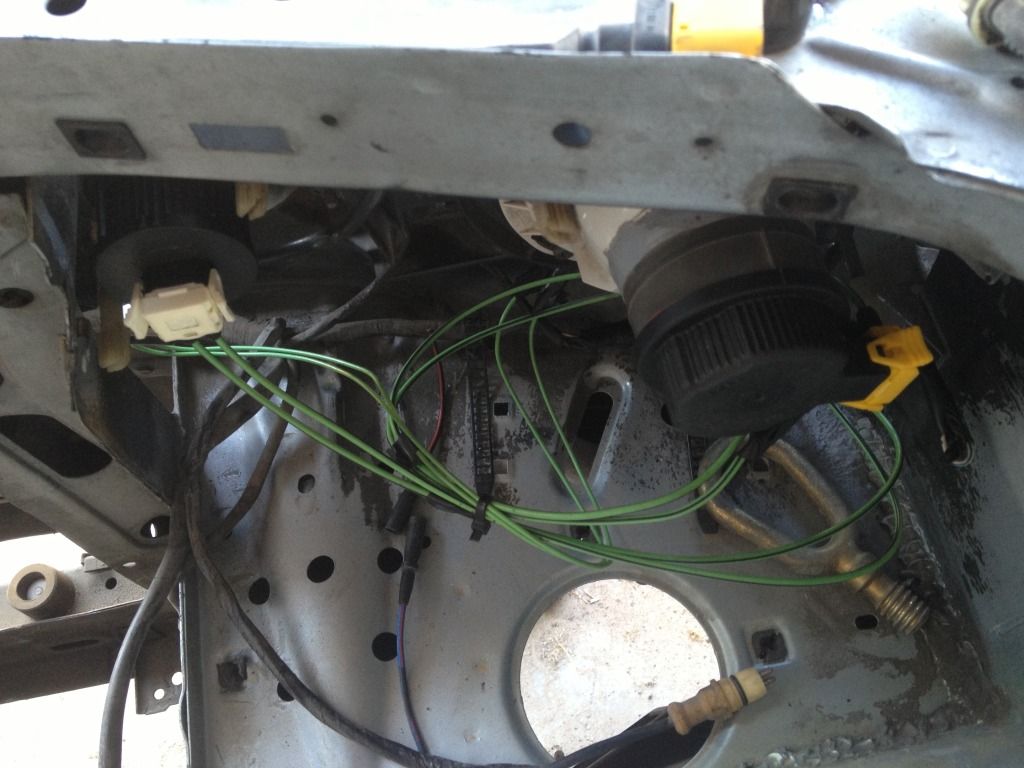

                I got my frenchies all wired up.. had a few hiccups with the city lights but figured it out. Cant wait to fire em up! New connectors and plugs/wiring
                little bit of euro action!

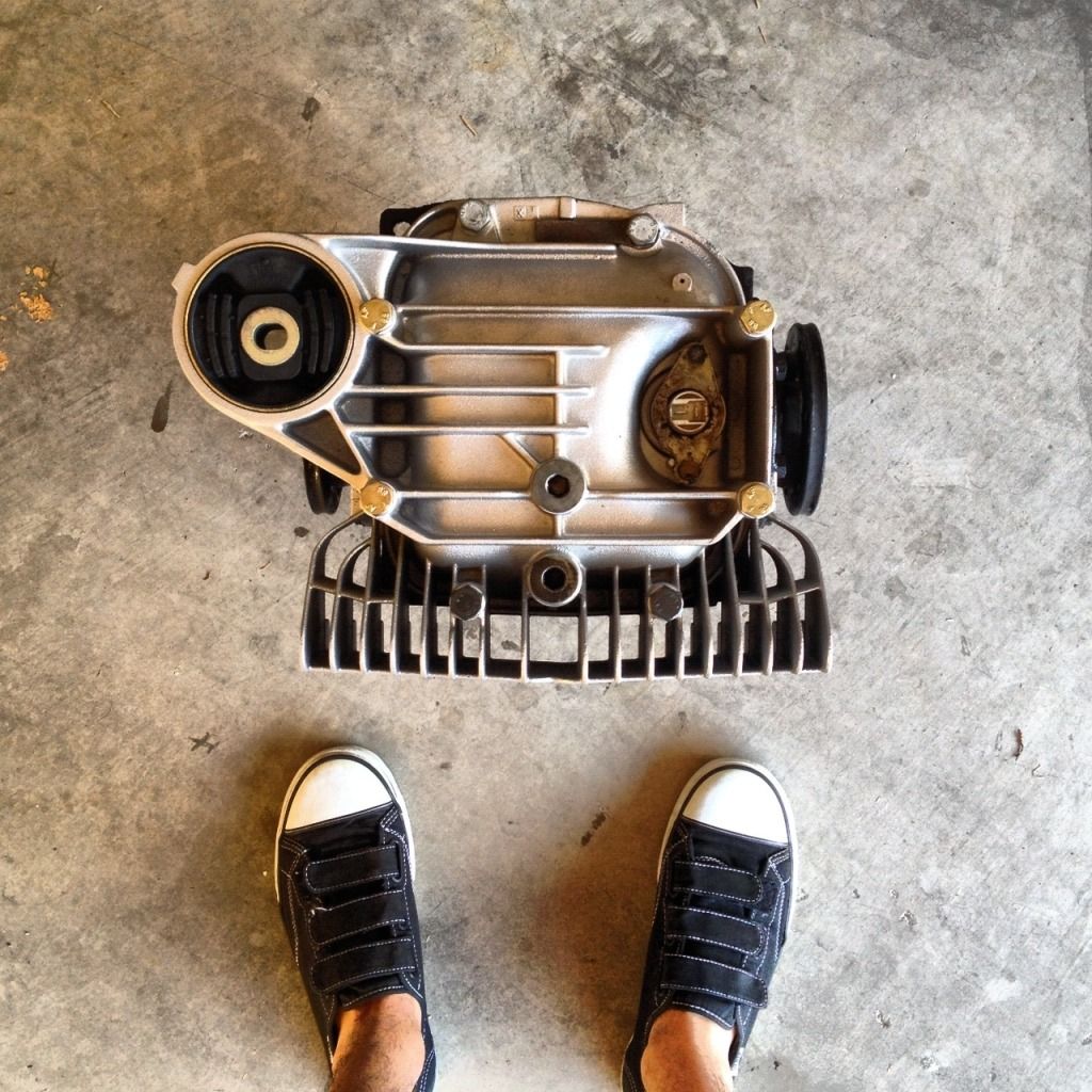

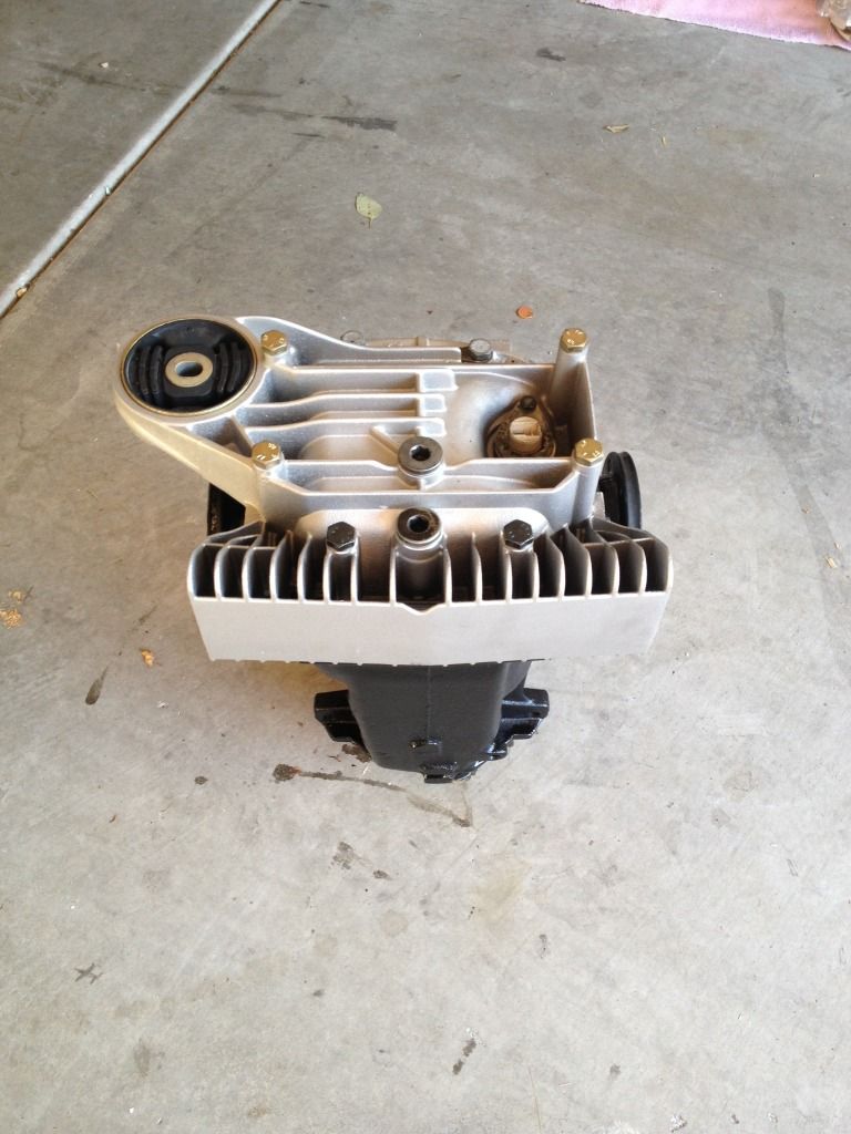

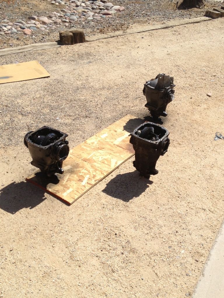

                spent today cleaning up my diffs

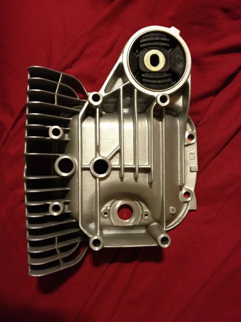

                Mcoupe cover! mmmmmm :twisted: its a s3.46

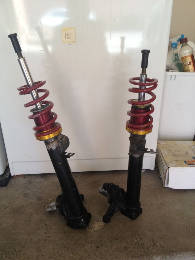

                    Picked them up! Very happy with Juniors work. Since I lost one of the supplied perches from GC he made a new one and it's almost identical. No short cuts taken or anything

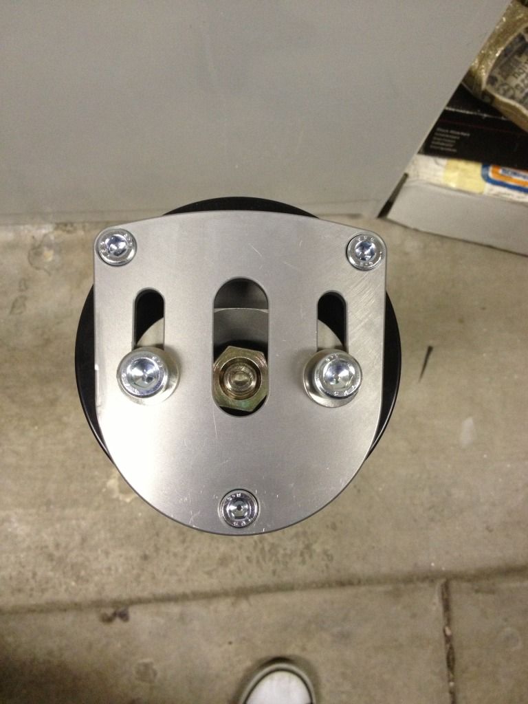

                    Now I just have to grab my spindles from my dads garage, and then grab my camber plates from Mitches shop
                    Looking like tomorrow I'll have pics of it on the ground!
                    What do you guys recommend for paint? Just looking to paint over the bare metal so it doesn't rust
                    Thanks for looking!

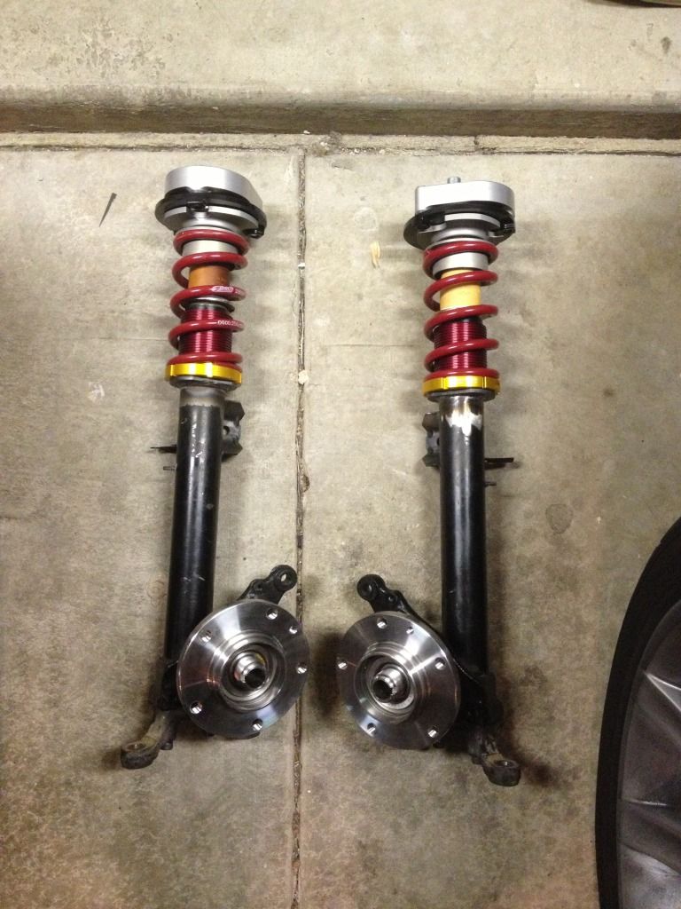

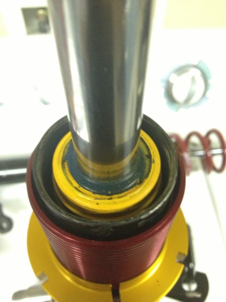

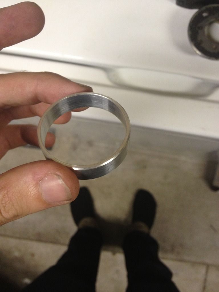

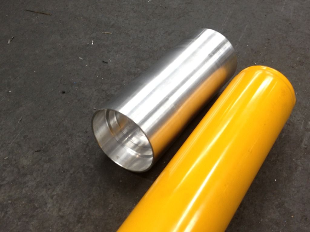

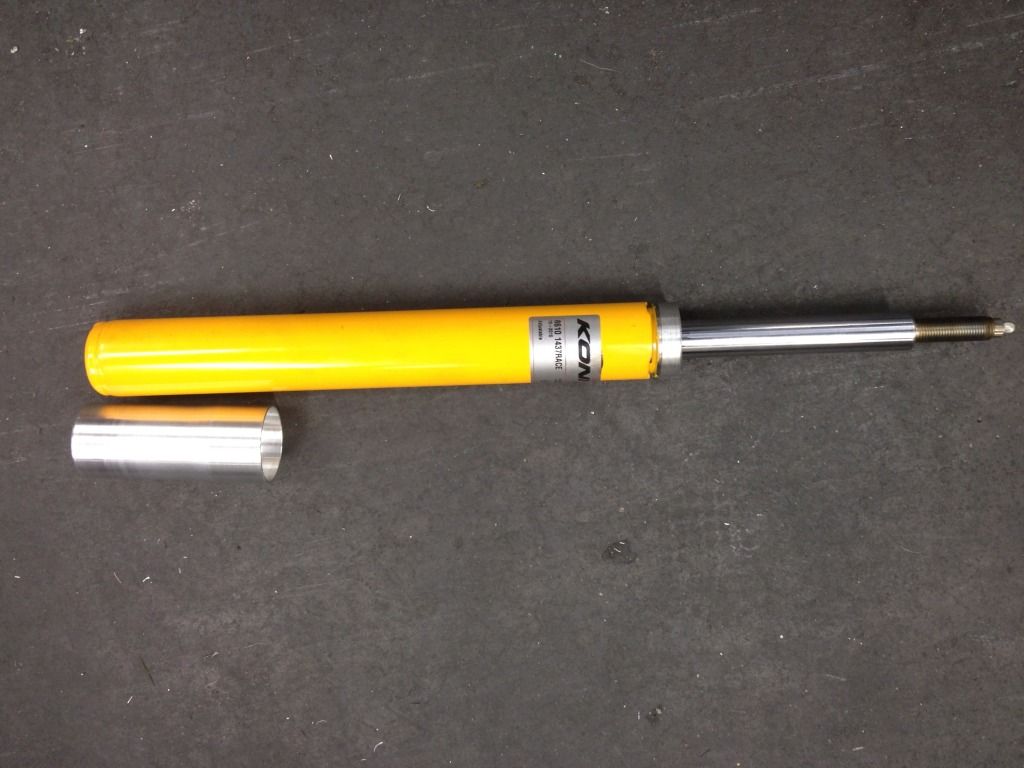

                            This should help clear up the shock fitment issue

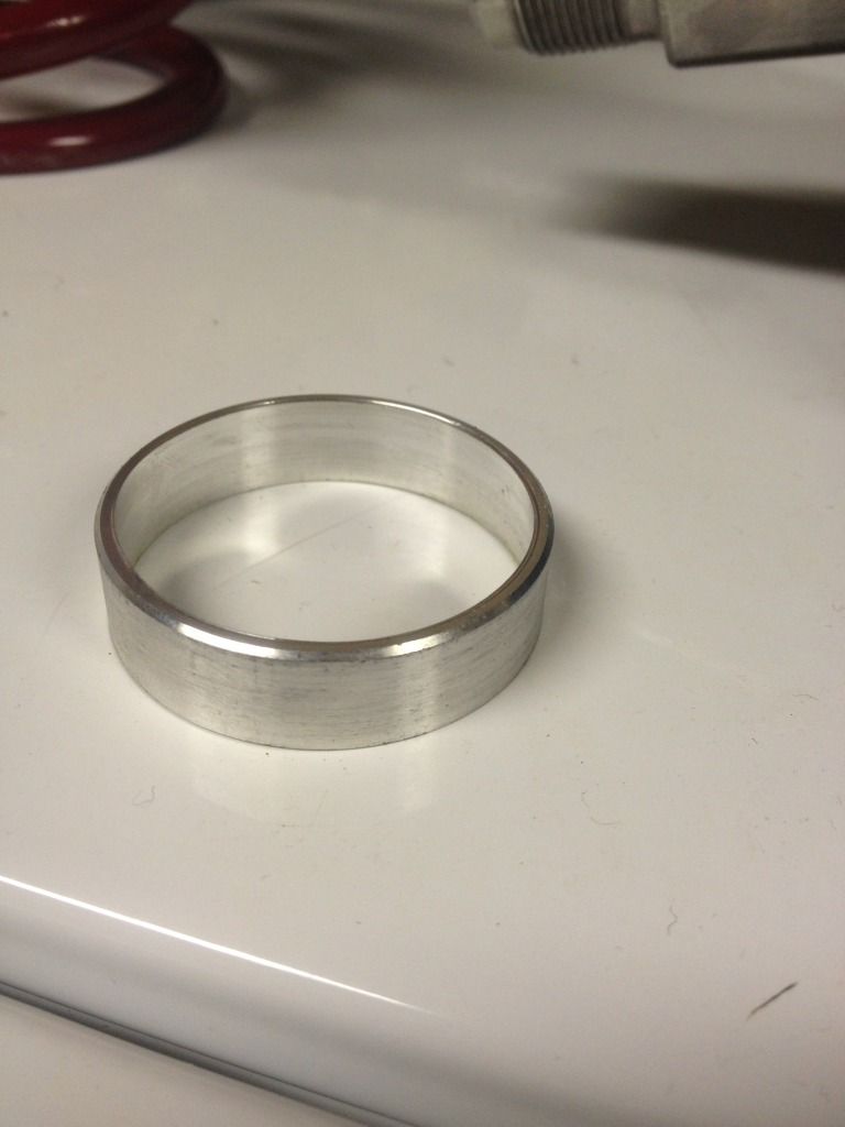

                            here is the spacer that sits around the top of the insert body and sits inside of the collar nut
                            here is how it goes inside of the collar nut
                            here is the space between the insert and the strut tube.. the bottom spacer fills the gap, due to the shorter insert, and then this top spacer keeps the insert nice and snug when you lock down the collar nut
                            hopefully this helps!
