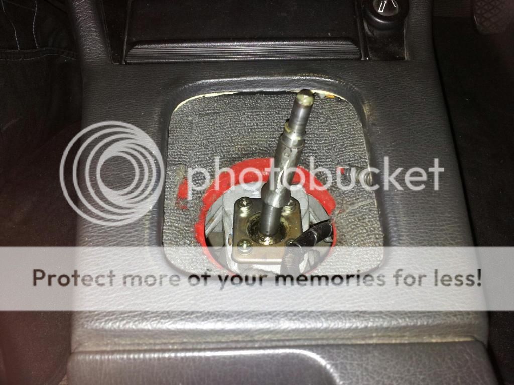

    Got the shifter done today. Welded the orginal BMW shifter internal metal (inside the insulated aluminium sleeve) to the Toyota gear lever which i bent straight in a vice. I now have a gearstick that is aligned properly (forgot to take a picture?)
    Fitted the insulating boot and the interior is alot quieter now. The gearknob will have to wait for the time being as i cannot fit the aluminium sleeve back onto it to fit the original gearknob i wanted to.

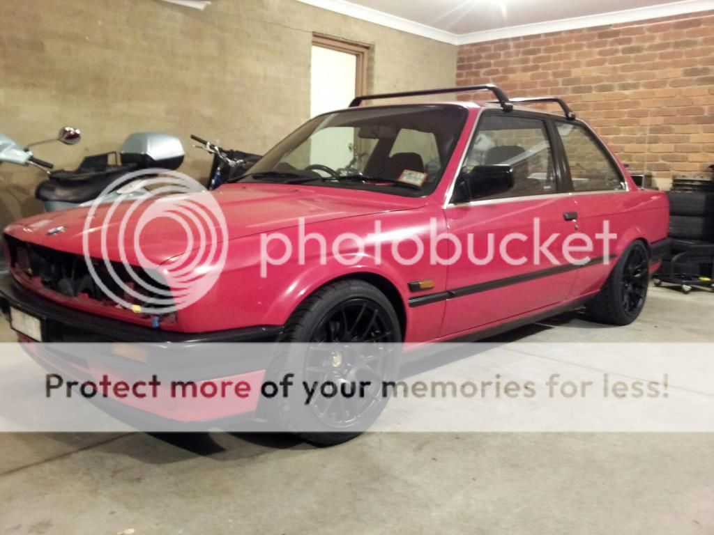

    How i had to drive it to the shop this morning.
    Some pics outside the shop waiting for my mate to open. Which brings me to the next issue....
    The car is way way too low at this ride height for Melbourne roads and speed humps. It rides great on the spring rates and at this height however it is just not practical and i scraped everywhere today (i have had many lowered cars so i know how to manovere) so it will have to be raised.
    Did not have time to fit the castor rod bushes nor adjust the sway bar (custom item will have to be made to get it back to a horizontal setup height, as it hits the bellhousing otherwise)
    Had a good time driving it out and about today though!

    Cut off the insulated upper sleeve of the shifter (prick of a job....)
    And this is how it looks when in 2nd gear
    The shifter factory has a bend in it that must be because the gearbox is on a slight angle in the factory car. So i will have to cut and shut this and add the BMW top section.

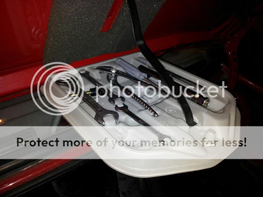

    A guy at work had a car accident in his E30 some time ago so i raided some bits from it before it headed to the wreckers. So now i have a complete tool kit.

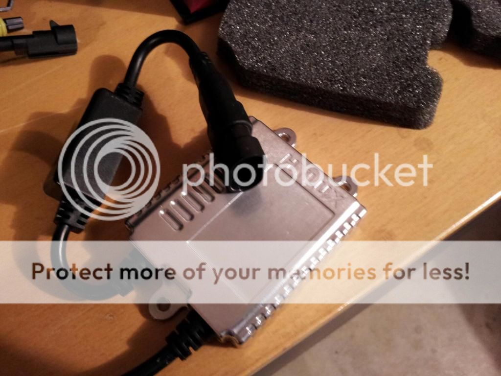

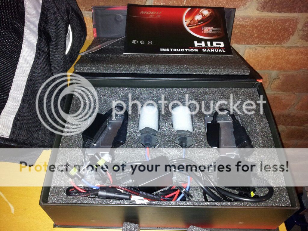

    HID kit arrived too
