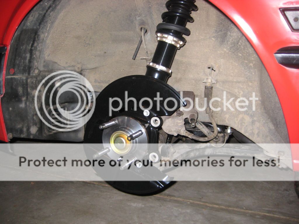

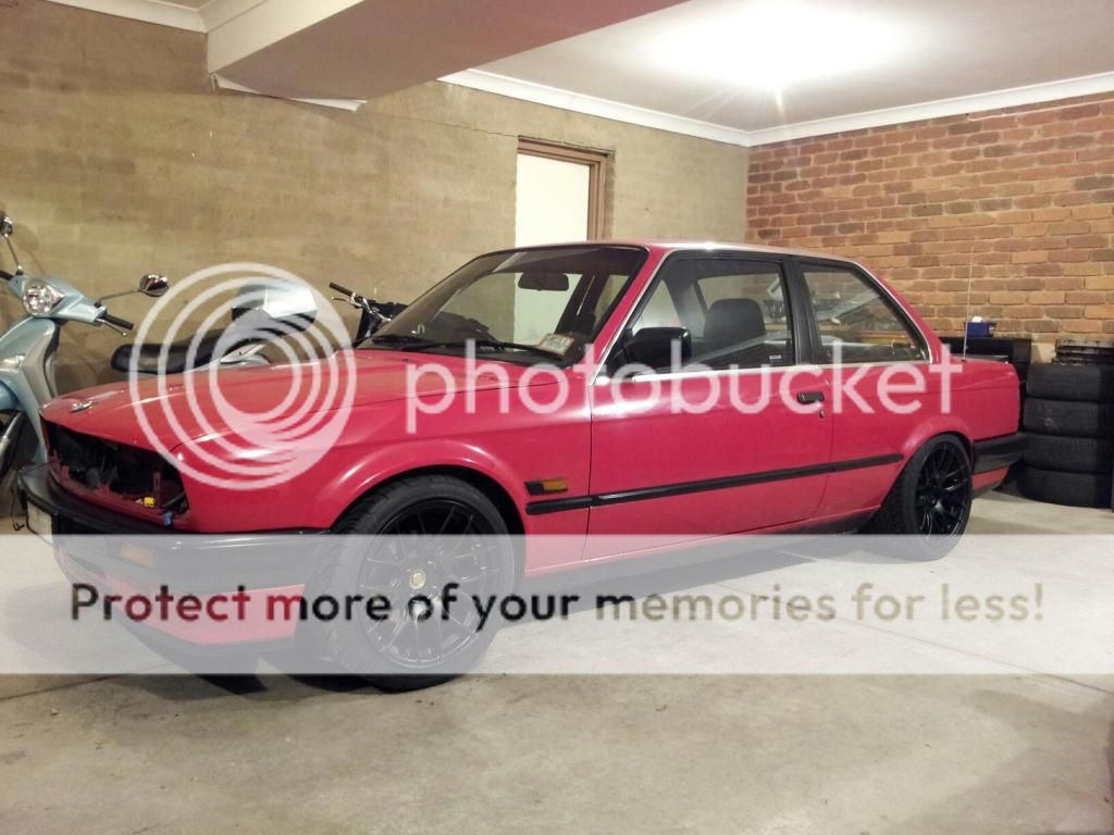

    Coilovers all done, Calipers painted yadda yadda.

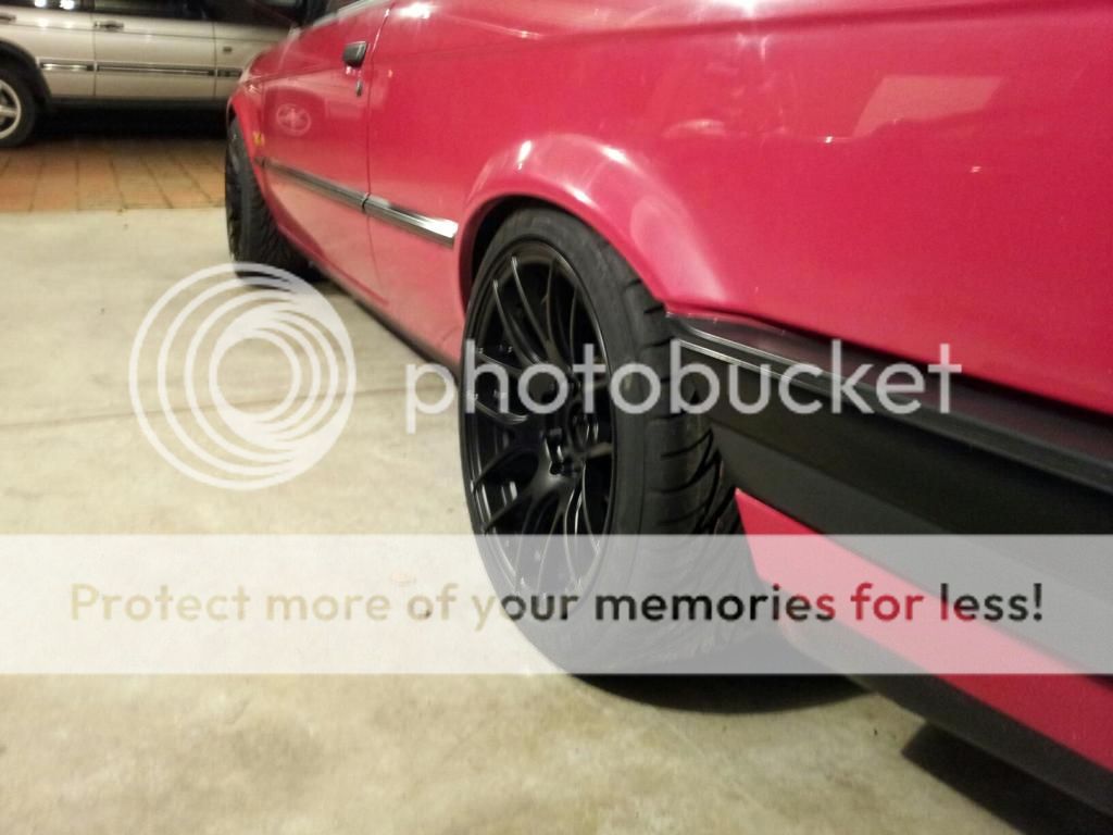

    Springs have not settled yet but i am happy with the height (not road legal here at this height however) If the springs settle like the rear it will go 10-15mm lower over the next few days.
    I did wind them down as low as they would go to see how it looked but as mentioned above by someone else the tyre was sitting on the spring perch. A 5mm spacer or smaller 205 tyre (i am using 215/40r16, 16x8 +20 rim) or a lower offset wheel would not have this problem at all.
    This car does not need to ride that low anyway since it is a daily driver for me and my gf will drive it around regulary (typical woman driver)

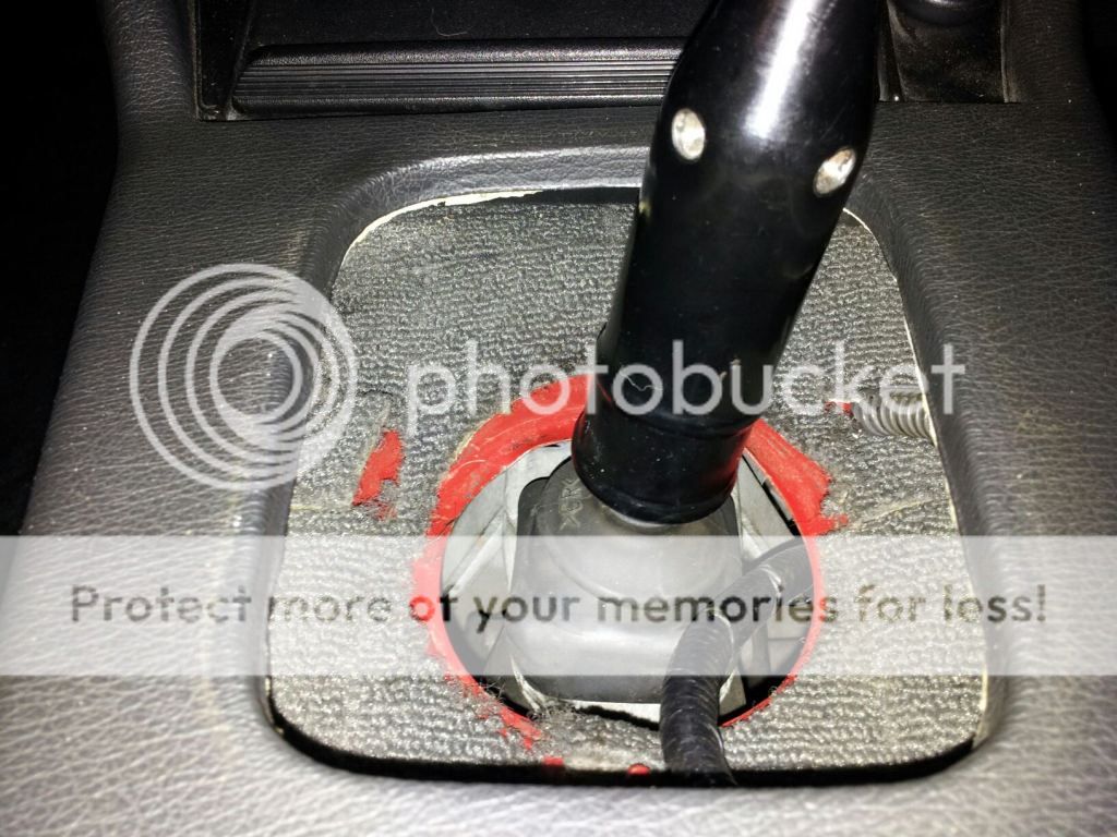

    Next job is to sort this out once and for all. I want it to look perfect in relation to it's positioning and also be able to use a genuine BMW gearknob.

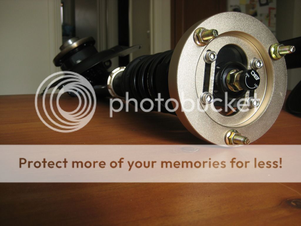

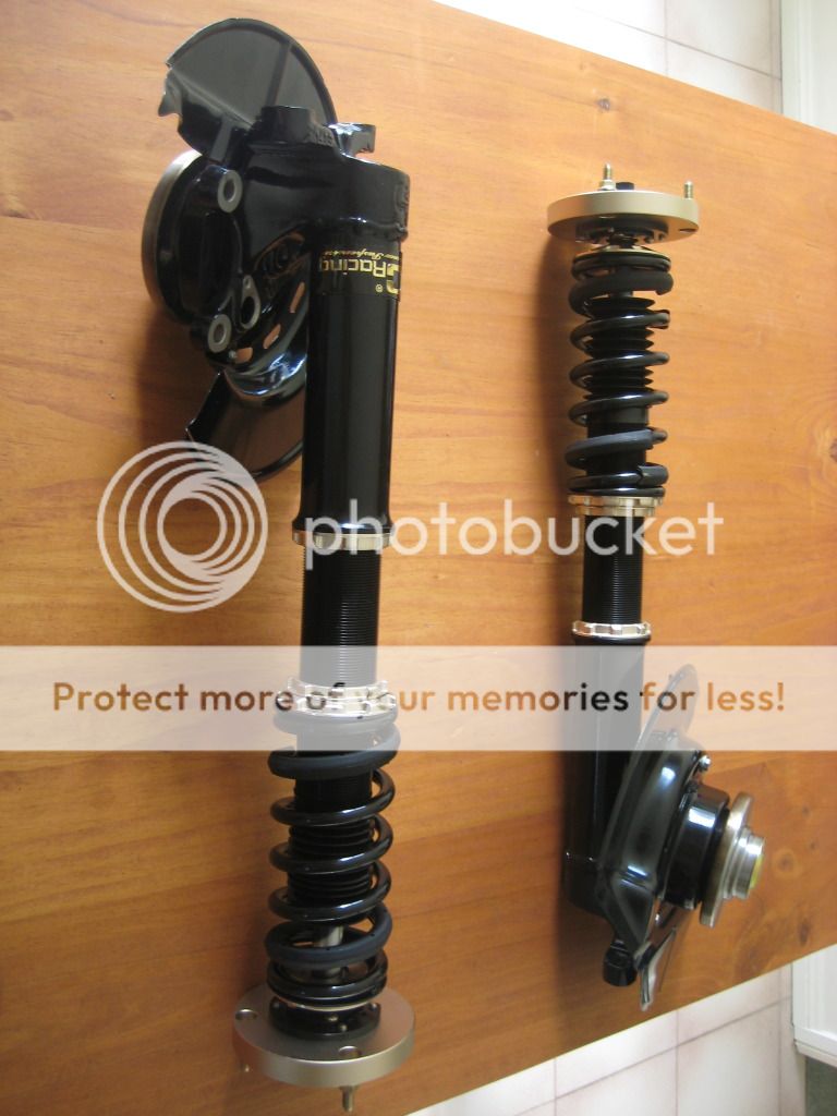

    I have 6kg front 8kg rear with stock height springs. as mentioned you can purchase shorter springs etc.
    That was not necessary in my setip however. Also theyre not wound down all the way in the front in the pictures either.

    You can get custom spring rates with the Bc's also, different spring heights(front springs). By the looks of his setup he has the larger 8in. (200mm) springs on the front, with a wider wheel in front say 16x9 the spring will hit the wheels in front causing the coil overs not to adjust lower than they could. I believe they have 160mm, 180mm, 200mm in spring heights.

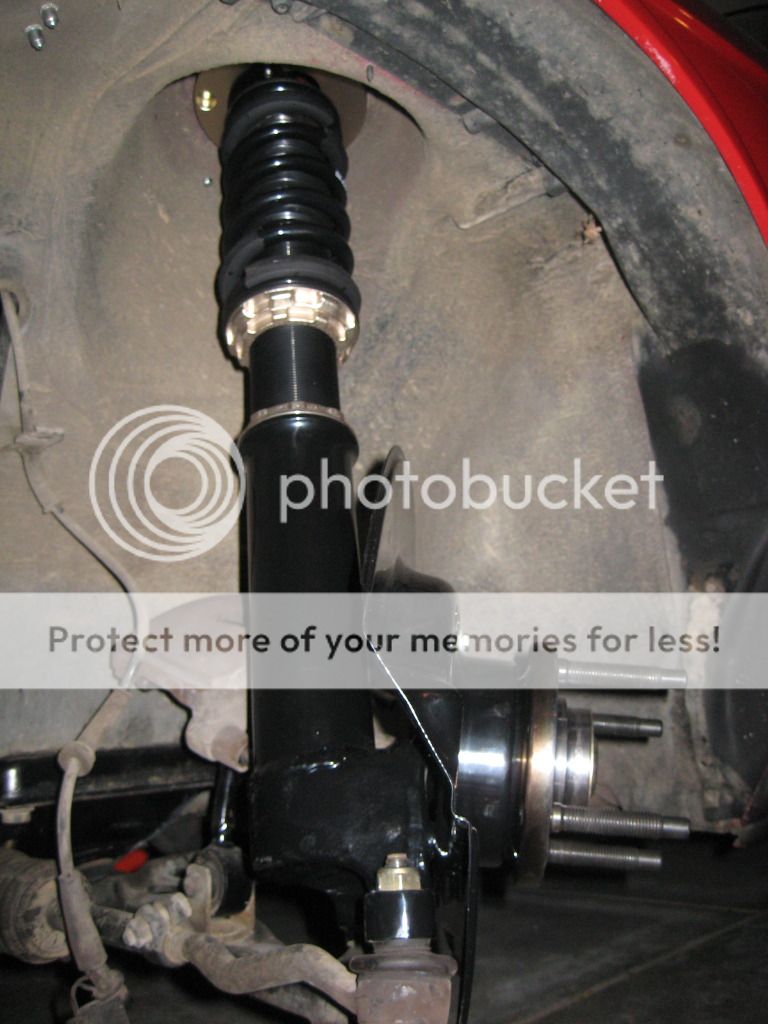

    One issue has arrisen however. The sway bar end links that were already modified for this application need a big cut and shut now this suspension is fitted to retain stock geometry.
    Something else to think about when lowering your car i guess....
    Leave a comment:

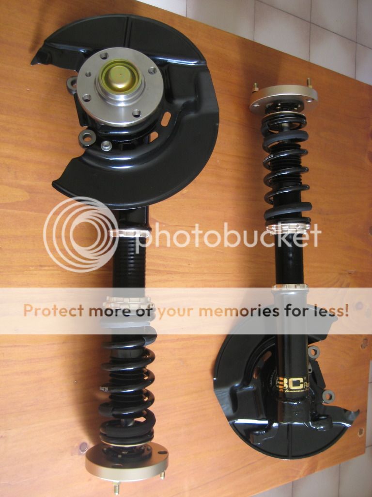

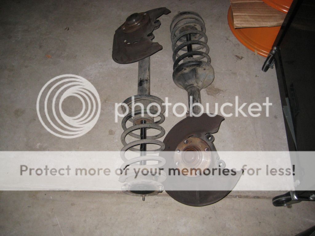

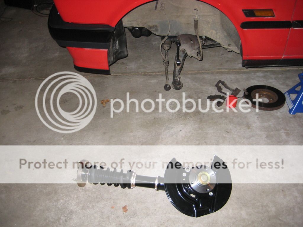

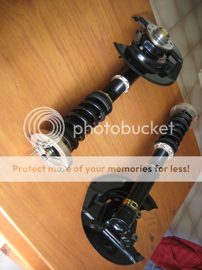

    Got the front coilovers fitted. The old 45mm struts were flogged out as you would imagine.
    Gave the brake discs a 20 second repaint that came out terribly too haha.

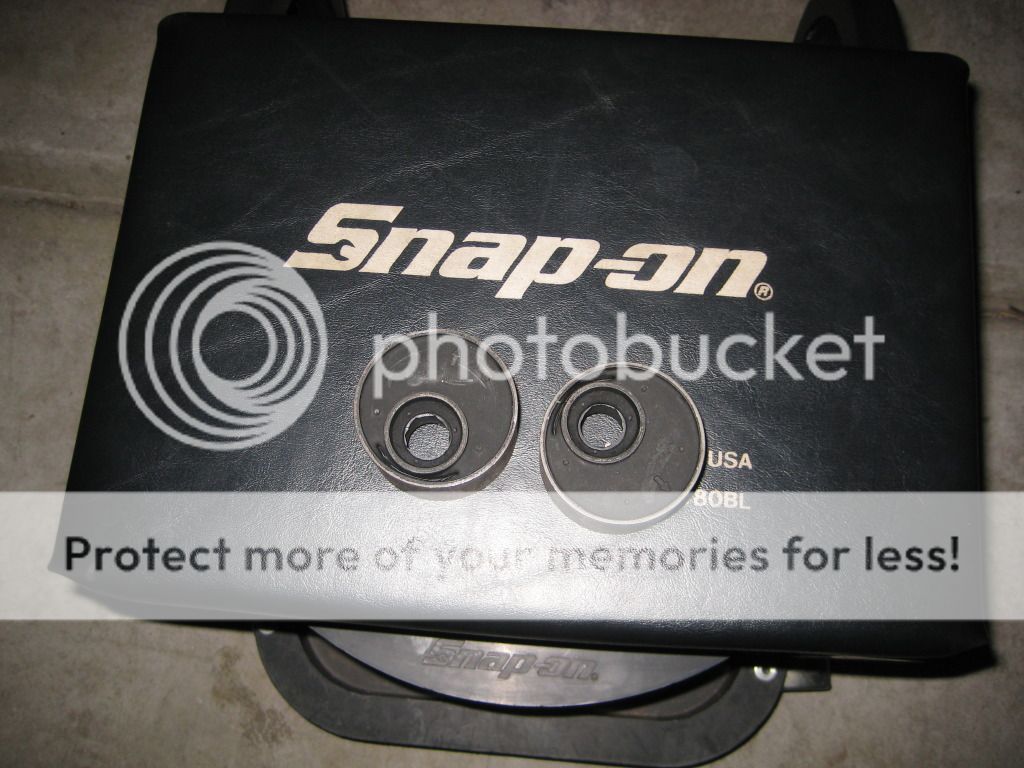

    M3 castor rod bushes arrived today too.
    The studs were a pain in the backside to remove from the old hubs and fit to the new ones. The loctite sure does work!
