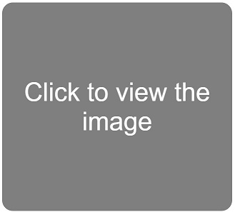

    M20 Oil System
    Since I'm doing a stroker engine with forged internals and other fancy bits I'll be running an oil cooler. I know this has been a source of debate between qualified forum members, and I am of the opinion it is necessary on this kind of build. In any case, I think of it as good insurance.
    Original Goal:
    To run a remote oil filter in conjunction with an oil cooler.
    Issues and solutions:
    -Remote filter mount so I didn't have to get cramped squeezing my arm past the narrower '02 frame rail, suspension bits, and tubular headers when I need to reach the oil filter. (solved by the remote filter bloc)
    -Add more clearance between oiling system and the hot headers (solved by 90' Rotating Remote Filter Adapter)
    -off-engine mounting provisions for the oil pressure and oil temp gauge senders (solved by the remote filter block)
    -Use a thermostat for the oil cooler since this is a street car (solved by the thermostatic sandwich filter)
    Running a 19 row Setrab oil cooler. Canton Remote filter adapter and mounting block, and an Earl's thermostatic sandwich filter. Also running the fancy braided fabric AN lines and fittings.
    If anyone would like the parts list, just PM or email me.
    Here's a rough layout I drew up to better illustrate what's going on.
    Layed out
    I'll try and mount the cooler behind the front passenger side headlight, similar to the #13 car, just on the other side.
