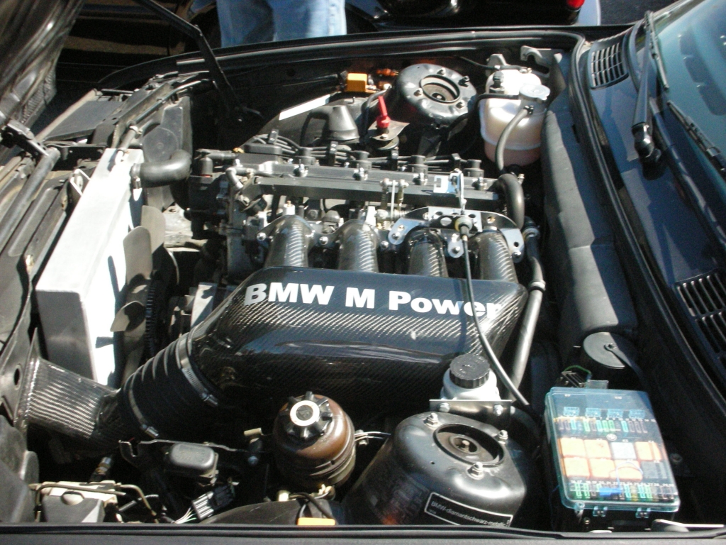

                    Do the S14 up like this man, and not give a shit anymore:
                        All that beautiful work ,and you kept the mechanical fan...he'll that's one of the first things on my list to do...after brakes,suspension,etc
                          Hey thats mine! haha. Yeah, if you want to race in a straight line, this isnt the car for you. This car is about balance in the corners. And please believe, that even off the line, my 210 lb/ft at the wheels and 245 wheel hp is no slouch.
                          Ive had no problems with mine. And your proceeding suggestions have been done. My car was Car Of The Month a couple months back you can read up on my mods. Ive never found it necessary to change to the electric fan. Id like to hear your suggestions as to why though. I know it supposedly gives 5hp.

                            I personally think an electric fan looks much cleaner compared with the viscous, I've done it to all my e30's. I'm not sure though if it's as efficient as the viscous due to not having a shroud.
                            That said, even if it gives me 1hp I would probably still do it for the 1hp.

                              I deleted my fan during the rebuild. I don't want to buy a new one and whatever weight or drag I can shed from the S14...the better. I installed an aluminum radiator with electric puller fan (operated by stock temp switch), deleted the AC condenser (more air flow) and have a 318 temp switch with the stock Aux fan. As some of you know, the euro spec M3's didn't even have fan clutches or a puller fan. However, in warmer climates like CA, it's nice to have that fan clutch just incase but if you've upgraded to an Al radiator, puller fan, deleted condensor, and the aux fan works, there's no need for a fan clutch.
                                Hmm. I also have none of the A/C accoutrements (piping, condenser, compressor, etc.). This may be my next mod to delete the clutch fan since I also have an aluminum radiator as well.
