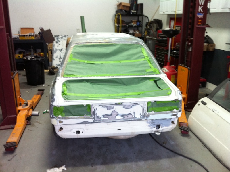

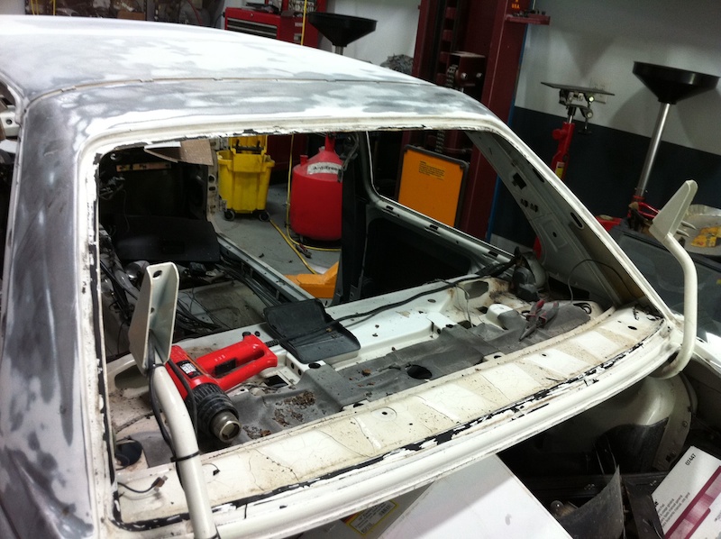

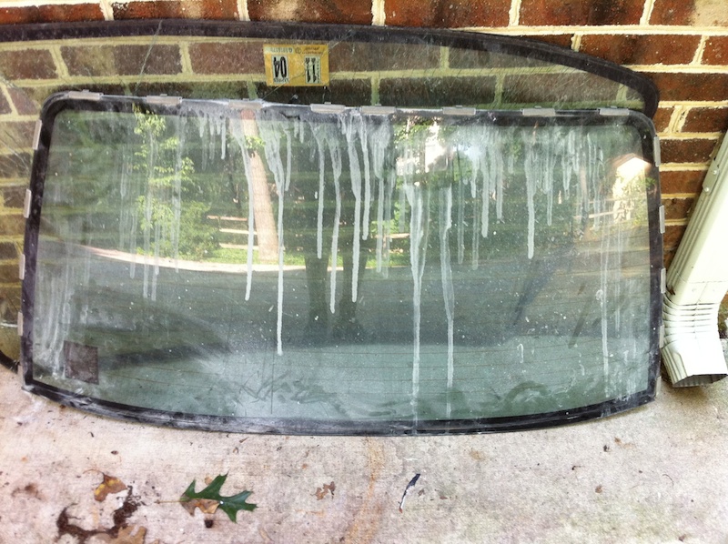

    Decided to suck it up and pull the rear windshield. I had originally entertained the fantasy of leaving it in, but the nasty build up of Maaco lacquer scotched that. The rear window trim was one of the few things they *did* pull when they painted it. Oh well.
    After comparing the cost of having the glass pulled with the cost of a new one, I just pulled the damned thing myself. It actually came out fully intact and I was even able to get the BMWCCA sticker off. I'll have to test the defroster before it goes back in, but I'm hopeful.

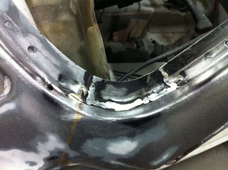

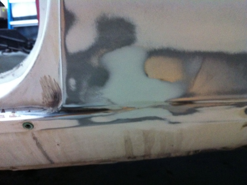

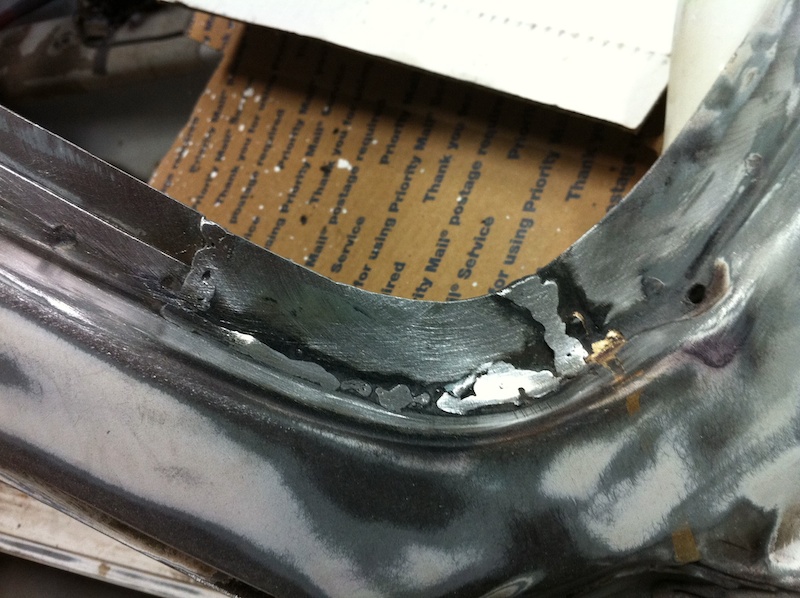

    The last weird rust hole patched and finished. I really wish that I could explain these two rust spots. They are so out of character.
    I did promise to show the windshield frame repair.

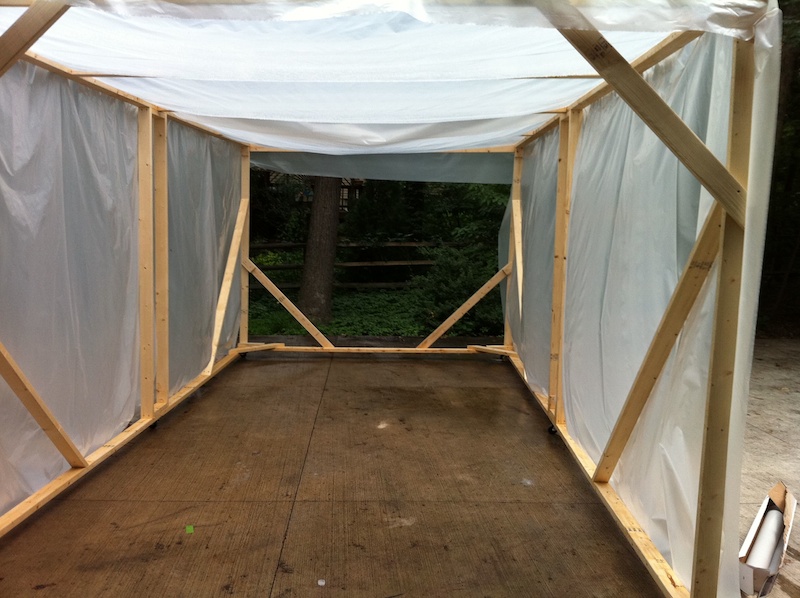

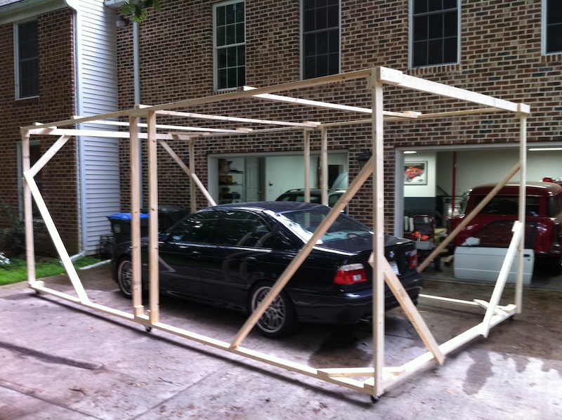

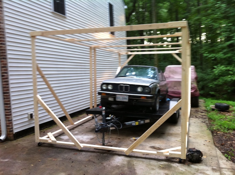

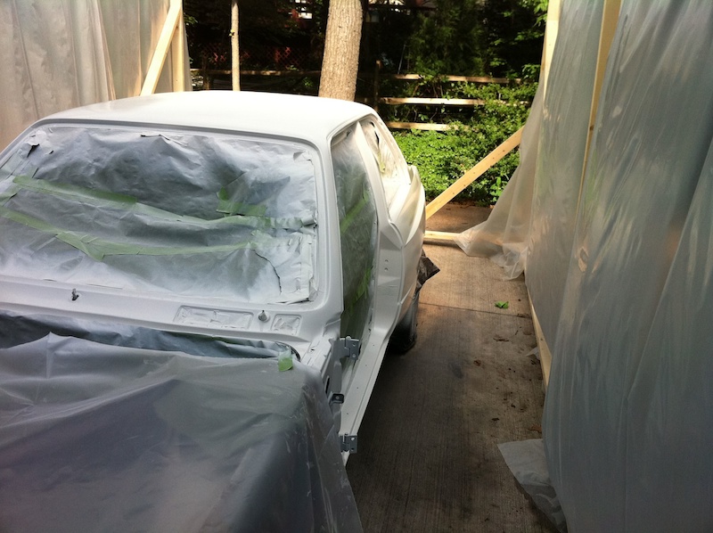

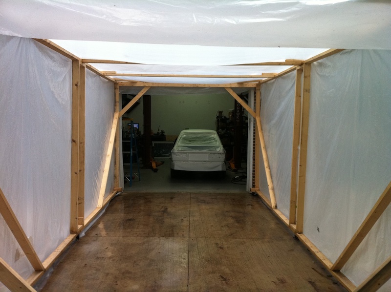

    Holy crap! It's a paint booth! Kind of.
    Luckily it fits over here for storage. It takes up a lot of space and I'm definitely looking forward to breaking it down and storing it.

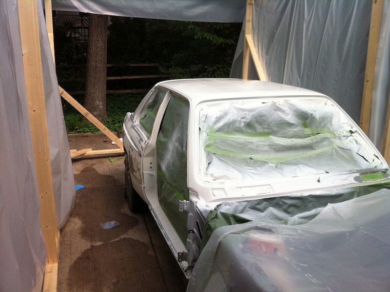

    Plastic draped on it.

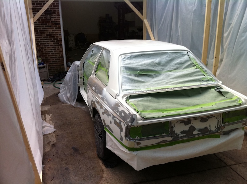

    Masking is a real pain in the ass. As annoying as sanding, IMHO.

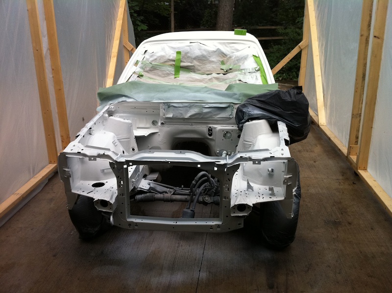

    DPLF going on…
    More DPLF…
    More DPLF…
    Even more...

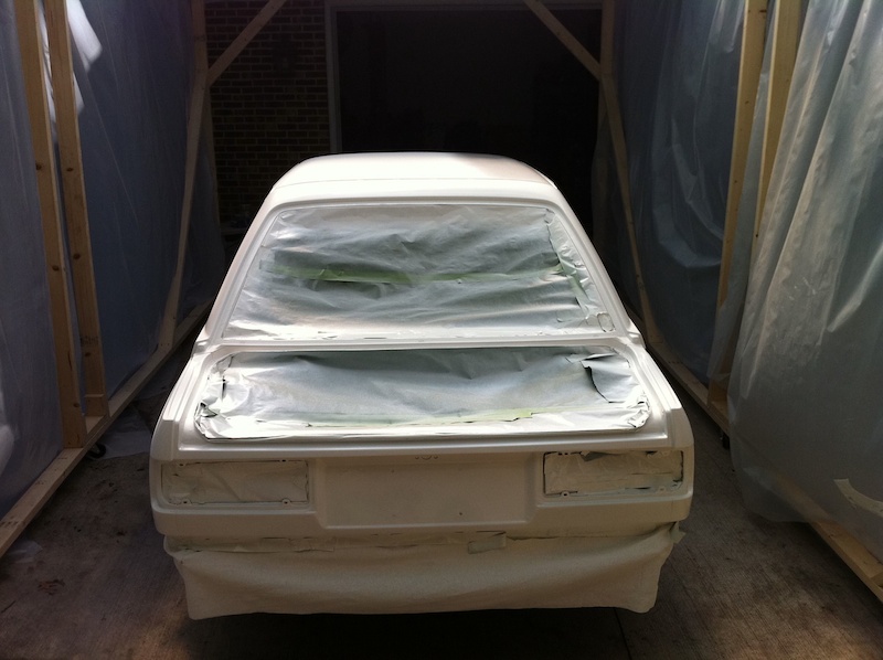

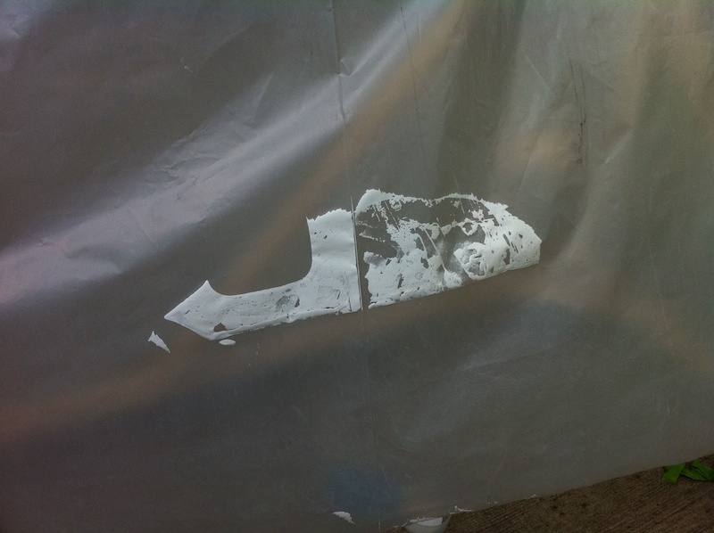

    *sigh* This is why it's a good idea to staple the plastic on. Luckily, damage to primer is easily repairable.
    Stapled together this time around. Much better.

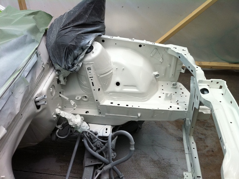

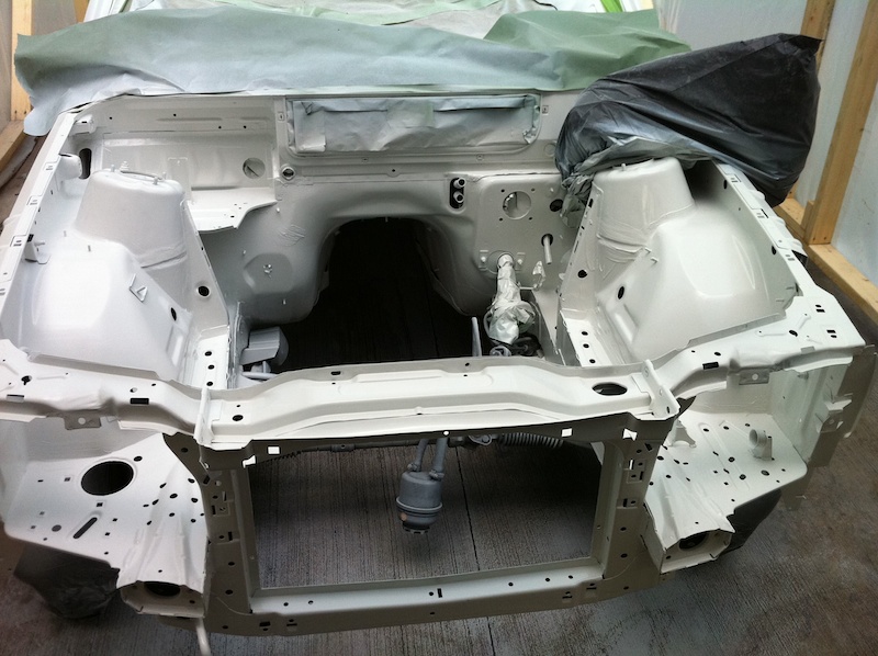

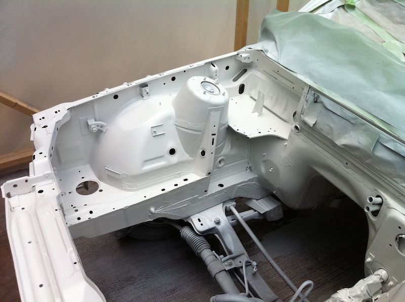

    DPLF going into the engine bay!
    Painted! In fact, I've top coated the bay, too. Apparently I didn't take any pics of that, but it doesn't really matter. The difference between DP48LF and AW doesn't really show up in pics.

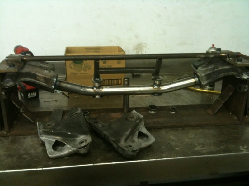

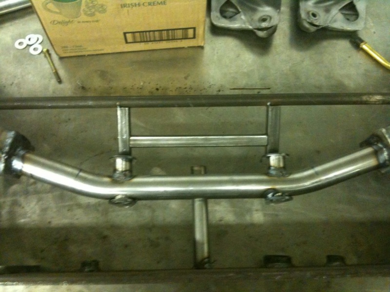

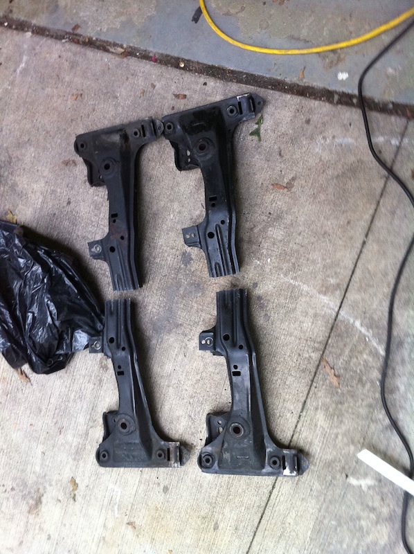

    Some non-paint related news! I felt really bad about cutting two perfectly good subframes in half. Just doesn't feel right.
    Fortunately, it's all for a good cause. Tyler Timmel is making me a couple of his lovely rear sump subframes so I can keep a dual pickup on the euro motor and so that I can swap to a rear sump pan on the 330is. The best part about this is that I get a pretty large weight savings by not having to run a skid plate.

        Excellent work so far! Let me get this straight now, you're using a custom subframe on your e30 with a US s50 as well so you can run a rear sump?
        I'd like to hear a bit more about that if you would be so kind as to indulge me.

            Danny -
            I'm not 100% certain that the stock S50 pan will work without modifications. A little modification isn't that big a deal if necessary, but it would be awfully nice if it just dropped right in.
                  Interesting link indeed. I'll be following this closely!
                        It nice to see someone is going to try this with a US S50/S52 swap. I'll be waiting to see how this turns out for when I do mine here soon.
