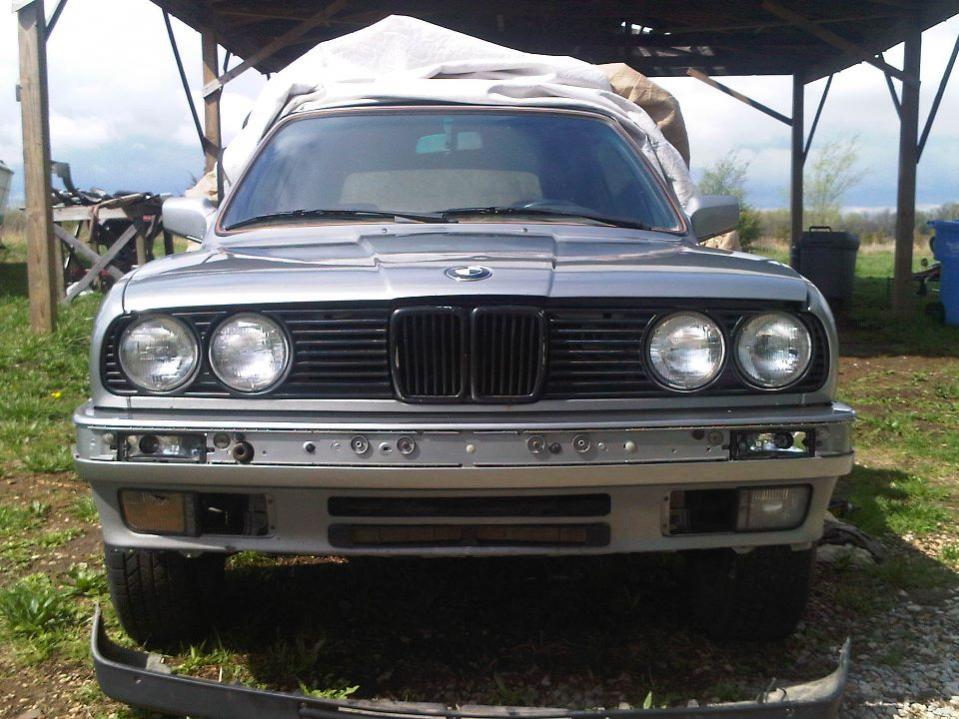

                            Ok so a lot has happened since I last posted. I have completely refreshed the M50 I am installing so there is new seals in the whole tranny (getrag 260), I replaced the rear main seal and pilot bearing, put on the e34 oil pan, and the next step will be to put all the new clutch parts on and mate the tranny and the motor for the drop in. I also scored hugely at the local pick and pull with a color matching plastic bumper swap for $100 so I have the new front bumper already installed and will do the rear shortly. Unfortunately there was no trim on the bumpers so it will look ghetto for a while but I approve of the ghettoness over the tucked Diving boards. I expect to have the running M50 within a week or so and possibly some trim for the bumpers soon too. Here is the only pic of any of the updates but will upload some pics of the M50 soon too.
